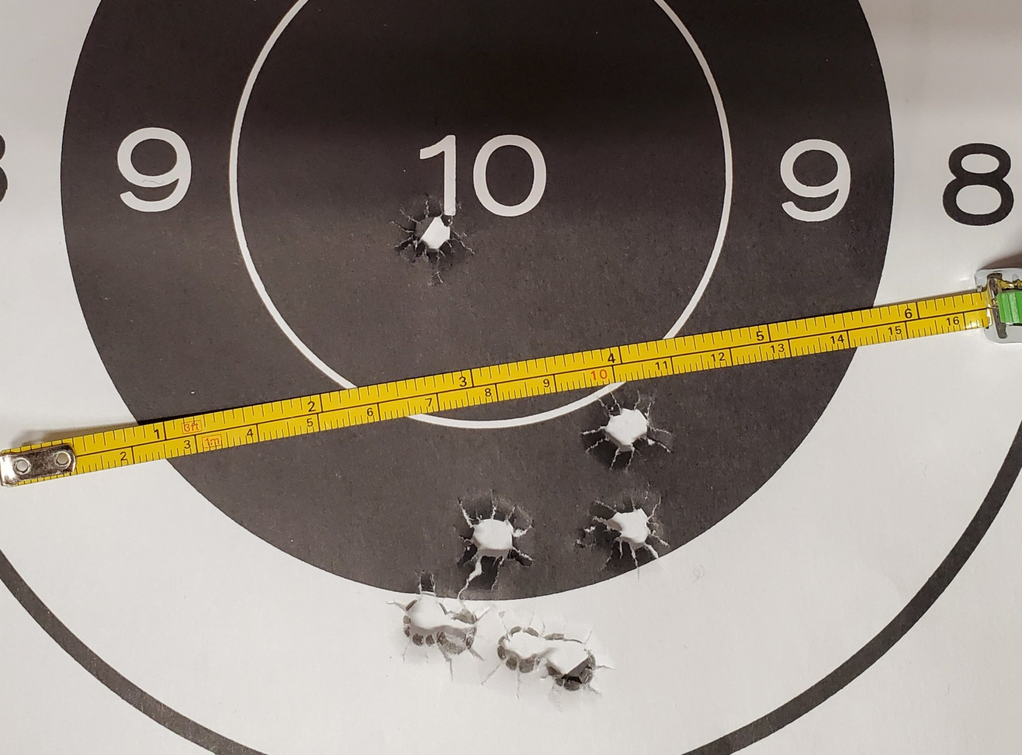

I've made the Springfield Loaded M1A that I purchased nearly 20 years ago my latest project. So far, I've made the following accurizing upgrades: 4.5-5lb NM trigger job, shimmed gas cylinder, NM ferrule and handguard mods and NM op rod spring guide. Rifle is sitting in a Boyd's walnut stock, unbedded but with clearance for the gas cylinder and op rod. Front band is flush/square to the ferrule with proper draw contact on the lip of the band.
(Benchrest and bagged at 100yds.)
The above photo is representative of the groups I'm getting with 155gr. ELD-M handloads with H4895. Federal GM308M is shooting just as tight or even a little better. The outlier in the 10 ring was all me and on call. There are 9 in the group below. Zero was a little off after cleaning the carbon out of the piston and cylinder plug.
For those familiar with these rifles, how much of an improvement can or should I expect after bedding? I'm also likely going to upgrade to a NM piston. Is there any advantage to going with a unitized front band and gas cylinder as opposed to just shimming? If so, is welded or screwed and glued best or does it matter? I have a feeling my journey down the rabbit hole may just be beginning!
Thanks in advance!

Thanks for the feedback, it's greatly appreciated! The group in the picture is with irons, NM front and GI rear. I've been shooting with a 6 O'clock hold. I've been considering trying a sub 6 hold based on the suggestions in Jim Owen's materials. Have you had better luck with a center hold? I can definitely appreciate what you're saying about holding the rifle tight, even from the bench.

Realistically, I'd like to be able to hold 1 to 1.5 MOA with iron sights consistently from a supported position, i.e., bechched and bagged. Offhand, I'd be tickled with keeping everything in or very near the black but that in my opinion is more of a function of form, fundamentals and wind reading as opposed to rifle upgrades. Starting out with the smallest dispersion from a fully supported position certainly helps though.
I plan on starting into some informal service rifle matches this spring.
That's a fantastic group at 300 by the way! It's hard for me to imagine being able to shoot much tighter than that with iron sights!

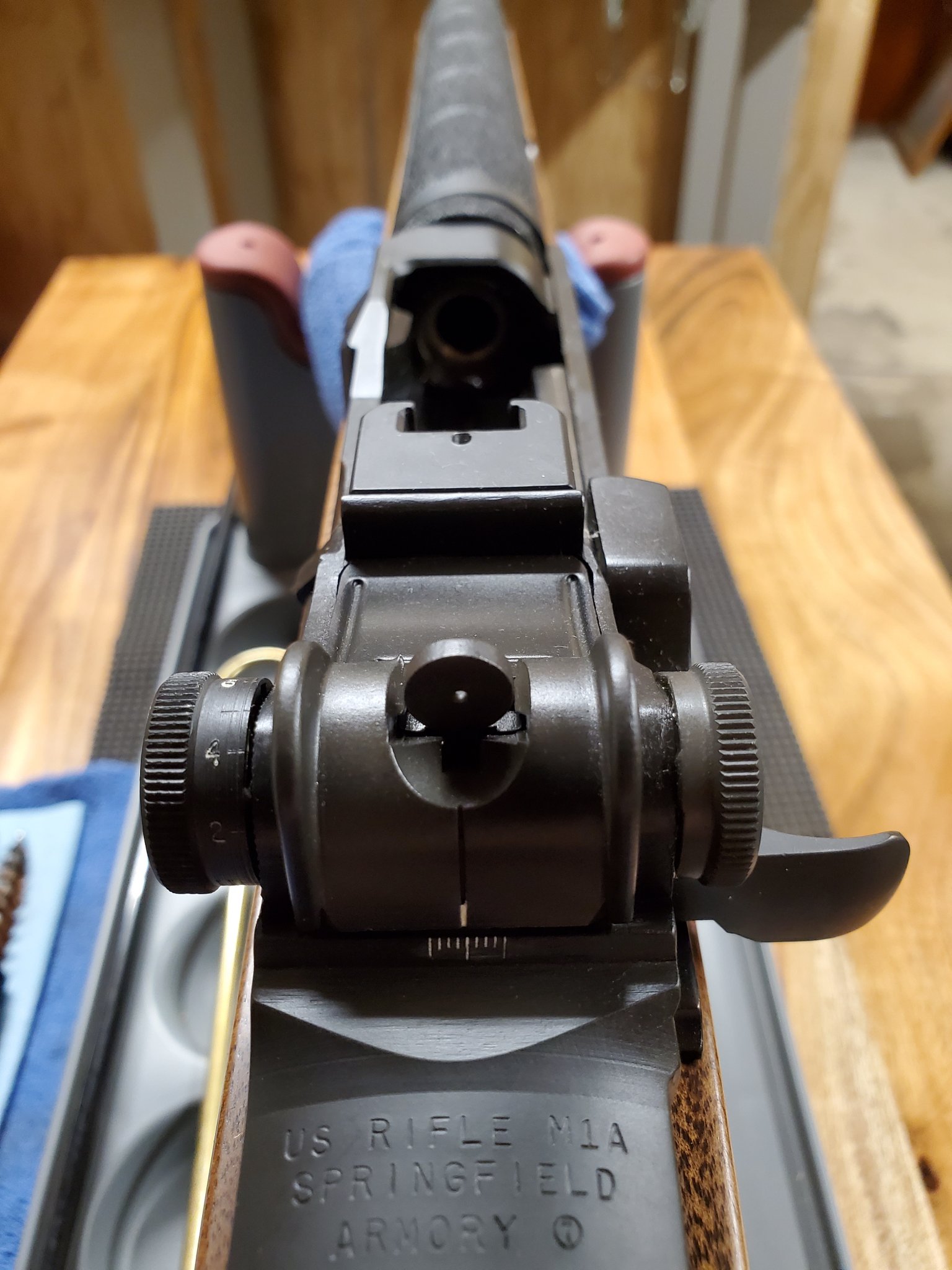

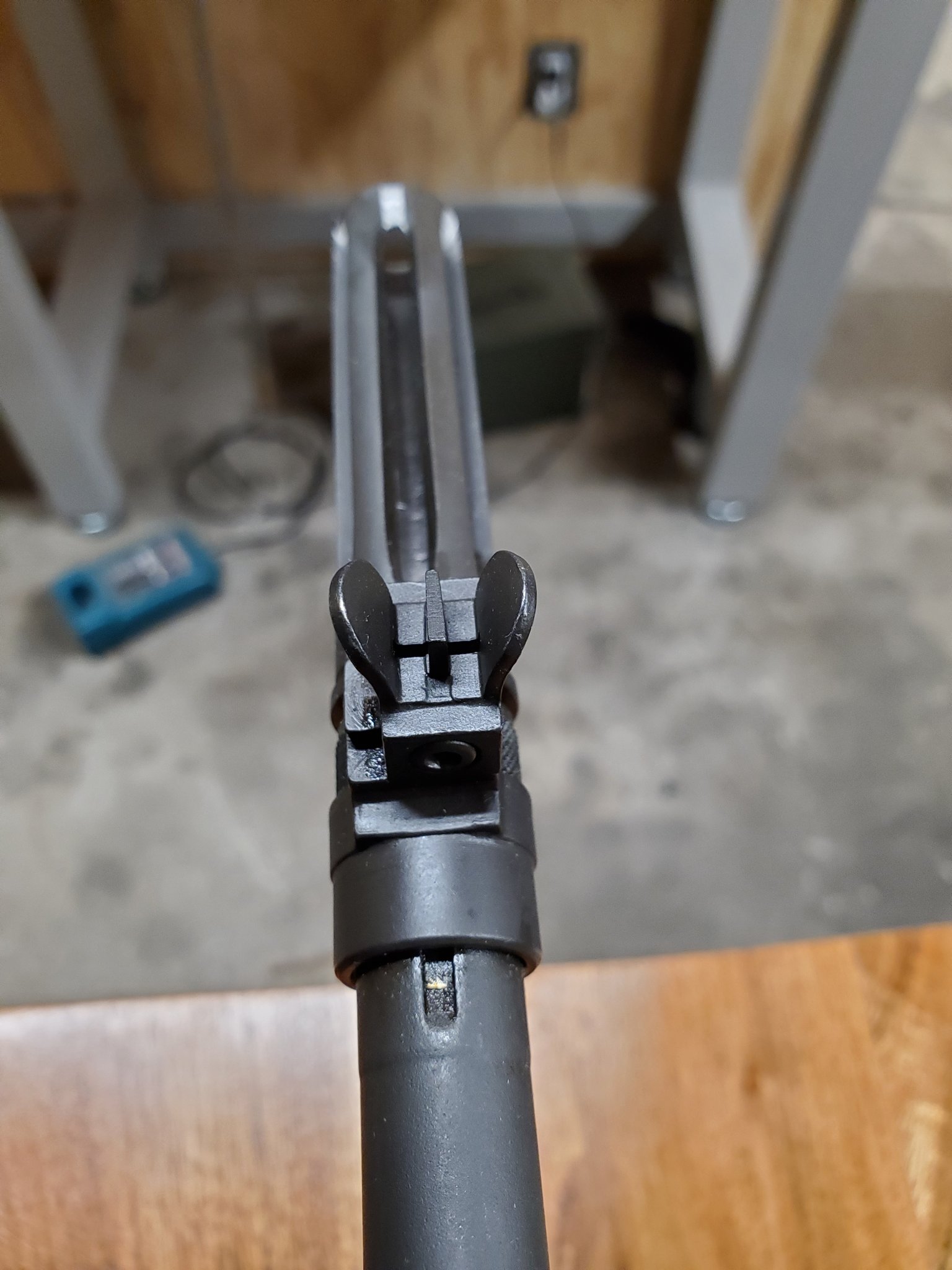

Photos as promised!
As you can see by the position of the front sight, my barrel is clocked a little off!

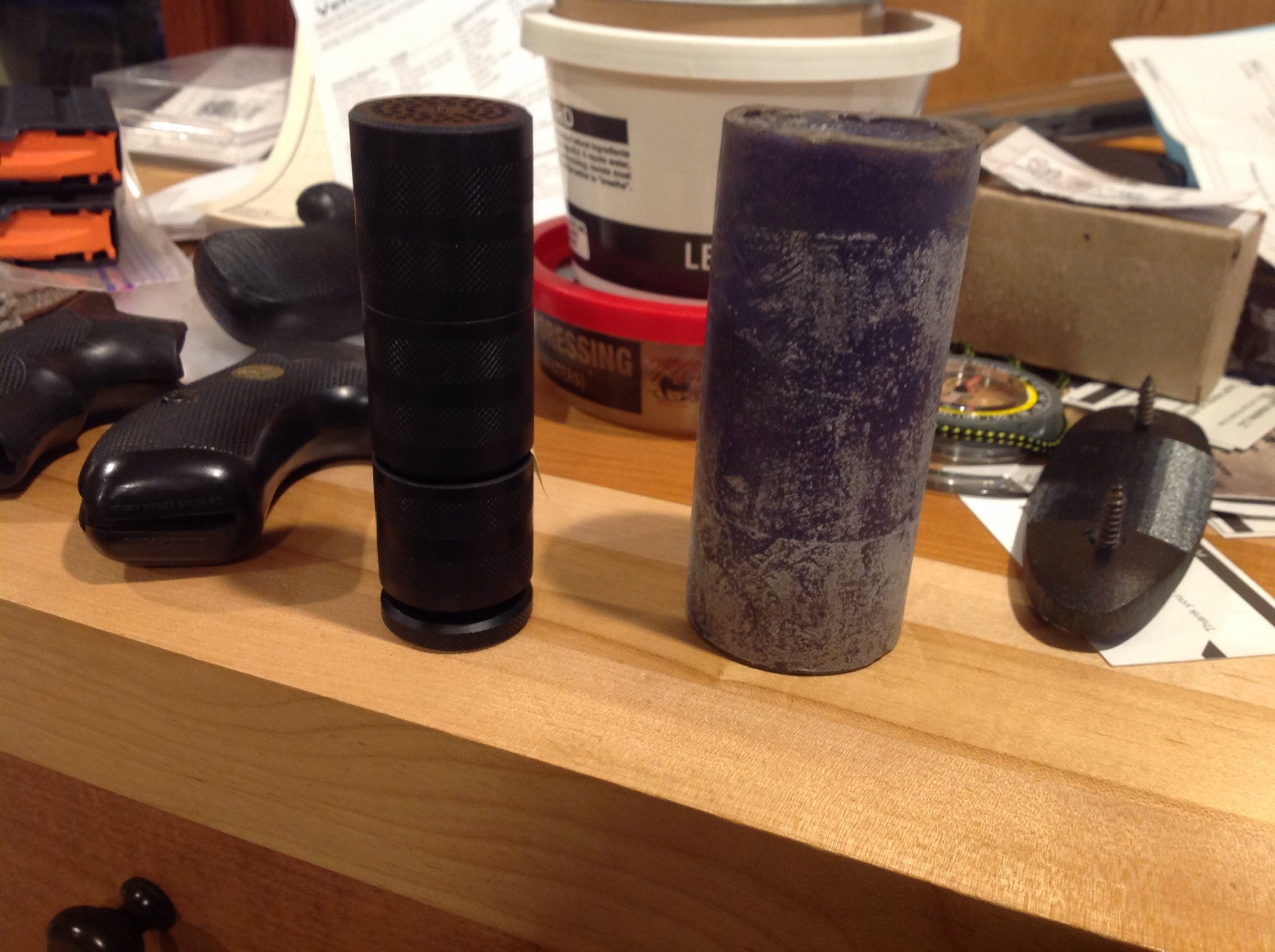

Would love to get hold of a carbide lamp. The one Ray Vin used to make looks sweet.
Guessing they become a little maintenance nightmare with the infrequency I would use one.
Looking though.
Neat piece of gear.

Yikes on the front sight!
Good on you though for going that route and centering the rear.
My M1A is pretty well centered front and rear.
When I got my Garand I had to look up the formula for sight radius, try to remember if "left moves right" or "right moves left" or perhaps it is "shot moves with sight", than I used the tail of my micrometer to move the FS the small amount needed to get the right correction.
Little bit easier to square windage on one of these than doing it on a no reference Redfield scope base and moving a centered scope to align with the scope base by trial and error, loosening rear screws on one side than tightening the other.

Looks like I'll be ordering one as well, maybe we should get a group buy going in the PX!
Seller is in Aus.
Lots of communication, very receptive.
Way to order is via his home page contact link.
With shipping, one tool and a repair kit I was $90 or so US.

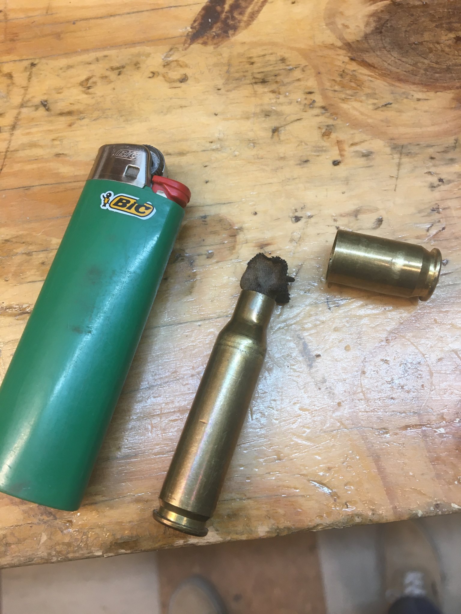

Nice! The benefit of the super smoker over candles, burning spoon, etc, is that it can be used to "touch-up" the FS on the firing line in breezy conditions vs the other impromptu sight smokers.
And not getting molten spoon dripped on your pants, rifle or worse, hand steadying the rifle.
Pea carbide should arrive this week from an EBay seller.
