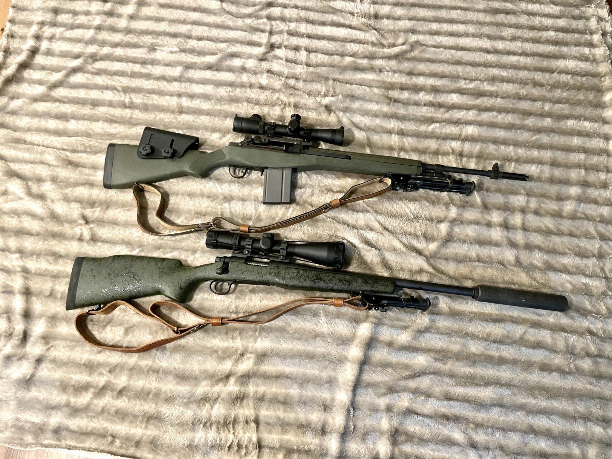

I have the sadlak steel mount and it attaches the same as the aluminum . I think you will have plenty of room adjust for eye relief . I forgot to mention if you have your irons zeroed count the number of clicks down to bottom and record that number so if you have to remove your optic you can still use your rear sight with the mount it's self still on the rifle and also pay attention to the direction you have to remove the stripper clip guide .tempImagevgDNev.jpg
I have the sadlak steel mount and it attaches the same as the aluminum . I think you will have plenty of room adjust for eye relief . I forgot to mention if you have your irons zeroed count the number of clicks down to bottom and record that number so if you have to remove your optic you can still use your rear sight with the mount it's self still on the rifle and also pay attention to the direction you have to remove the stripper clip guide .View attachment 7949879
What check rest is that? Is it mod to factory stock? Which direction do you remove the stripper guide?
The cheek rest is a karsten and yes I installed it on the factory polymer stock . You remove the stripper clip guide from the inside out .
