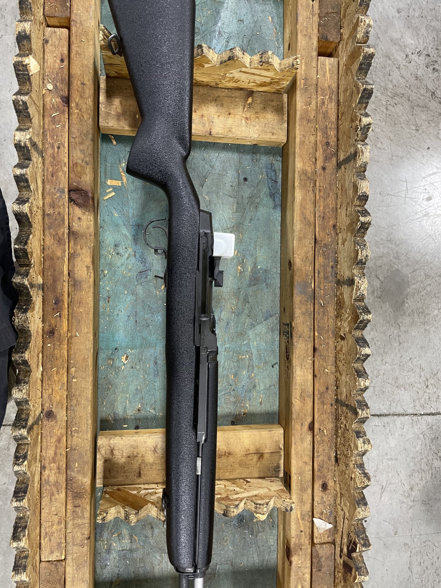

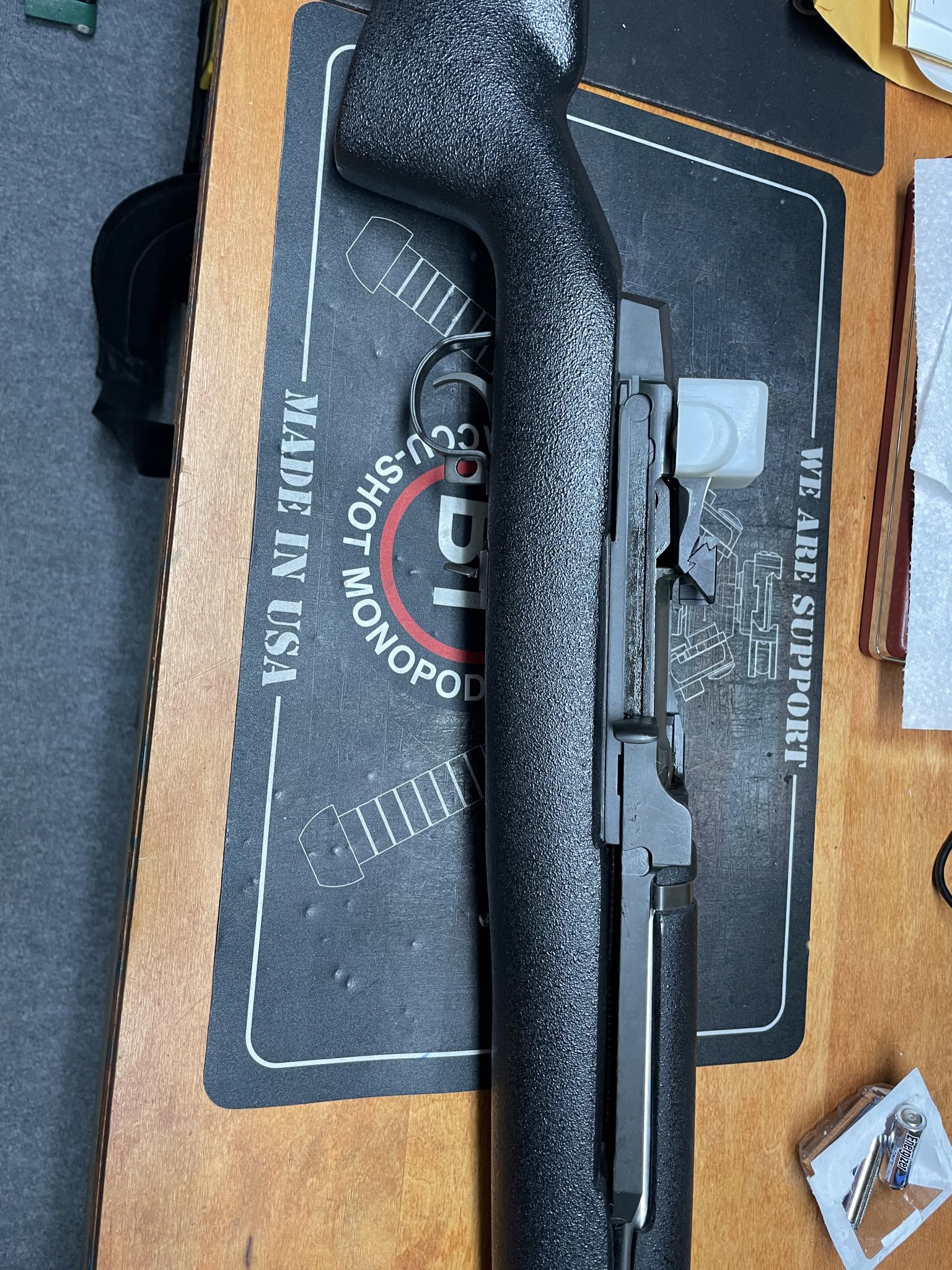

Hi, I picked this up new from a guy. Its a Springfield armory M1a super match. But, this one doesn’t have the black McMillan stock on it. It has a heavy black textured composite I’m guessing stock on it. It also has the butt plate from a m1 garand. I was thinking it was a T44E4 stock of some type?? All the T44E4s I see are wood. Is this a rare stock?? Any help would be great. Thanks. David

Have you called Springfield and asked them about it? When I called to confirm info about mine they were very helpful.
Supermatch stocks are quite chunky. They would also be bedded. The rear and front sights will also be a hint. Got a hood on that rear sight? I wouldn't go breaking it down just yet. Could possibly be a SM, never know......vague qustion and vague(r) pics...
Rear sight has a hood. The sights look/are correct. I have shown it to a few guys I shot service rifle with. Big M1a guys. They have never seen a stock like that. I’ll have to keep looking around for answers
Make sure you have a Super Match and not a regular National Match or "Loaded" M1A. If it doesn't have a lugged receiver, like the pic, it's not a Super Match. I'm guessing by that stock that you do not have a "Super Match".
Super Match

It looks like a Super Match or a custom build for Camp Perry / National Match shooting to me. Marines really liked lugging, Army not so much.
Check inside the fore end to see if it's painted. You'll be able to see the natural fiberglass texturing or milling. The shape at the "Balance point" in front of the magazine well is an indicator (different profile from GI wood).
The heavy pebble paint finish would have been appropriate for someone who doesn't want slippage while in position -- but it would get hot in the summer. The M1 butt pad simplifies set-up since you don't need separate butt pad, door, and hinging butt plate.
Reactions: camocorvette
Check to see if it is bedded.
The palm swell on your pics, isn't "normal" for a run of the mill M1A stock. The palm swell is certainly more match like.
Maybe some thing like this McMillian, but with a pebble texture added ?... https://www.uscollectorsordnance.com/product/m1a-m14-mcmillian-composite-fiberglass-stock/
Can you post a few more pics of the whole stock ?

I have it at work. I can post more pics of it tomorrow.

They DO come with over-sized wood stocks, too, so you have to check the fore-end channel and receiver bed to see if it's wood or fiberglass.

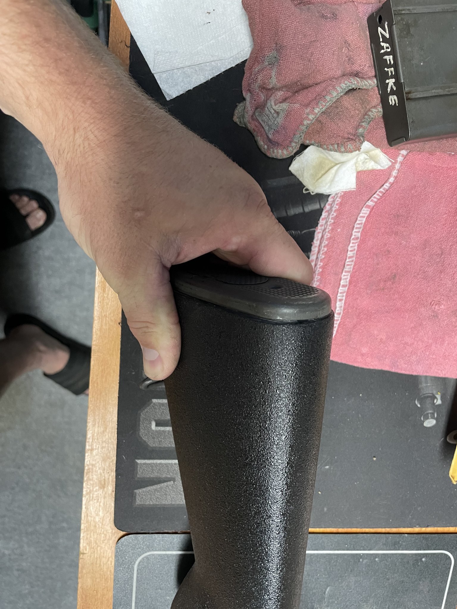

Here is a pic of it. It is bedded and the stock doesn’t appear to be wood with a textured finish.

Can't tell because of the textured exterior finish. If you don't separate the action from the lower, open the butt plate trap door. Do you see wood grain, fiberglass, or is it smooth? Painted or not routed out?
In the magazine well, is it wood grain, fiberglass, or smooth - painted over?
Behind the trap door it is smooth and painted. It feels and sounds like fiberglass. The mag well has a stock liner that bedded into it. There is bedding going to the bottom of the mag well.

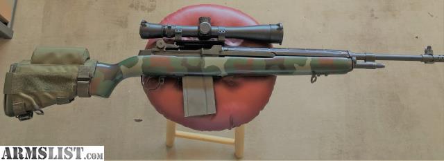

I would call springfield but it looks like a non-mcmillan fiberglass stock to me. There were a couple other companies making them but I cannot remember the names.
Here was my old one from the armslist ad I do miss it a bit. The grip area on the mcmillans I've seen are different than OPs:

The only other thing I can say, to check without drilling or scraping to confirm whether or not it's wood, is to remove the trigger guard and inspect the stock internals from there. You don't have to separate the upper from lower -- just pull the trigger guard from its rear stop, rotate the guard to fully open (to unlock from the receiver), and pull straight out.
It appears it was assembled and finished well -- no shortcuts.
I did that before I bought it. To me and a few others. It looks like fiberglass. I have to call Springfield
