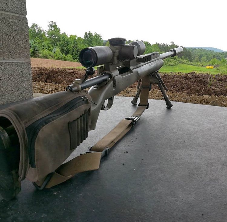

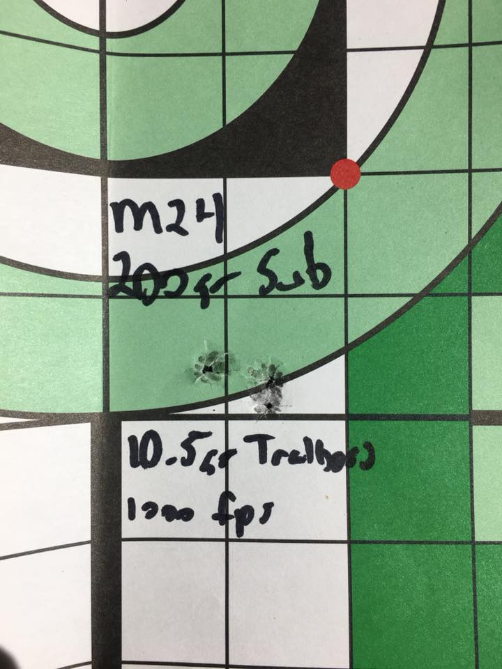

Hi All,
Shooting subs in a slow twist 308 can be tricky. At 11.25", my M24 "shouldnt" work with most heavy 30cal bullets. However, I got some 200 gr lapua subsonic bullets and through some trial and error found the sweet spot. The load is below as are photos taken from a 90 yard group.
Case: Once fired from Federal 175 match
Bullet: Lapua 308 subsonic (part: 4PL7060-Lapua )
Powder: Trailboss at 10.5 gr
OAL: 2.801"
Primer: Winchester
Velocity: 1000 fps

The Lapua 200gr grain subsonic bullets are much shorter than typical 200gr match bullets. As a result it does not require as much of a twist to stabilize them at slower velocities. Compare the same load using a 200gr matchking and see what happens. I can get 220gr round nose to shoot really well subsonic (1,050 fps) but 220gr MatchKings keyhole with the same powder and velocity in a 1:10 AI AT.
Finding a decent SS load is a challenge. It looks like you are off to a great start!
Good info! Yea im not going to try much else since I grabbed a bunch of those 200 sub bullets. Id try a 220 round nose if one of my friends uses em, so I can grab just a few.
Wally,
Based on the group posted you will struggle to get a better result than what you are already experiencing. Now go out and shoot a deer with that load ... really fun and works really well.
