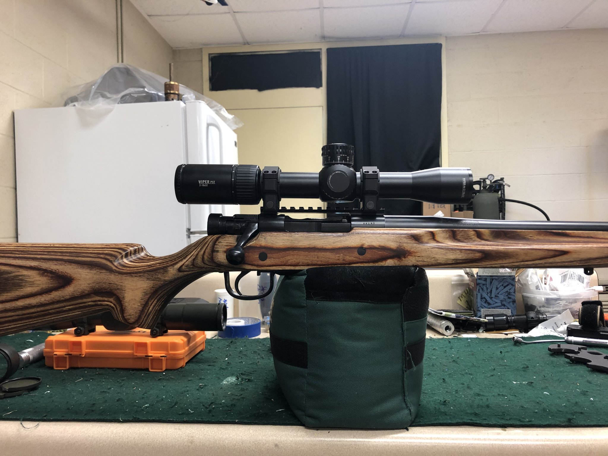

    This was a drilled Bubba mauser

    I replaced a butchered stock, added a timney trigger to gain a safety and changed the old weaver scope it came with to a nikon that was sitting around. Less than 500 not counting optic. Shoots better than it should out to 600 yards

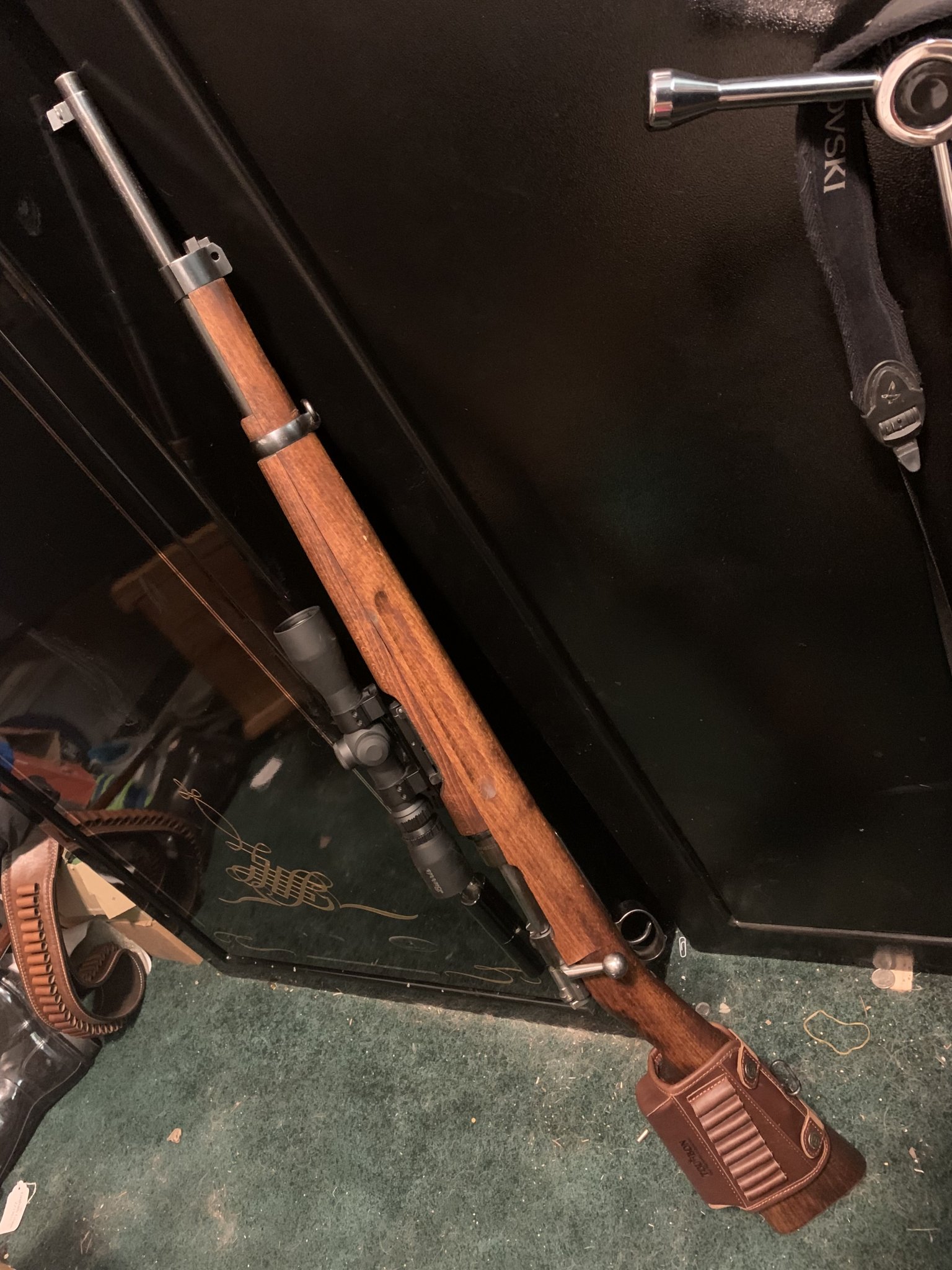

    Another source for Swiss M41 parts is Simpson LTD. The have a significant quantity of rifles that pass through in all conditions plus parts in separate lots. Take your time and I bet you can put a nice rig together that suits your needs and budget.
    Here’s my M38 Husqvarna (1942) with a BadAce mounted Burris 2-7 SS and Traister 2lb trigger. Shoots great!

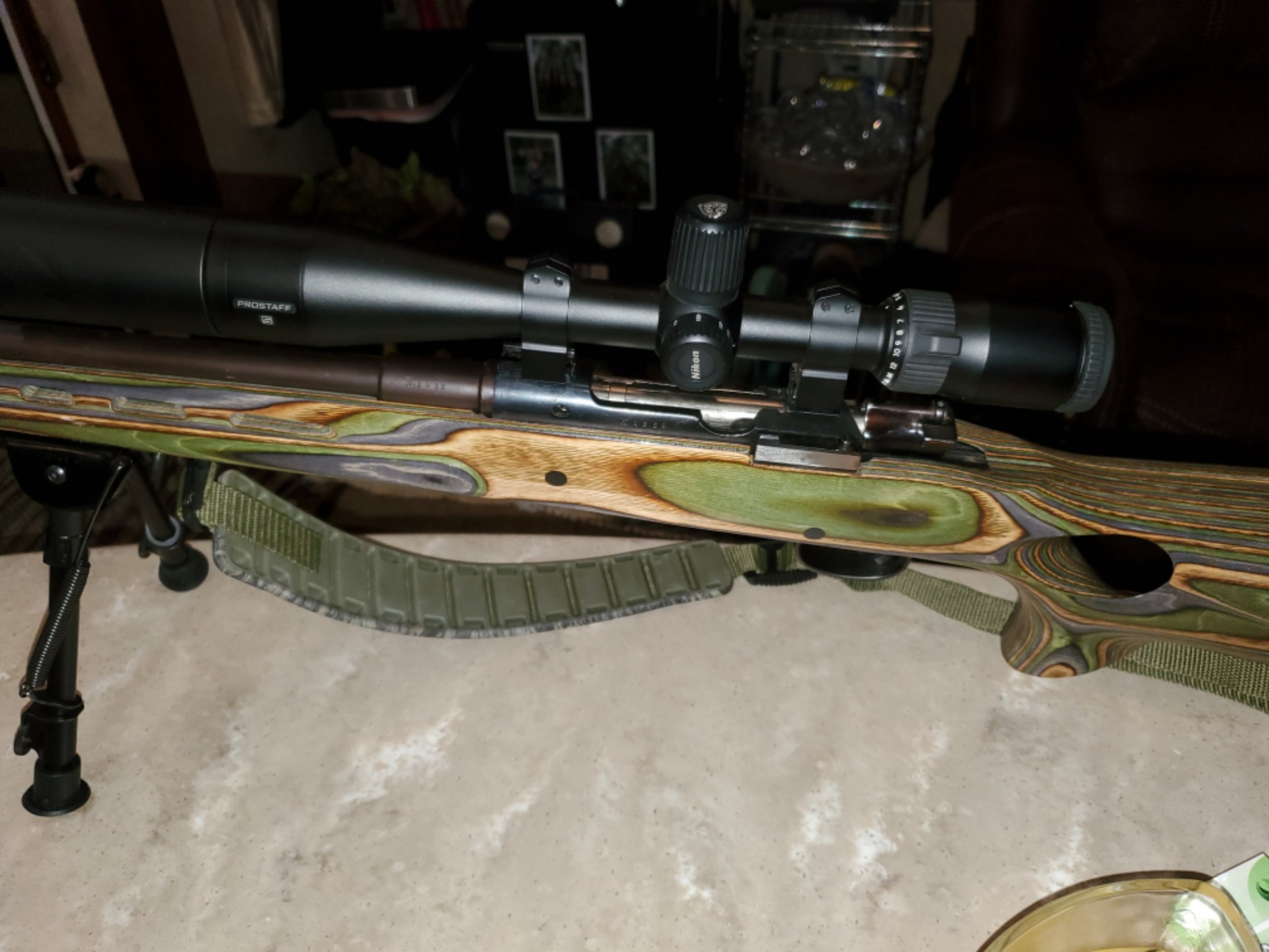

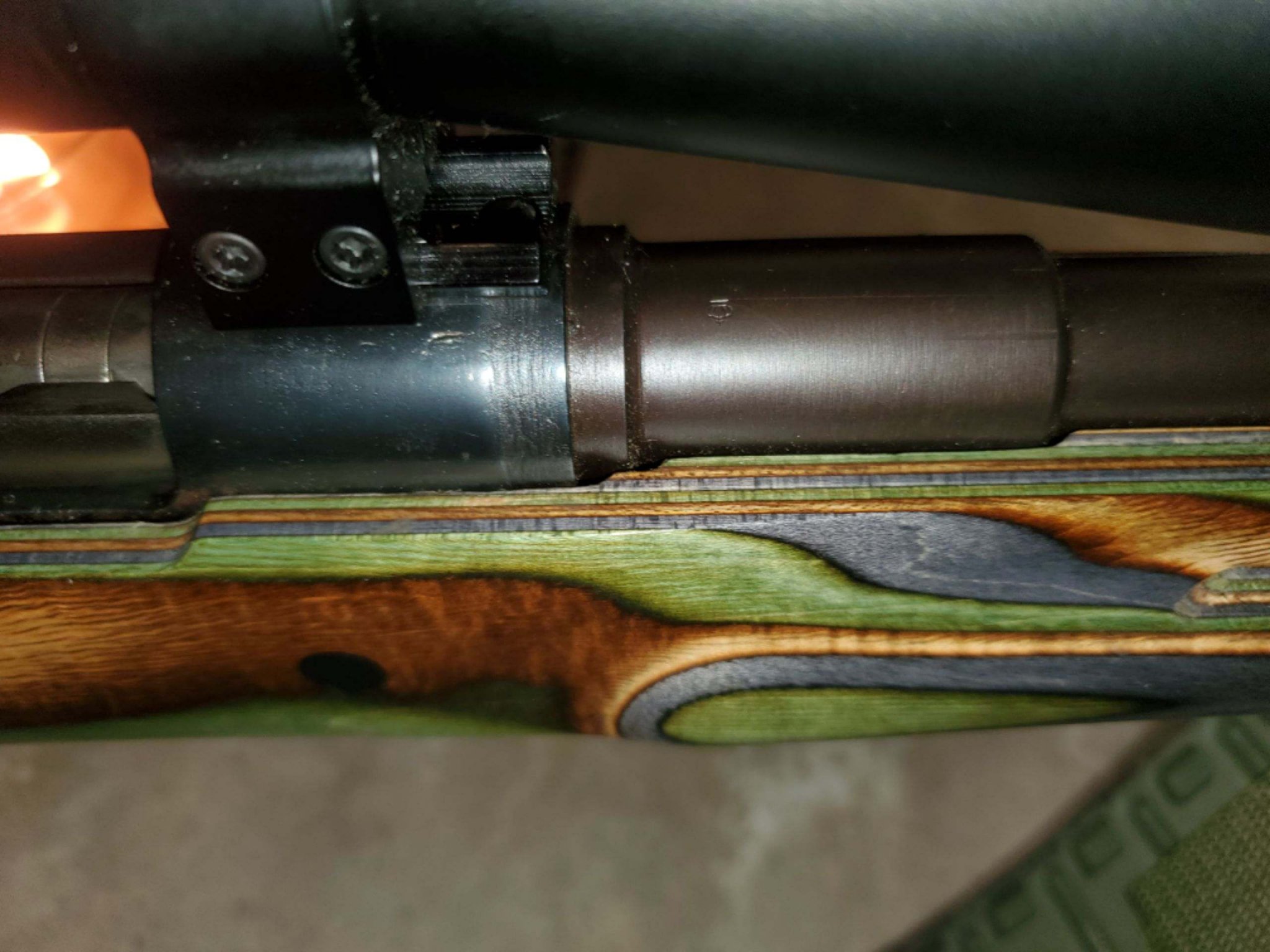

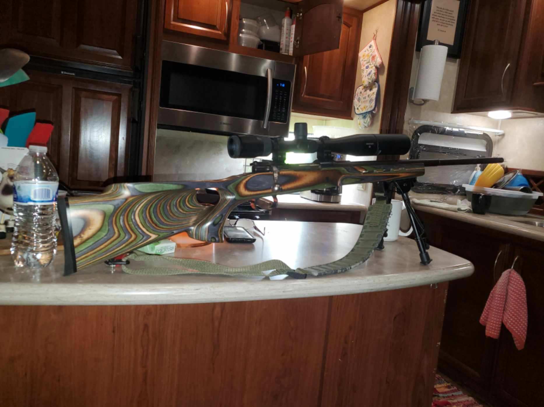

    Almost done with my fun Swede build. Should have the low profile Warn mount Tuesday. The rail and old strike fire red dot will be gone. Got Trijicon RMO HD going on it. The idea is to have it mounted as low as possible so I can use the iron sights for longer distances.
    The ballistics are quite impressive with lighter bullets and the short barrel. Accuracy will be determined later next week.
    Changed his name from "The Mutt" to "Jan" since its really about 70% CZ made components. Its also an non-binary, gender fluid name so todays snowflake cry babies can be offended. Obviously this is not a vintage anything but just something fun and possible.

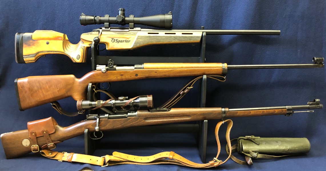

    Fwiw, here's three Swedes, modern Tikka at the top, middle is a 1917 M96 converted to a CG-63 target rife in 1969, and bottom is an 1900 Mauser converted into an M41B, presumably in WWII (scope is dated 1941), updated in the mid-1950s to the "B" configuration. Repo leather cheek piece came out of the UK. For the record, the modern Tikka is a half-MOA rifle, and will easily out shoot the older rifles, but I like the patina of the old-school stuff.
    Fwiw,
