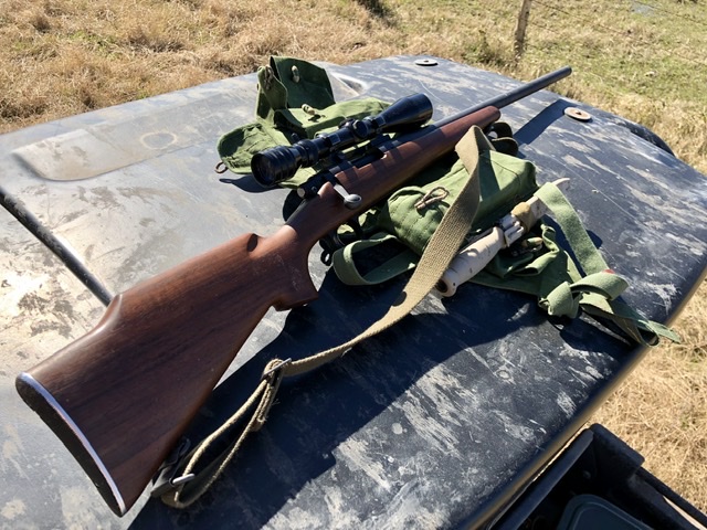

My clone is 1/12, buts that due to the factory sps varmint action/barrel. Haven’t shot at 500, but it does work at 2.
