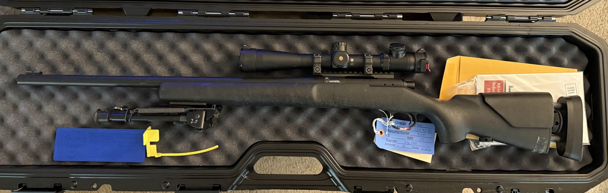

Bought from CMP, not as sexy a history as @USMCSGT0331 's but it's mine. We already talked on another board and it was probably a USAF rifle originally.
Real 7 digit M40 with original barrel. FOIA says it was turned in to Robbins AFB in 1978, was issued to a couple ARNG/USAR units, and then sent to the AMU in 1985.
When there it acquired an HS Precision stock and bottom metal (gen 1, ugh), Harris bipod, and Leupy MK4. Scope is an N suffix, so built in 2005.
What a long strange trip this rifle has had.
Link to CMP photos.

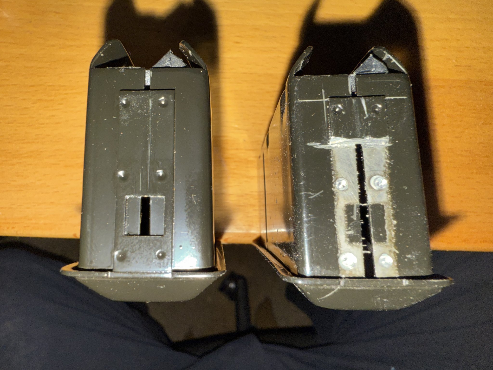

Since HS Precision gen 1 SA mags are near non-existent, I ordered some Kwik Klip mags because someone somewhere said they would work.
They're the same exact design. Only difference is where the mag catch latches.
Yes, I have a dremel. 🥸
Left is a KK mag out of the package, right is after cutting the rib to the proper length and drilling out the 4 spot welds.
