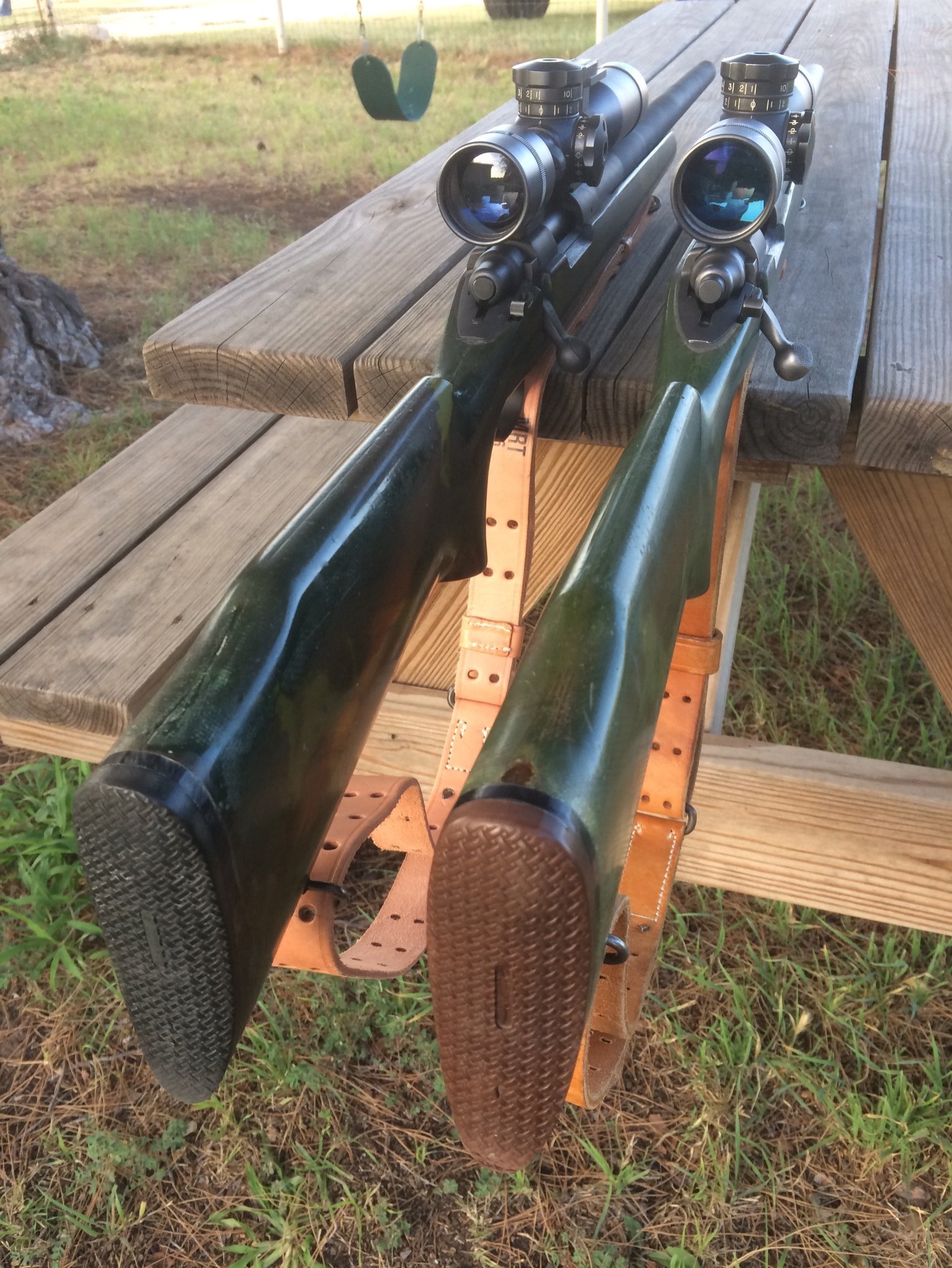

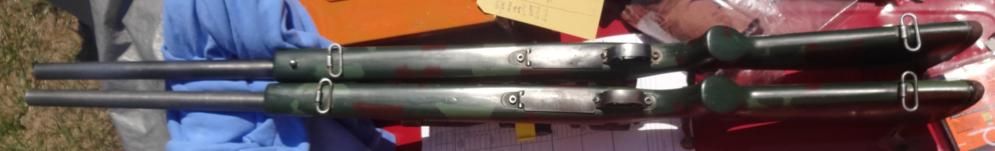

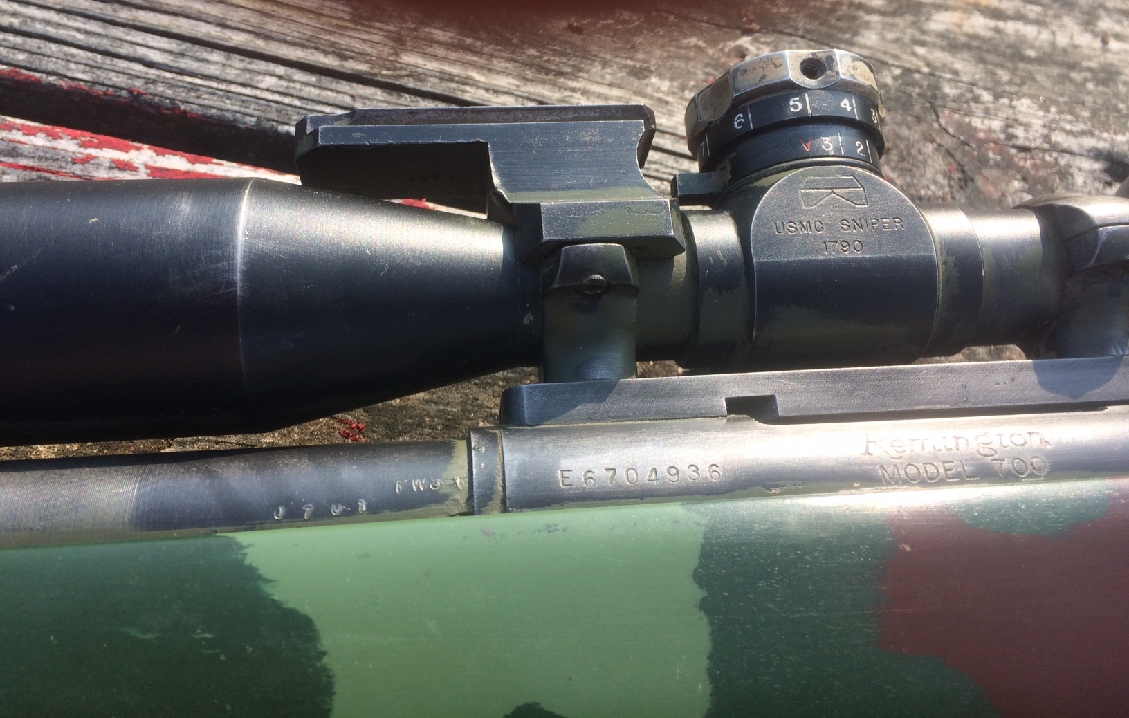

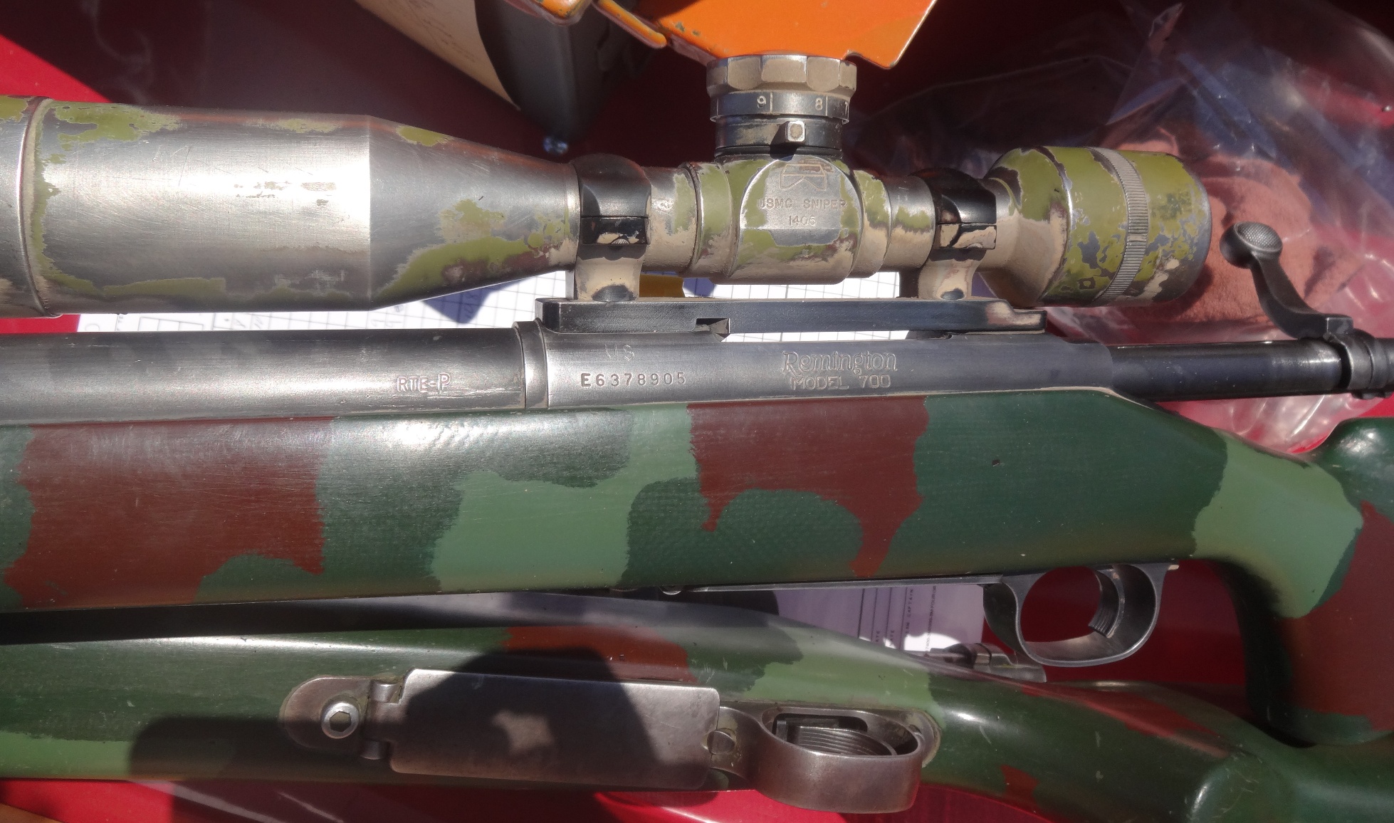

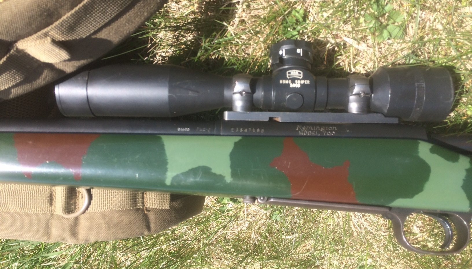

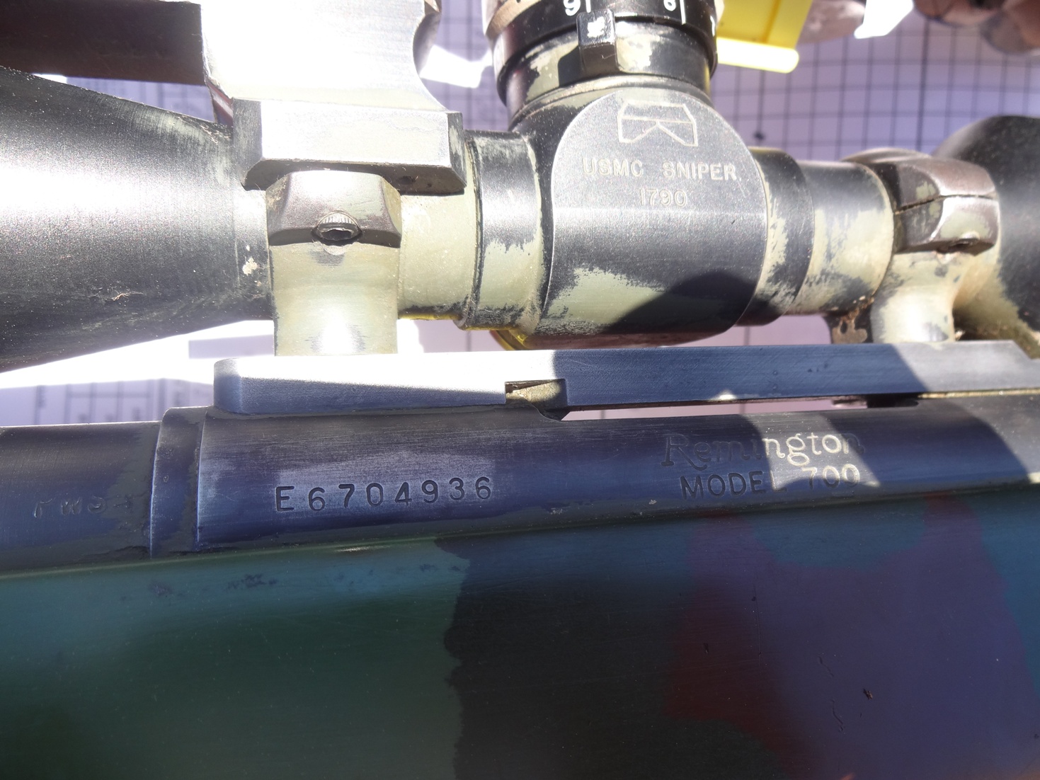

    I don't have much to add, as you can go either way, as noted above. If it makes you feel better, I recall 3 or so E-prefix M40A1s at Quantcio vintage rifle matches. They all had woodland camo pattern stocks. For example, here's some pics from 2016 and 2017 that I took of a couple of them. The first pic has an "RTE-P" barrel stamp with no date, and another E-prefix has a "PWS-P" stamp with a July 2001 barrel date. Fwiw, the E637xxx also had a hand inscribed "US" above the serial number, as seen on random C & E prefix M40A1 rifles. It's scope was serial #1405, but those got swapped a bit. The last pic from 2018 is not in good focus, but it's an E prefix, woodland stock w/ black buttpad, a PWS marked barrel (can't recall date stamp), and a USO scope too...
    (Many of these M40A1s often had interesting, small variances, and as seen in the 3rd pic, one of these E-prefix rifles I nicknamed "Mr. bipod stud.")
    Good luck in your decision, and I'm sure one of use would be happy to buy what ever M700 receiver you end up not using, in case it's a surplus item.

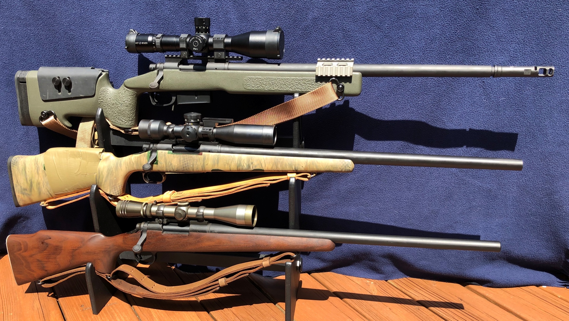

    I stopped at these 3 M40 replicas, but if I were wealthier I'd consider an M40A3 w/ a CMP Unertl 10x just to close that gap. The M40A6s are neat, but I'm more old-school I guess. (M40A1 is a C-prefix, top and bottom are G-prefix). I'd like to build a 6-digit rifle as well one day, just haven't gotten around to it, given that I bought a 'turn-key' Chuck Mawhinney replica back in 2015 that I will use on occasion at the matches. If I ever found a smear M40A1 stock I'd certainly build a six-digit rifle around it....so it's sort of a bucket list item for me.

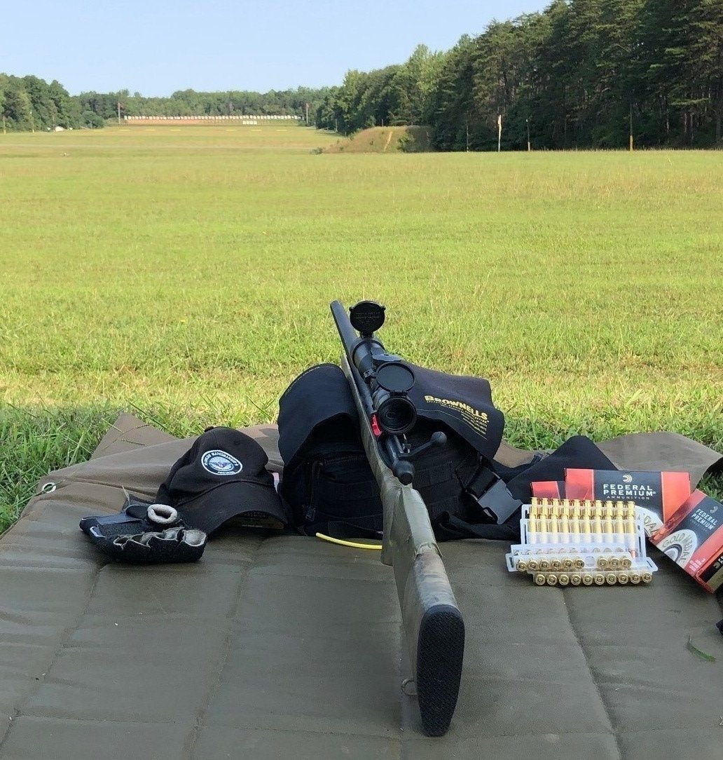

    I used my M40A1 in Sept 2021 at a Quantico match for the 800 and 1000 yard event, so mine get used too...

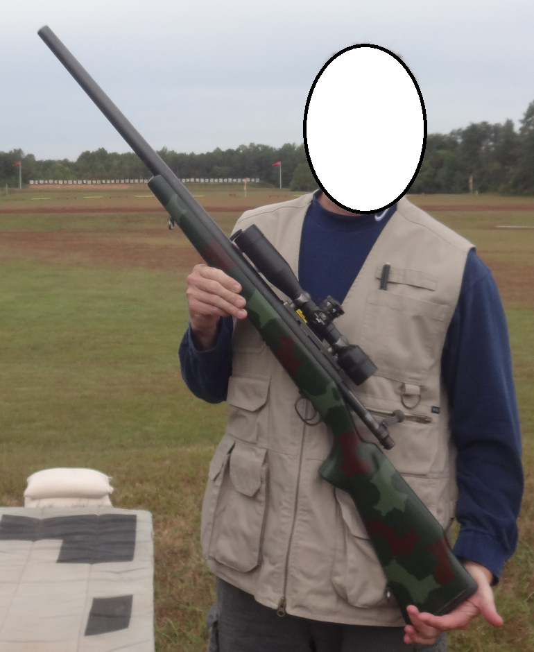

    For example, here's a random dude holding one of PWS's spare M40A1s back in 2015, that he may have nicknamed "Mr. black buttpad"....
