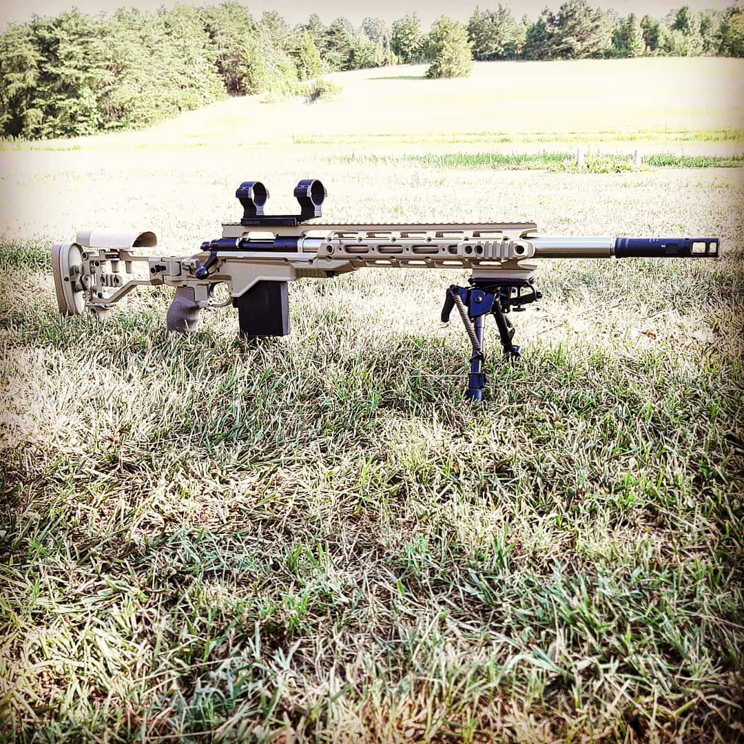

    Been slowly accumulating the parts for an A6 build...something i swore id never build but here we are. The wife wanted me to have something she could shoot on occasion and didn't like my other 308s so this will be done in 223.
    -RR action
    -Badger A6 lug
    -Remington RACS chassis
    -Bartlein 5r .224 8 twist
    -Surefire brake
    -Larue lt840H-34-0
    -standard Walker trigger tuned to 2.25lbs.
    -UID sticker from Carolinalaserworks
    Going to top her off in a ATACR 5-25 f1 illuminated with T3. Been seeing the majority of photos coming from there west with these instead of the S&B.

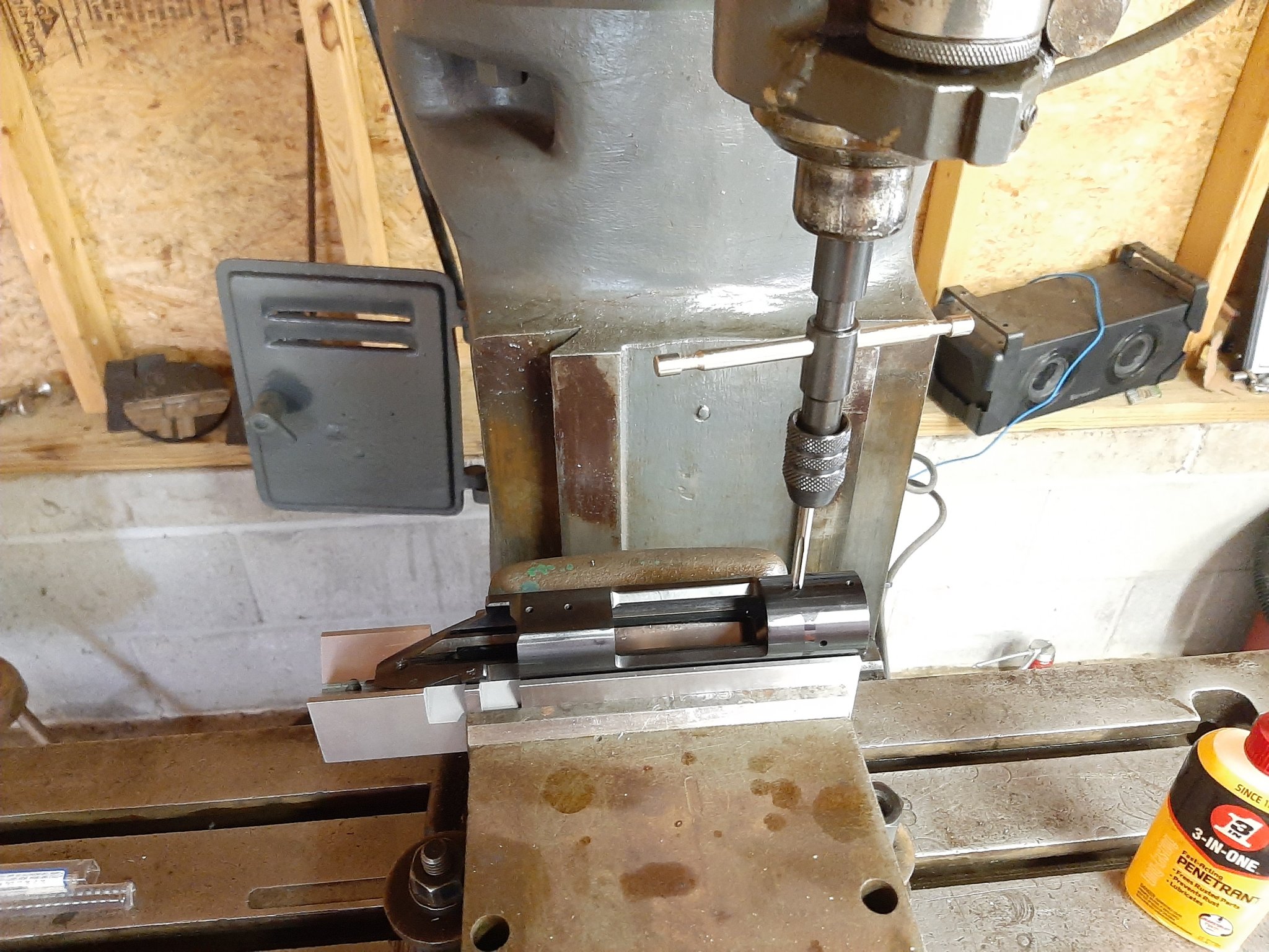

    Started to get pics of the fake lug slot but only got one. E and G prefix actions had the full lug slot from the A5 days but the new RRs they use only have the bridge flattening, thumb cut and 8-40 screws.
    Hoping to slap together there rest of the barreled action in the next month or so. Might have a house move and all my machinery would need to come as well so TBD.
    Most of the pics i received show the same markings as the A5 series and will follow that process.
    Anyway, will update as the build moves forward!
    Following. Whats that tap attachment you got in the mill? Looks like it just holds the tap in line and you turn by hand?
    Yup, its a guided tap meant for this. Keeps the tap aligned straight when running it in.
    Oddly, the front 2 and very back screw holes were spot on the remington spacing and inline. the 3rd screw hole (back of ejection port) was slightly off center and a gnats ass hair forward. Weird how only one hole rebelled.

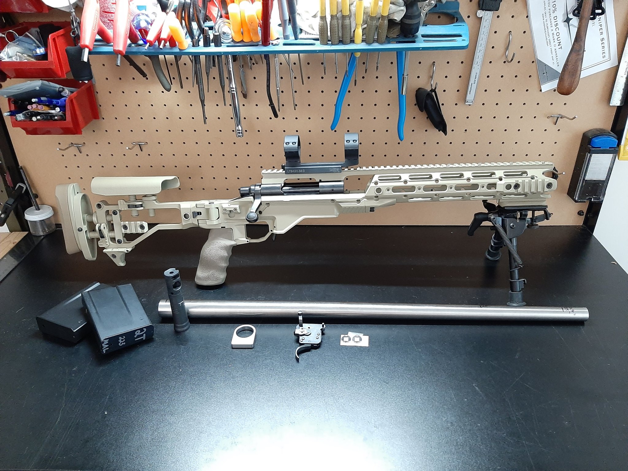

    Welp, wife asked what i wanted for my birthday and i said a day alone to finally put this together.... and the good wife i have gave me what i wanted. Just wondering when she will finally come home :unsure:
    Anyway, she went together great. New RR action and badger A6 lug age fit like a dream in the RACS. Front tube/mount block needed tweeking since the asshats to manufacture it did it incorrectly. My guess is thats the #1 reason the rails bend and bind the action when torqued.
    Only put 1 proof round down but going to work some 77 RDFs and 77 TMKs and see what she does.
    I only marked the pws-p and last 4 sn on the handle and lug. Couldnt find any proof its stamped anywhere else. If you have info please let me know!

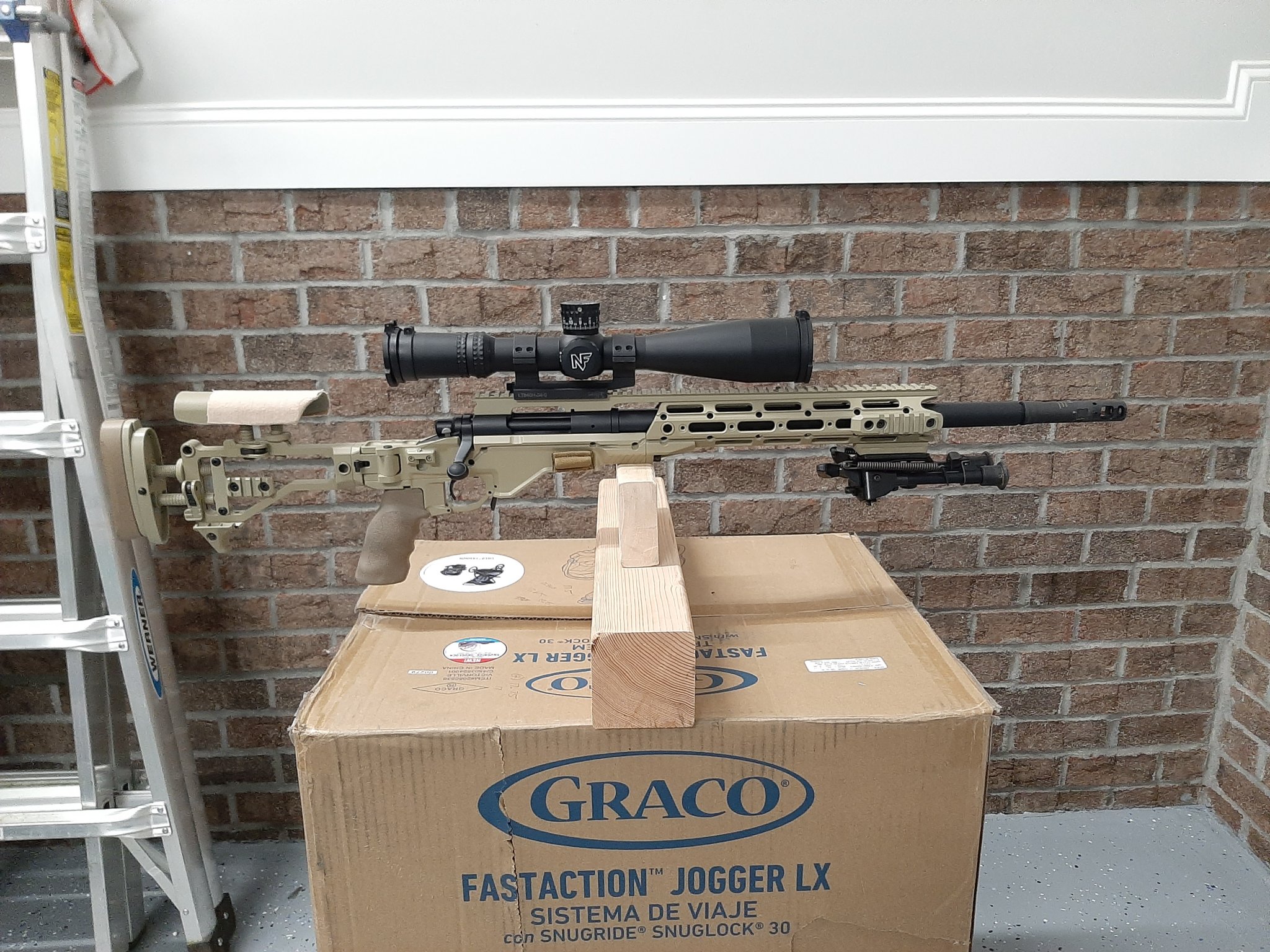

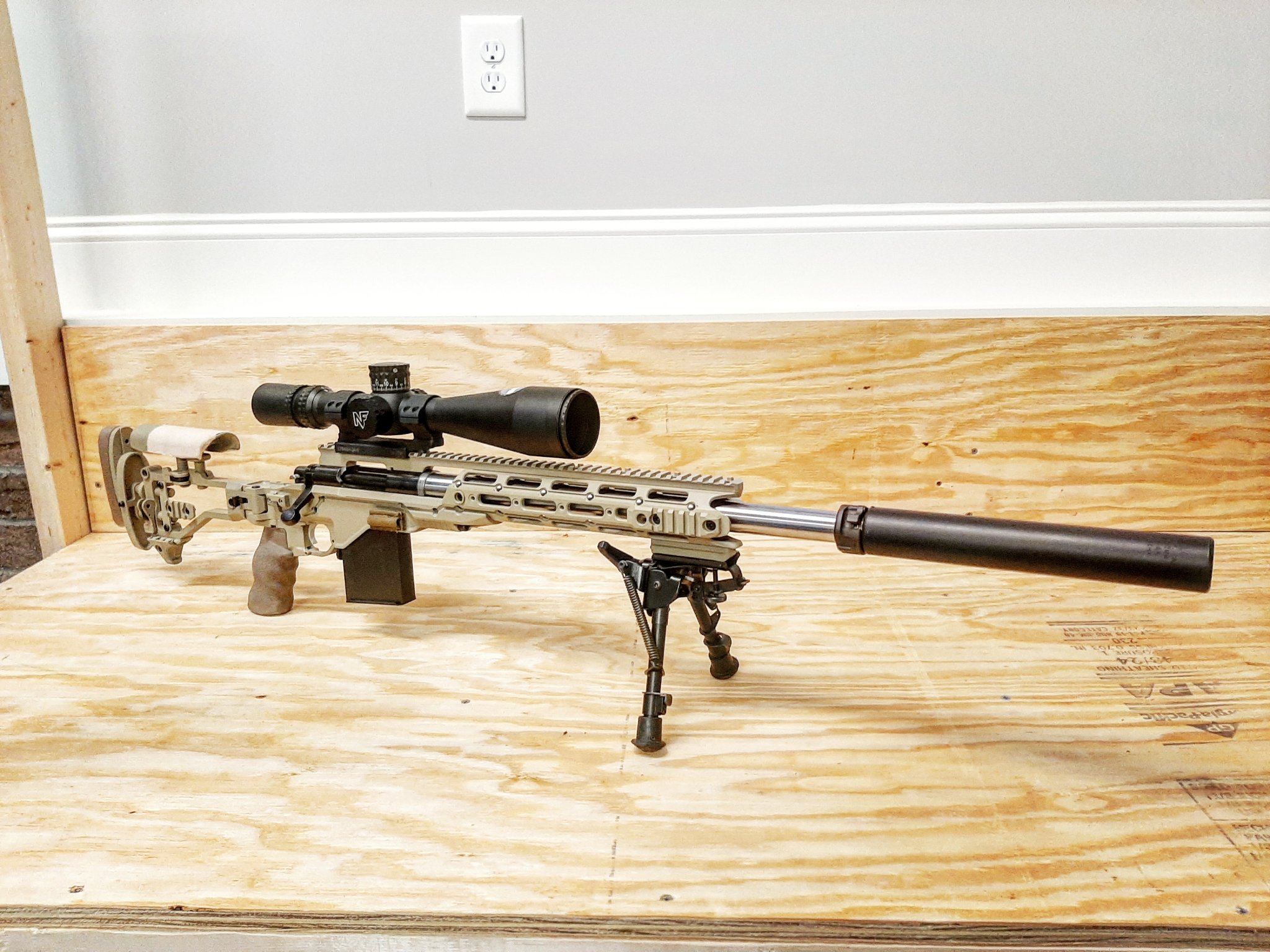

    Can't believe it was 7 months ago she got built... finally got the scope in and mounted up. Hoping to do some pressure testing this weekend so I can really start load development. Also going to spray the black oxide on and get her proper looking.
    Can't say yet if I like it more than the A5 but I'm going to hold out judgment until I run her through a match or 2.

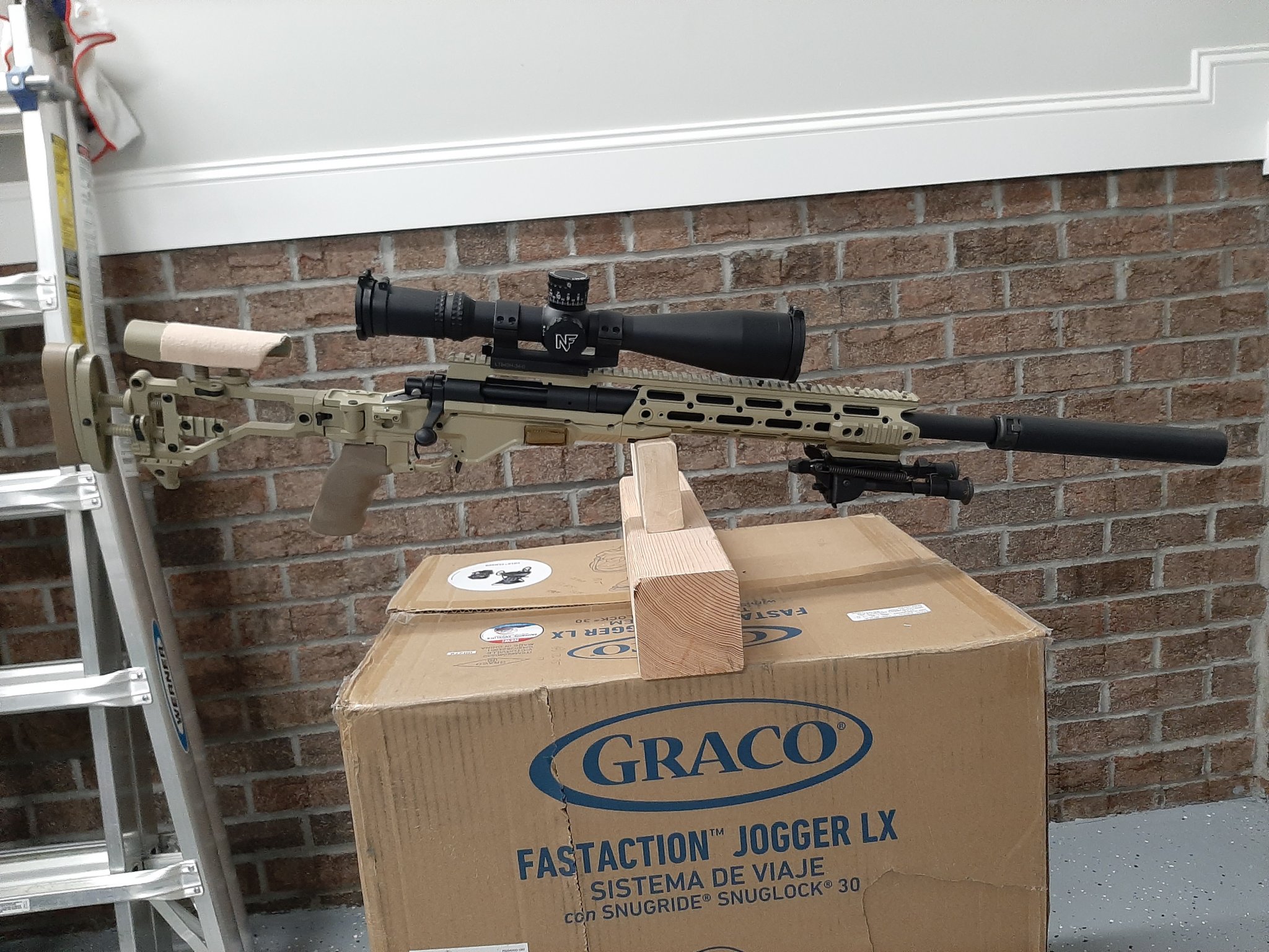

    Sprayed a little black oxide today. Not setup for actual oxide but maybe down the line if I can start drumming up clone building business. Hope to have my FFL in a few months and specializing in clone builds.

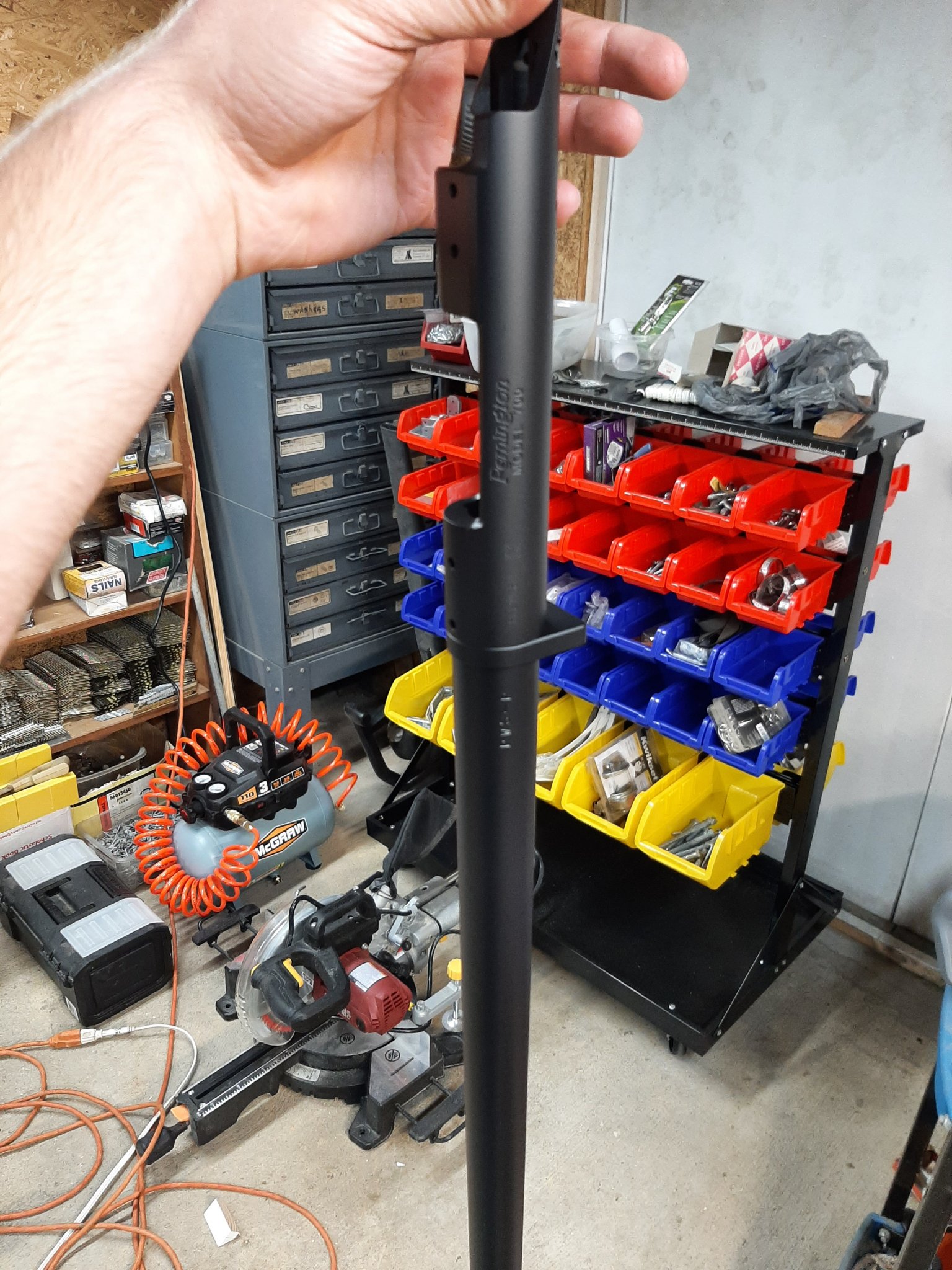

    Still have a strong urge to grab some krylon and paint up this chassis like some of the west coast dudes. Its pretty painful thinking of painting a $2k chassis though. Krylon will likely win out.
    Two photos of the paint scheme.

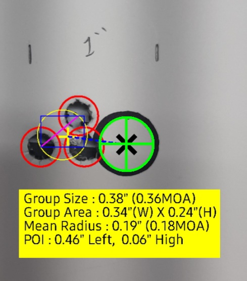

    Started to break her in and I'm pretty pleased. 5 shot group is rounds 11-15 and the 3 shot is rounds 25-27. Both groups are factory black hills 75gr. Did some pressure testing and will start an OCW in a week or 2 to prep for her first match in mid May.

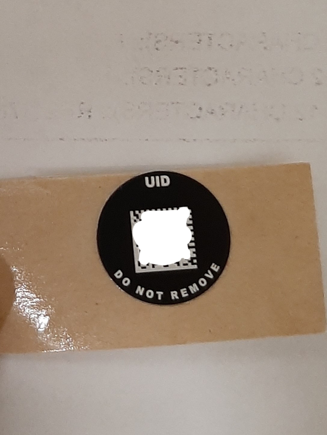

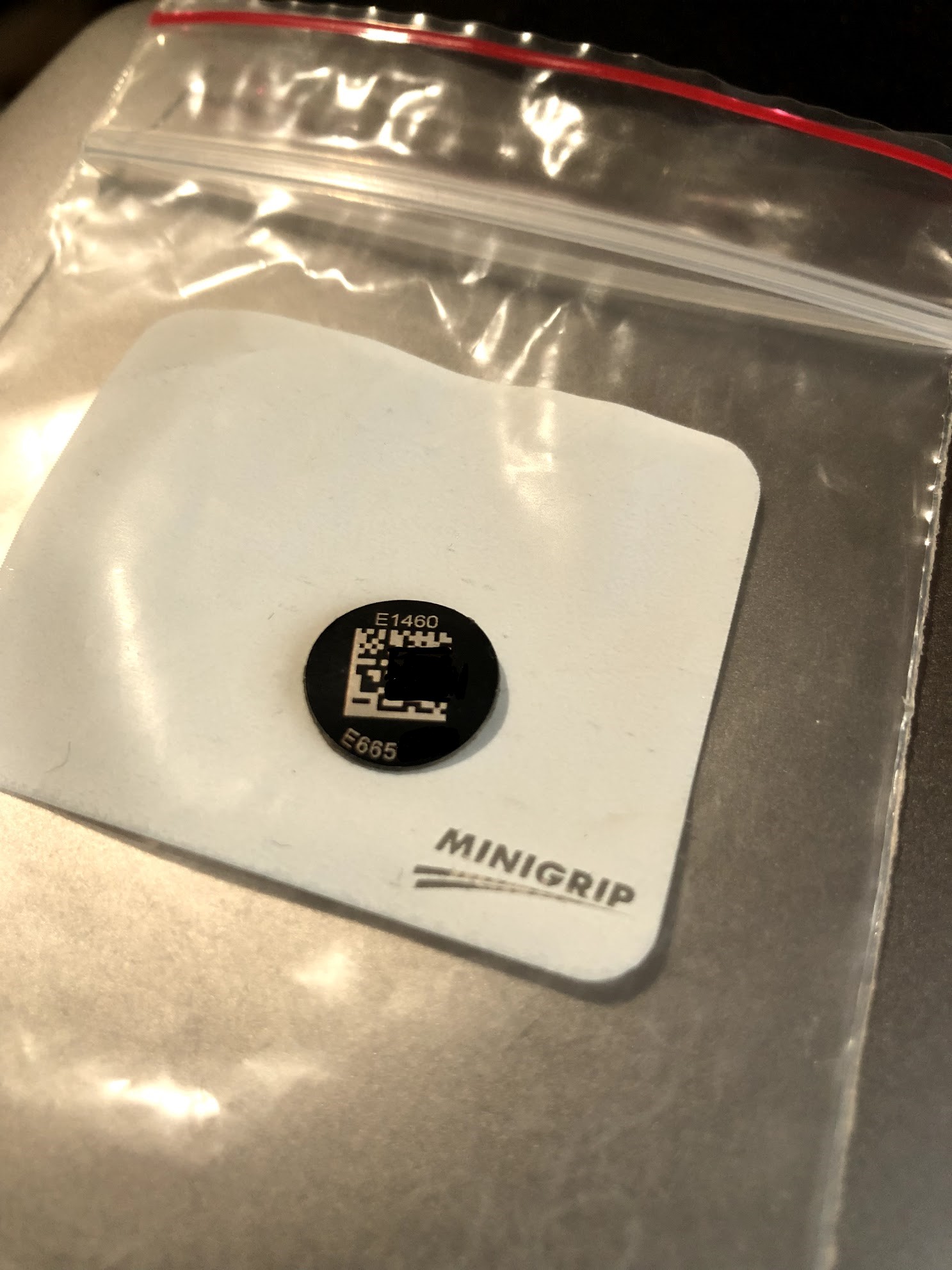

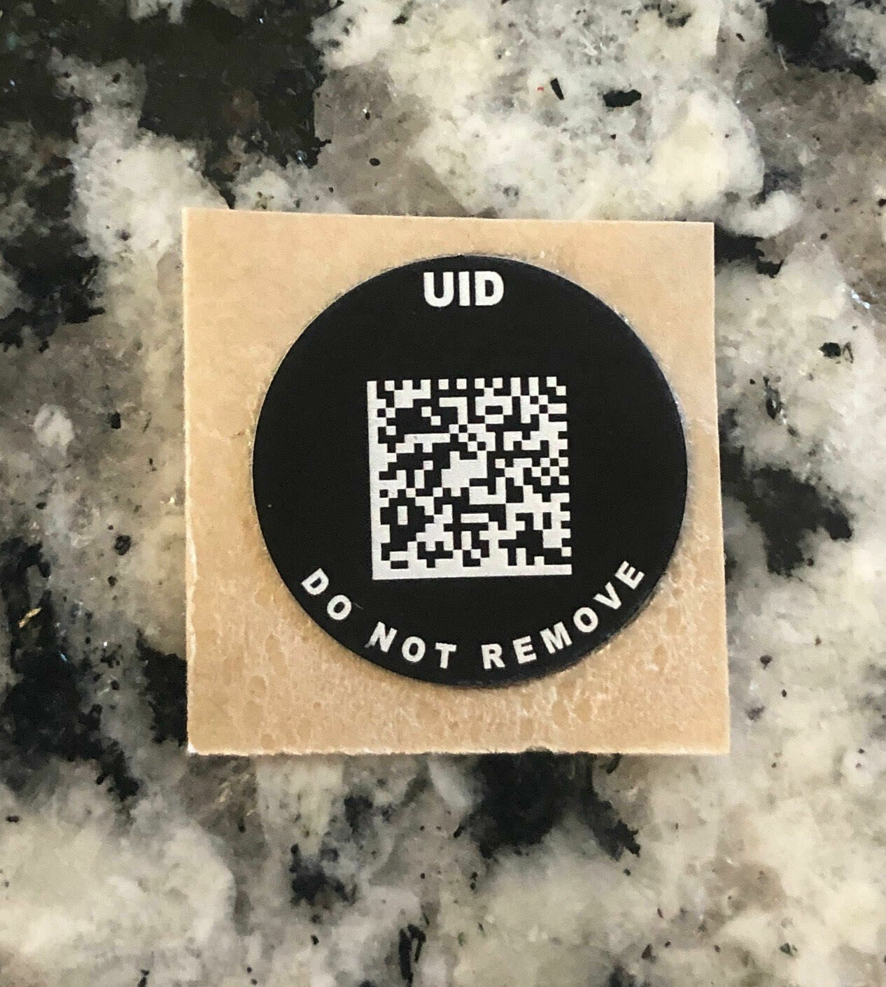

    So this is the UID tag I got from CLW (blurred out the QR part). It does NOT match the photos I have from one in fleet example. The in fleet example I have shows the receiver SN where CLW has "do not remove" and above the QR code where CLW's says "UID" it looks like it says "E1480" on the in fleet example but it's a bit hard to make out.
    It also is not pre curved to sit flat on a remington receiver. It takes nothing to do some light bending over a screw driver shaft to match the curve though.
    I'm going to be emailing CLW and seeing if I can get one made up to match the in fleet example better.

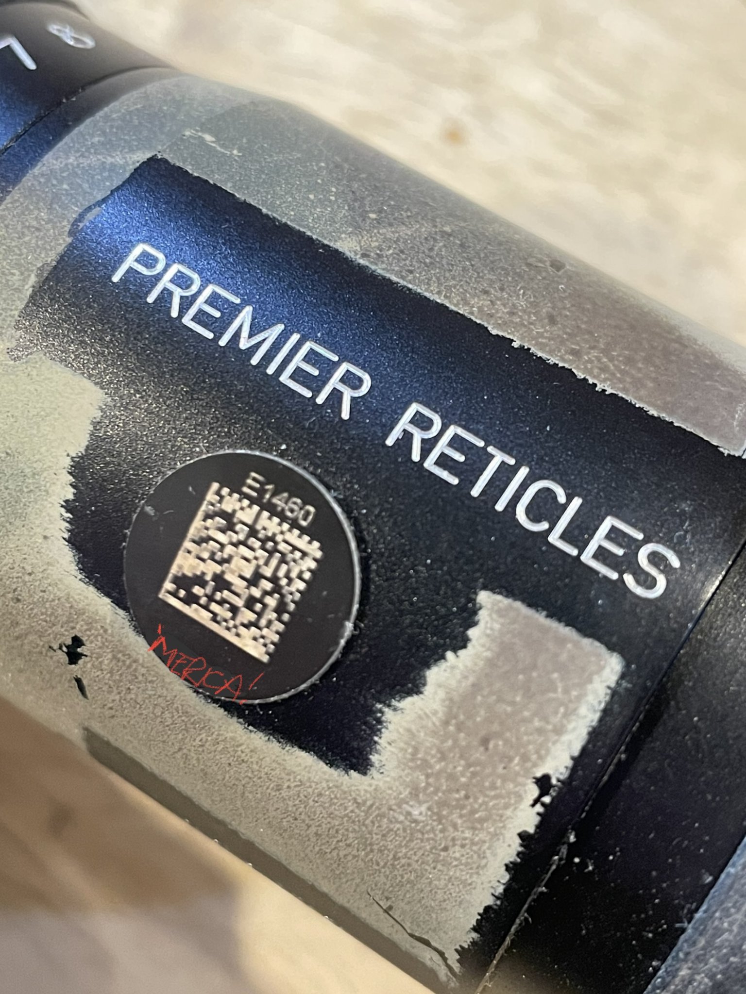

    Thanks for the info! Here is the eBay source I mentioned: https://www.ebay.com/itm/M40A5-M40A...ine-Corps-Sniper-rifle-m82A1-dm-/124383928433 . I can’t provide a recommendation for them either way as I have not dealt with the seller before. Hopefully CLW will be able to customize it. They have been recommended by a number of folks in the AR clone community so I’d probably lean in that direction.
    That's the one I was looking at too. Seems to have the weapon S/N on the bottom but I'm not sure what the top one is for. Maybe weapon system identifier?
    Yeah I’ve looked at a number of pictures that read E1460 on the top. Did a google search for “e1460 m40a5” and there are a couple gov documents that say it’s some kind of inventory number for the M40A5 rifle.
    Reactions: Nate87
    I think it may be the identifier. I have to check my notes what the identifier was in my QR code when I did a bunch of research.
    E1460 might be what my in fleet example says. It's hard to make out that 6 vs 8. Curious if e1460 was the A5 of the e1480 would make sense to be an A6.
    The number at the top of the UID for the M40A6 is E14607M and called the TAMCN number, or Table of Authorized Material Control Number.
    I have no idea why the number changed so much and why they added the M at the end.
