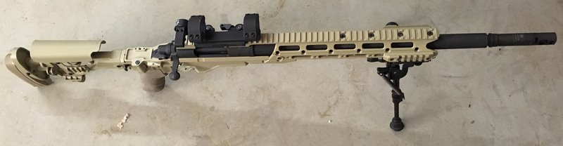

M40A6 PICS added! A handful of people have asked for my opinion on M40A6. I am not a M40A6 Subject Matter Expert but I am fortunate to own them. This review is only my experience. I have not personally seen "EVERY" or "ALL" the USMC M40A6 rifles that the USMC has built. Don't take my experience for doctrine, do your research. This info is what I have physically seen and believe to be the truth. NOT info I "heard from a 2112". The phrase "a 2112 told me" seems to be the norm for validating a usmc sniper rifle claim these days. All this is solely my opinion based on personal experience not hear say (unless otherwise noted below). No 2112 has coached me on this write up. This is purely my opinion based on my own practical experience with this system.
I sourced the parts to complete my BA over a long period of time, arduous and frustrating. I posted some photos but I will not be posting photos of all the components. These parts are incredibly difficult to source. Youtube has 1 video of the A6 from a trusted source. Beyond that be careful what you read online see photos of and accept as gospel. There are some photos out there that show the rifle in configurations and colors that are not USMC spec. Some photos are of test rifles, vendor displays and civilians rifles. Some are posted for personal gain and have no historical significance. Others simply misrepresent the USMC M40A6.

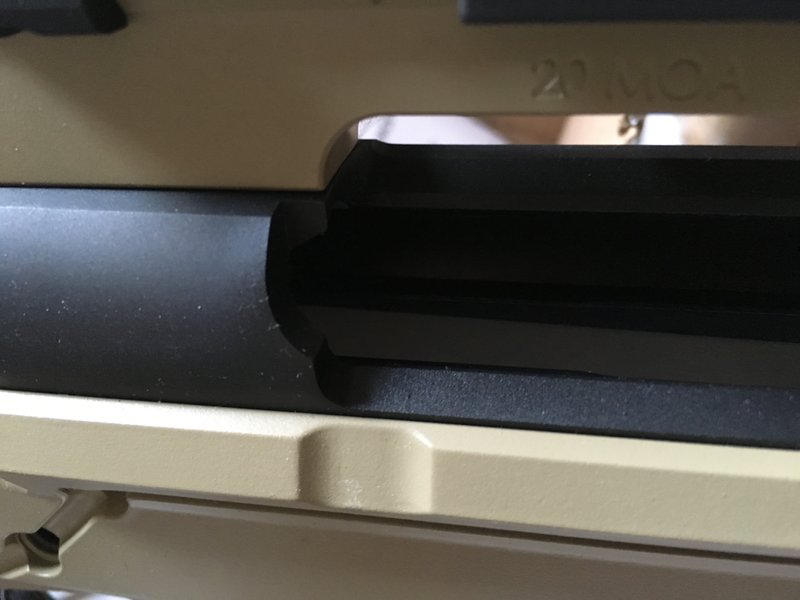

Action
Remington 700 SA (trued & slotted). The new style slotting is not typical as used on M40, M40A1, M40A3 or M40A5. The slot on the A6 is limited to the ejection port relief cut and rear action decking. There are no lug slot cut outs. The chassis does not have lugs that fit down into the receiver as did the optical platform on M40A1, M40A3 and M40A5. The M40A6 rifles that use older M40A3/M40A5 (E, G series) actions will still have the original LUG slotting that will be phased out as those actions get relieved of duty and new ones in service. The new receivers that the Gov't is using are RR series actions. The bolt is marked on the handle and RR serial number actions will have a letter at the end of the serial number.

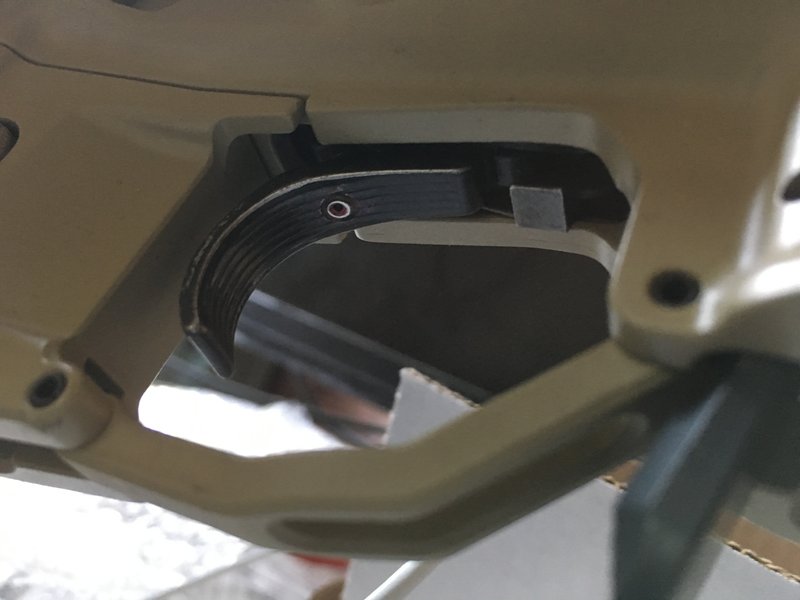

M24 Trigger
The Remington M24 trigger is still being utilized by the USMC on M40A6. There is a photo out there that shows an A6 with a different trigger installed, the reality is that the USMC still uses the M24 trigger on the M40A6.

My opinion on M40A6 is that it is a not overly impressive but a capable weapons system. I do think it is easy to pack and conceal when the suppressor is not installed. The weight difference is not substantial enough to justify saying it has an advantage over earlier systems. The Scout Snipers that I know who are currently employing this system tell me they like it. Most of them are young over achievers who have limited experience with other USMC sniper systems. These snipers are proficient and capable with this systems regardless of their previous experience. In all fairness they know all the systems they have been trained on and they seem to love them. Understandable, I am grateful and respect those who are doing gods work with the tools the USMC has provided. I find the system incredibly comfortable when shooting. It has good ergonomics and is a solid platform to shoot from. There have been accuracy issues in the past but like most Remington 700s the weapon is more capable than most shooters ability out of the box. These HIGHLY tuned weapons will likely out perform the enthusiast shooter. I am not a fan of this chassis systems or any other one. They have too many functions for my taste and are easily hung up on other gear. With that said, as far as chassis go, the M40A6 chassis is as good as any if not better. It is a cool looking weapon but mine will surely stay in the safe most of their life as I prefer the earlier weapons systems, particularly M40A1.

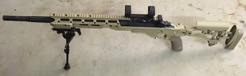

Here are the pictures I promised. This gives the viewing public a good idea of what the gun is when its done. I am not dedicating a USMC issued M8541 scope to this gun as I don't plan to use it much, probably not at all. If you have questions and I can help you with your M40A6 project, I will. TEXT, EMAIL or contact me through TheHogsDen.com for fastest response.
This M40A6 is 100 percent USMC SPEC pedigree quality. Has ALL the correct parts and part numbers as used by the USMC. It cannot get any closer to USMC issued to this without purchasing from the DOD.
Bonus is the RR serial numbers are being used on this system, the action has the ejection port relief cut out but no lug slot. RR actions are fairly inexpensive and available. May be worth having one slotted and set on the shelf for a future project. [IMG2=JSON]{"data-align":"none","data-size":"full","src":"http:\/\/i68.tinypic.com\/zx0hw5.jpg"}[/IMG2]
