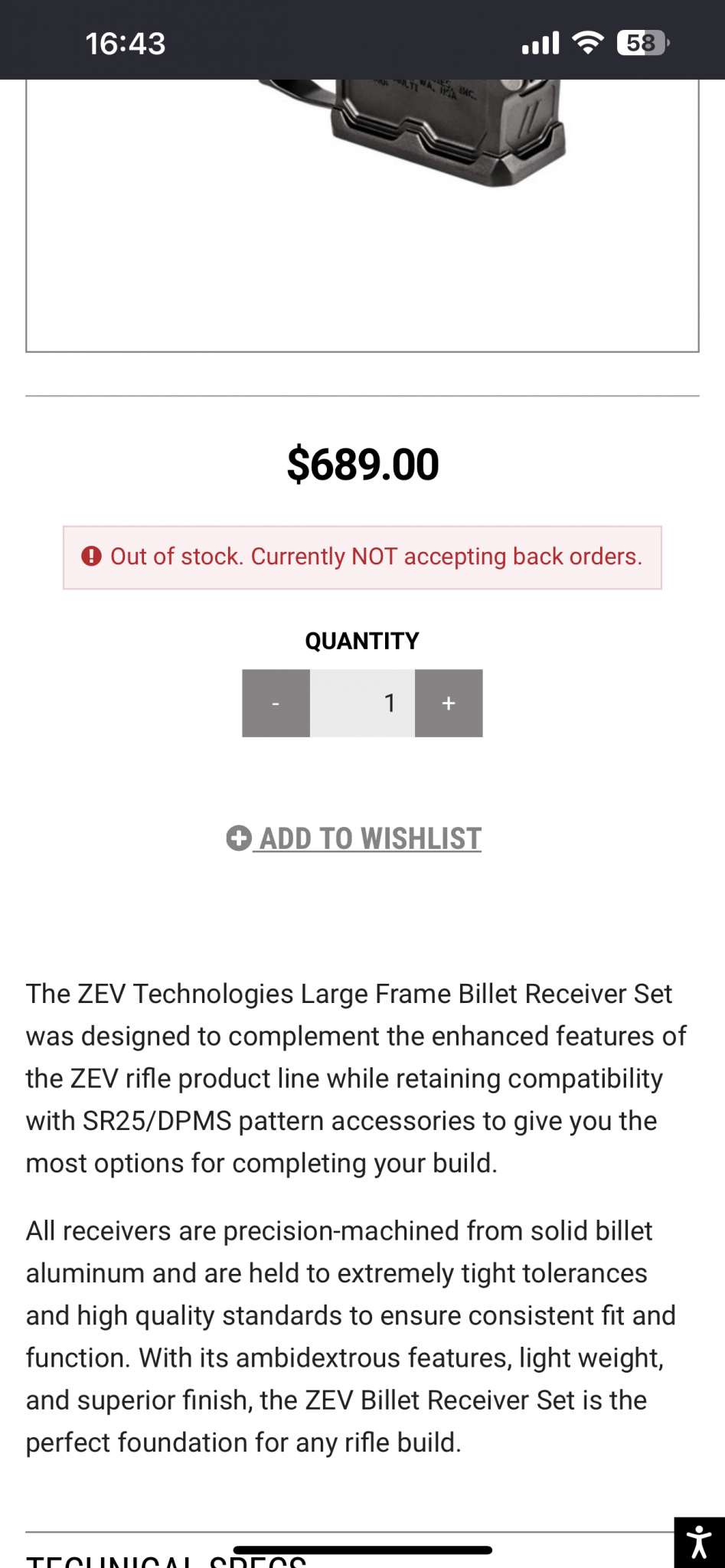

Zev is my go to.
The Zev large frame is SR25 pattern and is not compatible with DPMS LR-308.
OP. I strongly advise against mixing manufacturers of uppers and lowers when building a large frame AR. I believe that your intention is to use an Aero upper, so stay with the Aero lower or start all over. As far as Aero receiver quality, Compass Lake Engineering uses the Aero M5 Enhanced upper for their precision builds. It comes down to the builders skill and the rest of the parts selection when it comes to reliability and precision.

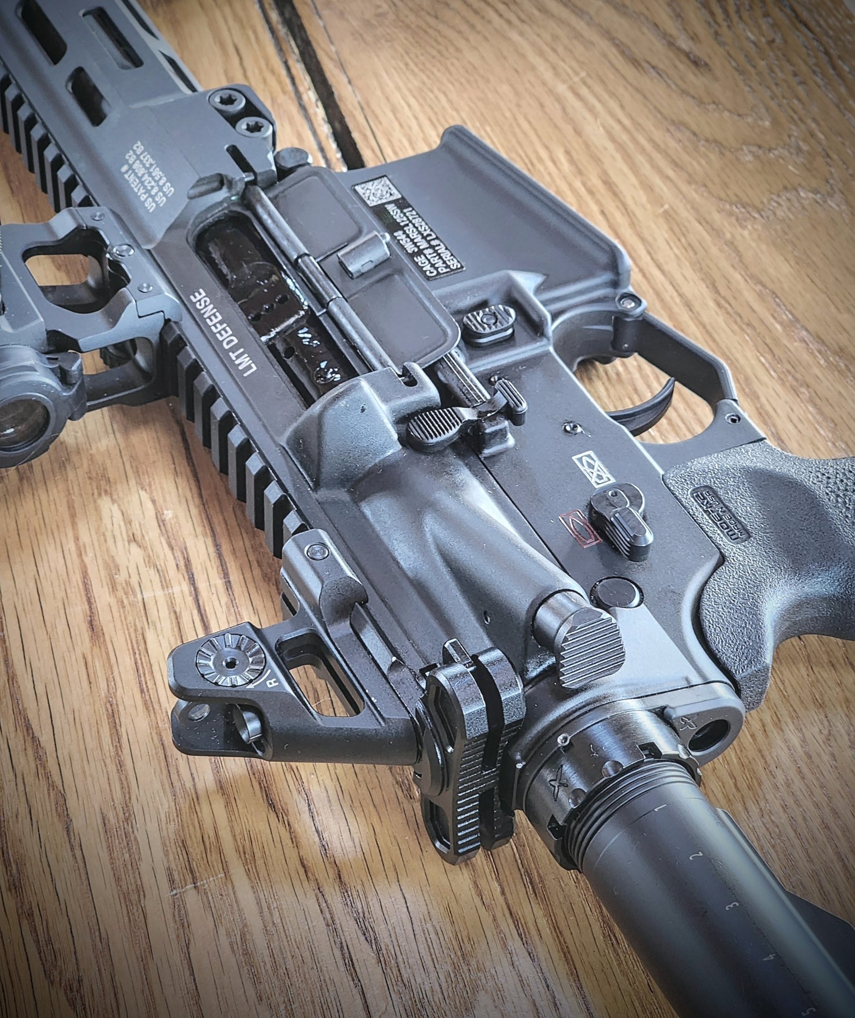

I am gonna claim my "newbness" and ask what LP and FCD are?
Not who you asked, but LP = lower parts FCD = Forward Controls Design
Although the person you asked posted a picture of an MARS-L 5.56, FCD does makes some parts for large frames in addition to AR-15's, and many parts will work on either platform. They are regarded as one of the best.
Forward controls design? What is the difference between a LPK and the forward controls design? (Learning something new right now)
Meme aside, FCD doesn’t make the right side bolt catch/cam/lobe mechanism so you’re stuck with at least 50% of LMT’s bolt catch levers; ain’t no fixing that pot metal.
