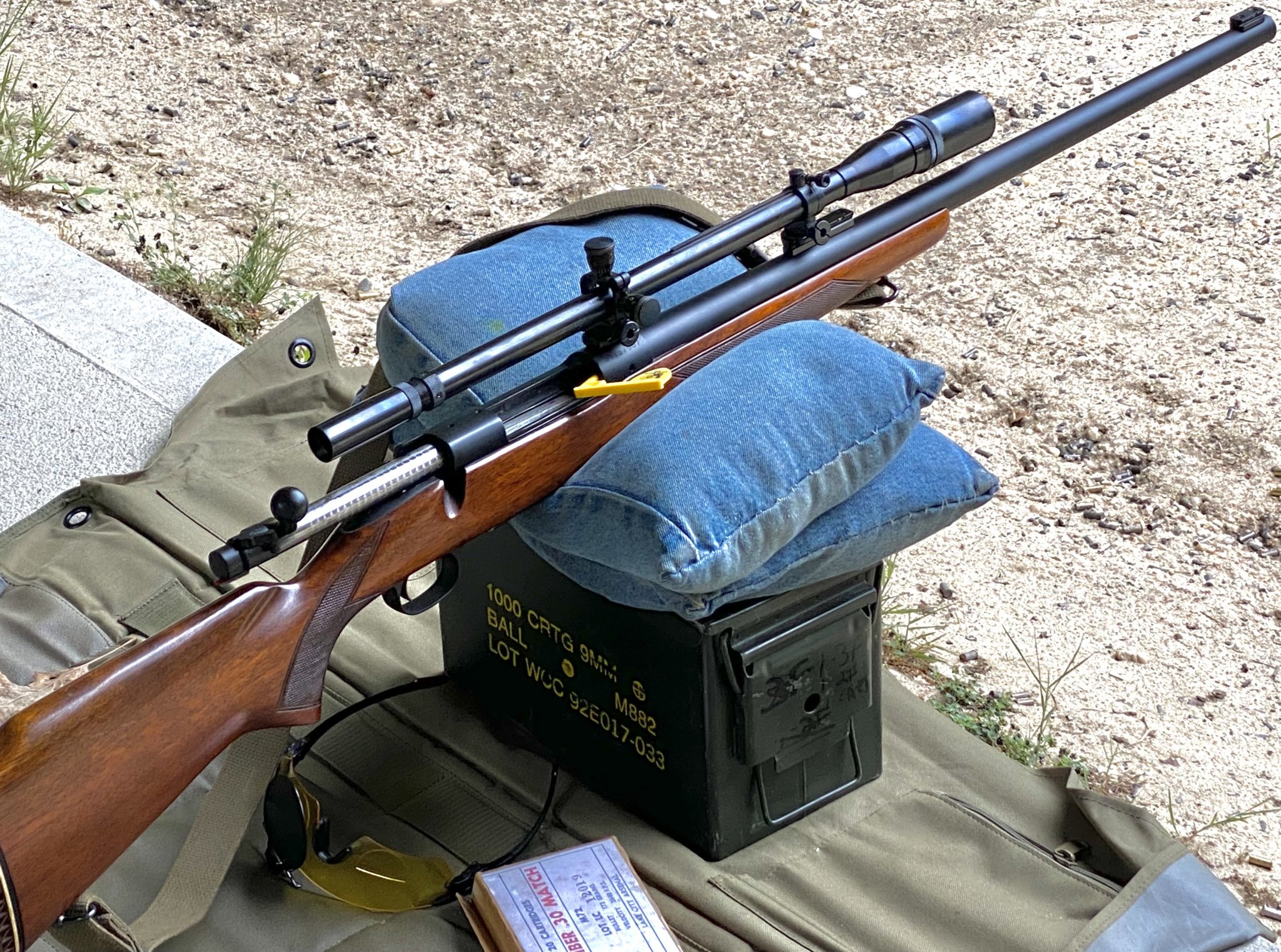

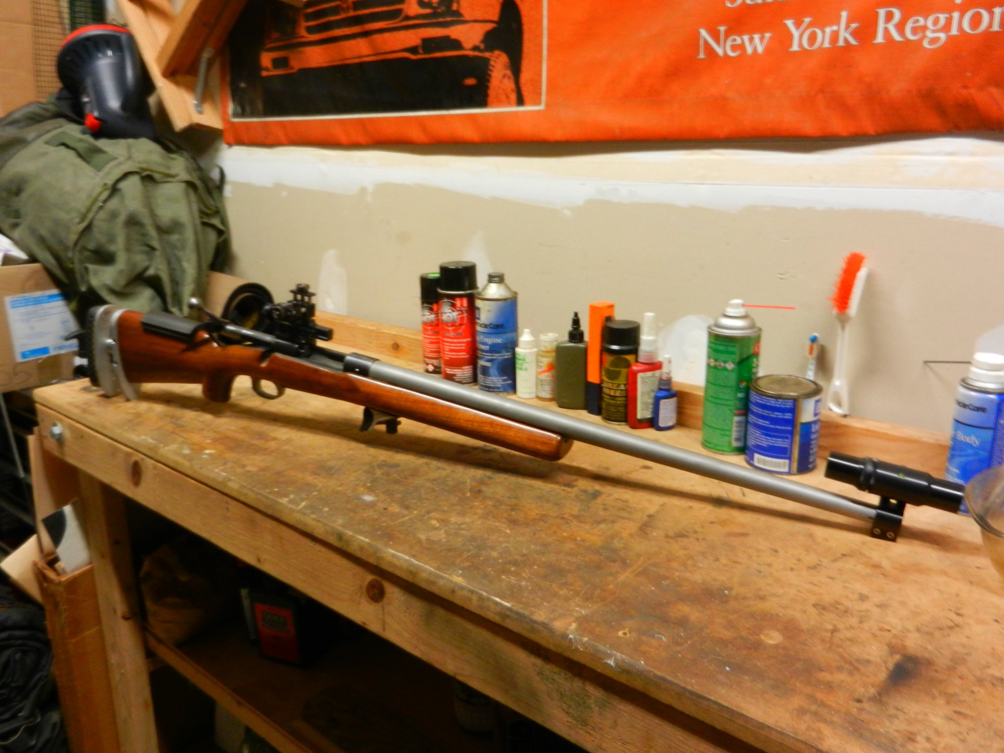

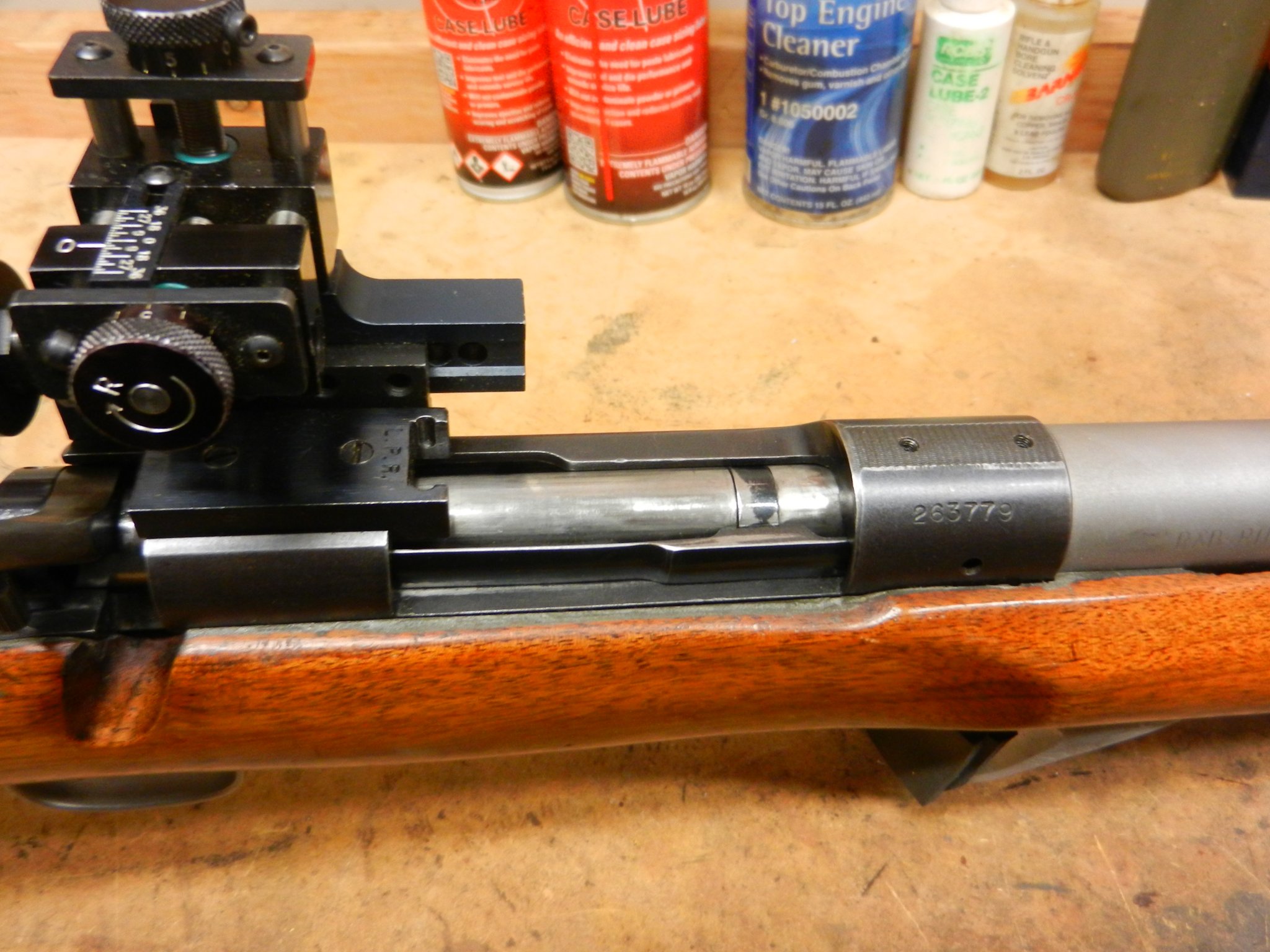

I have a pre '64 70 that was first built by Larry Racine in .308. When I got it the barrel was on the way out but it still was a good Expert rifle which I was on a good day... I barreled it to 6.5 Creedmoor and when my Son inherits it he will be able to shoot it far better then I can anymore. I do like looking at it though.
What kind of glass and stock does it have?

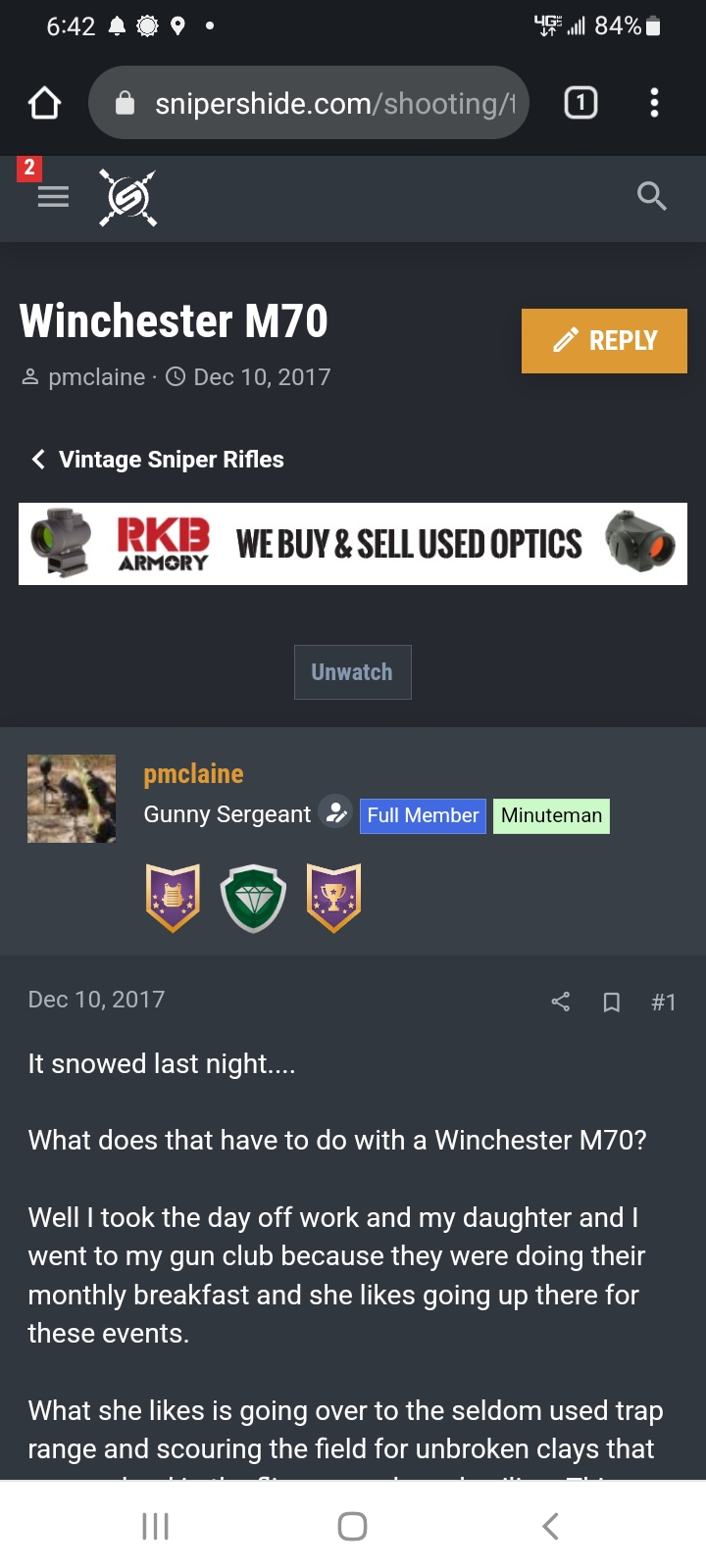

Scroll to this and read it all. After you get done, it should cover a lot of what you want to know.
You ask questions then, it might be easier to answer then.

I have read that thread, kinda what got my mind on having something in that realm. I read some on it the other day and read most of what he posts about his vintage rifles. I’d say he is partly responsible for me wanting to do this.
As for scope, nothing crazy really. I rarely shoot any kind of distance, and that is 600 and in. Most of my plinking is at 100-200 just for shits and giggles.
When L.Racine built it was a Palma rifle. It had 2 stocks a McMillen and the Winchester Target, and no sights. I was using it XTC so it has a PNW rear and a Stallings 30mm Right Sight up front. I'm going to scope it and just use it long range prone that 10 in 60 seconds sitting with that long action is getting to be a bear.
Still shooting XTC old school?
That's pretty badass

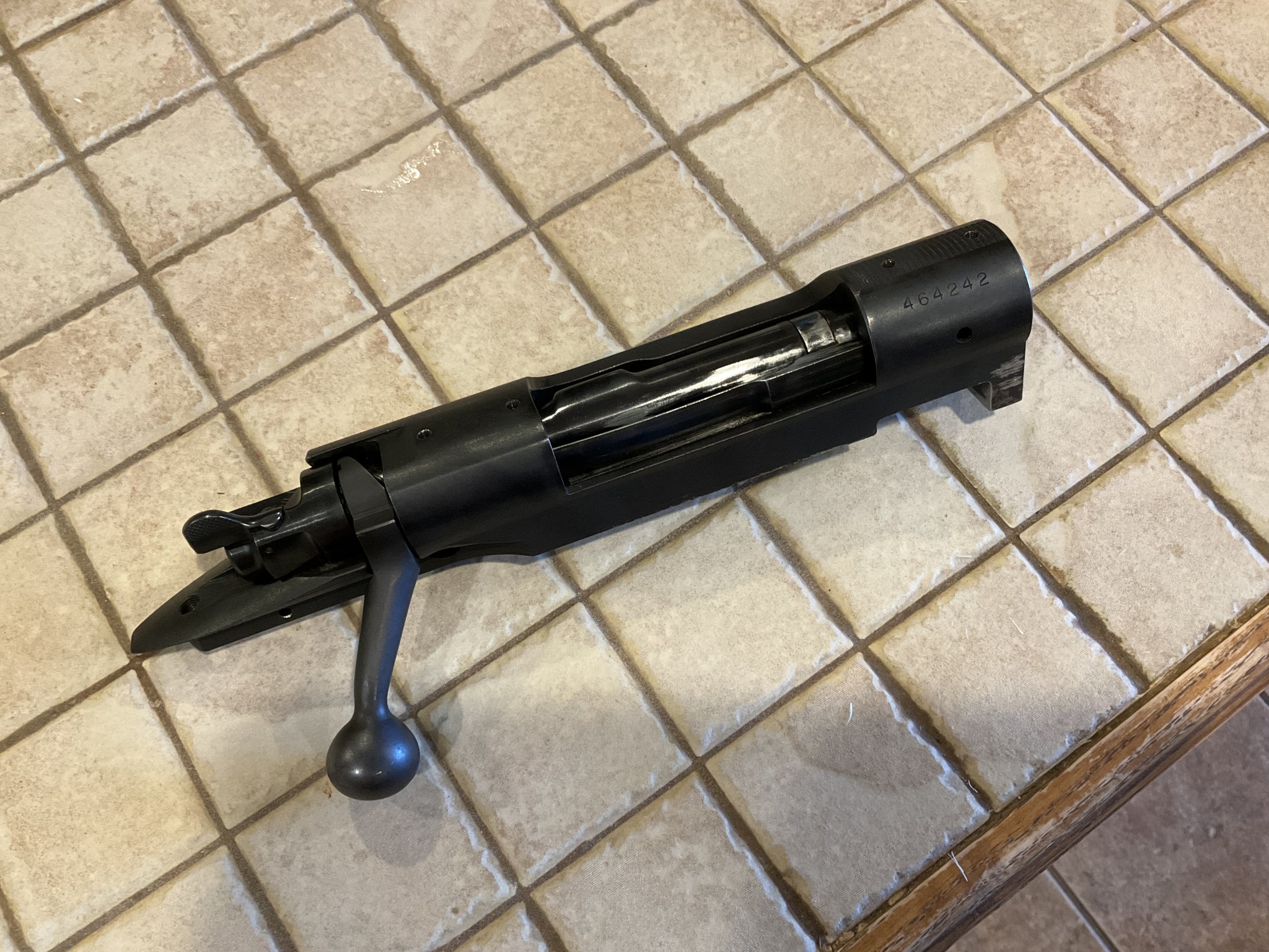

Will bring this thread full circle as well. Donor gun was located for a fairly good price. This is the auction site pic, will get better ones when it lands in my hands.
Pre 64 Winchester featherlight chambered in 243, manufactured in 1962 ish.

I figured this one was already tampered with, and as an early 60s featherweight there was no real desecration to one more collectible

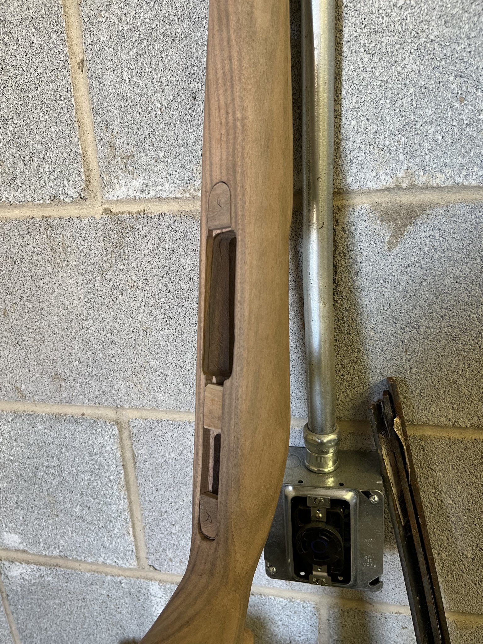

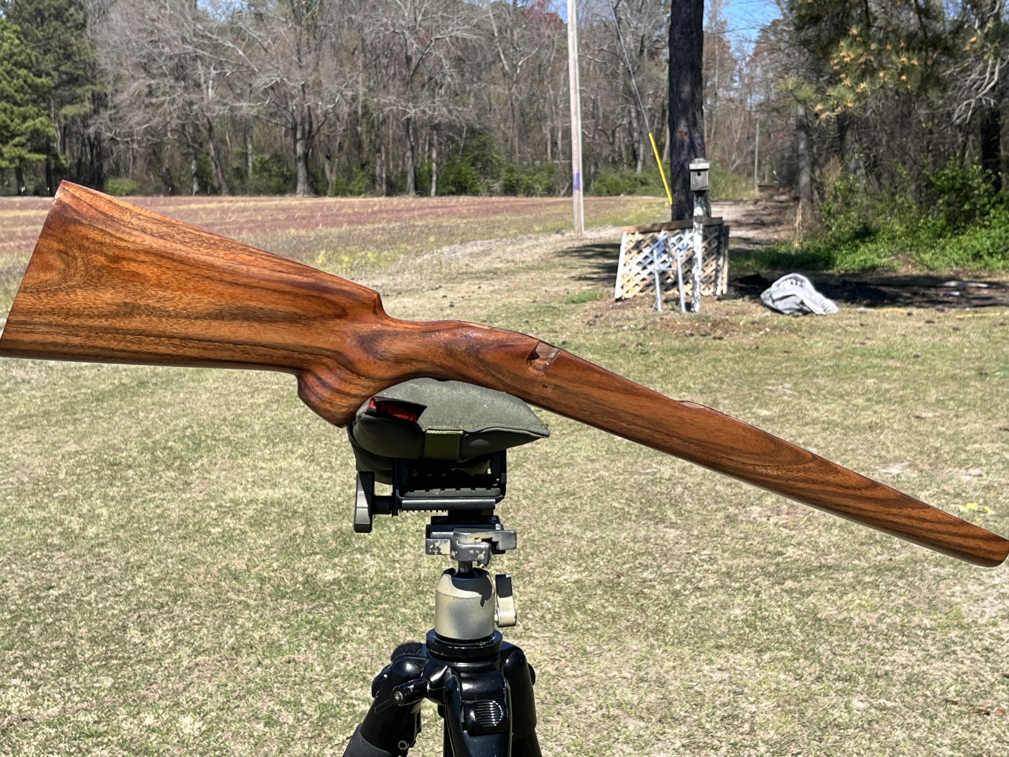

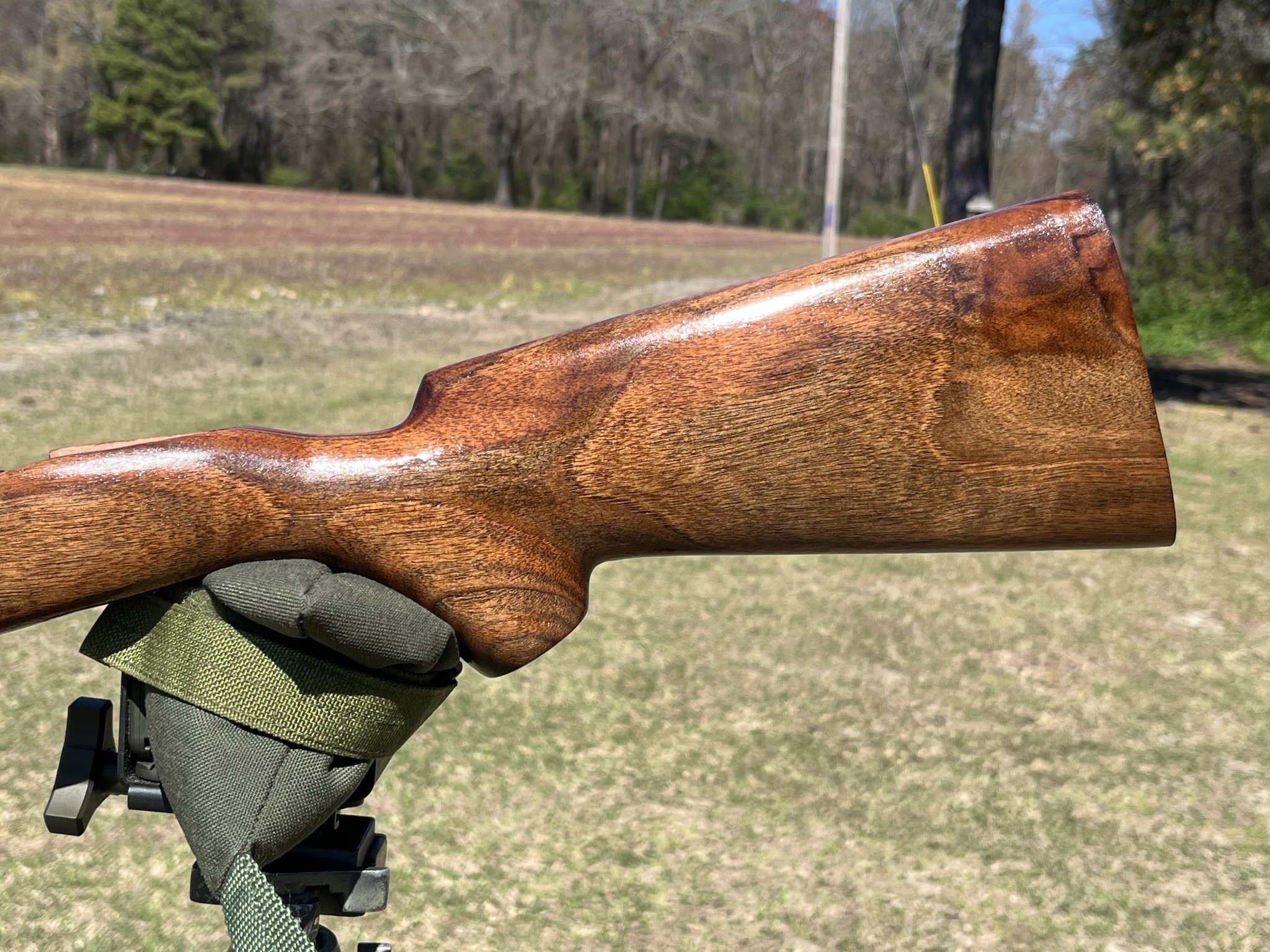

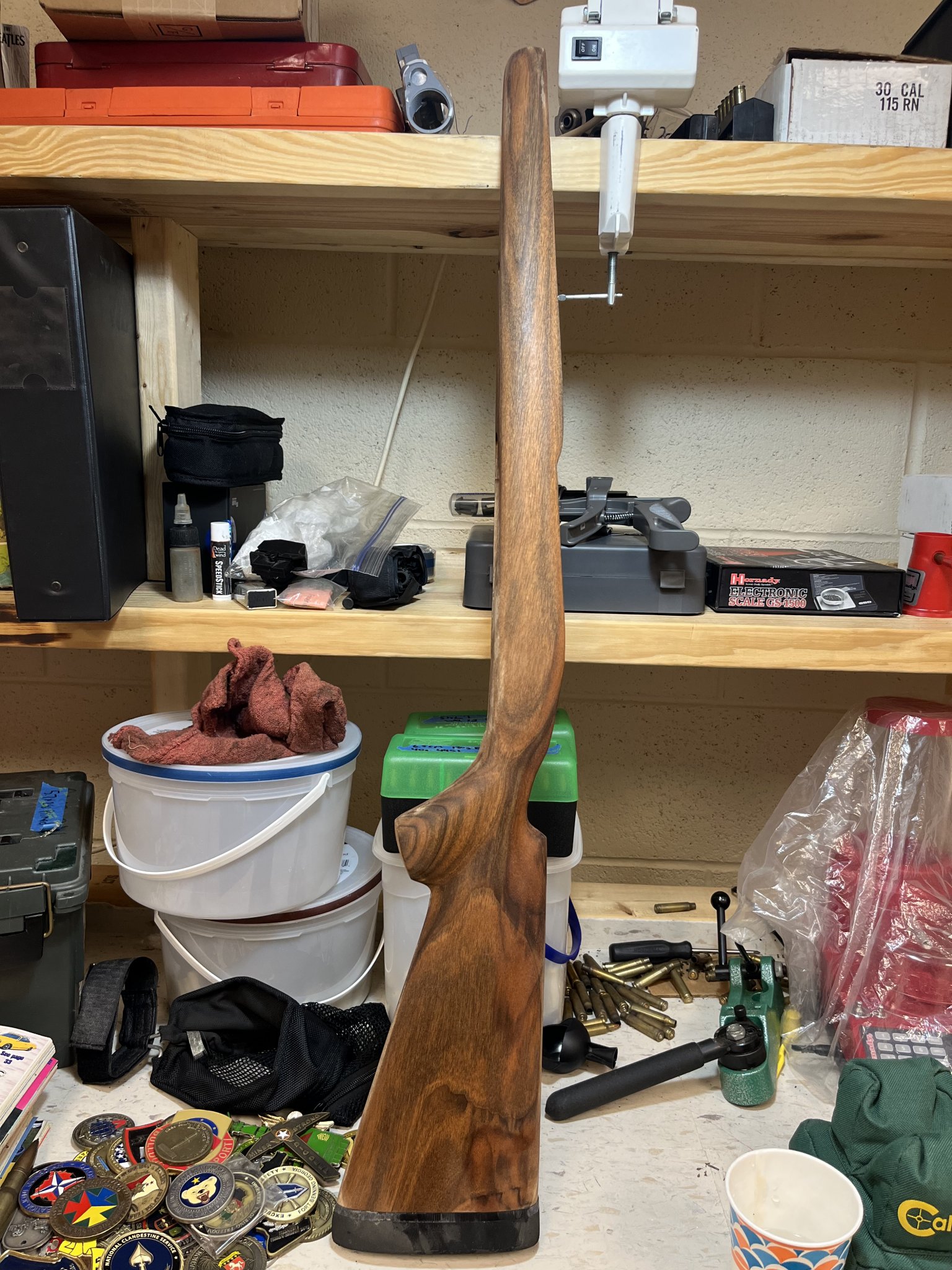

That is going to be quite a chore. The machining is way off. Hope you can get it sorted out.
Why did you not use American Black Walnut? Your wood is better but looks different.
Reactions: roostercogburn98

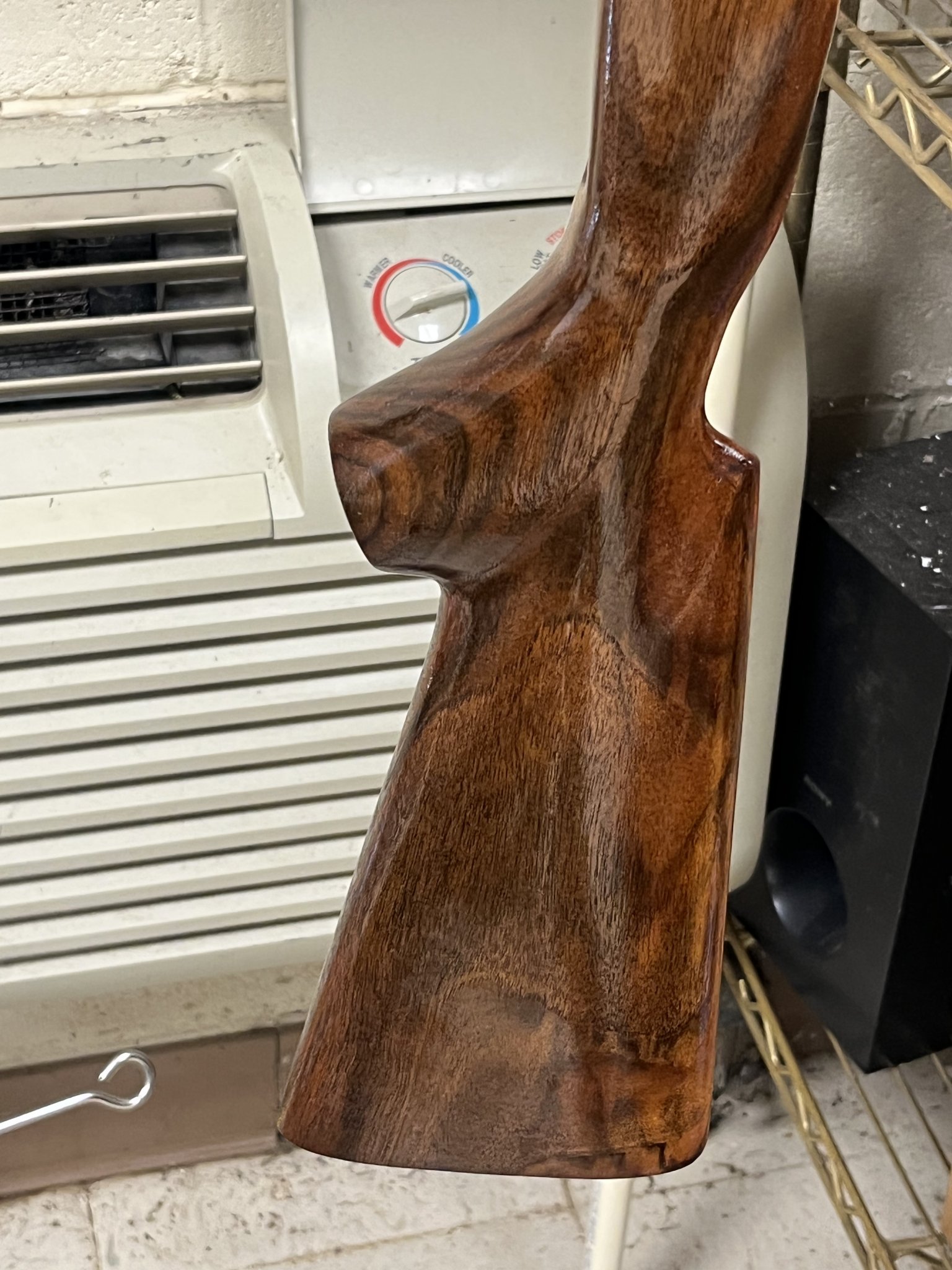

Stock is English Walnut, bought it from an online retailer that had TONS of positive feedback and sales of rough cut stocks. I figured it would have been in better shape, but probably won’t buy from that seller again.

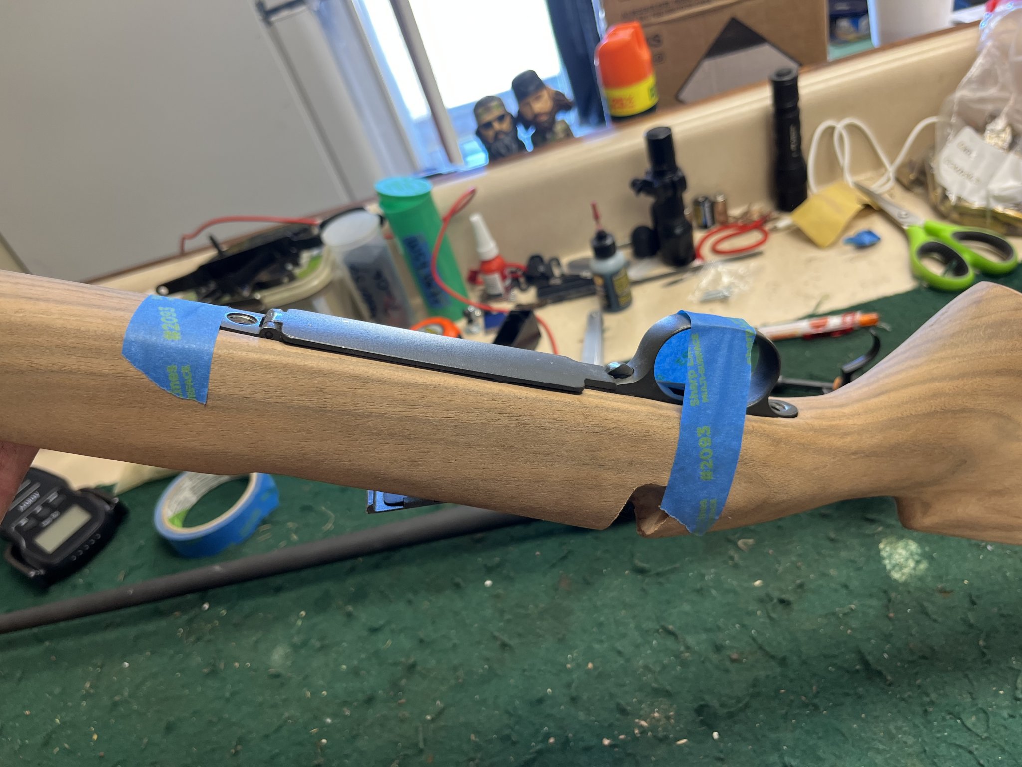

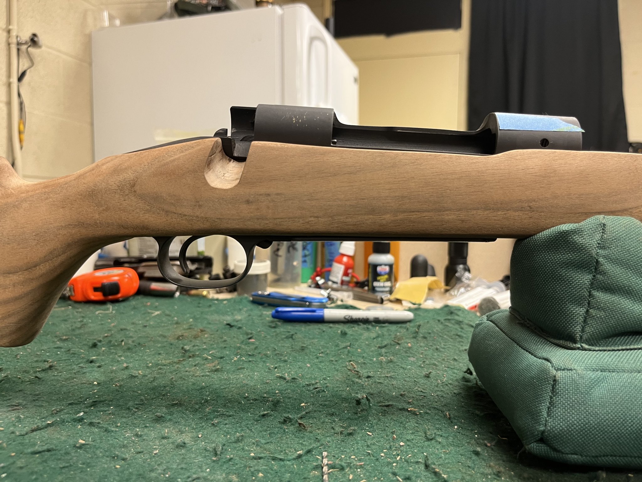

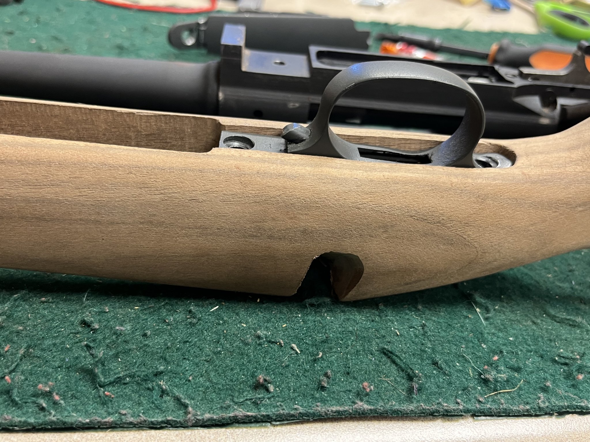

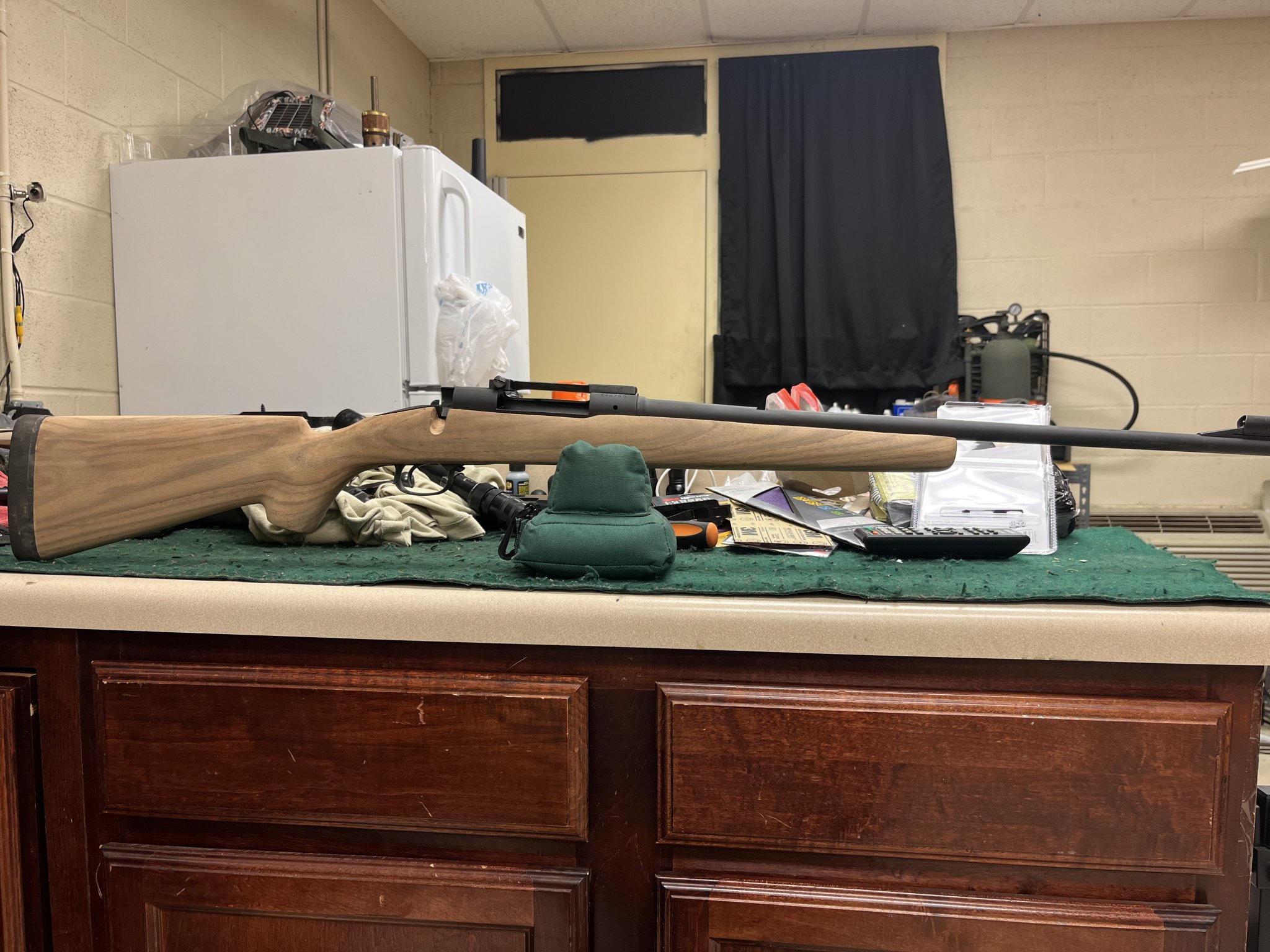

I got the bottom metal to sit pretty much where it needs to, and started working on fitting the magazine box, but had to stop to help someone out.
Stock is fit to action, and it cycles and ejects like should. Lots of fine tuning and more cleanup left for sure.

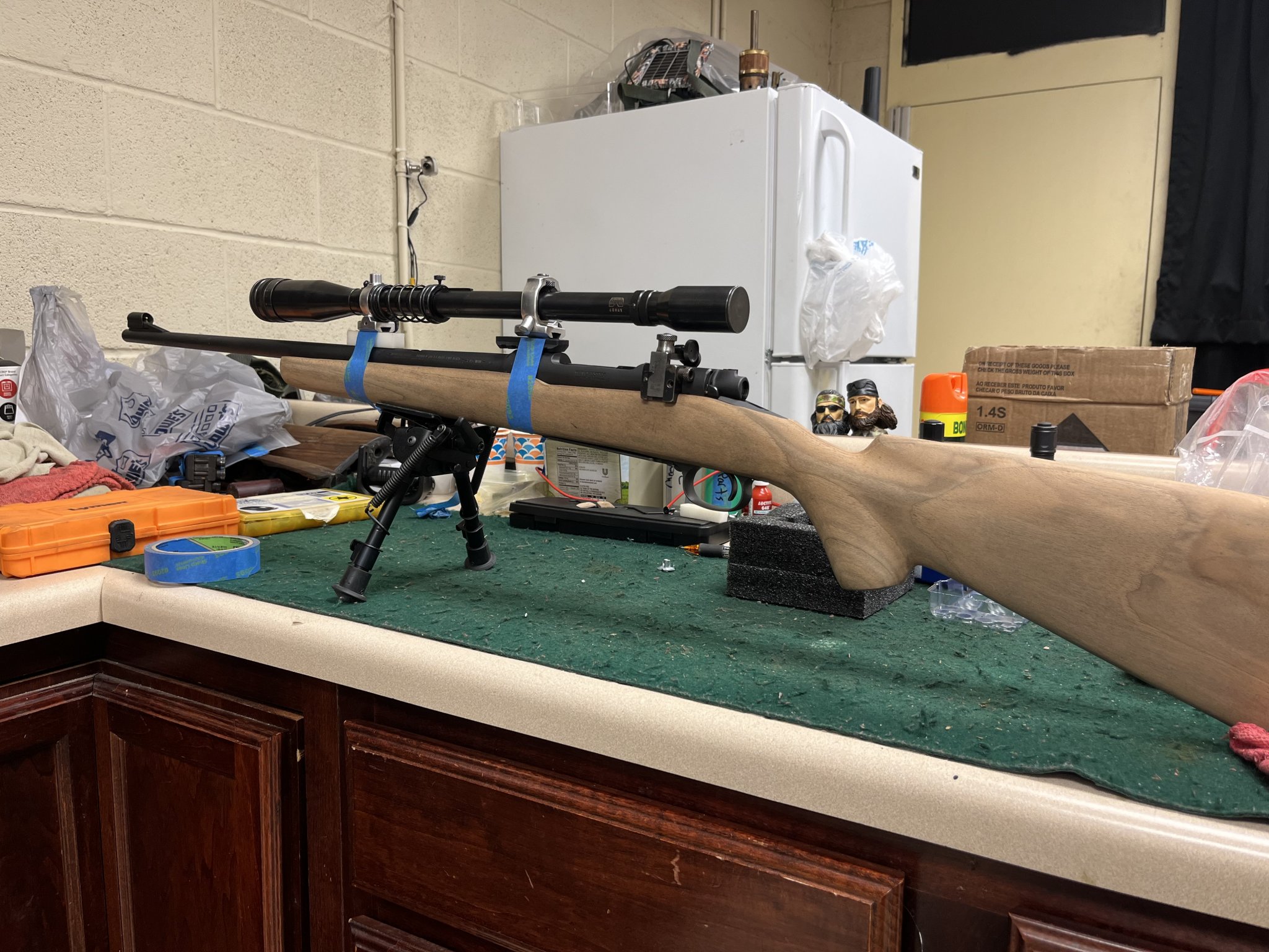

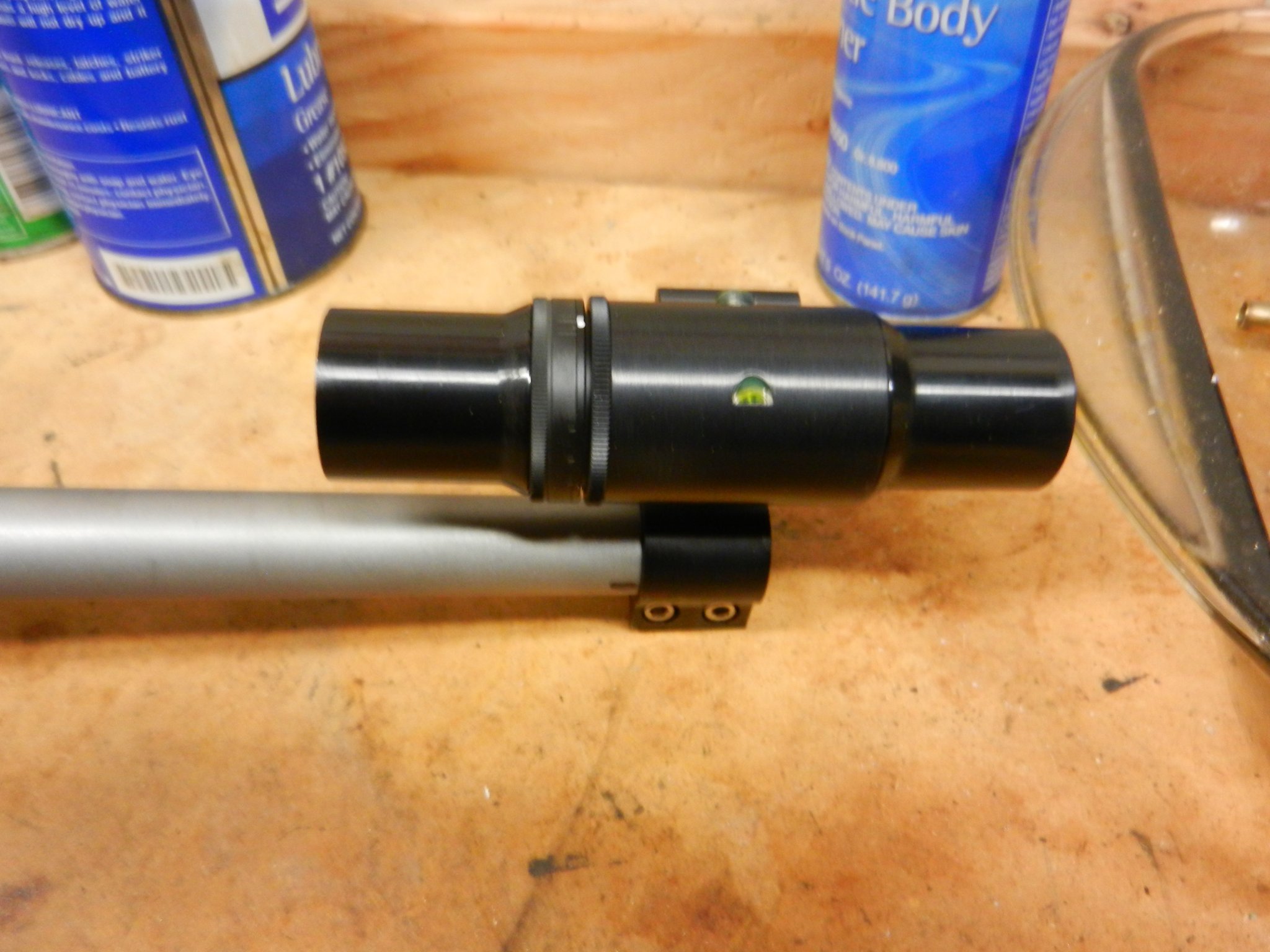

Ordered some unertl blocks from fleabay today, decided to lay the 10x on it. Will work on changing the rear mount later.

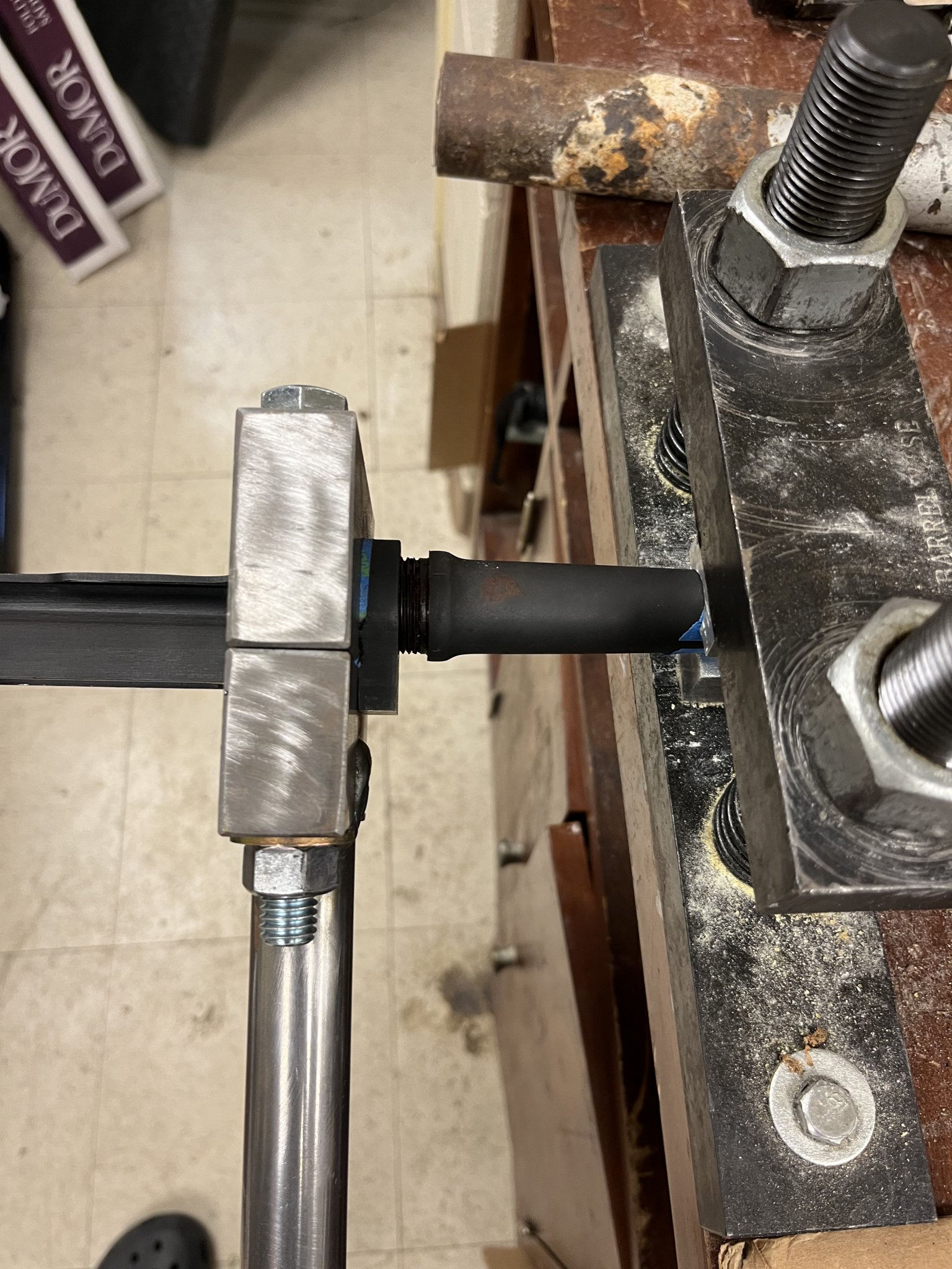

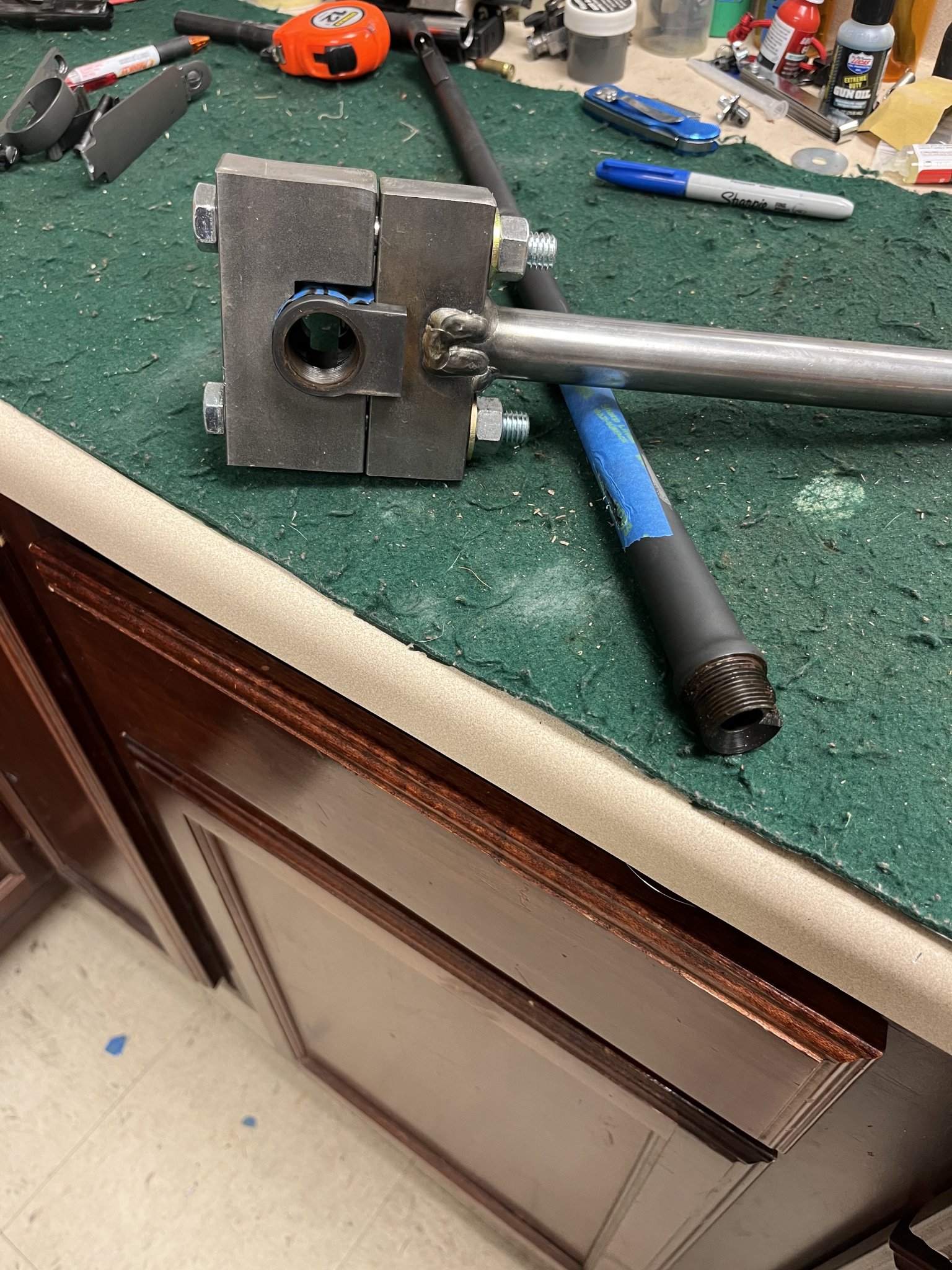

Will call the gunsmith next week and see about getting the action and barrel blank to them. Still have to source a front sight appropriate to the rear sight I had laying around. The mock up unertl blocks are too high, but gives me a reference until the ordered ones show up.
Featherweight barrel came off today. Bottom metal is flush, or as flush as it will be as well.
Unertl mounts showed up. Next step is the final make me happy fitting to the stock, and call the gunshop to see when I can get this terd mailed off. Still looking for a front sight base for a globe style sight, but those mount holes center to center measurements are fairly common.

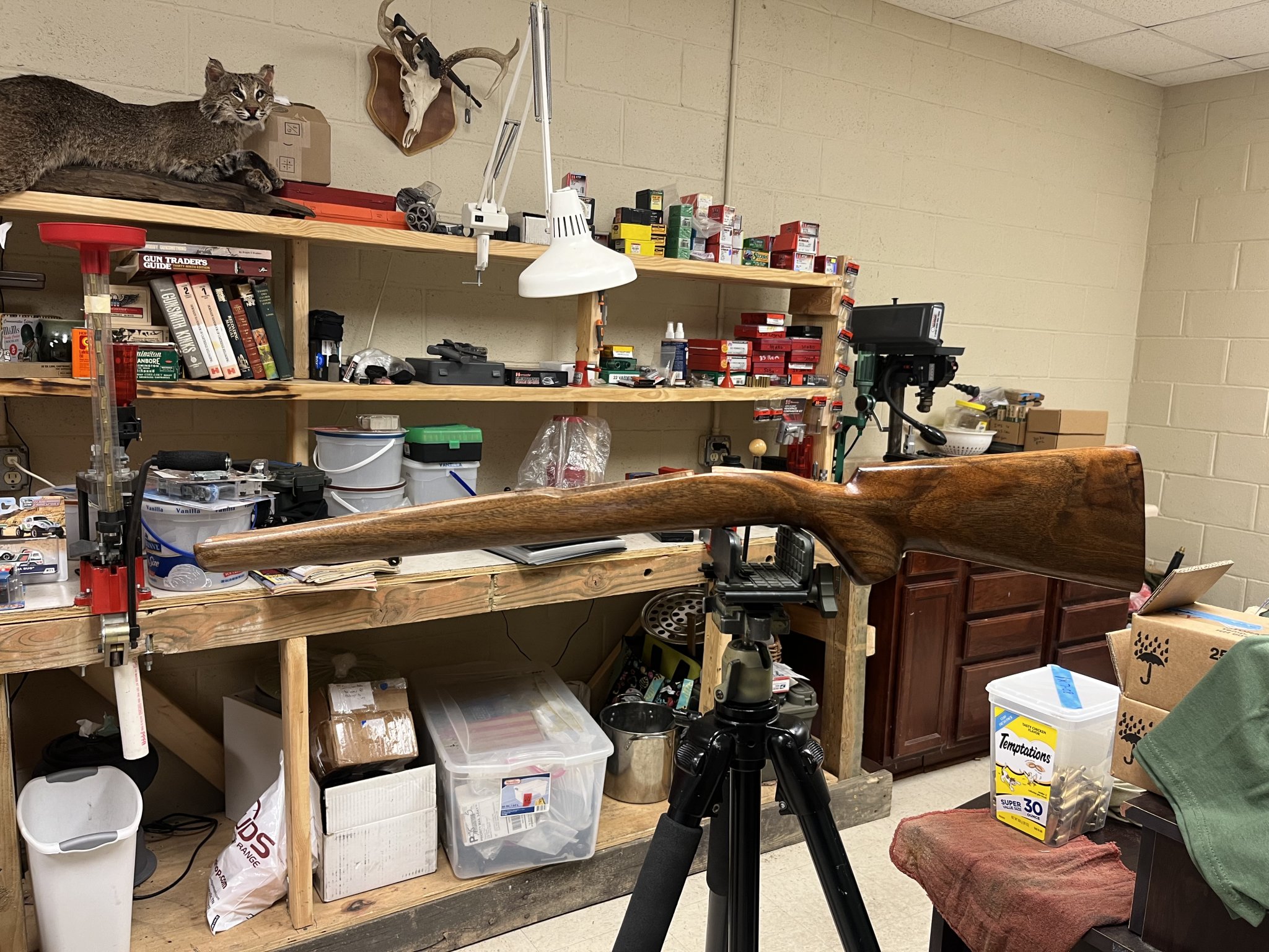

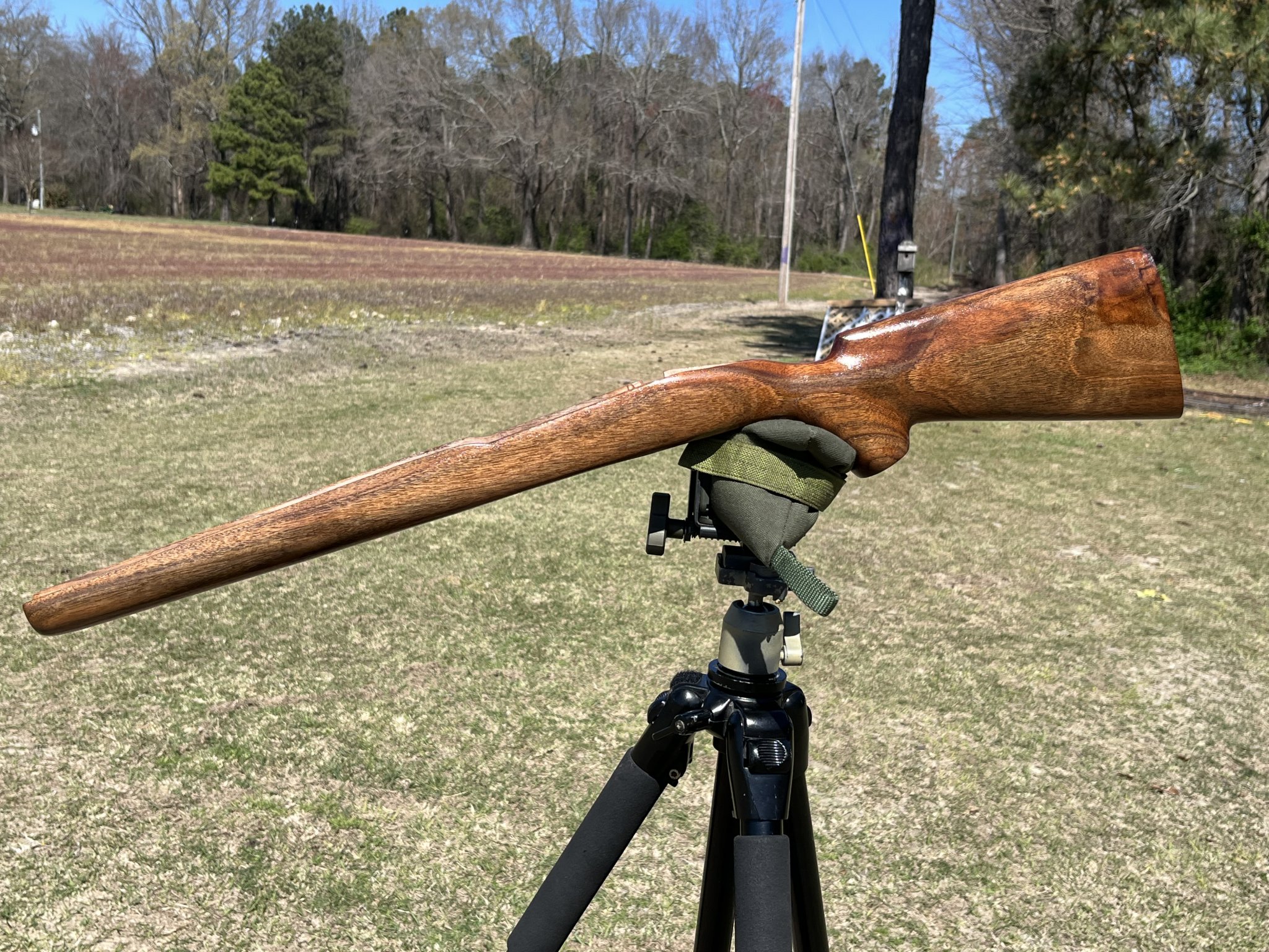

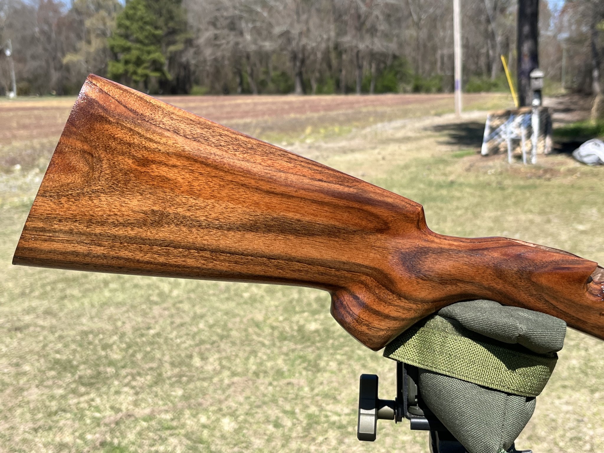

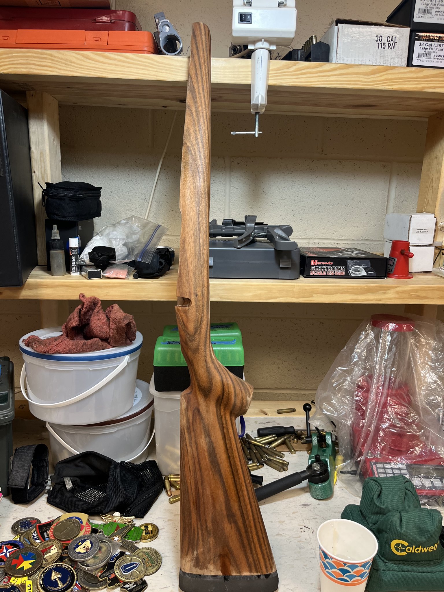

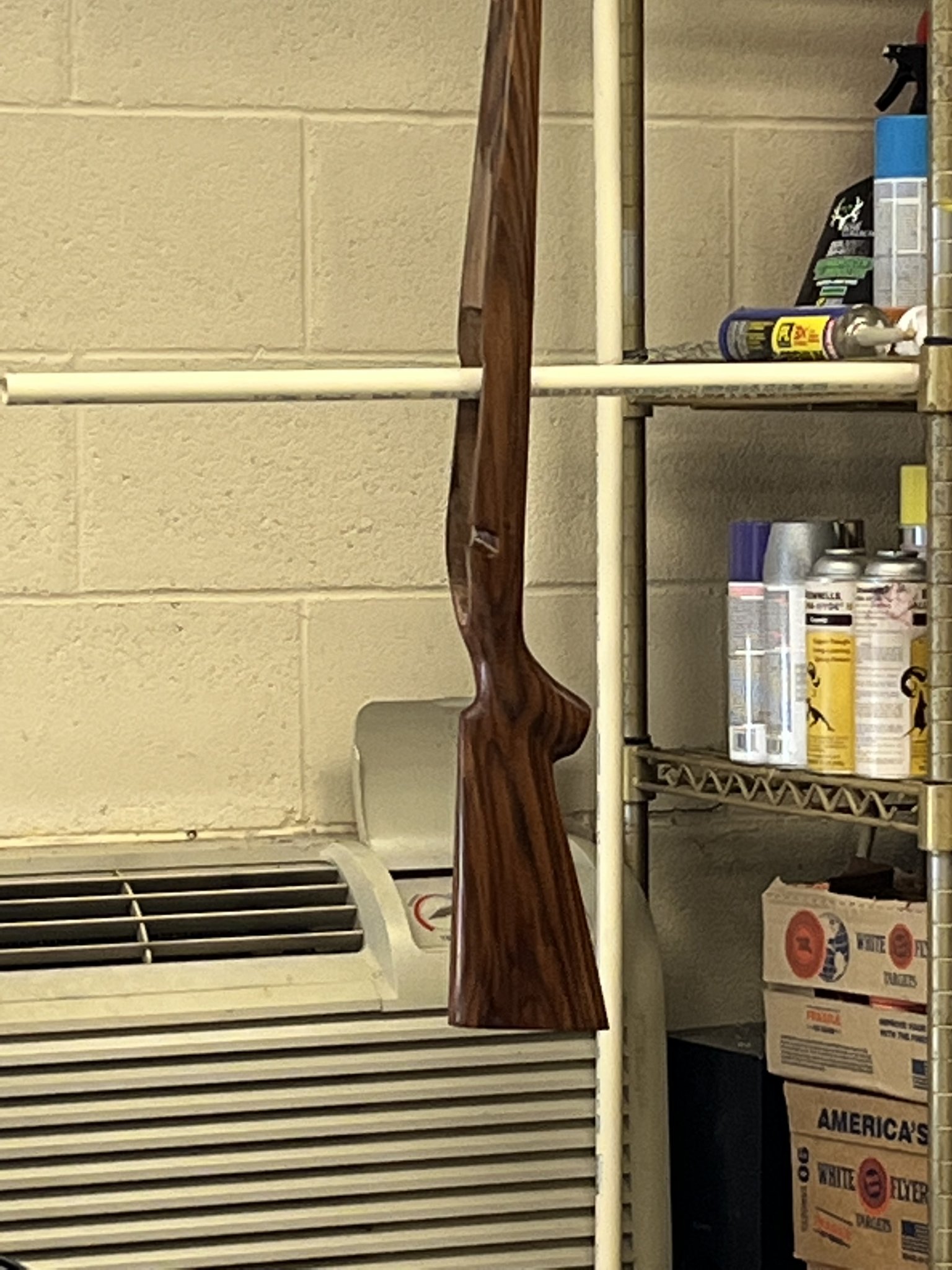

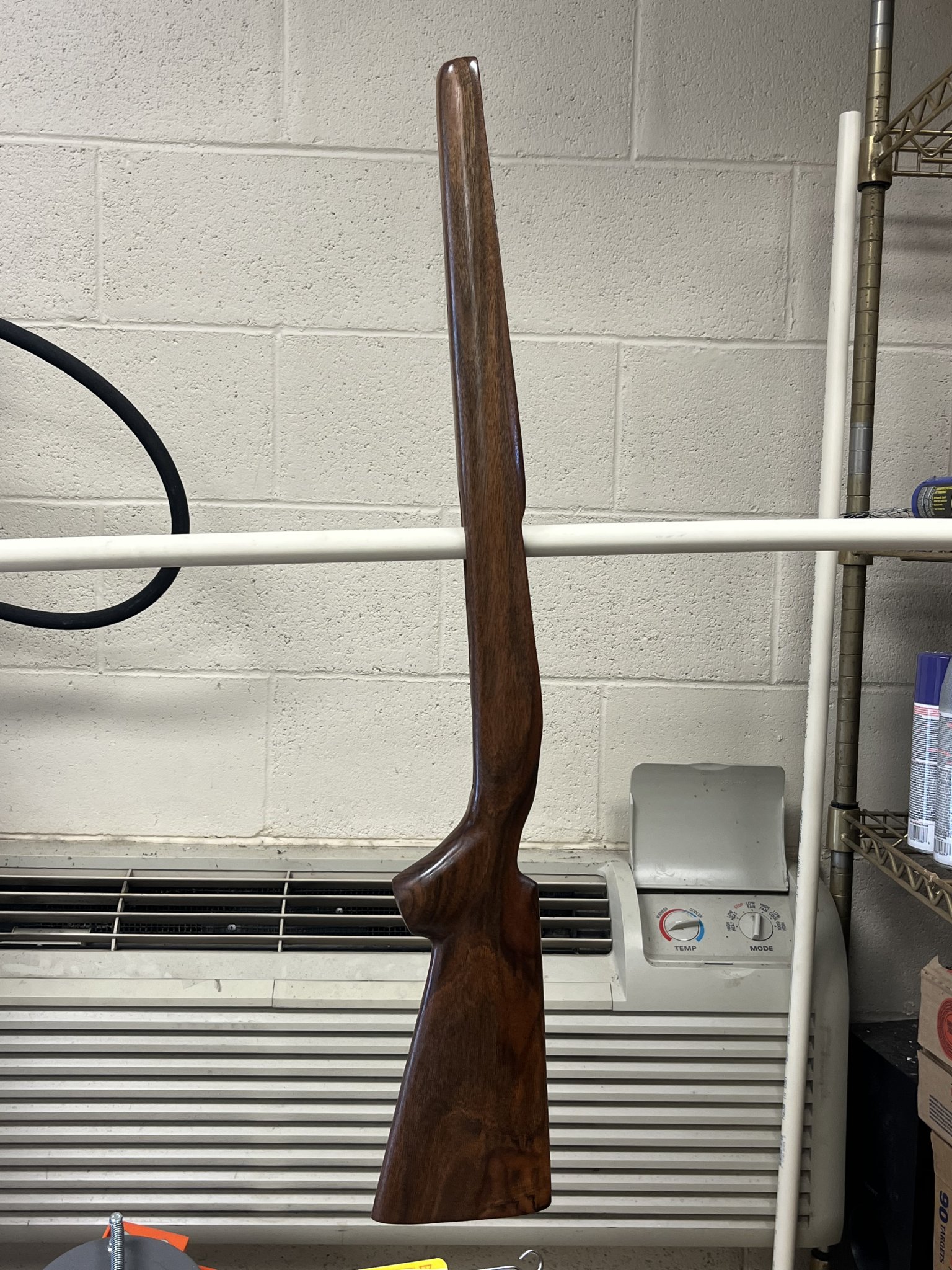

The stock is pretty much finished as far as “looks” go. I added a stud to mount my trusty harris bipods, and put a few coats of oil on.
