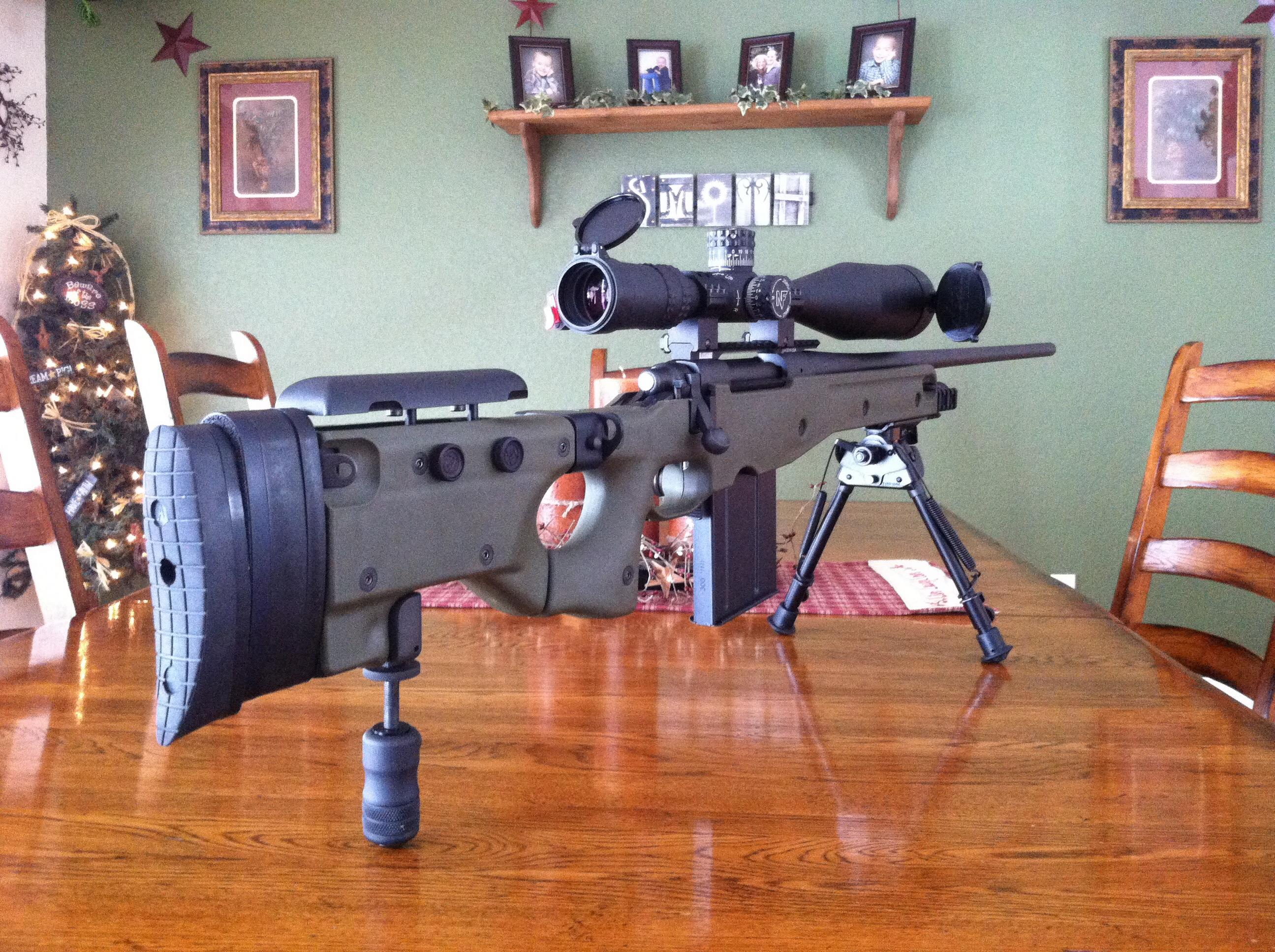

What is a good load for shooting out to around 1300 yrds ?.Its an sps 24in stock barrel .Some guys I talk to say 160 gr some say 190gr some say 200 gr now I'm just confused on where to start. I just need to be pointed in the right direction.Thanks
