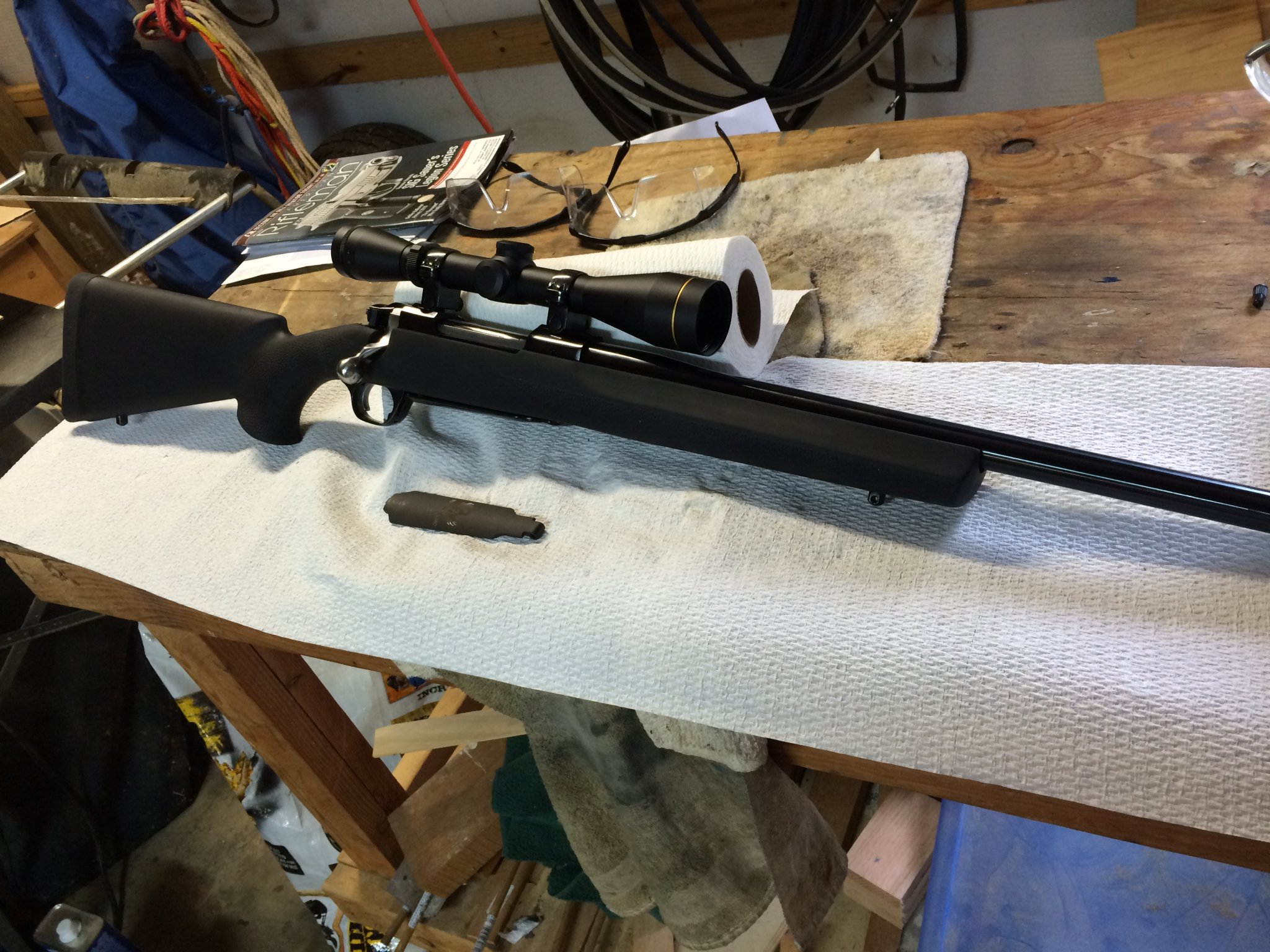

    Hey guys, I know this isn't exactly a hot topic, but I figured I'd share it anyways. This was one of my father's favorite rifles, but it burned out years ago. I wasn't going to let it stay that way.

    Shaw does a really nice job working with Model 77’s. They rebuilt a beater MKII in .30-06, rebareling it to .35 Whelen, truing, and rebluing. Put it in Hogue stock. Shaws work looks great and the rifle shoots really good.
    I picked this rifle up used at a large firearm retailer for about $400.00. It was rough. Picture is not the greatest but I really am proud of the results. Its a shooter too.

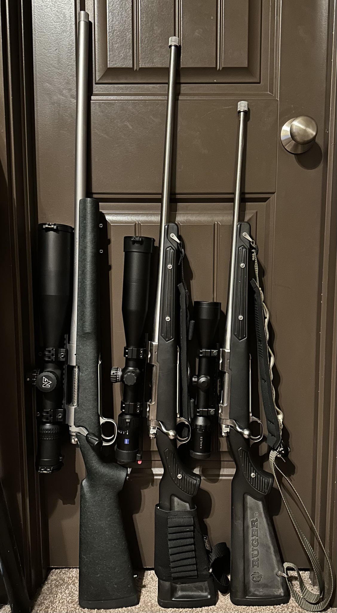

    @coldboremiracle your resurrection of that M77 is inspiring; I’m going to look into a fast twist 7mm barrel for mine and give it an update. Maybe I’ll look for a new stock as well. Thanks for posting.

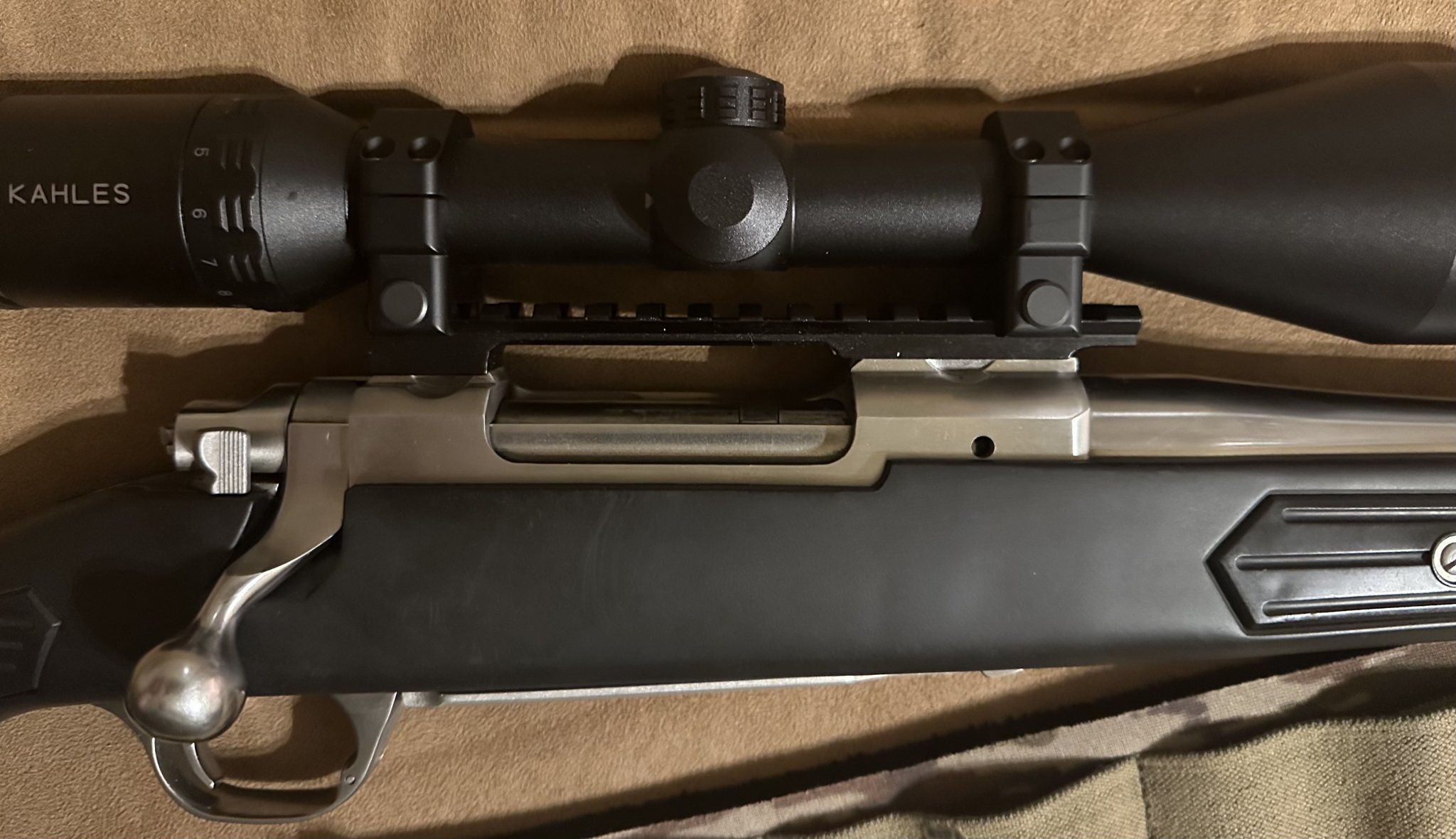

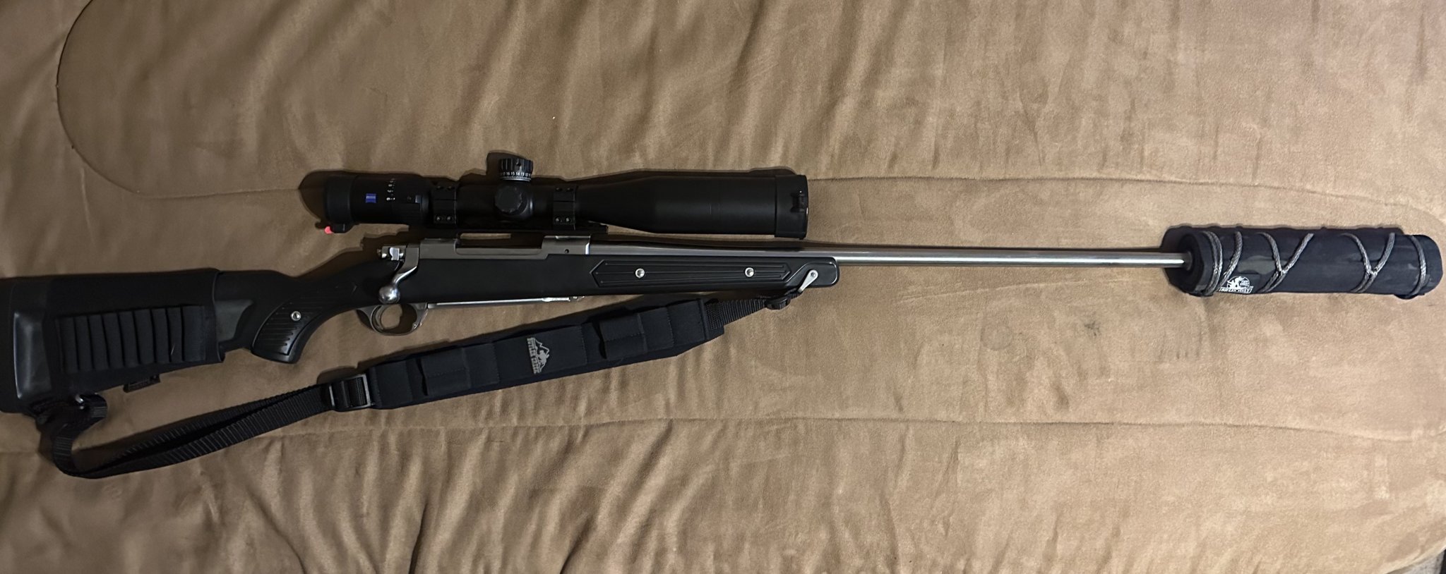

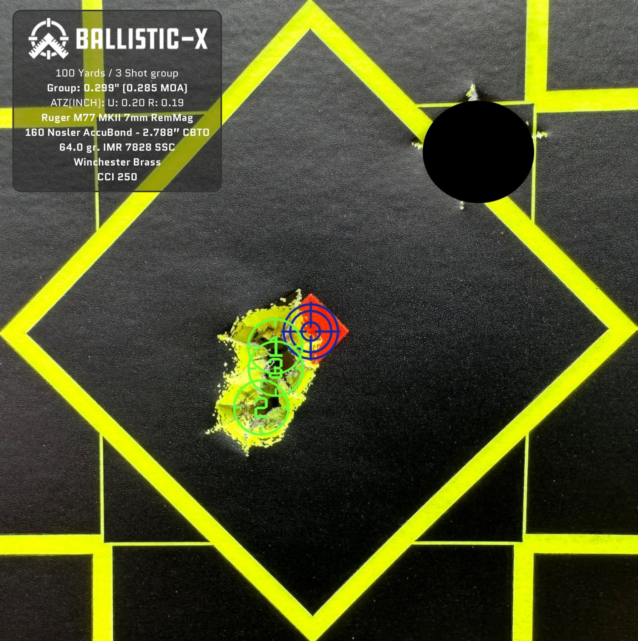

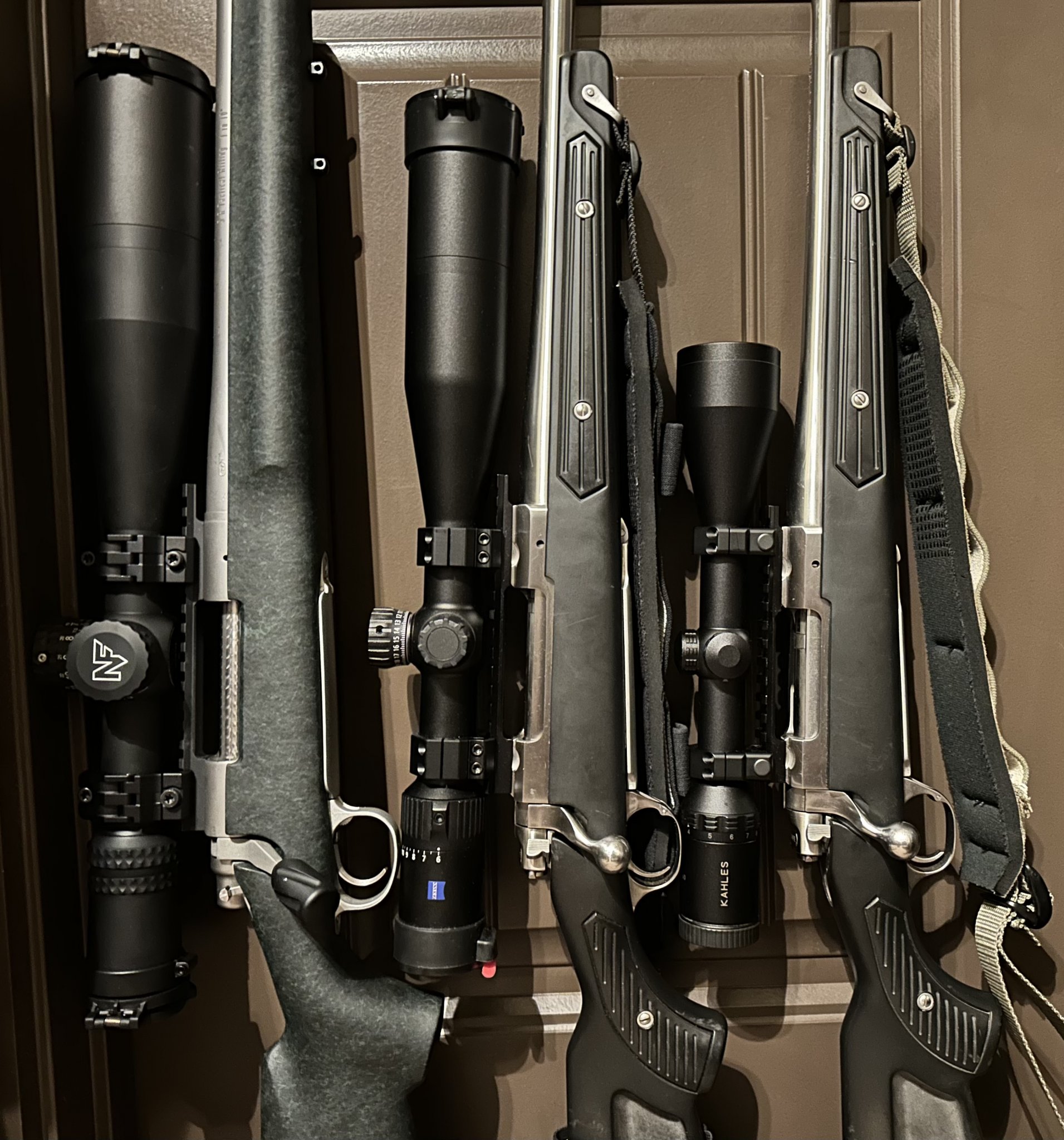

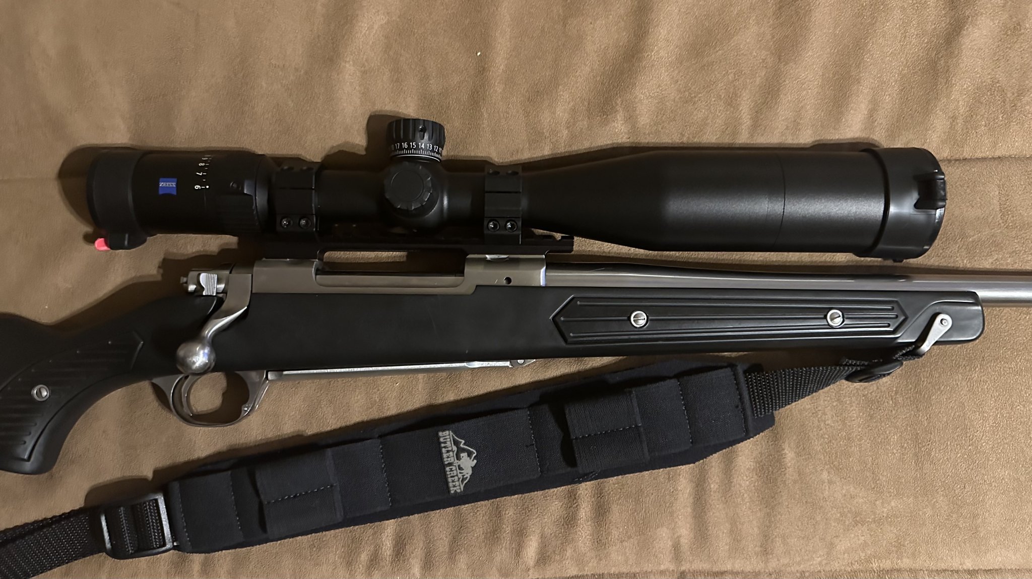

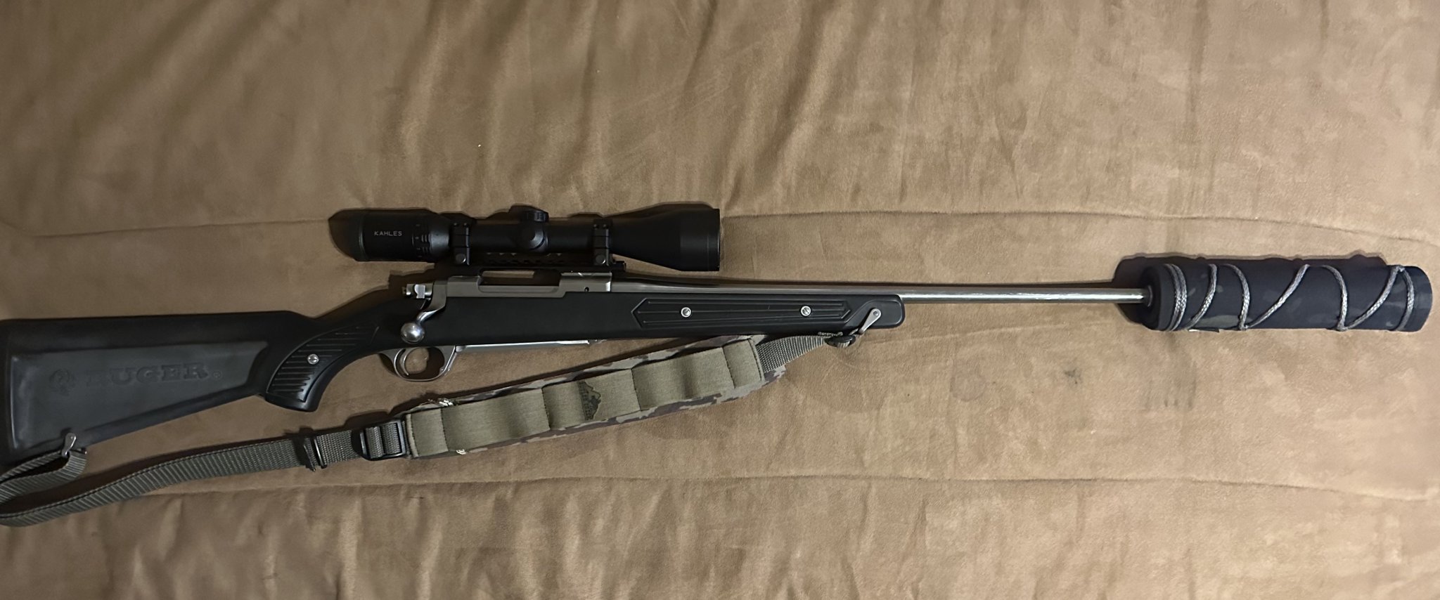

    I like your build, but you are definitely NOT limited to the proprietary Ruger-style rings designed to fit on the receiver... If you know a gunsmith or are handy with a milling machine, you can bring that old M77 into the 21st century... I did this earlier this year with 2 of my old M77 MKII's (7mmRM & 7mm-08)...

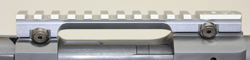

    EGW makes picatinny rails for them, but you have to drill and tap the receivers for 8-40 screws. They are actually VERY well built and fit really nicely. They even give you drilling measurements on their website.
    IMG_9281.jpegIMG_9278.jpegBallistic-X-Export-2023-07-16 20:21:01.465900.jpg

    Don’t have to drill and tap for picatinny
    That was one of my top options when I was researching, before finally deciding on the EGW’s. I wanted to get away from the big side screw design altogether, so I went with the traditional top-mount EGW’s. They had to go to the smith anyway to get the muzzles threaded, so figured what the hell. 🤷🏼
    Reactions: spife7980
    This is the way. Works well for the 77/22 also and no need to start swiss cheesing the action.
