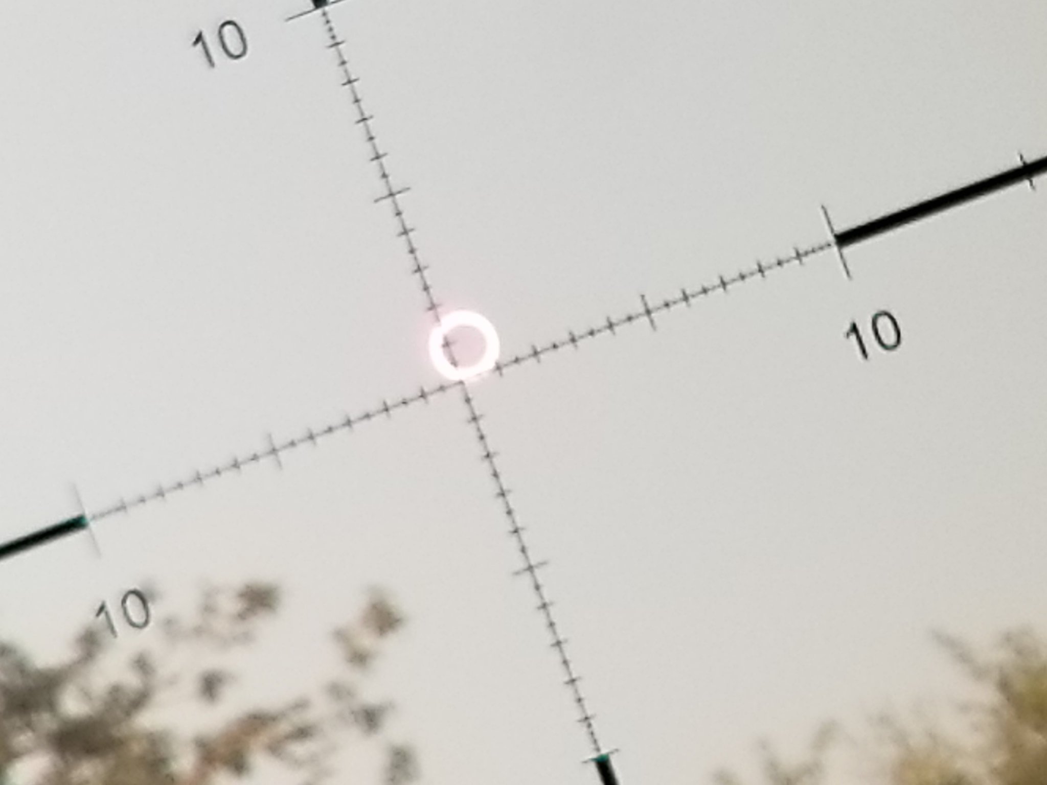

Anyone else with a pair, is the illuminated circle off center from the etched reticle like this?
If so I'm guessing the circle is the aim point for the lrf? Just used to my plrf being dead on.
Also, when i adjust the diopter to focus the reticle (+1 as usual for me) the circle is way out of focus, i have to adjust to +4 to get it in focus.

So I'm afraid I have no feedback on yours other than to say I would contact Steiner of the matter and get their feedback on it. If that is a new issue it may have been jarred or moved in some manner. But its worth them taking a look at it.

I saw a video on yt and it looked like the indicator and reticle were lined up perfect.

Yeh, I've seen that before too. I think yours is buggy.
That M Series can take a hell of a beating with the internal design they use. But I could see something getting hit hard enough to move that aim point but not break it.

I have the 1535nm M830 LRFs, I have put them through some pretty awful conditions and still hit 8700 yards on a water tower the other day. I would reccomend sending them back to Steiner and they will polish the glass and clean them after fixing whatever is wrong. You may have just gotten a bad set.
The manual should mention that the laser centering can be off of center depending how the binos are fitted to the eye...

Yeah, that is weird the put the laser and aiming reticle on opposite lenses.

Mine is perfect...I align at the 67 marker though...not sure where your eye lines up at...either way Steiner will take care of you...they have never dropped the ball for me on that front.
I just got a response from steiner after a month....
"Good morning,
The repair technician looked at them. Everything appears to be within spec. It is off but the circle is what you put on target but with the tolerances it is within limits"
