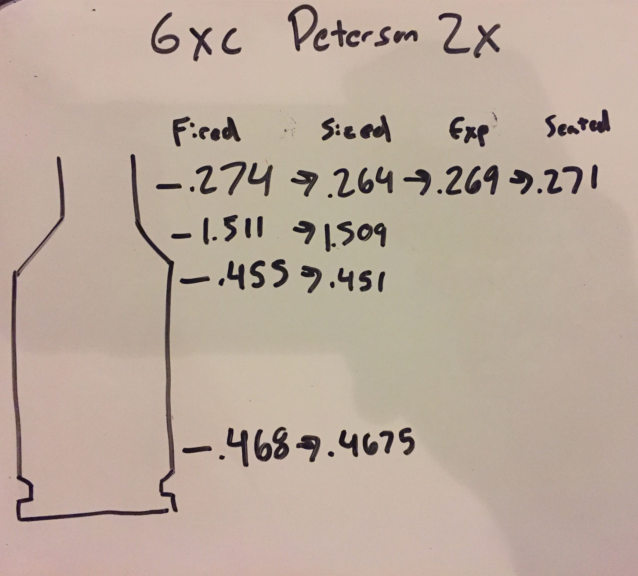

It could but Im assuming the base diameters are really large and its not the necks giving you issues. Id try a liberal amount of lanolin liquid lube just because I havent had issues with it but taking measurements will show you where the issue lies.
I take the
neck diameter
the shoulder to base measurement with the comparators
shoulder diameter and
base diameter directly above the web, about .2" up.
