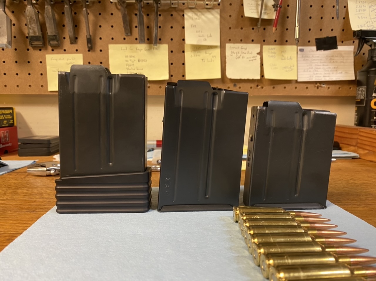

Nope, nope, nope. Got my 7 round Accurate Mag and Area 419 extension. Don't bother. The extension is nice, fits very well just like it should. HOWEVER, once you try and put rounds 9 and 10 in it, it gets extremely stiff. You have to use two fingers to get the rounds pushed down, and if you slide a round out, the follower hangs up. I tried several times cycling rounds, and rounds will hang up in the mag, nose dive, or it won't come up at all till you get to round 8. Playing with the follower in the extension, I noticed it hangs up on the front and back at the corners, does not slide smooth like it does in the mag. Not sure I want to return it, I want to make it work. Maybe if I use a Cratex tip and smooth it out some.
Not to mention I got the wrong color extension.
Edit - I may try an MDT mag, maybe the follower won't be stupid when it is full.
Edit - 3 round AM it is still a pain to feed the mag, but the follower doesn't hang up. But doesn't work in an Oryx Chassis. Catch is to long hitting the extension and mag doesn't seat well.

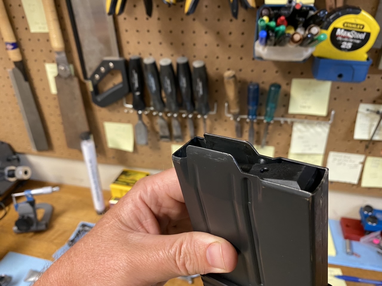

Did notice on the 7 round, with the spring/follower pulled, that the front corners are protruding inside on the extension. So I think the rounds are pushing the corners of the follower into the extension, and that is also why it takes force to get the last two rounds in.
Got my area 419 +4 and I'm pretty disappointed...
Its well machined, seems like a good design, follower doesn't bind, and yes - you can fit 10 6.5 PRC rounds in a MDT 10 round 308 (feed lips tweaked) with the +4 on it.
However, no magazine that I own has enough "spring height" to actually press the last round (or 2) to the top. Most end up at a totally goofy follower angle and even if you bend the shit out of the spring to give it more height, as soon as you fully load the mag it compresses the spring so hard that its back to its original memory position.
I'm a little surprised that -anyone- recommends these, for 3 different brands of mags (and both MDT 10 and 12 rounds) you couldn't successfully run the same number of round in it as you originally would have because it adds too much height to get the rounds to the top of the mag with sufficient spring pressure.
This seems like a fatal design flaw simply trying to do "too much", compared to a more traditional +2 base pad.

Right, so here is what I recommend: install the extender on the 10 round metal magazine, but use the spring and follower from the 12 round metal magazine and see how many you are able to load up?
What is happening is that you are taking the magazine body and extending it by the internal height of the extender, but not extending the spring (unless you stretch it), which is why you're "running out of spring" on the magazines. Seeing as it is a +4 extender, you may be adding more internal height than the springs are capable of for the 12 rounder + extender, meaning that you would need a longer yet spring for that to work.
When ordering our MDT Mag Extender for a 10 round magazine, we recommend that you also order a Mag Extender Spring + Follower which is just a longer spring to take up that extra room. The fact that Area 419 doesn't have something like that also, confuses me a little.

@MDT_Josh - I'm one step ahead of you but didn't want to crowd the thread with permutations initially.
10 round mag with 10 round follower/spring, +4 extension : not enough spring height to pressure the last round or two, but does fit 10 rounds snugly
12 round mag with 12 round follower/spring, +4 extension : not enough spring height to pressure the last round or two, fits 10.75 rounds but not quite 11
10 round mag with 12 round follower/spring, +4 extention : plenty of spring height to pressure the last round, however the extra spring is enough that it no longer fits 10 round, you can only get 9 in there and its pretty tight.
Reactions: MDT_Josh and loveha
What we seem to need (which gets honkin tall) is a 12 round mag body, with a slightly taller than 12 round spring/follower, with the +4. It seems like there is enough room that the extra "spring space" when compressed would still allow 10 to fit and give enough up-pressure to feed the last round or two.

I'm pretty sure the AM world work, if it just didn't have so much issue with the follower jamming in the extension. Because like I said, round 8 is great, inserting 9/10 it sucks, and the follower sticks not pushing the full stack tight to the lips till you give it a smack, but round 9 jams when you go to cycle the action so it either nose dives or you rife over the top.
I blame the large radius corners on the extension.
I'm here at work looking at my shops ancient end mill looking for small enough bits to reduce the radius. It's so deep though I don't think I have anything long enough. I'm past the cost of this thing though. If I trash it, oh well.

Nope, same spring and follower in the WSM mag as the standard 12 round offering. We did do a stronger spring at one point, but like @loveha said, you'll run into issues with the spring compression and taking up extra space.
One thing you could look at doing would be to file off the bottom of the legs on the follower to allow it to get down a little lower in the magazine when under load and **maybe** increase your capacity back up to 10 with the +4 extension.

I can confirm that stretching a 12 round spring out -does- appear to give enough pressure to fit 10. If you try and hork an 11th in there it will "rebend" the spring however, so its right on the edge.
For now I'll run a 12+4 (holds 10) and a 10 (holds 7) as my backup.
