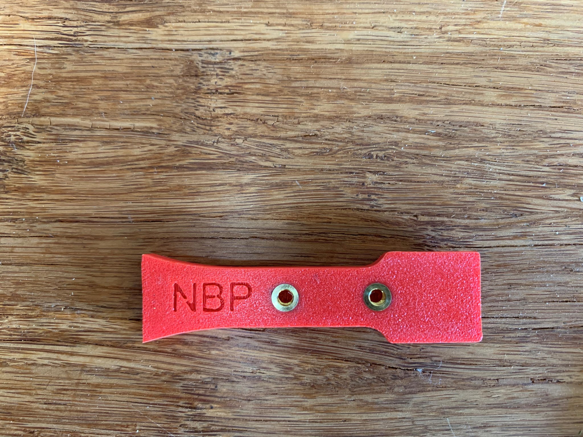

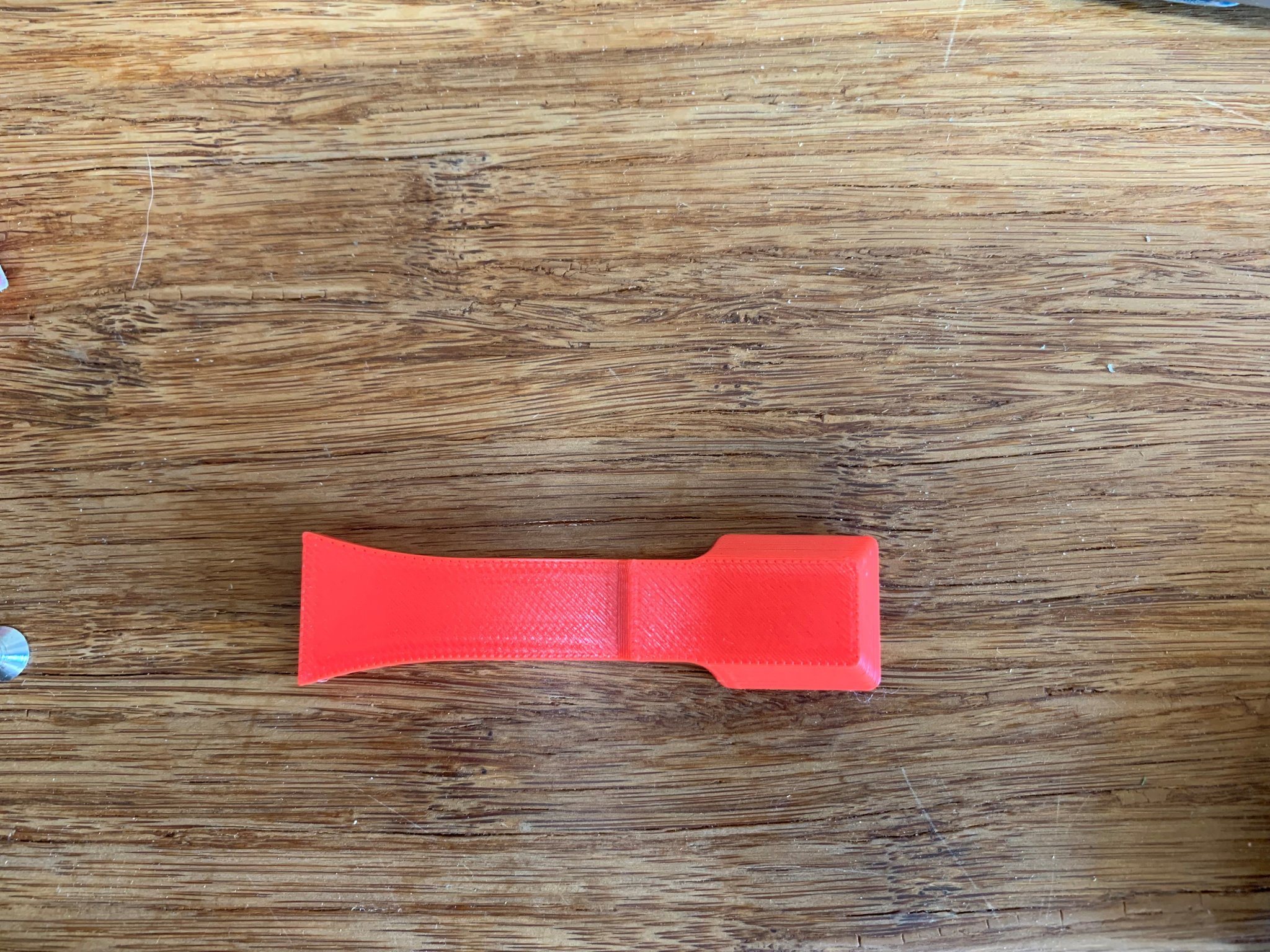

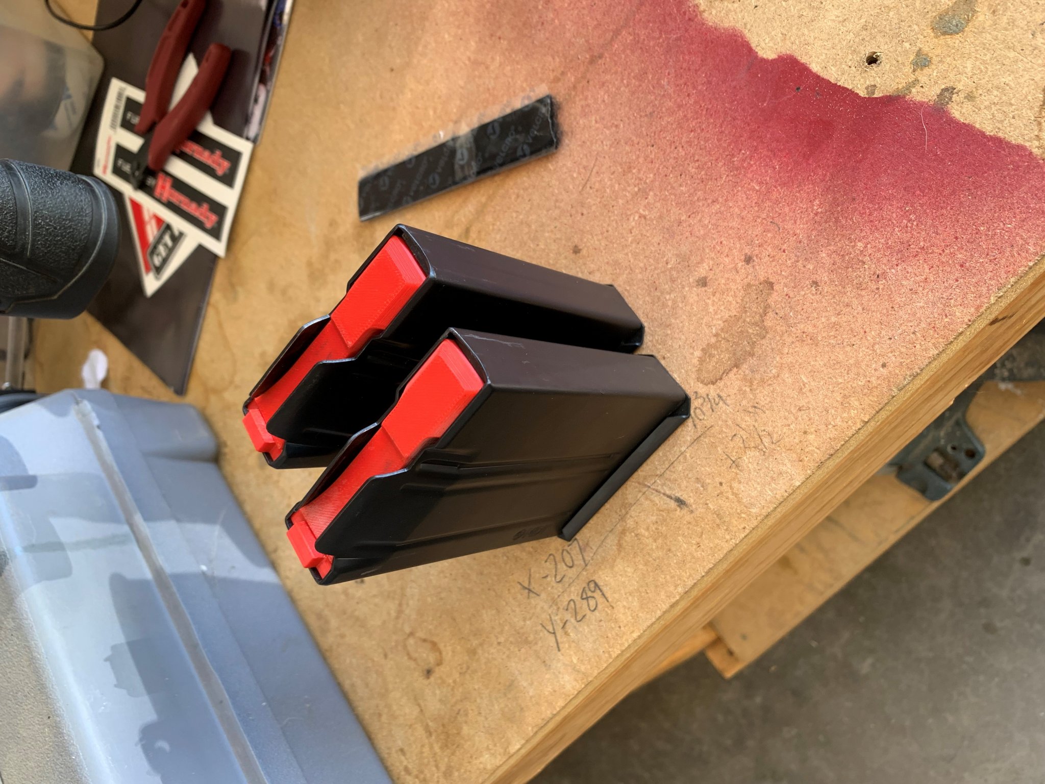

I played around forever with the 12rnd MDTmags and could never get them to work. Finally I designed and 3D printed a spacer kit and they run flawless.

Probably a market for a few when the GT hit the lathes, but most have either tinkered with the MDT mags to make them work, or just buy the AI or ARC mags and go. I do appreciate the ingenuity to a problem, so props for that!
I was planning to sell them, just never got around to it.
I never played with the BR mags. I just started tinkering with my .308 mdt mag.
If your interested in purchasing a kit, send me a message.
I sent a message…I think…hell I don’t know lol. But I’d like to try one of these or two or three in a 10 round MDT. I don’t have any 12 rounders. I would certainly be willing to pay for them.
