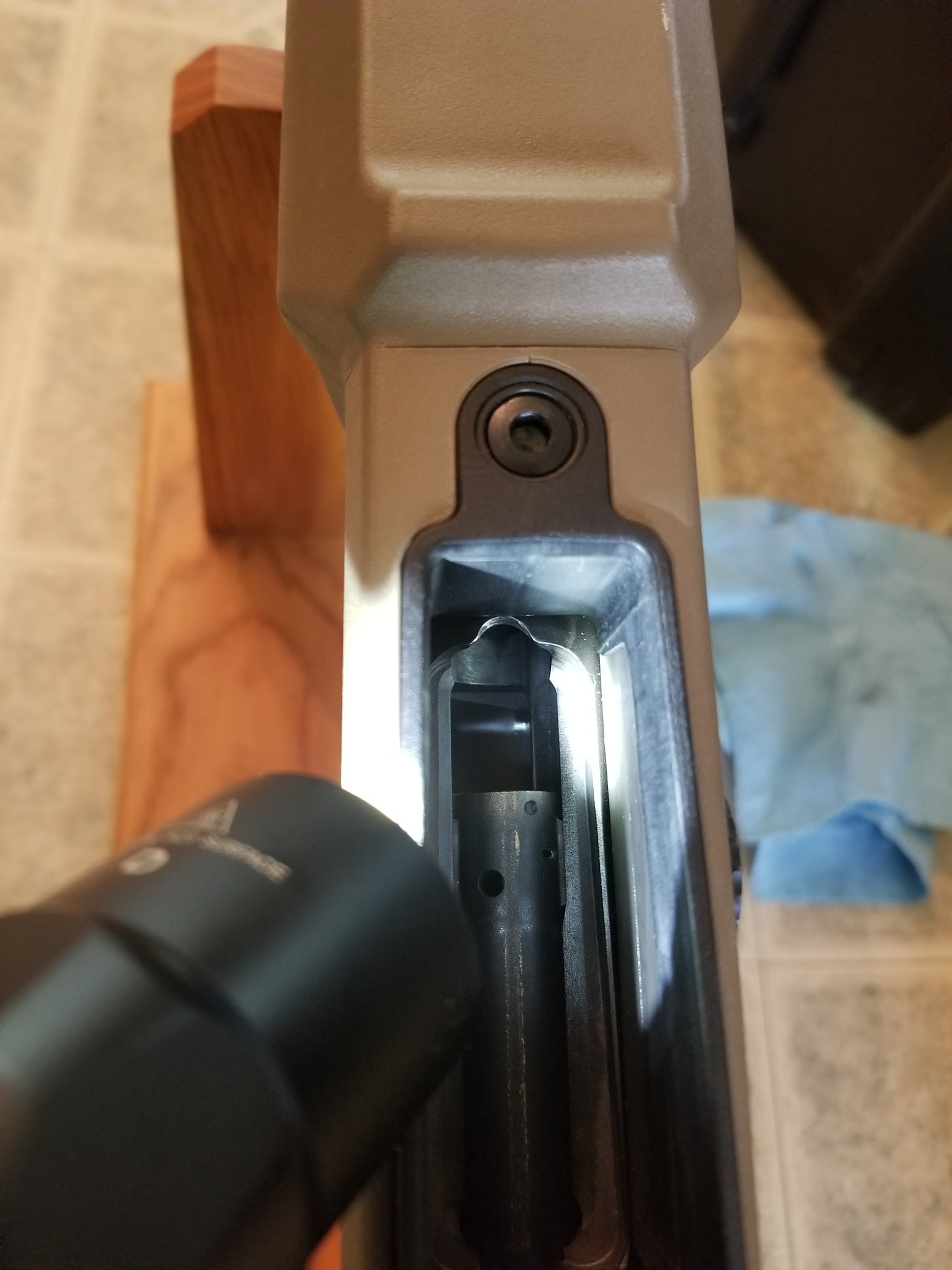

Mpa has a fix coming for this. A small plastic piece that fits into the chassis near the mag latch the keeps this from happening. I epoxied a piece of .125” aluminum in place that does the same thing. Works so well I did it on all 3 of my chassis.
