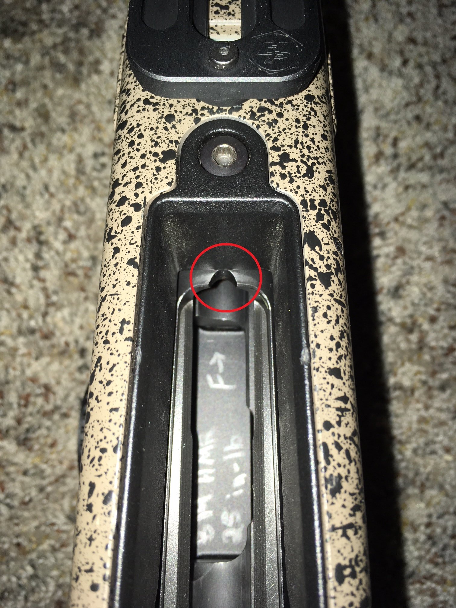

Oh man, totally forgot about the feed ramp notch, glad that video mentioned it. Did mine (VERY carefully) with a Dremel, beveled the top and bottom surfaces of the feed ramp just at the rim of the action in the front of the mag well. You'll have to do this, or have it done, to get anywhere near even poly mag length, unless the Premier action has a different clearance there than the original B14 action. Maybe they fixed that, hopefully they did.
Clean looking work.
Got me wanting to peek in mine now. :rolleyes:

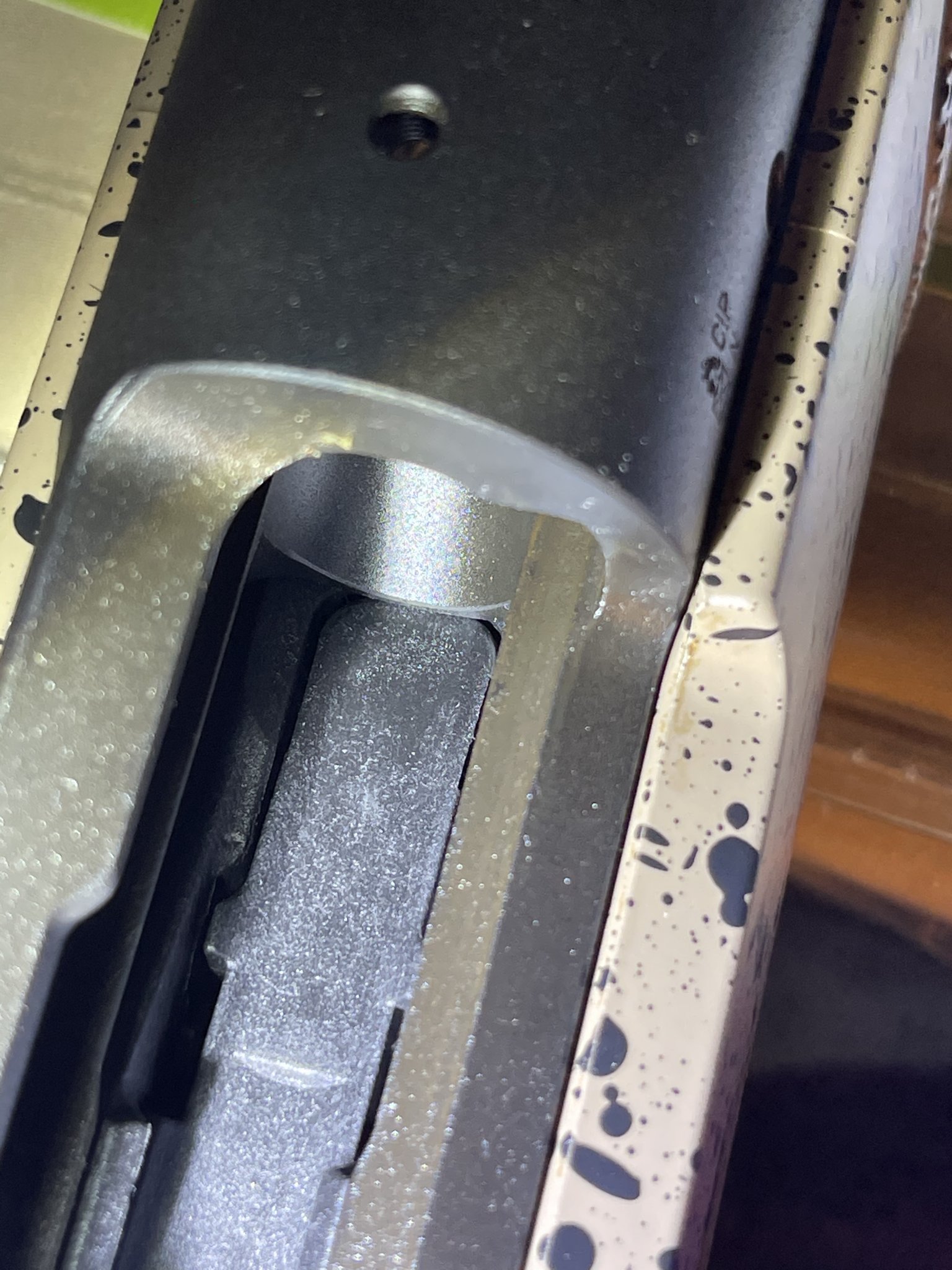

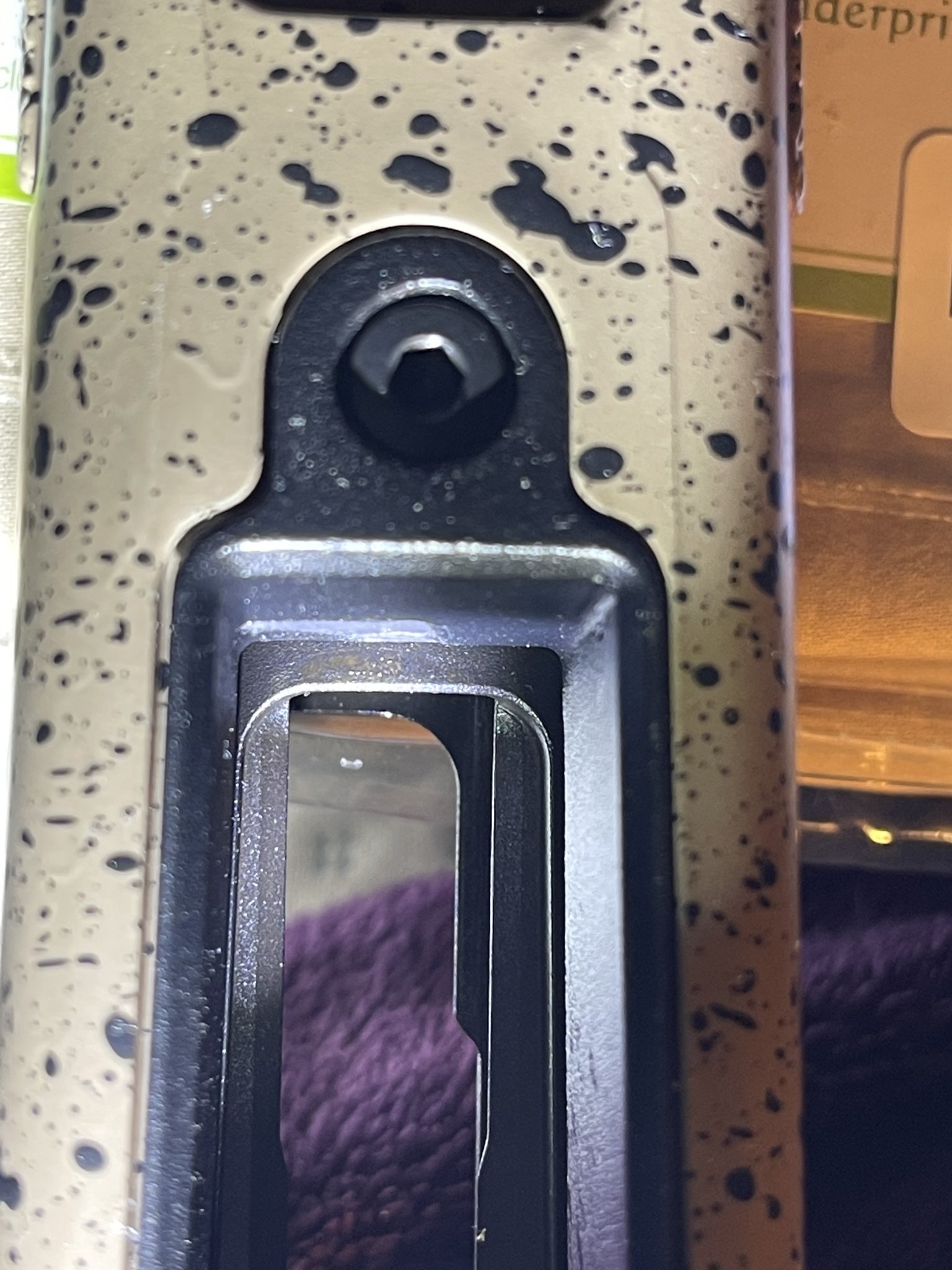

Well.....broke out the rifle and peeked under the hood....glad I did so.
I won’t be able to fully utilize the space in even the supplied mag unless I make that same clearance notch.
May become a moot issue once specifics are verified with chamber.

I'll say that it was an easy mod; I spent more time prepping for and applying the cold blue after the fact than I did making the notch. Best way I found to center it up on exactly the right spot was to load up a mag-length dummy round and mark where the tip hits the action, that's your spot.
Thanks for the info, I'd forgotten all about this and it's good to know that the Premier actions have the same feed ramp configuration. Lucky you though, you don't have to blue it since the Premier action is 416 stainless iirc.
