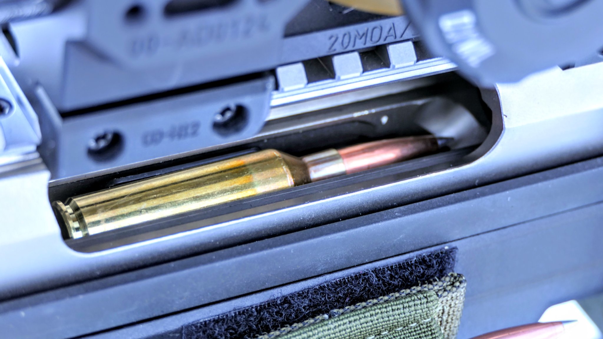

And you can buy MDT AICS magazine with or with out the binder plate.
With out the plate, you can use 6.5PRC ammo for the magazine, just testing one new rifle on that caliber.
MDT magazines are also cerakoted, so no problems of water etc.

I have used mine for few years now, i think they have spread a bit on the lip area.
But i have not modified the lips yet, only done some minow filing to the magazine front plate, where the ammo is leaving the magazine, filed the
sharp edge off the magazine, but i think i will open the lips a bit, so that the ammo would be a bit nose heading from the magazine.
Today i was shooting, and few times i had issues with the magazine.
But i would fix it also by timing the magazine fitting, i have a KRG Whiskey chassis.
You can tune the magazine tension, how tight or loose it will sit on the chassis, one great thing on KRG, among many other.
