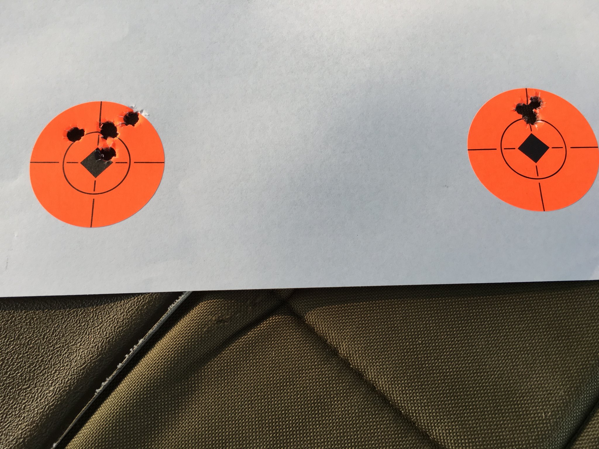

I'm doing load development for a 6mm Creedmoor. Currently using 110SMK Lapua brass and H4350.
41.0 shoots damn near .25 MOA and has an SD of 2 at 3035.
The issue comes when I take the magnetospeed off. Groups open up to 1+ MOA. As soon as I put it back on .25 again.
Any suggestions or should I just move on from this load?
I'm curious to see the suggestions on this. What contour barrel are you running? I run m24 and mtu contours and have never had this happen to me so I didn't know if I was lucky or if you are running a lighter contour barrel and the harmonics are affected more. I bought an MK machine mount to try out for the next load development I do to see if it makes any difference.
Marksman contour. Not what I would call light. Magnetospeed on right, not on left. 5 shots each.
I'd say you'll have to tweak the load in some fashion, your magneto is acting as a tuner. I had the same, marksman contour, 6 creed, 110's, but RL16 powder, groups at distance were amazing with magneto on. I went so far as to pull the suppressor, and put a brake on which did the trick, not where I wanted to be though. Not sure just what you could do here, mess with neck tension?

I will try shooting with suppressor next. The above groups are unsuppressed.
If that doesn't do it, any recommendations on what to try first? Powder charge vs seating depth? All my shooting was at .010 jump with the 110 SMK.
I have seen the magnetospeed improve groups and I have seen it make groups worse, depending on the barrel. You can't trust the results you get on paper with it attached. I'd suggest either finding a way to free float it off the barrel, or do your velocity gathering separately from the group testing/OCW on paper.

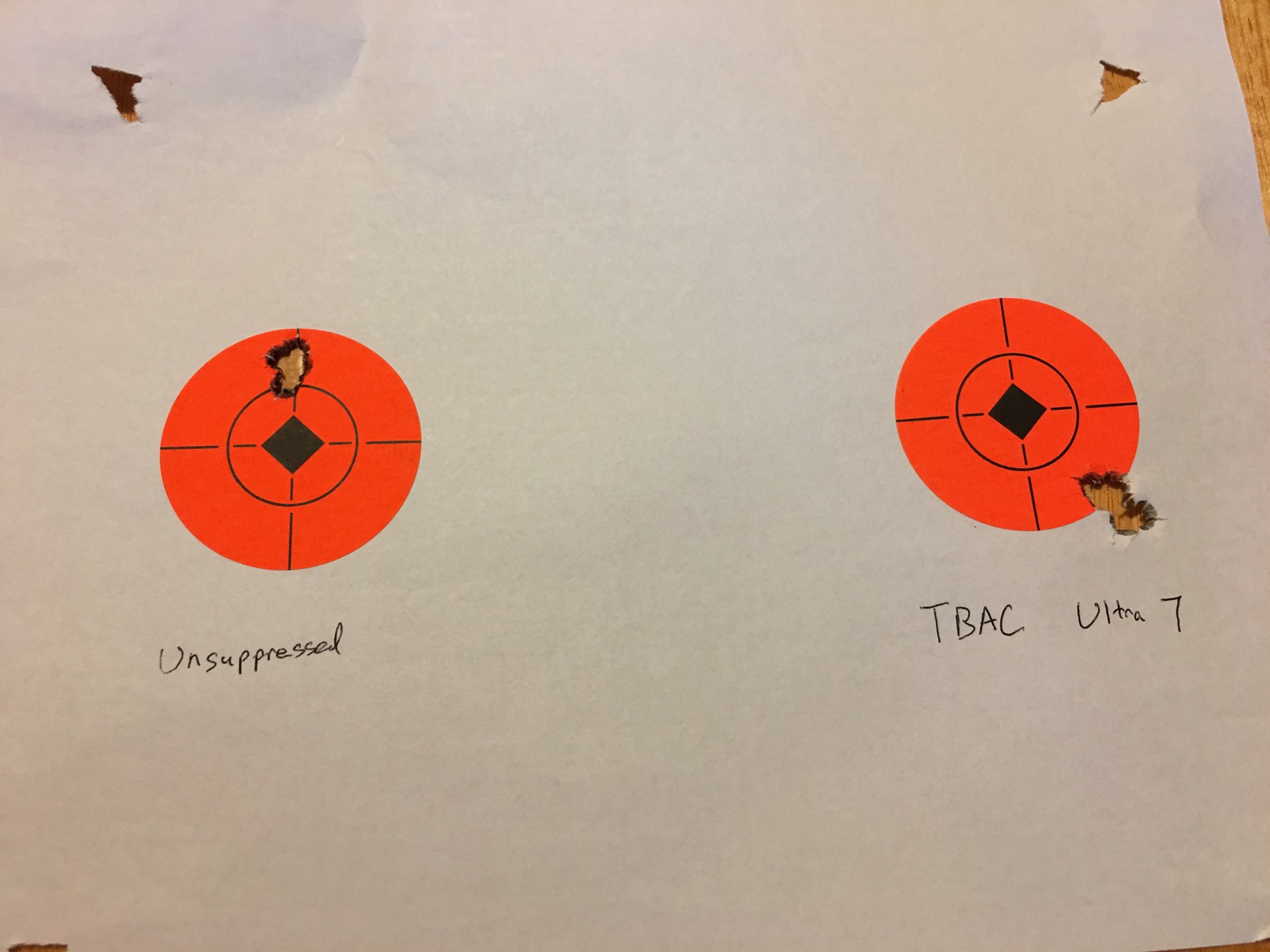

So back to the range, same load as yesterday.
Unsuppressed shot much better, in line with what I was expecting. It's possible the wind was blowing my target around yesterday, but it wasn't that windy.
TBAC group was also pretty good. POI shift was more than expected.
