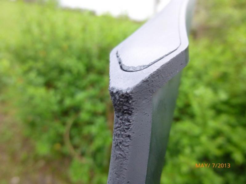

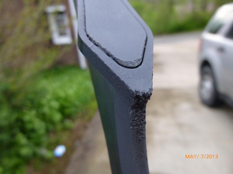

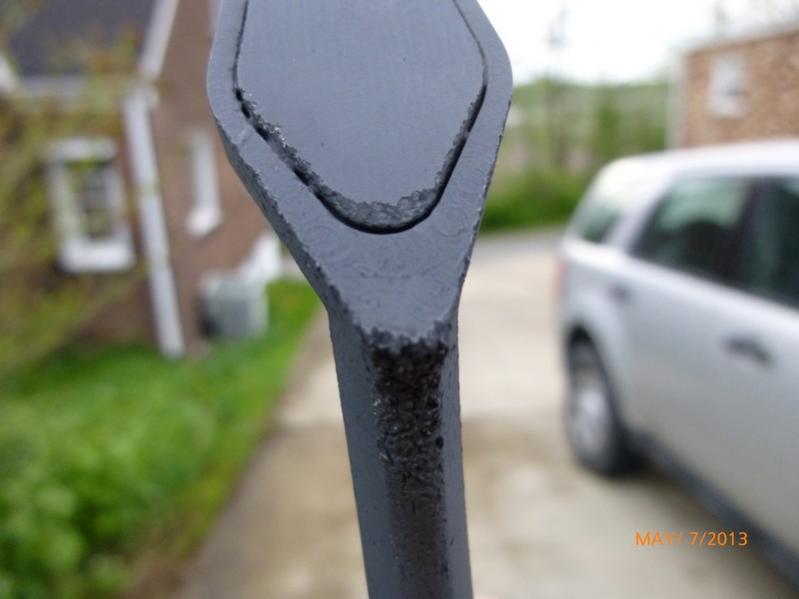

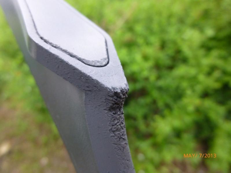

I have had my Magneto for awhile now and have several hundred rounds over the bayo.
Just wondering how many of you are seeing the material loss on the front side of the bayo I am.
Also, was wondering if anyone has mentioned this issue to them. The unit works great with no issues,
however, I am concerned with how much longer the bayo will last with this material loss from the muzzle
blast.
Terry
