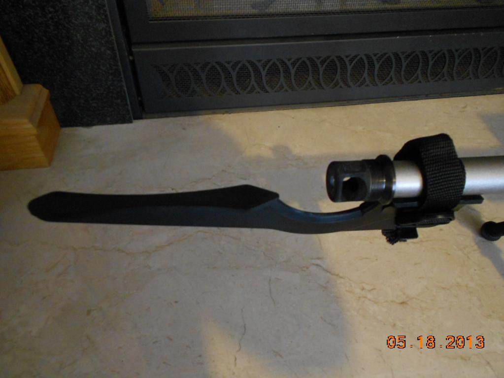

I had mine for awhile now and absolutely love it. The only reason I'm considering selling it is to get the V2 version now that I've got suppressor on all my rifles. Here's a pic of it installed on a 22" Rock MTU contour with a Thunderbeast 30 BA brake.
