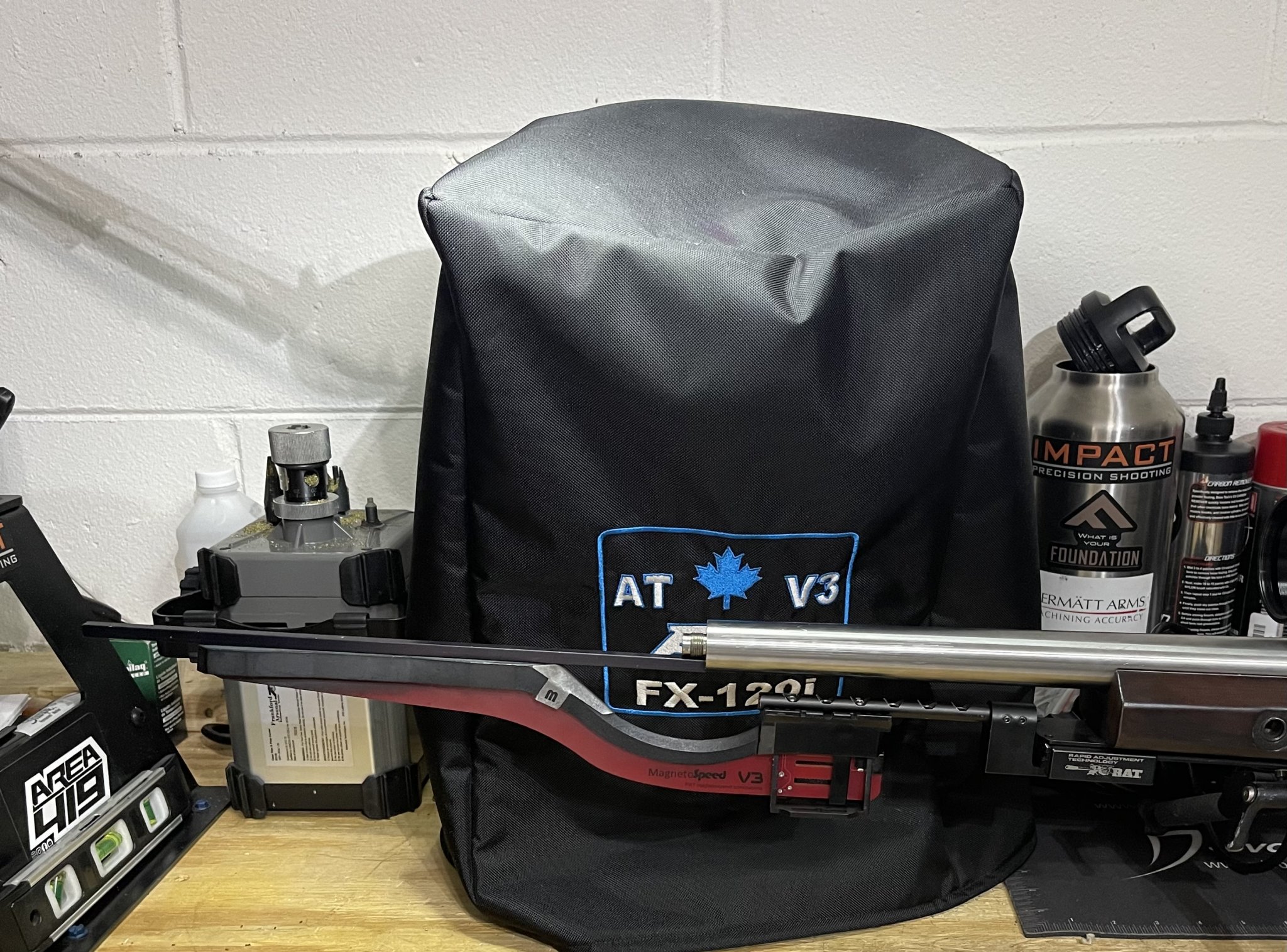

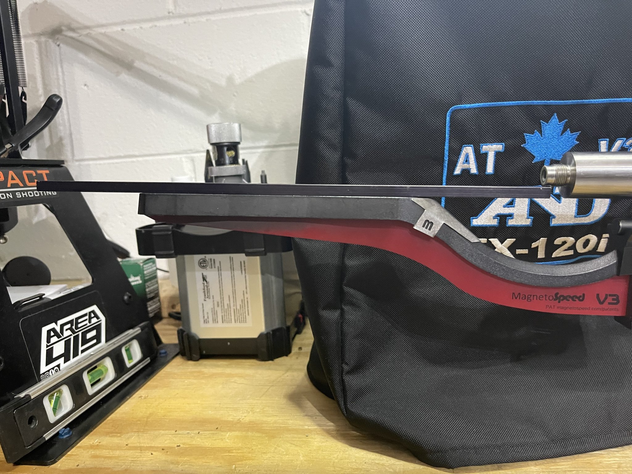

    Slightly low but alignment wise I think I’m good. Thoughts?
