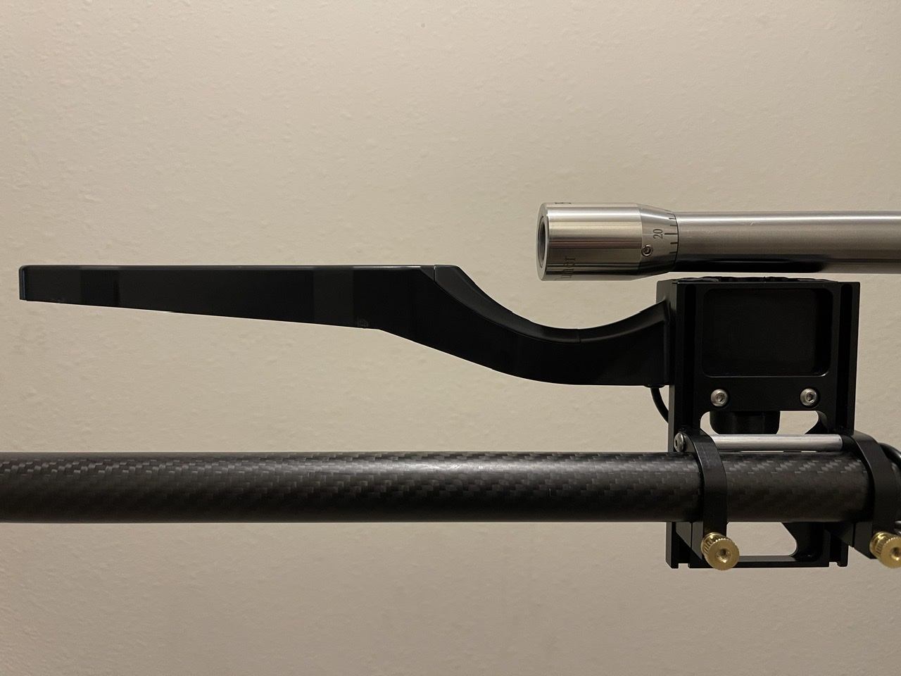

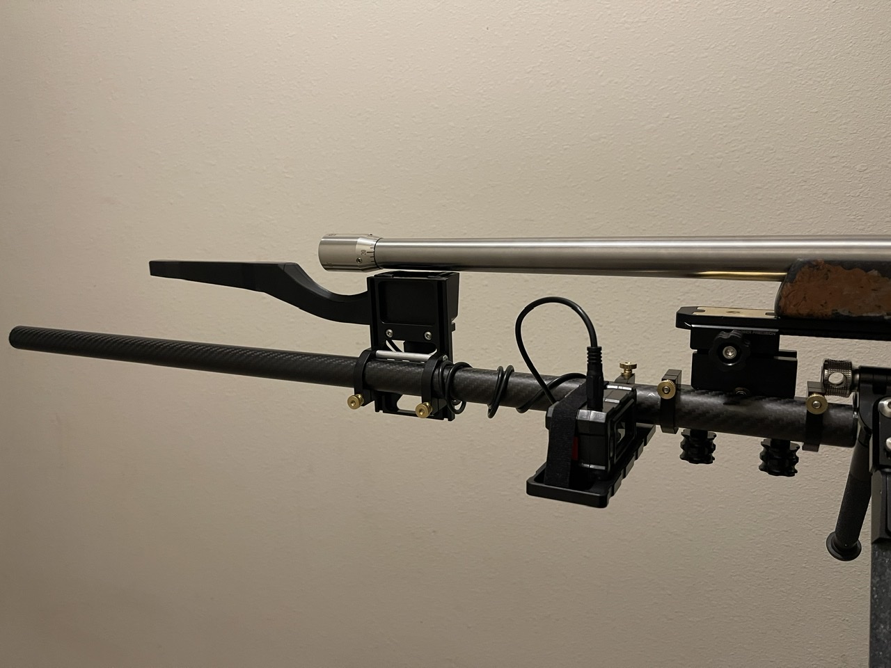

I have done the same with my MagnetoSpeed Sporter - mounted on a bracket and cut 1/4" from the bayonet top. It is 100% reliable using Hi 2 sensitivity.
