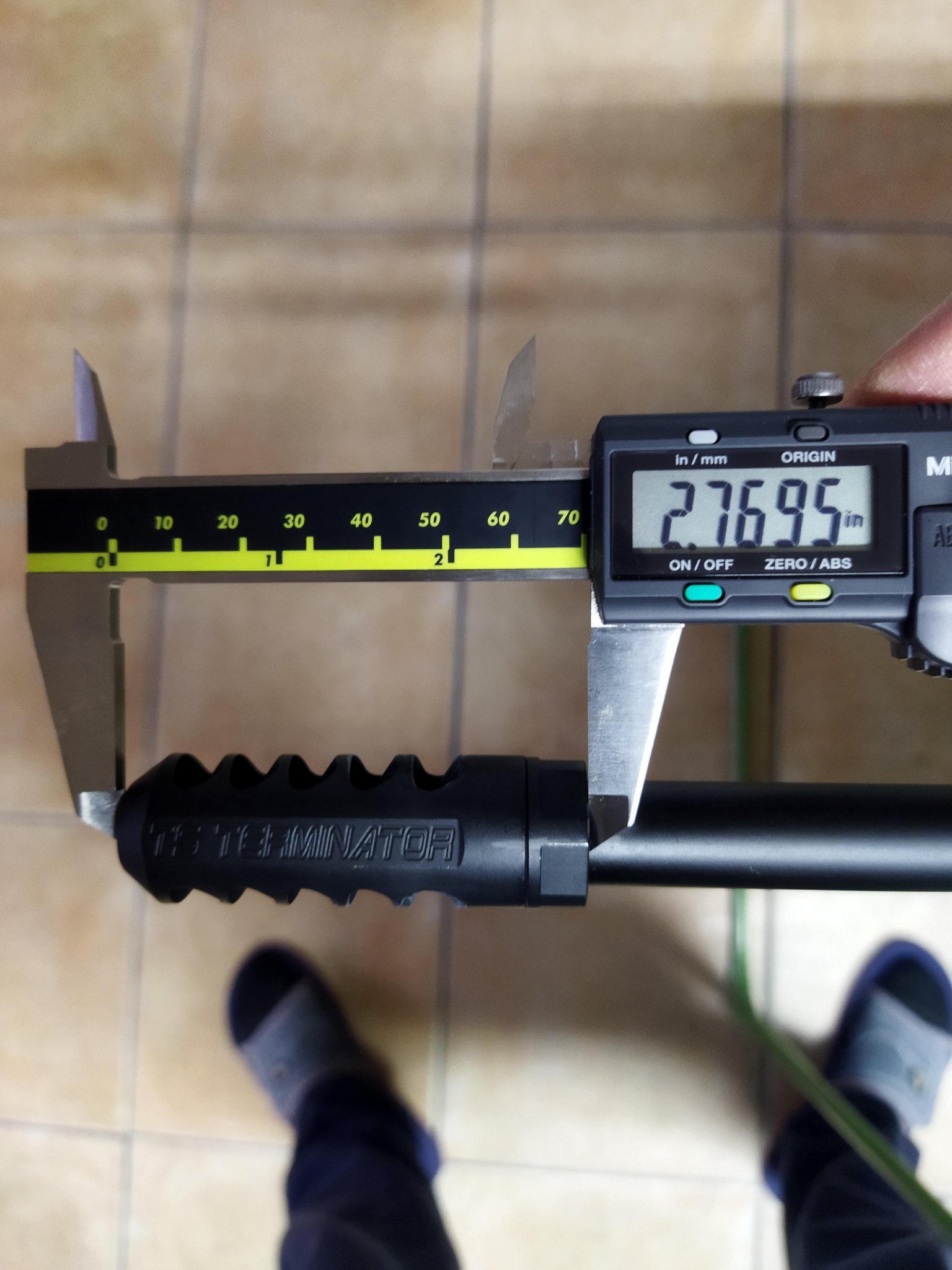

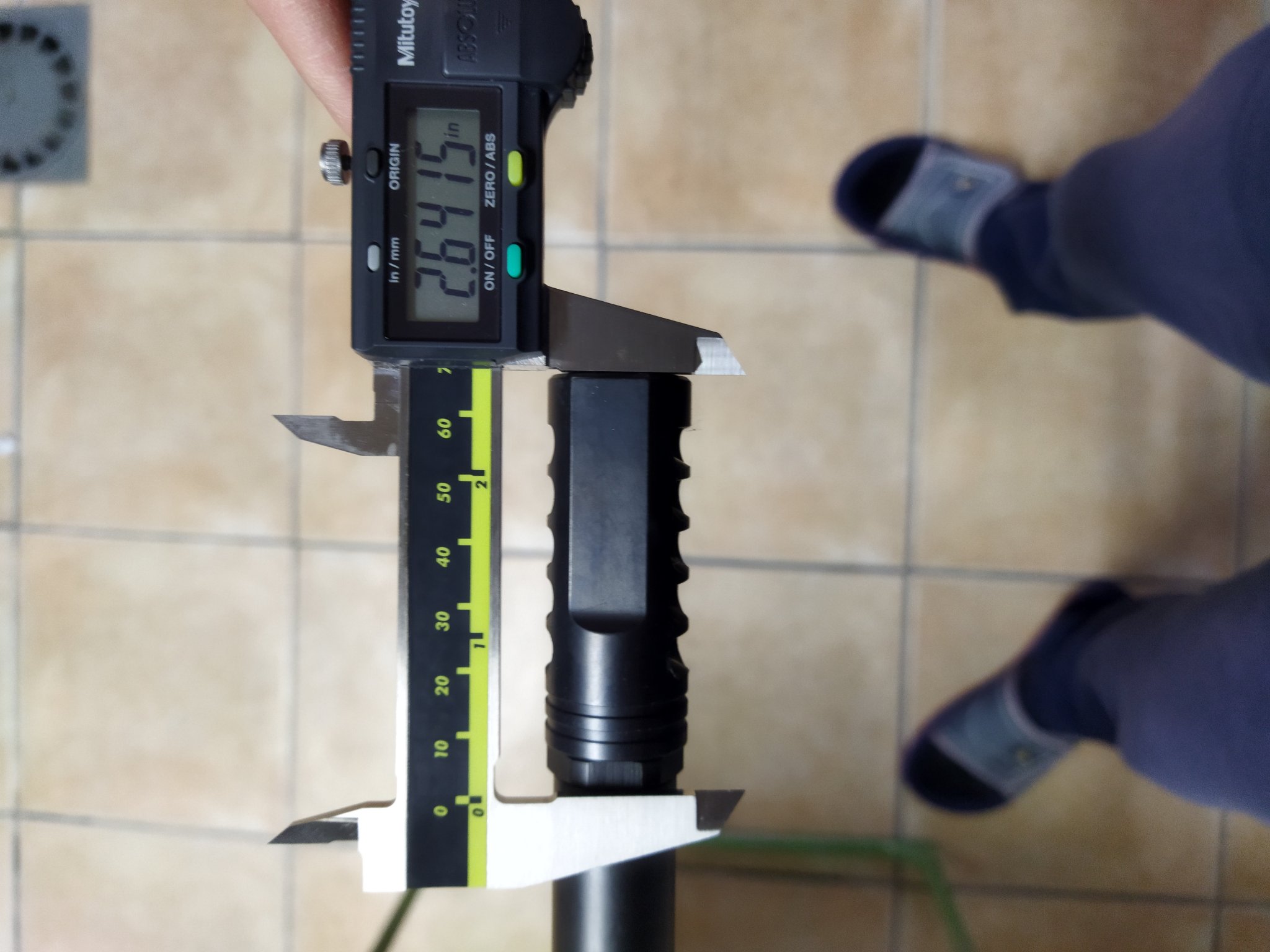

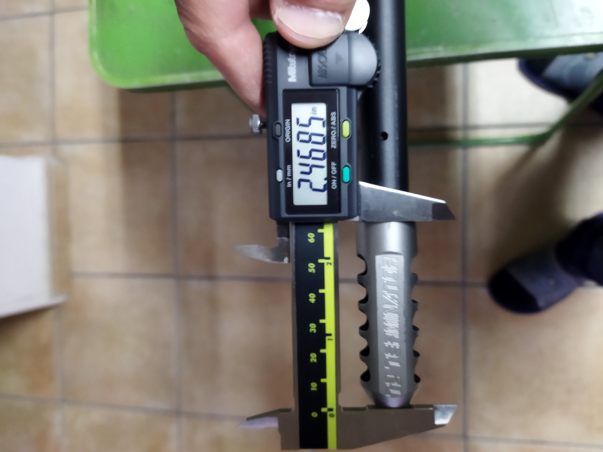

Can you tell me if magnetospeed sporter will work with my muzzlebrakes?
I give you some photos with the measurements
Likely not. I have a 4 port Heathen that's shorter and I have issues occasionally with mine.
I have always wondered if the velocity readings need to be taken with the brake on? Like will it make a difference if I shoot a few without the brake to get velocity, then put it back on?
Should work. I've brought it out closer to muzzle exit on some brakes by wrapping the strap around the brake's nut right before the first port, then shimming with cardboard under the barrel.
