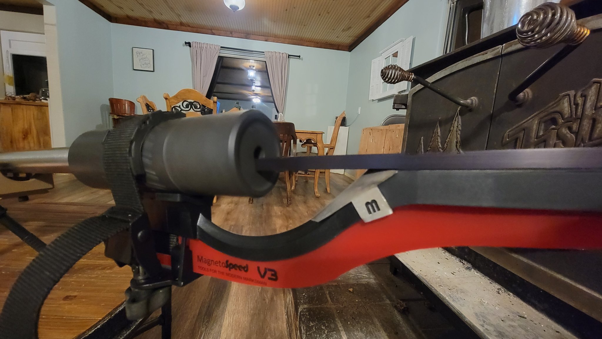

Here's a picture of how I had it set up today. It's a titanium can so I'm not sure if that has any magnetic properties. 30 cal can and 6.5 bullet.

You have an issue. Contact magnetospeed. I have the V3 and have run it on my TBAC can on 556, 260, 6.5, 308 and 300 without one single error
I run mine about 1/8” lower than yours. The top of the square stock is at the very bottom of the suppressor opening or just below it
Yeah, on this dominus it seems like I could use a in-between size shim but it was locked on good and it didnt get shot off haha.

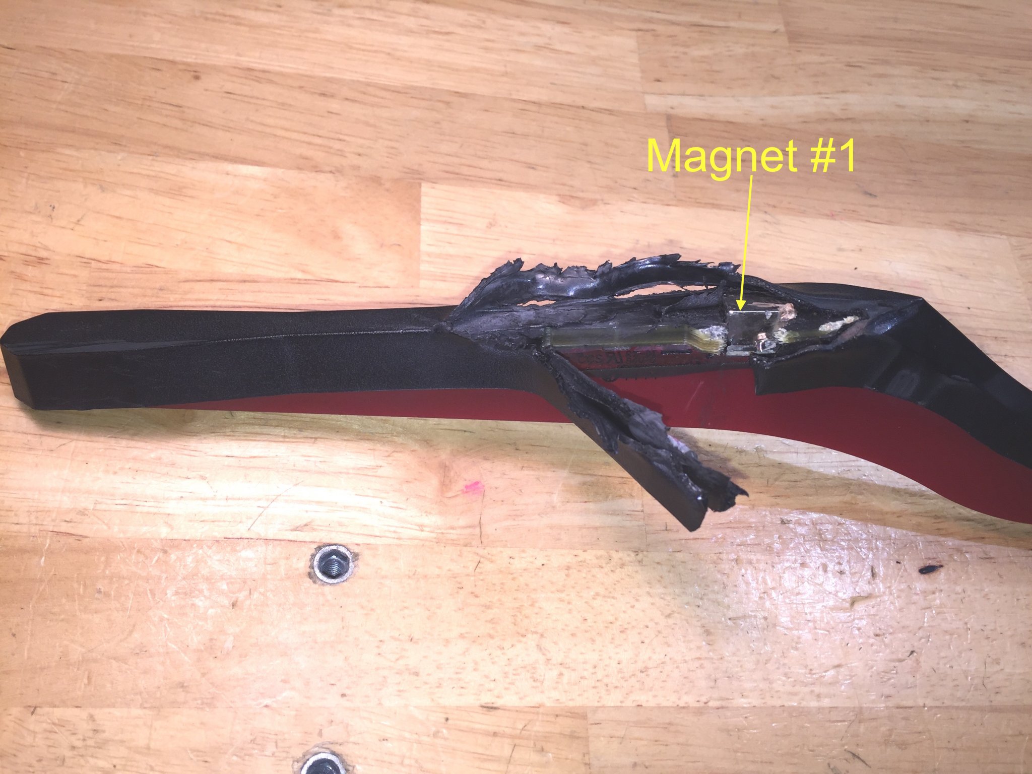

You will want to use a alignment rod in the bore and make sure your 1/4" min clearance to the sensor deck is proper.
When hanging the bayonet off the supressor you will want to check the clearance every other shot or so; a little bit of recoil induced slacking on the tightening straps may cause device misery. IF you were wondering where magnet #1 is located.
Below , when I first started using the V1; didn't check it often enough. Moved on to a rigid free-float setup with the V3.

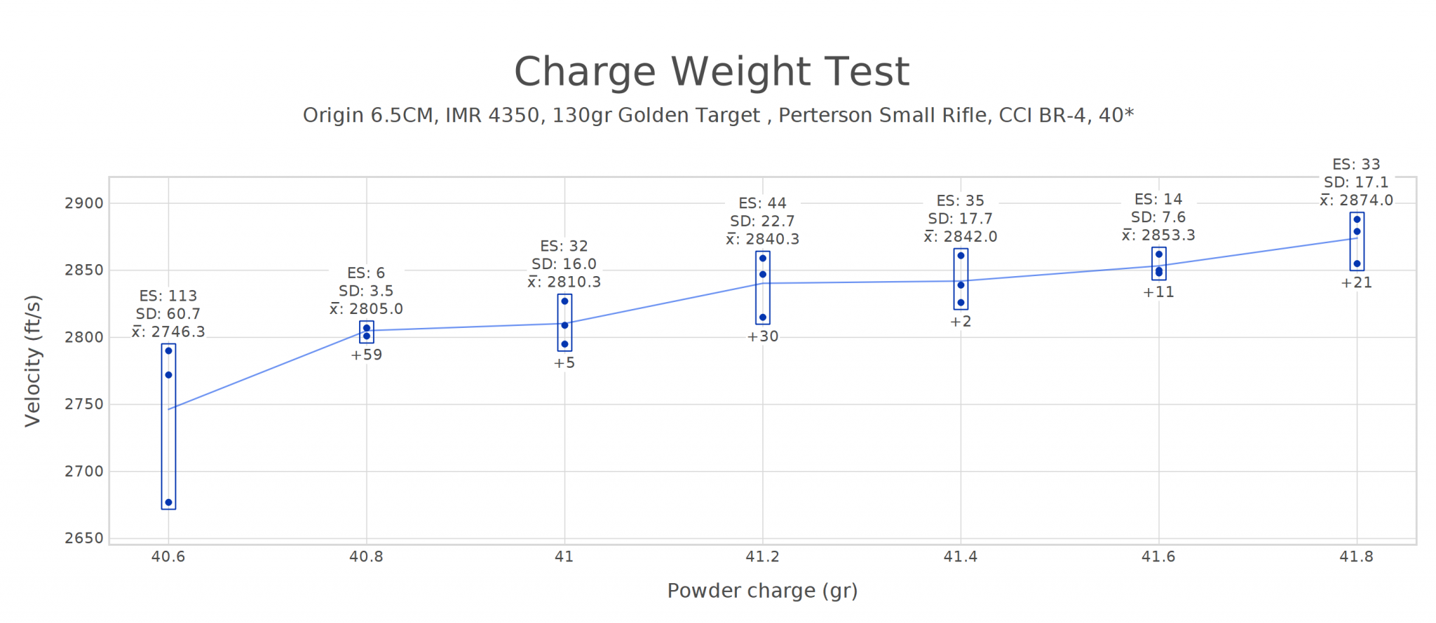

I’m sorry but a bit off topic could you share details on this excel graph?
