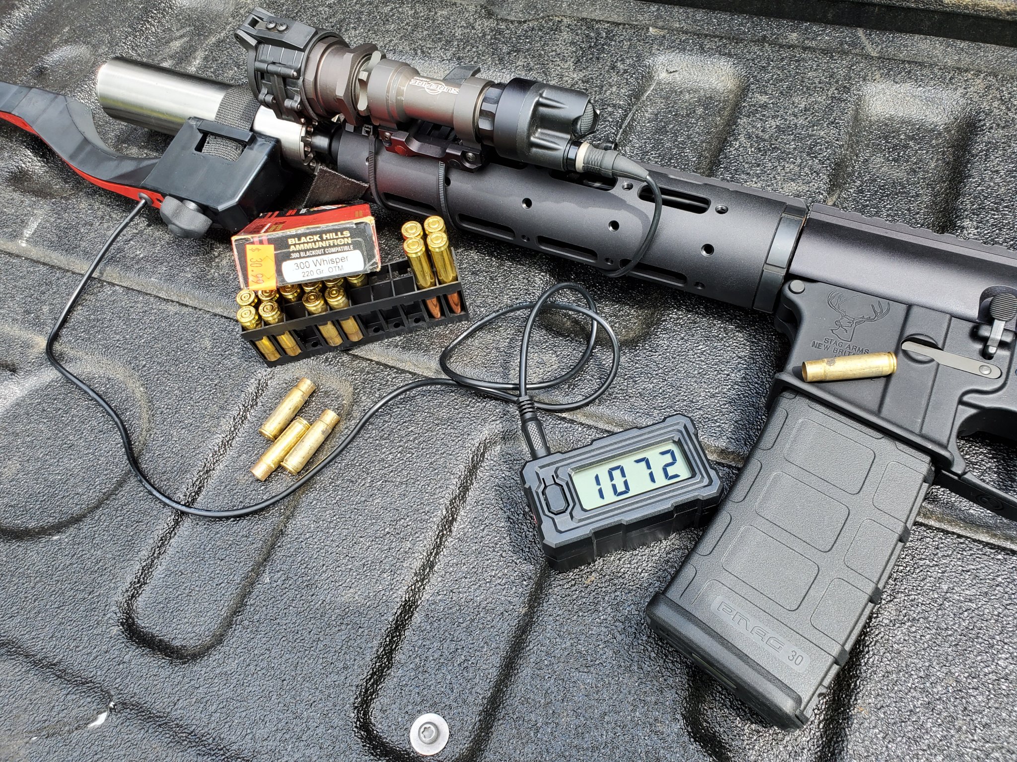

I run the sporter with suppressors all the time. It's extremely rare for me to shoot without a suppressor.
I don't have any pics handy of it on .22LR, but I run it just like this without any spacers and it works fine with suppressors
Reactions: Just Chuck
