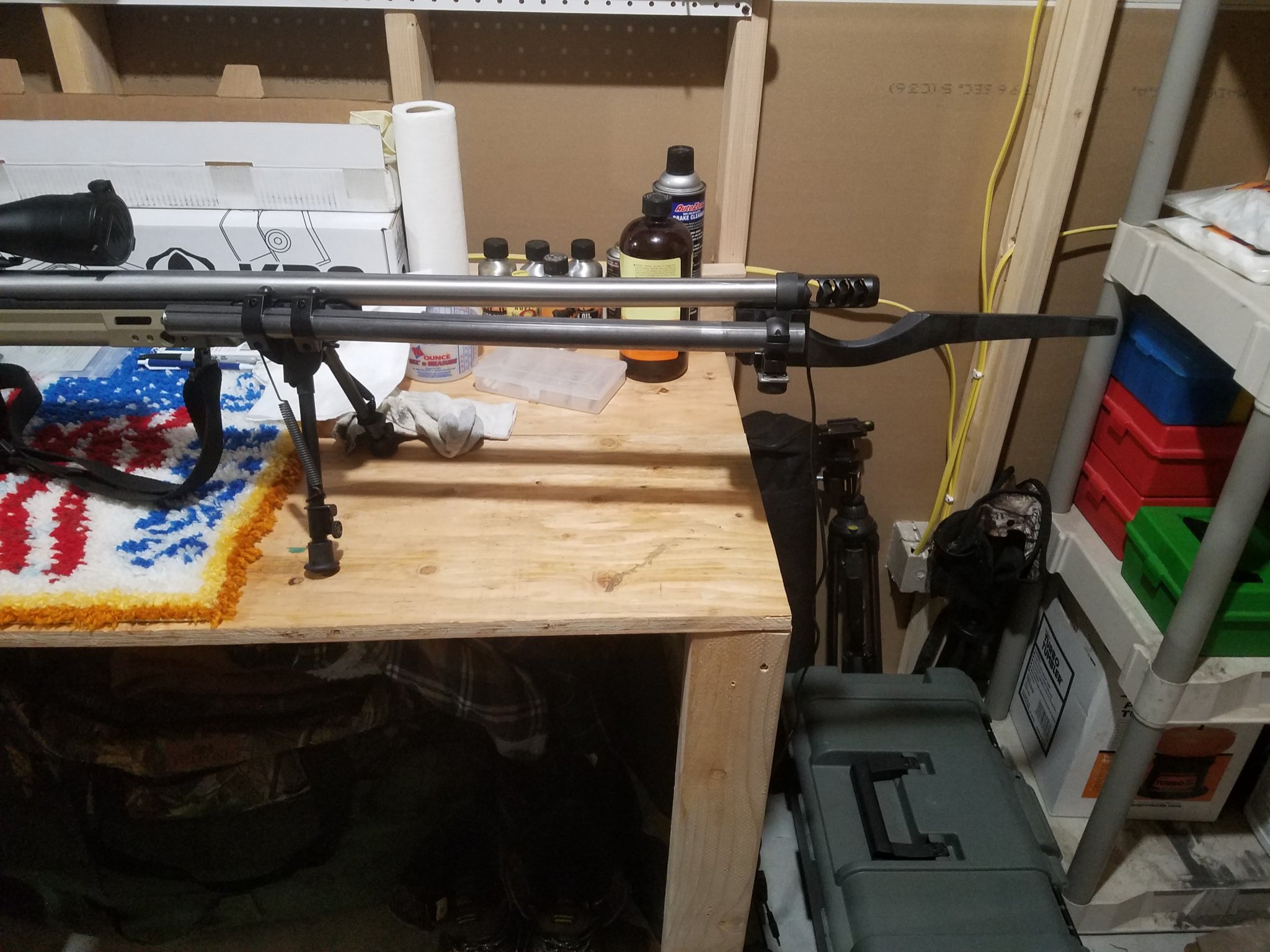

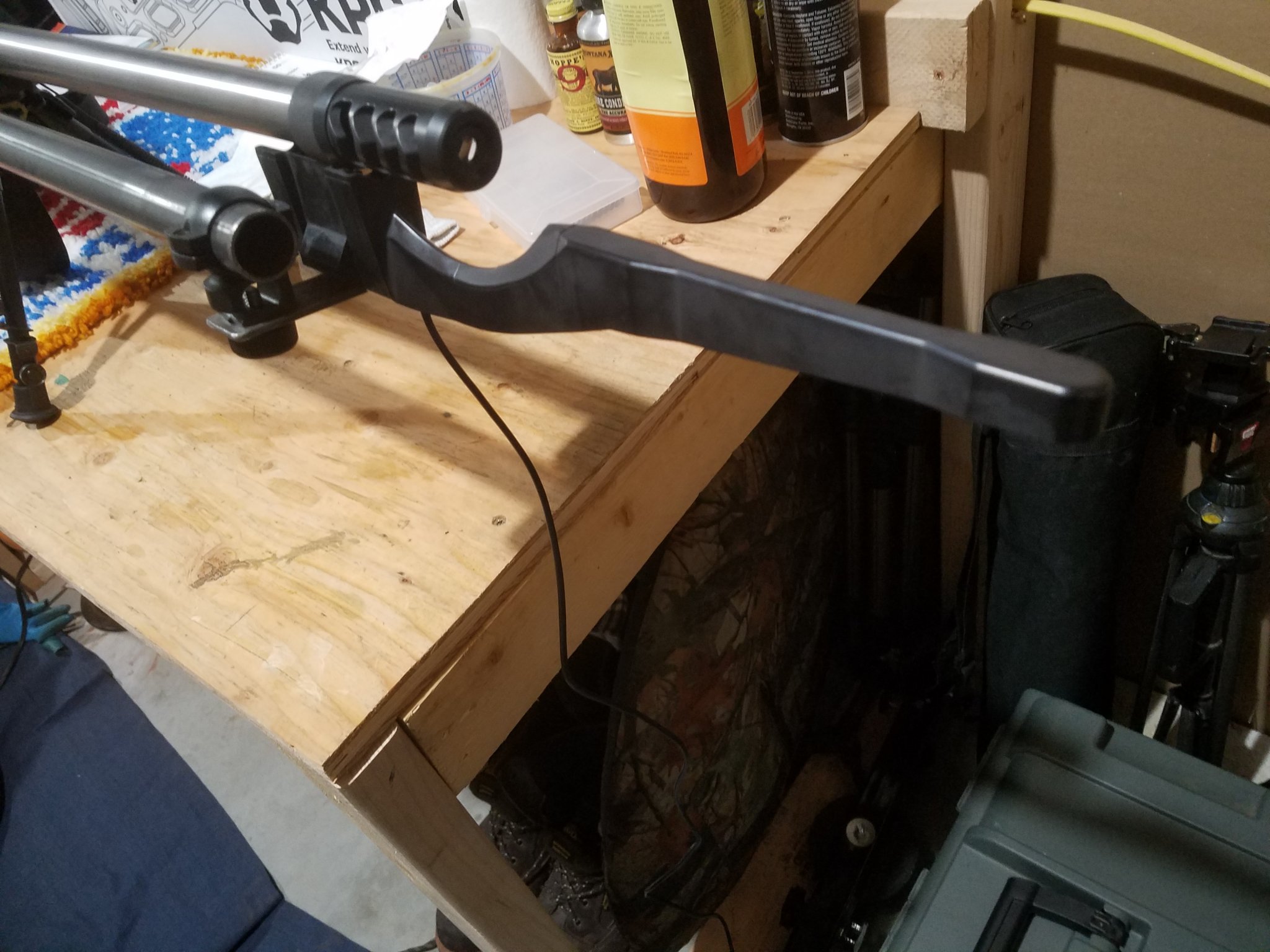

If your still fighting consistent v3 readings attached to the barrel you can "build" a offside mount. I use a small pic rail section with the cheapest 1 inch weaver scope rings i could get, 1 inch tubing and flat strap. The end ring holding the bayonet i removed the cross bolt and ears then drilled and tapped the bottom for a bolt. This combo works fine on my 7mm rem with a sidewinder brake

If your still fighting consistent v3 readings attached to the barrel you can "build" a offside mount. I use a small pic rail section with the cheapest 1 inch weaver scope rings i could get, 1 inch tubing and flat strap. The end ring holding the bayonet i removed the cross bolt and ears then drilled and tapped the bottom for a bolt. This combo works fine on my 7mm rem with a sidewinder brakeView attachment 7844672View attachment 7844673
Thanks. That's an excellent approach to solving the problem. My muzzle break exceeds the Sporter limit of 2.7". The v3 accomodates a larger break and should solve my problem. I appreciate the time you spent on providing this response.
Sure thing, an ah yes your correct i had a mix up of the v3 and sporter... my thought process after graveyard shifts is typically scrambled haha
