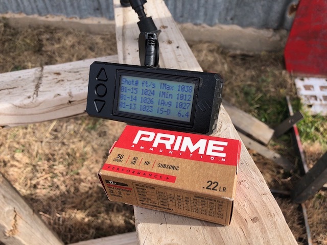

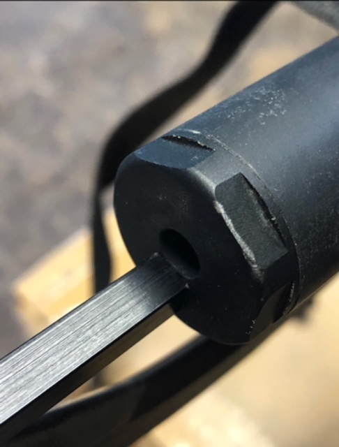

I had my sensitivity at 7 and try to get the bayonet so that when you put the provided testing rod that it is very close to even with the bore (as seen in my picture)As for the bc use .145.
That is an incredible sd out of 22lr!!!
