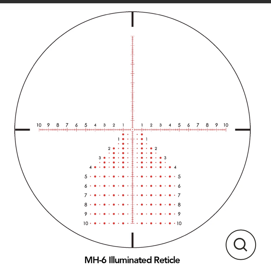

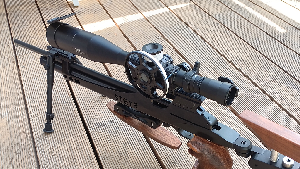

magnification whores, check this out

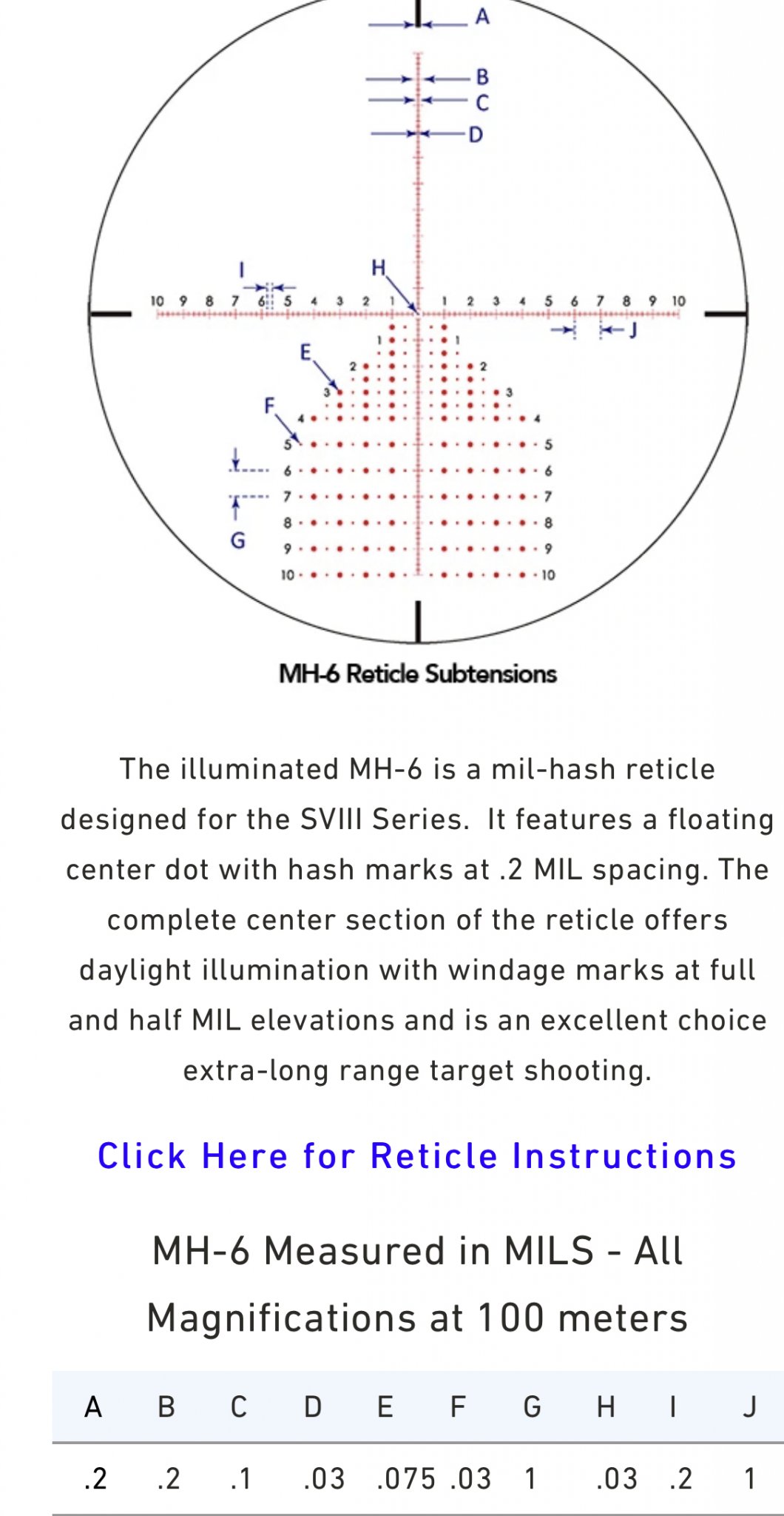

I like it a lot. It checks all of the boxes that everyone always goes on about.
- MH6 tree reticle
- .2 mil gradations
- zero stop
- 10 yard parallax
- 8 times power range
Add to that, it includes the 40mm rings so you don’t have to go trying to find a unicorn. Plus the price, while spendy, is under the price for a Nightforce 7-35 and I know that Sightron will deliver on the glass side of things. This just may be the Sightron holy grail that fans have been waiting for.

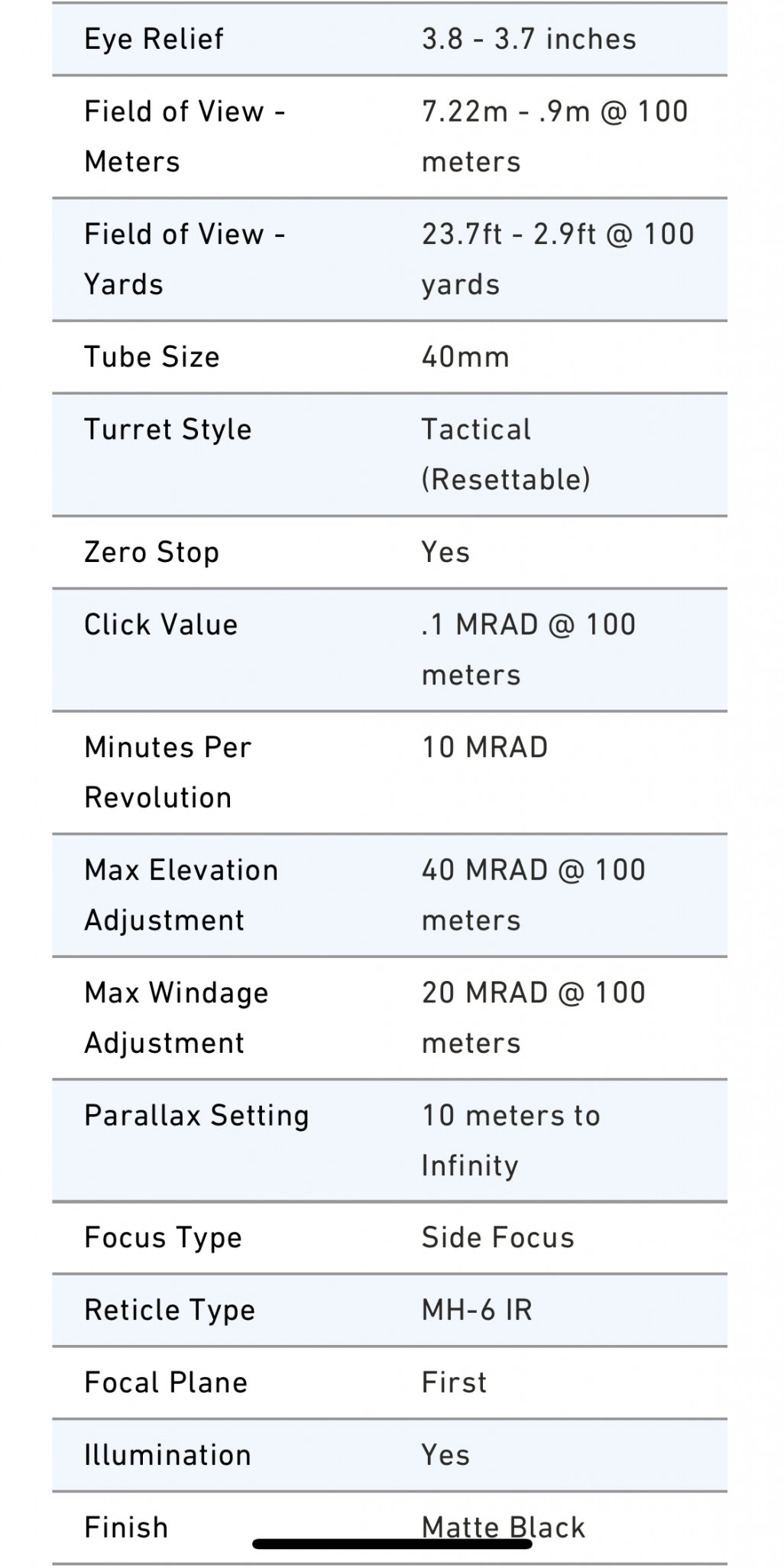

That image makes me want to slap whomever added '@ 100 meters' to click value and adjustment range. Just list the MIL values and leave it be, dammit.
Marketing guys are gonna market. They don’t necessarily know what they are talking about. It would be nice if they tried having an actual knowledgeable person review the materials first, but it seems to always be the case that that step tends to get short shrift.

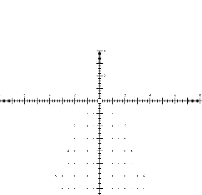

#2. that reticle looks really close to this one we all worked on here on the hide. I am glad someone is watching.

exactly your design :D
but I like sightron's more, because it has all numbers on the elevation line, not just even ones. but on windage line only even numbers would be better.

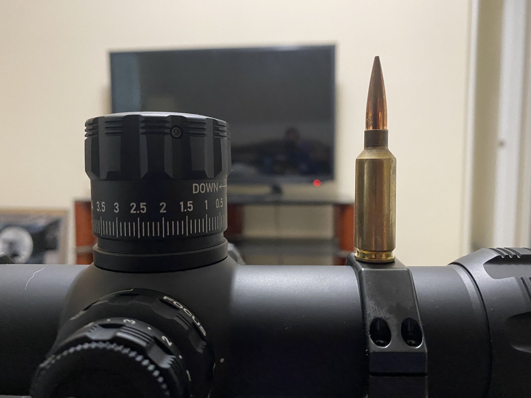

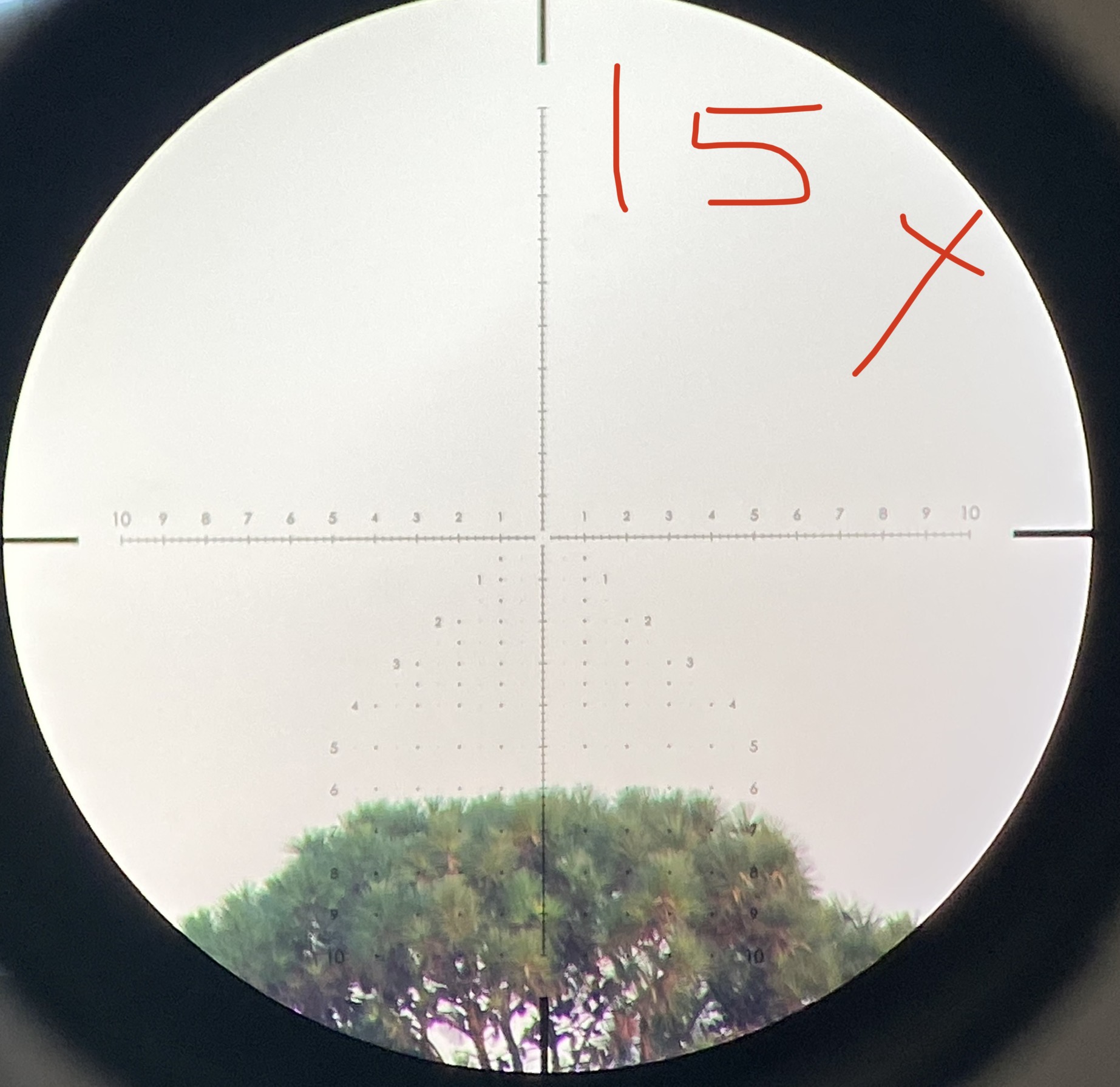

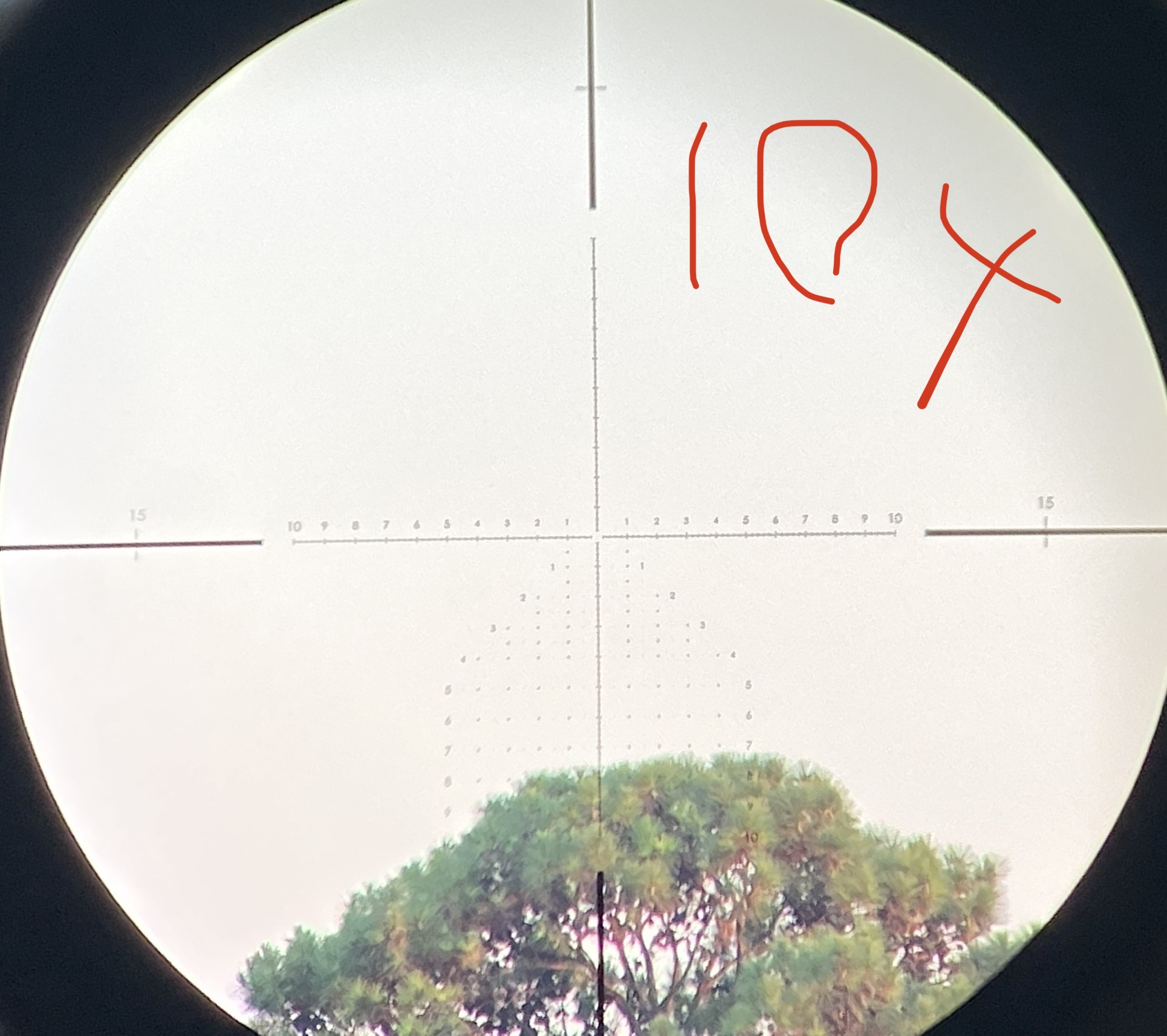

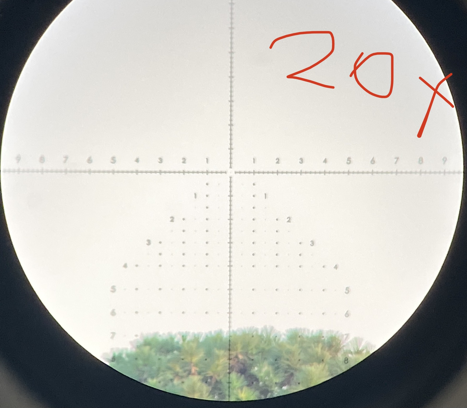

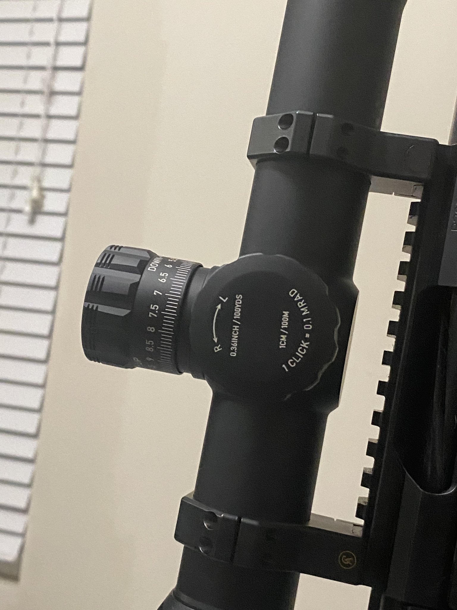

Just received my SVIII 5-40X56.
I apologize for grammatical errors in advance…immigrant here!
Disclaimer: I don’t work for Sightron nor I am getting any reward for this review. I paid for the scope with my own money.
First impression is that the thing feels/looks HUGE. It seems, however, that it’s size is exaggerated by a 40mm main tube and pretty big turrets as it doesn’t appear much bigger than my Kahles when put side by side. It is noticeably heavier, by a pound to be exact. Not an issue for me as it will be used either for PRS or ELR style shooting.
Fit and finish appears to be very high quality. Parallax, eyepiece and mag rings are very smooth and have just about perfect amount of resistance, which is subjective and preferential of course. I like them on a stiffer side.
Turrets…again things are effing HUGE, which I personally like. It allows for a “larger click spacing” and larger number markings. It also has a number marking every 0.5 mil. I do wish clicks were a bit more stiff and tactile, but I never really understood why people make such a big deal about the way turret feel. As long as they track and have enough resistance to stay in place I don’t really give a shit, but again you are entitled to your own preferences. These turrets feel very much like Mark 5 turrets to me. They are 10mrad per revolution and I counted a total of 42.9MRAD of internal adjustment!!!
Zero Stop is of a simple, robust and very common design. Nothing to complain about here. See pics.

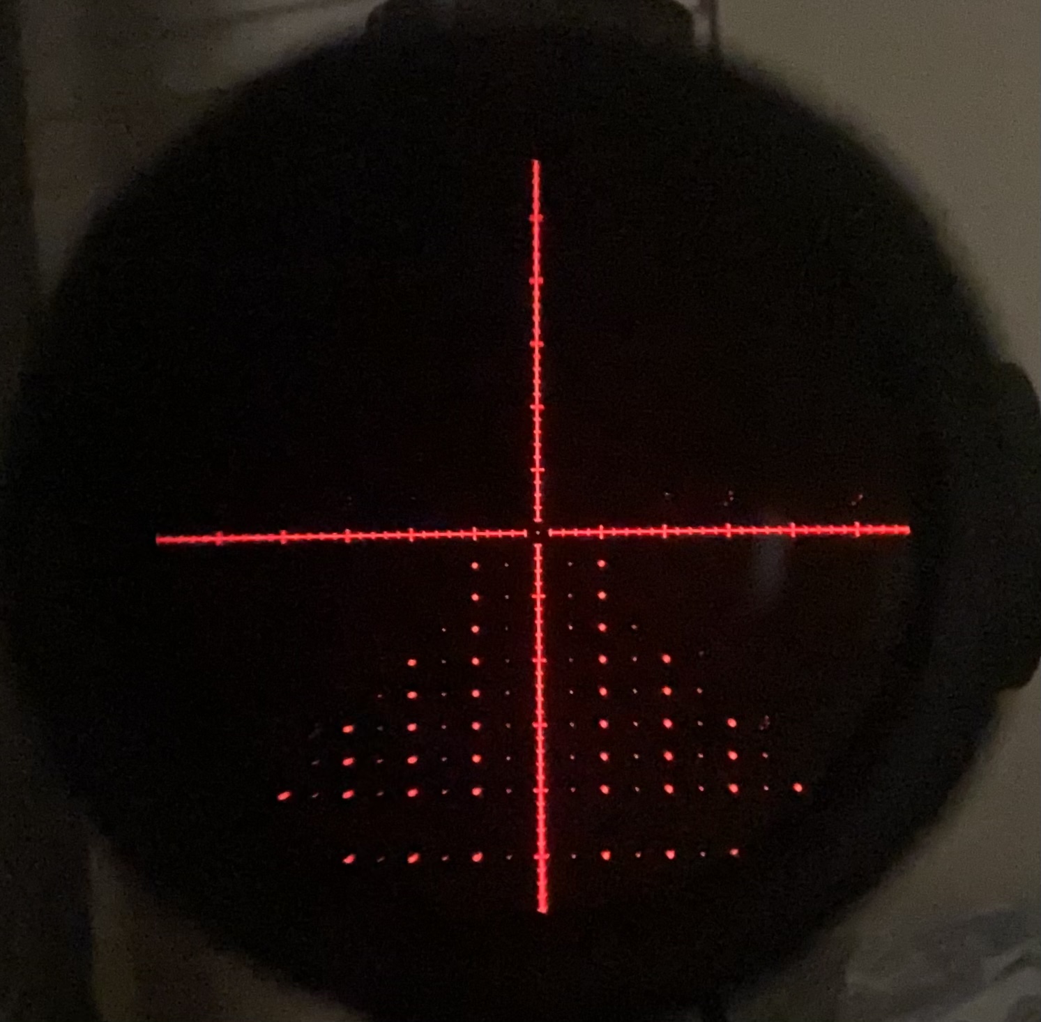

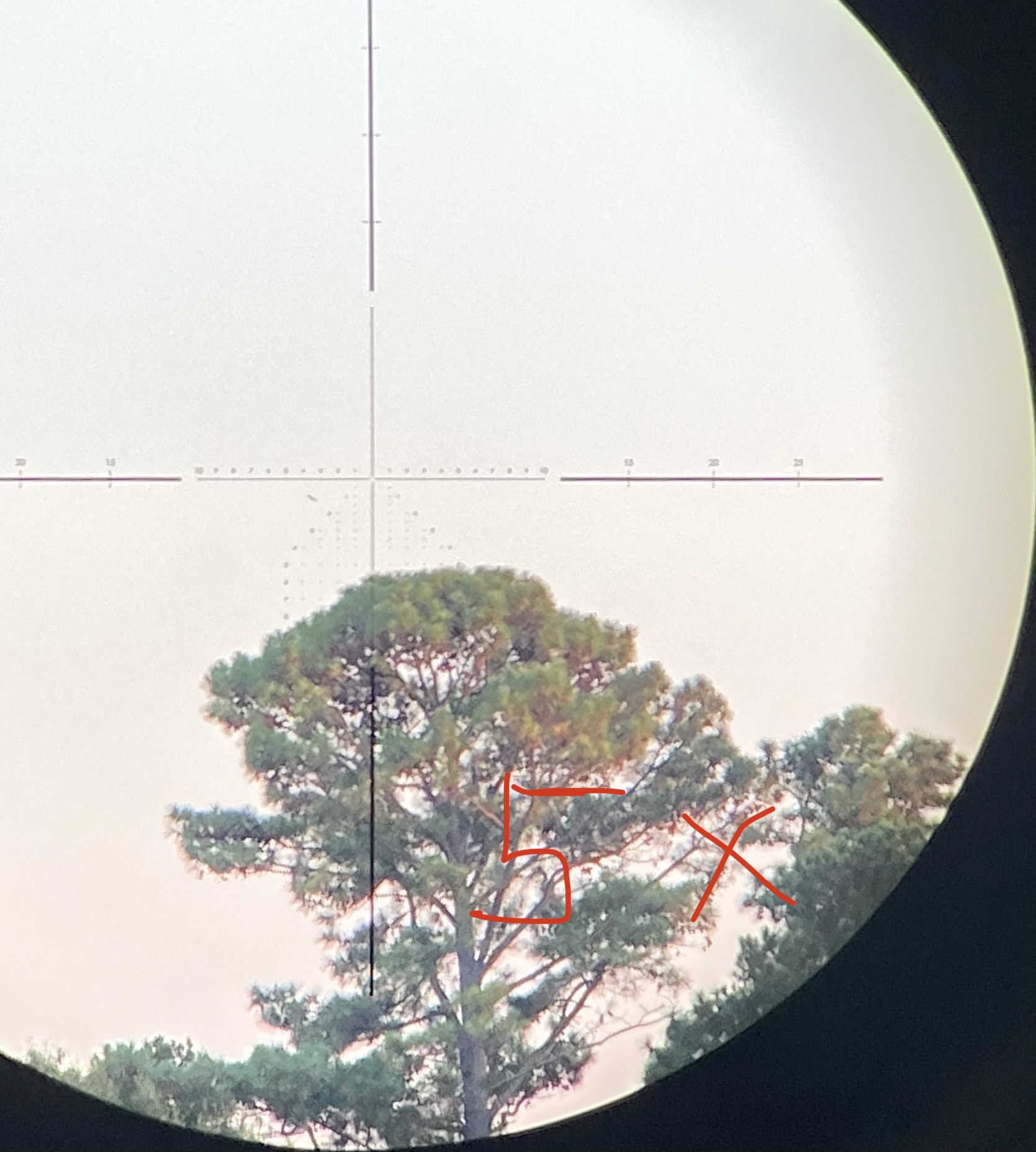

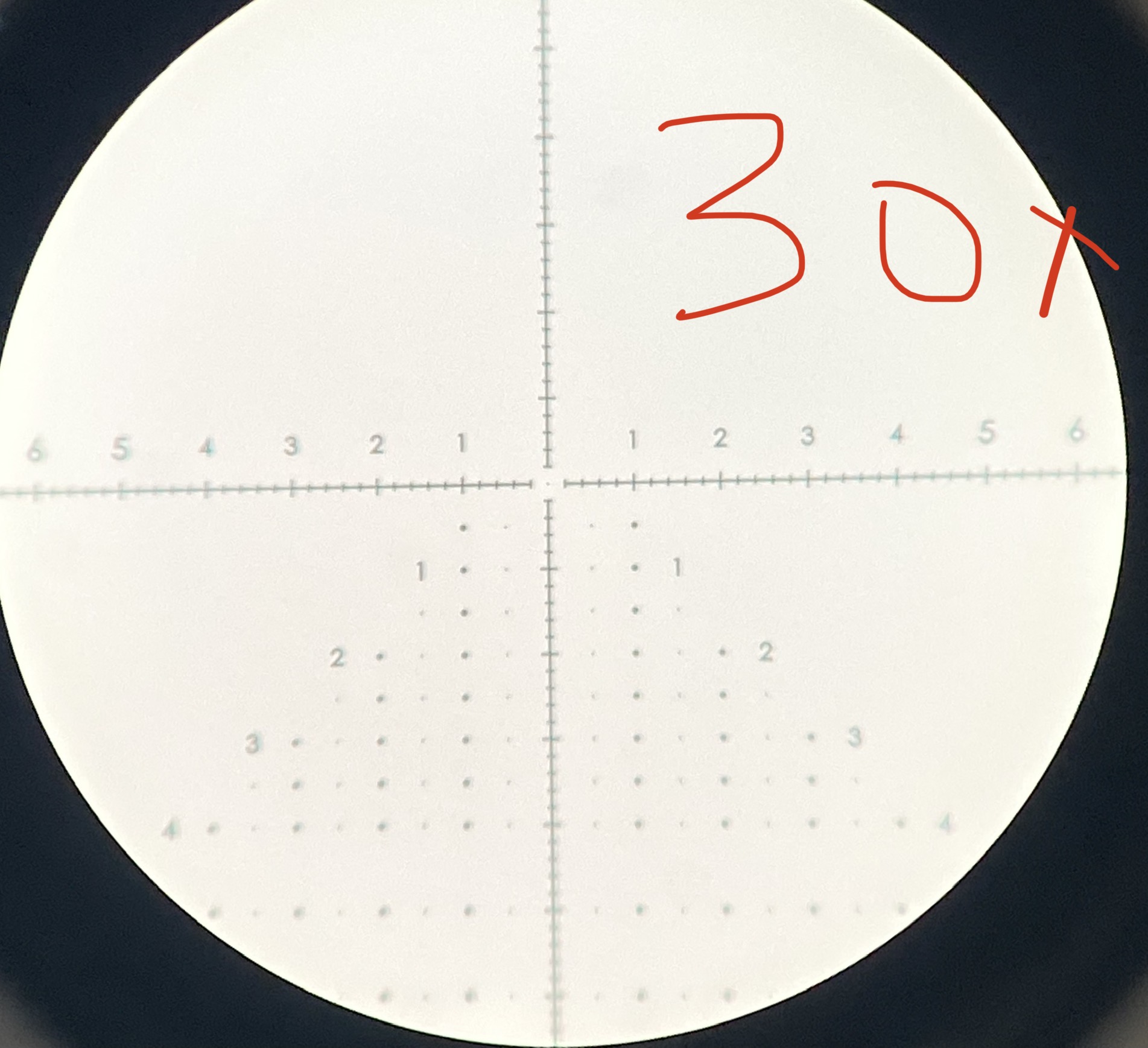

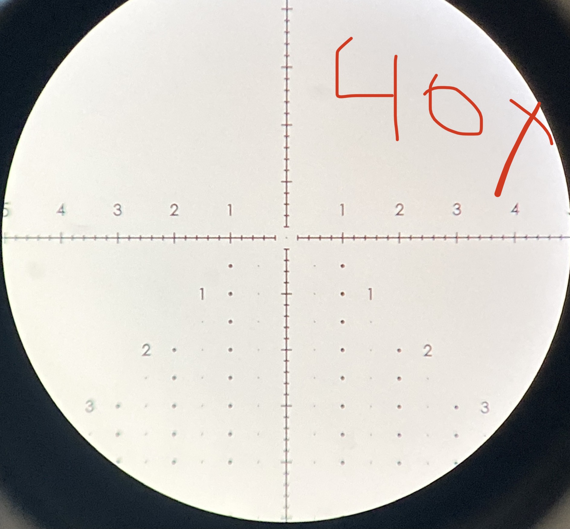

RETICLE!
Reticle was my main concern considering that the center dot and stadia lines are 0.03MRAD according to Sightron (center dot looks smaller than stadia lines to me). That combined with an 8x erector made me wonder if the reticle is unusable/unreadable at lower powers. I was pleasantly surprised that it was nowhere near as bad as I anticipated. At 10X I can read .2mrad hash marks, but can’t see 0.03mrad center and “tree” dots that are located at every .5mrad. I can, however, see 0.075mrad “tree” dots that are at every mil. At 12X I can see everything on the reticle, but it’s still very small and I can already hear bitching from PRS guys that suck at “pointing” their rifles and like to shoot around 12X. At 15X no one should have any complaints about seeing every bit of information on the reticle. The reticle really starts to shine from 15X all the way to 40X. The center dot and smaller “tree” dots remain fine and unobstructive. Even larger 0.075mrad dots are still fine at 40X. I am so far a huge fan of this reticle and I think Sightron NAILED IT! I’ve been seeing a trend of PRS shooters going away from “tree” reticles lately and going to something like NF’s MIL-C. I personally still like more info on my reticle, but I can’t think of a single time/stage I needed all the shit in my SKMR3 or Mil-XT reticle during a PRS match. I think this reticle is a good balance between something like Mil-XT and Mil-C. It still has plenty of information yet it is not cluttered by crap you may use once in a blue moon. Great job Sightron!
Illumination…it works as it should. Has 11 settings with off in between each setting. It does bleed over if you turn it up to high as any etched reticle would. It does get very bright!
Optical quality. I haven’t spent nowhere nearly enough time on it yet to give an opinion, but after spending about 30 mins on it until sunset today and looking at trees and pine cones around 400 yards away I can tell you that it blows my Kahles K624i out of the water in clarity/resolution, contrast and depth of field! I never thought Kahles was optically impressive though. The glass seems to be GREAT! Besides that the eye relief is very good and consistent throughout the mag range, eyebox is surprisingly generous even on 40x.
The side focus! Thing will focus at 40X across my living room.
Other: I like the screw in metal scope caps that came with it. I don’t care about flip-ups as I usually take them off when I shoot anyway.

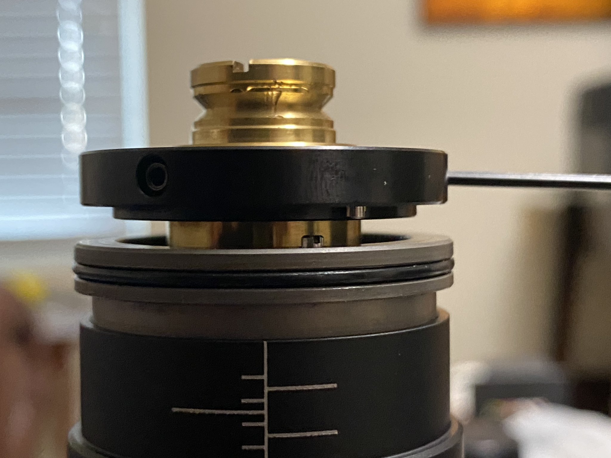

Now the bad: SCOPE RINGS…WTF? I have larger more robust rings on my hunting rifles. The rings the scope came with are made by Contessa, which I have no experience with. They retail for about $125, are steel and machining appears of good quality. I just don’t think they are robust enough nor have enough contact surface area with the scope or the rifle. It is a 3lb+ scope after all. I feel that a one piece mount is a must for a scope of this size/weight. I already ordered a Spuhr.
I hope someone from Sightron reads this…trust me any one of us who is willing to spend $2799 on a premium scope isn’t going to be happy with these rings. Lower the price of the scope by whatever your cost of these rings is and let us pick our own mounts. Most of us are gonna get mounts with 20-30MOA inclination to get the most adjustment. There are great options out there like Spuhr, ARC and ADM.
The other possible negative effect of these rings may be that less knowledgeable people/new shooters will blame the loss of zero on the scope and fill the internet with bad reviews. Back in a day when I worked at a gun shop I’ve seen it on numerous occasions when people brought us back NF’s, Razors and other high end scopes, that they mounted in cheap rings,saying they don’t hold zero.
Stand by for an update. Going to take it to the range this weekend and do a side by side comparison with a Kahles, ZP5 and NF 7-35x56F1 on targets out to a mile and check tracking. I’ll report back on Sunday.

Nice review Tony. Do you notice much/any CA? How about tunneling at low power? Edge-to-edge clarity? Any noticeable color bias? My Sightrons tend to look a tiny bit "cool" to me. I'm with you about those rings; they wouldn't inspire a whole lot of confidence.
Thanks, bud!
I will look for those things this weekend and report back. I am fortunate to live close to a 1 mile long range with all types of targets and other objects that I can observe to evaluate optics.

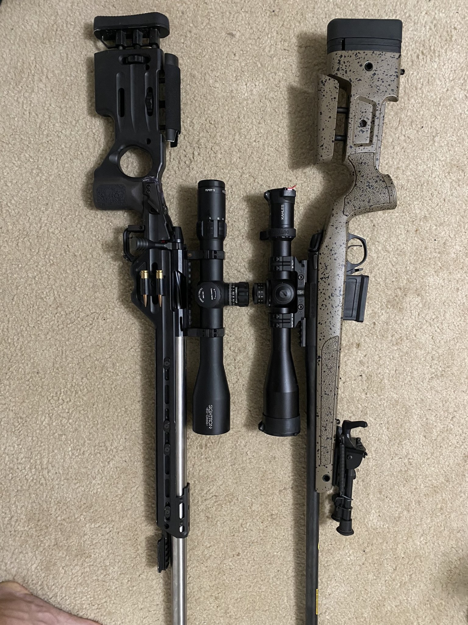

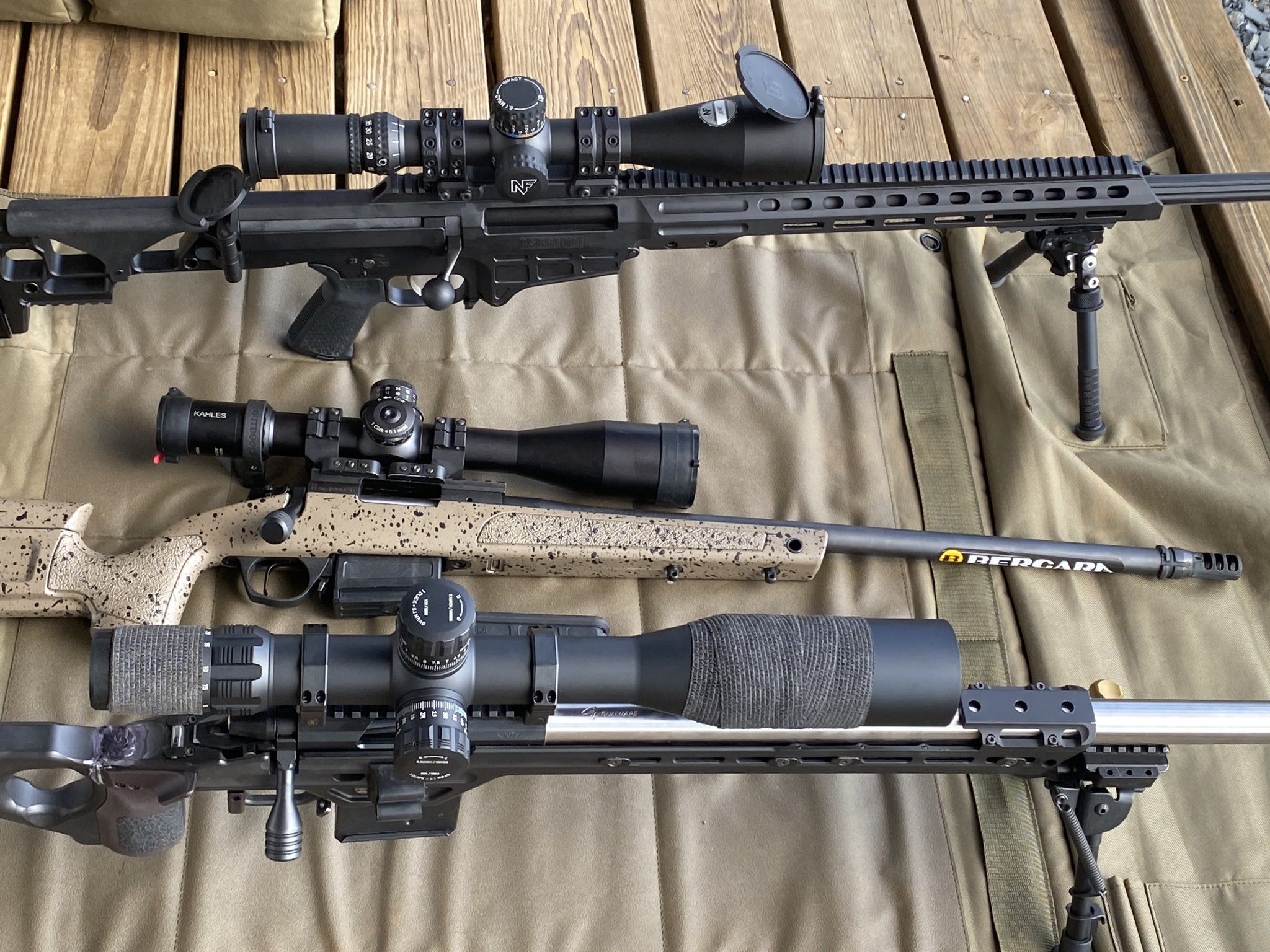

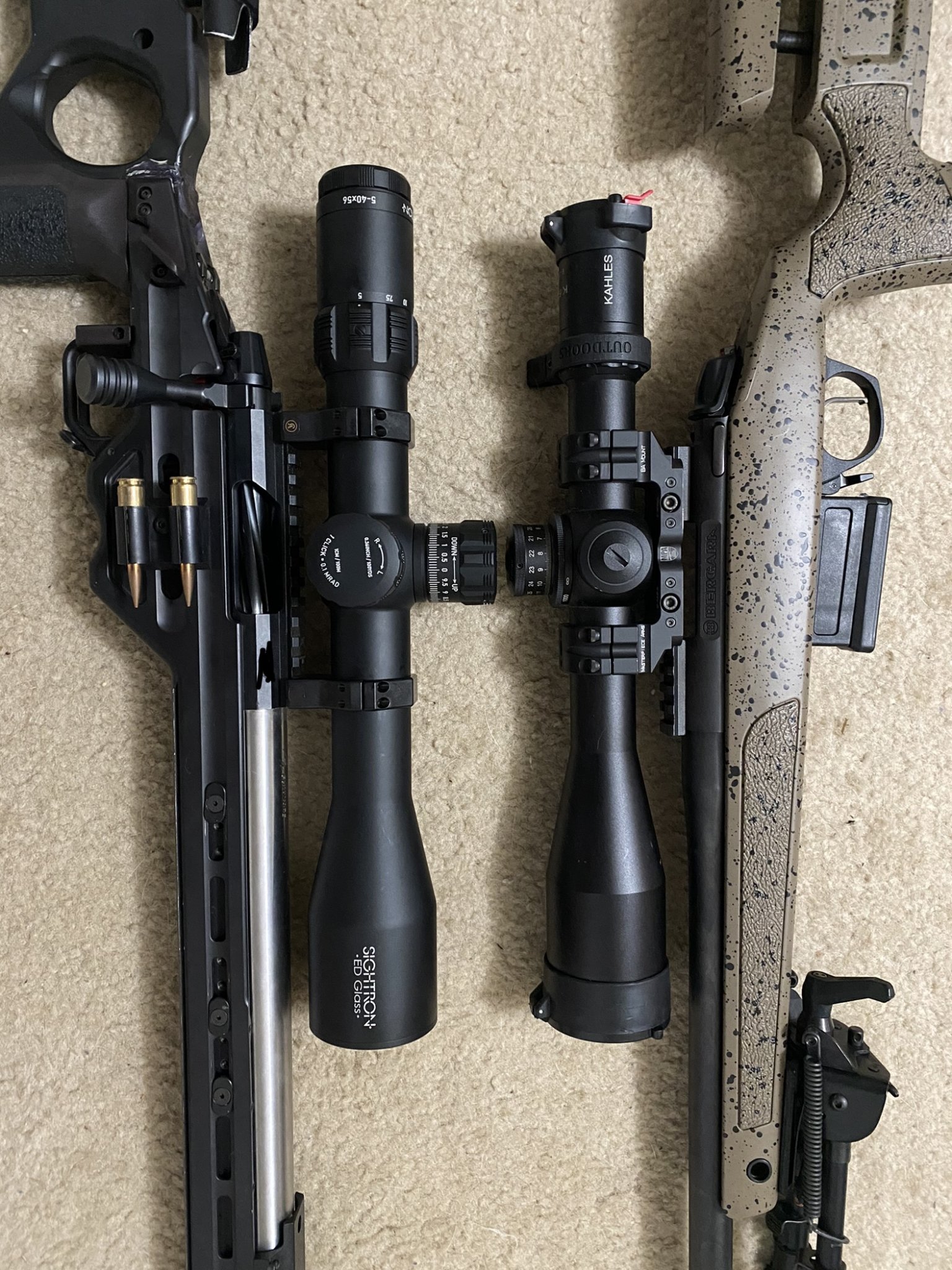

Well, just got back from the range and here is my impression after a side by side comparison of the new SVIII to NF 7-35x56, K624i and a Minox ZP5. To no surprise ZP5 optically outperformed every other scope. Kahles was optically the worst with exception of field of view. NF and Sightron were very comparable as far as clarity/resolution and contrast. So from now on I’m gonna concentrate on comparing those 2. NF was a bit easier to focus. SVIII focus is a bit sensitive. Similar field of view on 35x. Both scopes had right around 11 mrads of field of view. Both scopes had very similar color fidelity favoring white. No CA that I could induce. I know what makes my Kahles fringe purple and yellow and tried to replicate it with SVIII. To be honest if it wasn’t for the reticle I dont think I would be able to tell wether I was behind NF or SVIII. What else can I say? …No tunneling. Clear edge to edge. No degradation of IQ when turrets are crunk to their limits, however, focus changes and has to be tweaked and also becomes more sensitive. I had 24mrad of upper travel left in the scope on a 20MOA rail.
I didn’t do the tall target/box test, but I’ve shot out to 1270 yards and turrets matched my ballistic calculator.

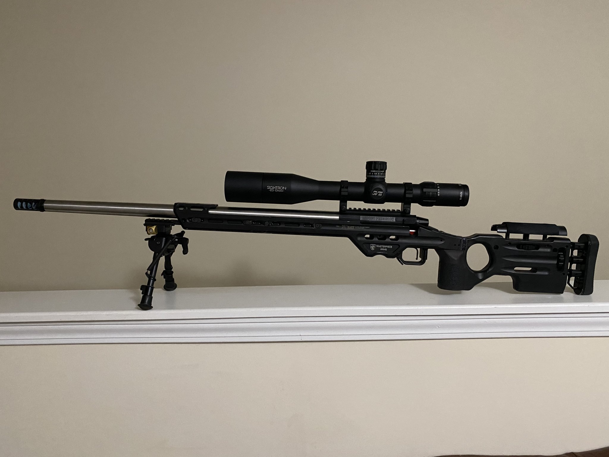

Im pretty happy with the new sightron considering it’s seems to be optically comparable to an ATACR even with an 8x erector vs 5x on NF. Don’t really have anything negative to say about it except the rings and I know that some of you are gonna hate the way these turrets feel.
