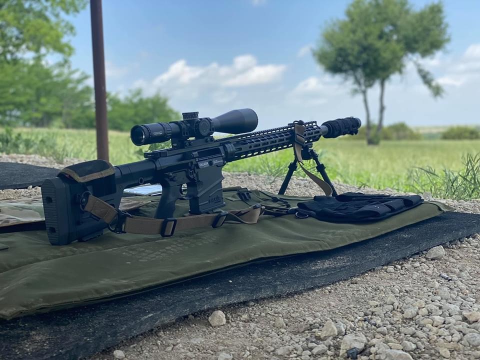

Gorgeous. I see you've suppressed it. We're using the DeadAir Sandman and have had a heck of a time dialing in the gas levels. Also having problems with it being consistent with brass ejection once set.
What ammo are you using? Are you using a 2nd Allen screw to lock the gas screw in place in the adjustable gas key? Also I found it helpful to get a looong Allen wrench with a screw driver style handle to adjust gas on the gas key and leave the bcg in the upper with rear takedown pin out
I’m running a nine inch srt arms suppressor. I take apart the bcg and clean/ lube after a range trip of 50-100 rounds. It doesn’t run reliably if it’s dry/dirty. My brass looks like it was fired from a bolt gun and lands a foot from the gun on the bench at 3 o’clock shooting suppressed. Better to start under gased and slowly work gas open until it locks back on empty magazine. Only put one round in at a time until you get it to lock open. The nice thing about the adjustment on the gas key is that you can make very small adjustments to fine tune the gas. The detents on an slr gas block are to large of an adjustment for fine tuning a magnum cartridge in my experience.

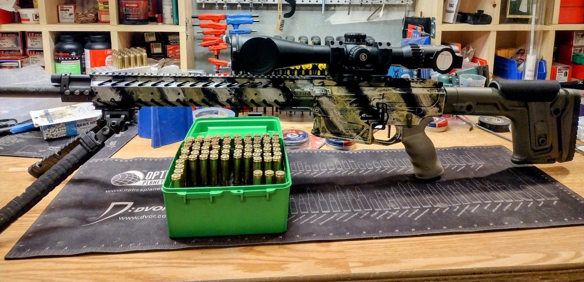

only "magnum AR" I've had any interaction with was the Sword International Mjolnir, while helping another club member with some reloading workup for it. Plenty of room in the mag on those for over standard length, but it's .338LM, so you'd better reload or it's gonna get pricey real fast.
Very fine rifle from my sample size of one, good fit and finish, and very accurate. Our range capped out at 500, but even there on a gusty day with unfinished ammunition optimization it was well under MoA, probably a little over half
