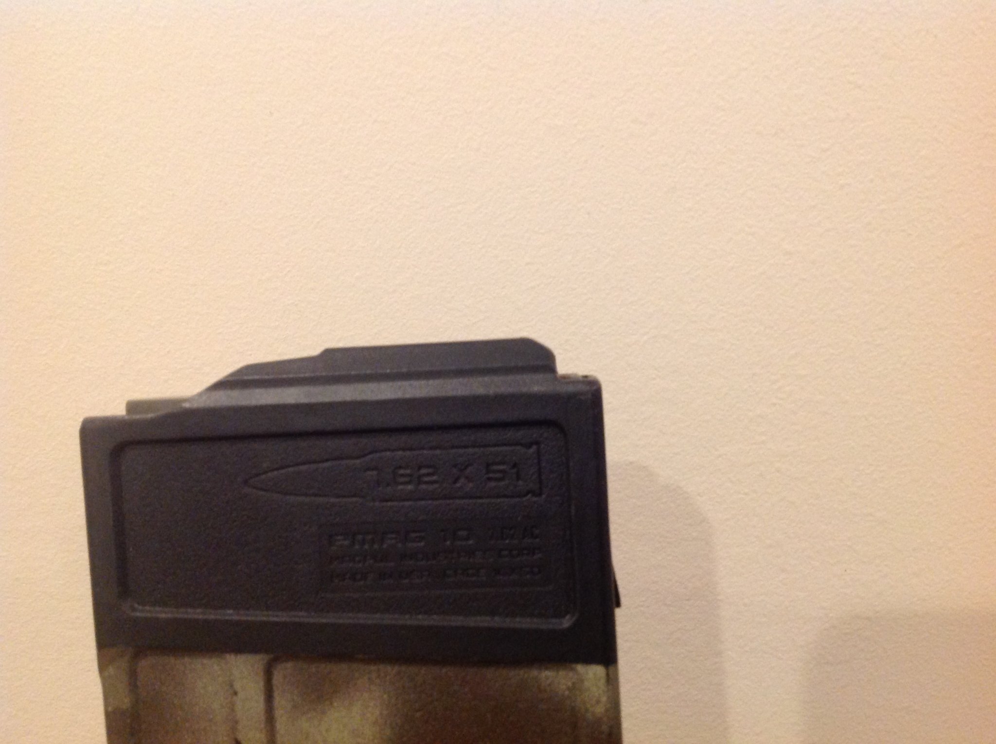

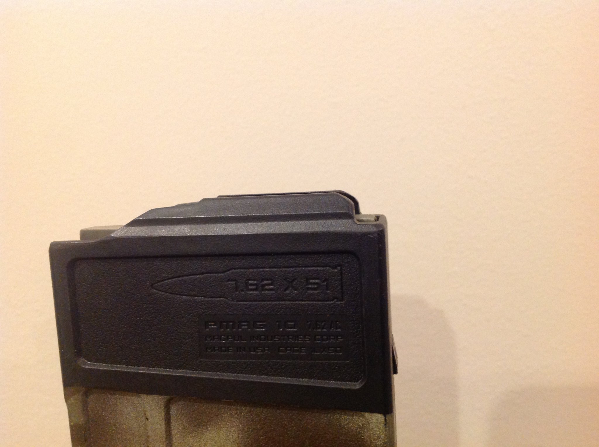

The Magpul LA AICS mags I used needed about 5 minutes with fine sandpaper off the top to really feel great. I much prefer them over the metal mags I have. Long action in a MPA Chassis (6.5-06AI Rounds).
