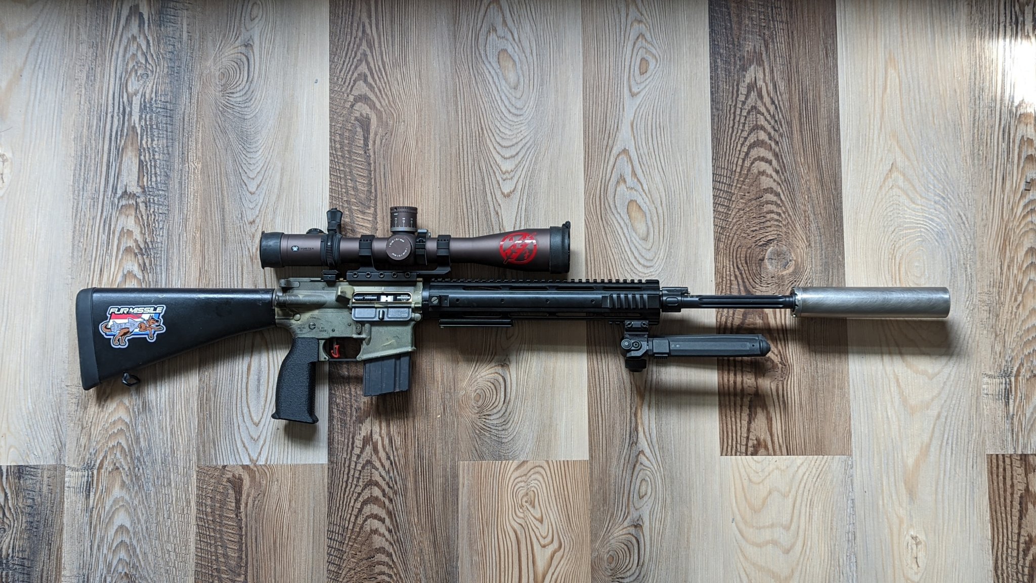

Been a few years now. How is this holding up?
Great honestly, the slots I filed out have less wiggle than factory. Just went out and shot it last week at 400 yards, pushed up a couple notches due to the alfalfa growing. I want to get another and see if it can make it lock up at 45, 90, 135 and full 180 (can't happen sadly due to the mech).
