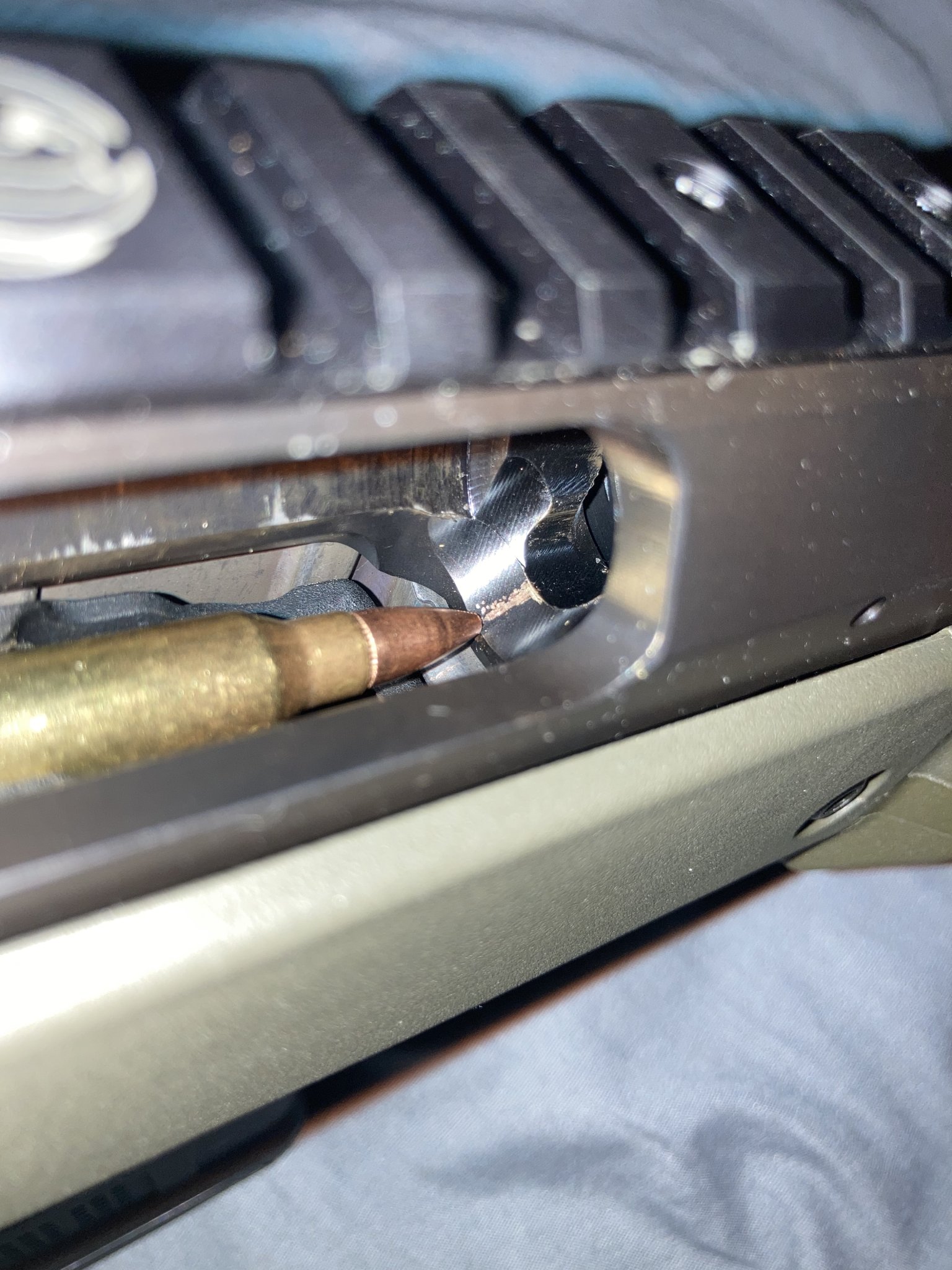

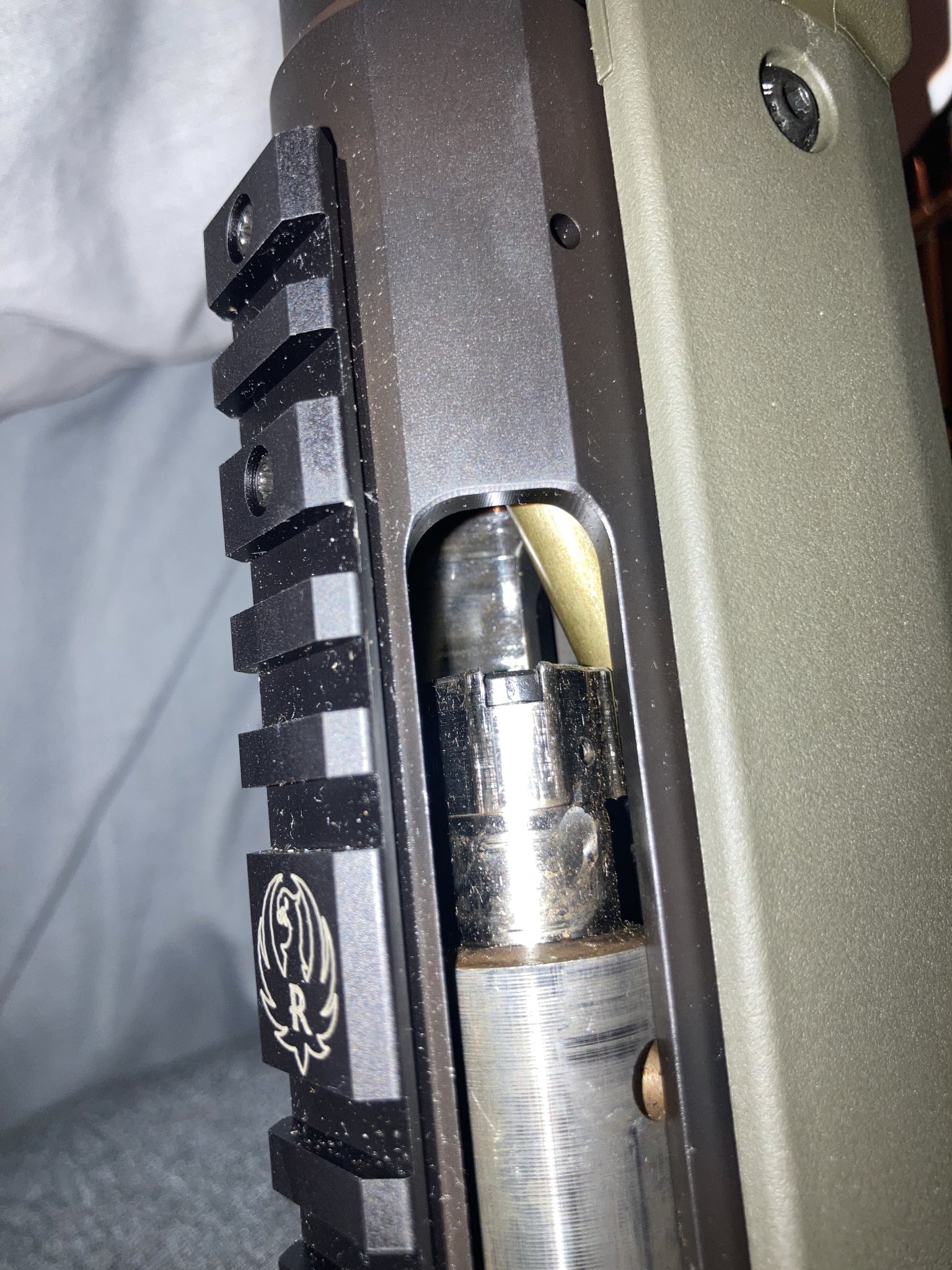

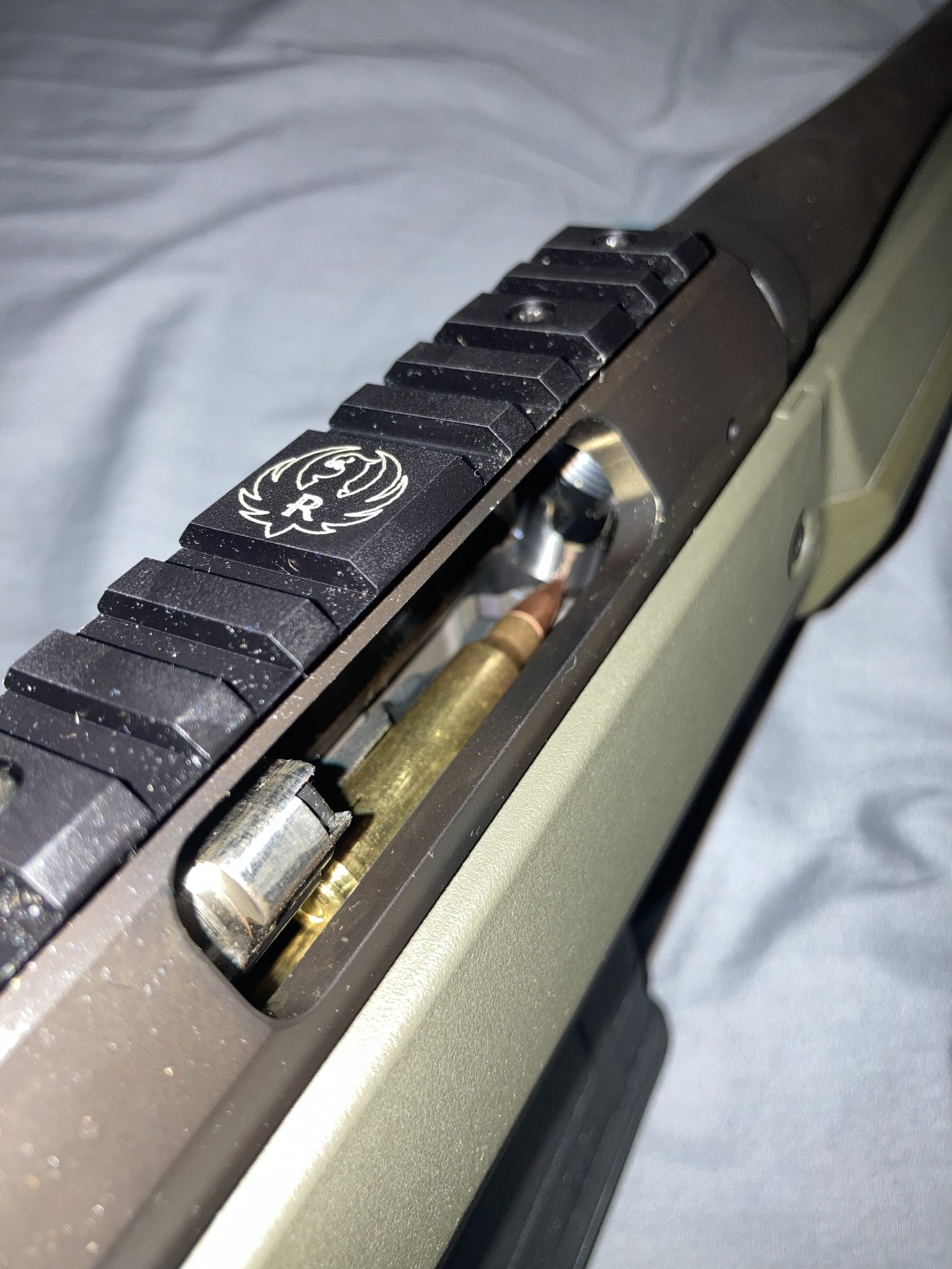

These will not work with the Ruger American 223 rifles. Magpul at some point added a disclaimer about them not working which is awesome being I ordered a couple after being told by Magpul a long time ago they would work. I tried them in my Ranch to no avail. The bolt overran the cartridge or when it did pick up the round it would run into the base of the feedramp. So glad I went this way and now have a worthless rifle/stock. To make it all even better and rub a little salt in the wound they used an American in the picture of the mag even after adding the disclaimer about it not working with Rugers. So stupid. Should have bought a Tikka.
  • Due to the feed geometry dictated by the .223 Remington cartridge and the Ruger American overall receiver length, this magazine is not recommended for use in the Ruger American rifle. While it will be possible to insert the magazine into Ruger American rifles that accept AICS-pattern magazines, function and reliability may be heavily compromised.

lol which mags work? Seems like none is the answer. Rifle seems to be incompatable with AICS mags which was the reason I bought it. Magpul doesn't mention anything about the stock not working with the 223 guns and told me that it would work when they finally released these mags. Now they say differently.
To be fair, normal aics mags don’t work for a ruger in the magpul hunter stock either. The magpul hunter mag well is funky and doesn’t jive with 223 sized cases.
Put that American in an oryx or another chassis and use the accurate mag extended lip metal mags and it will work fine.
