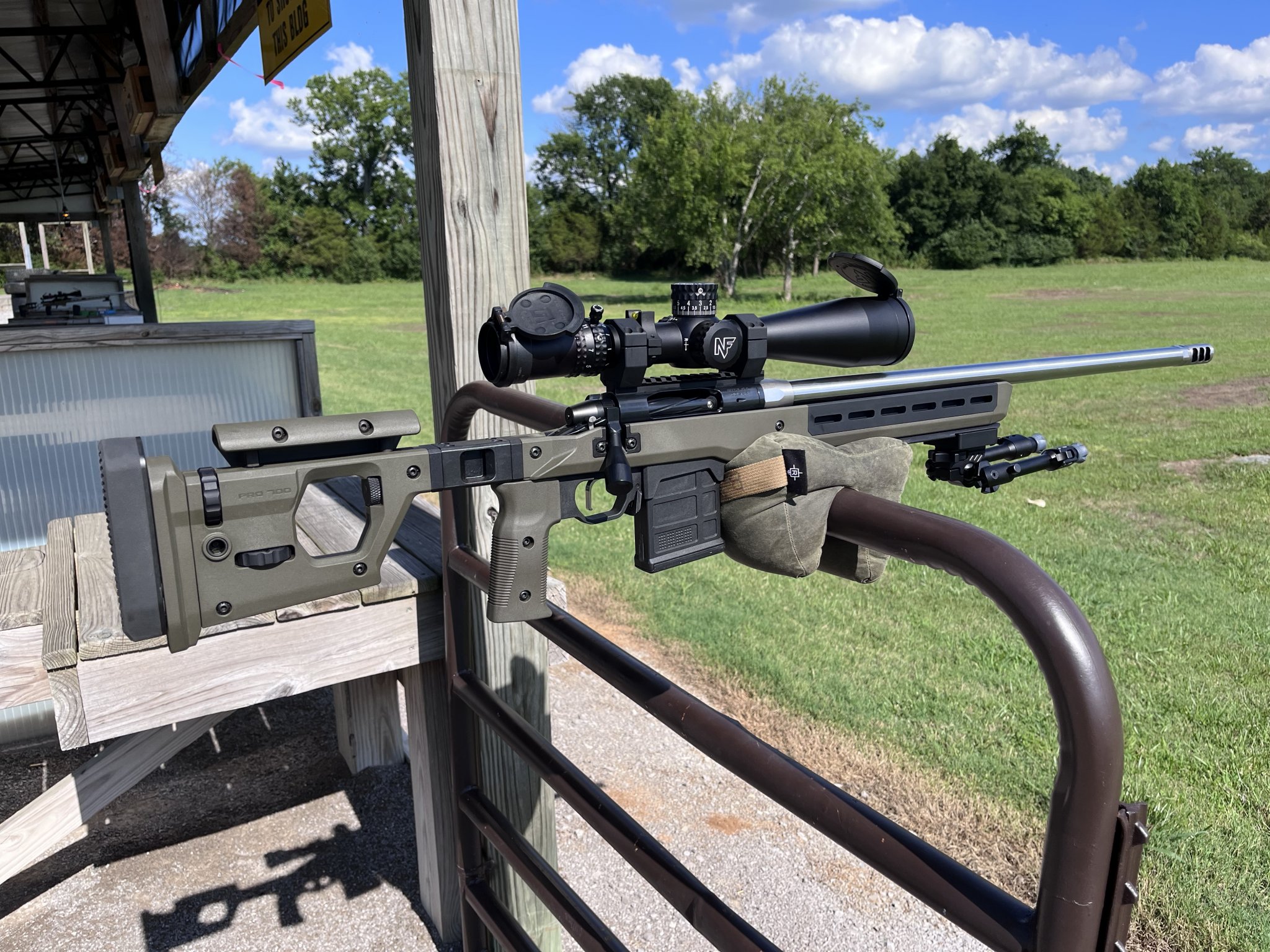

I love mine. Only things that annoys me is the lack of a barricade stop in front of the magwell. Adding an aftermarket one wouldn't be optimal either bc it would force you to have a balance point too far ahead for my taste. I think its the best value out there. I need a right folding chassis.
Hopefully a LA will come available at some time in the near future, everything is out of stock at the moment.
I love mine. Only things that annoys me is the lack of a barricade stop in front of the magwell. Adding an aftermarket one wouldn't be optimal either bc it would force you to have a balance point too far ahead for my taste. I think its the best value out there. I need a right folding chassis.View attachment 8134444
