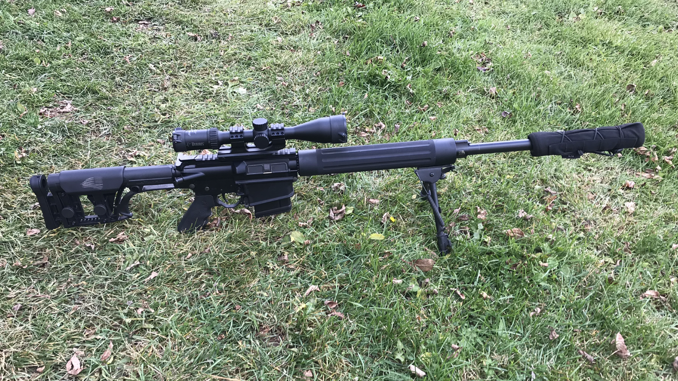

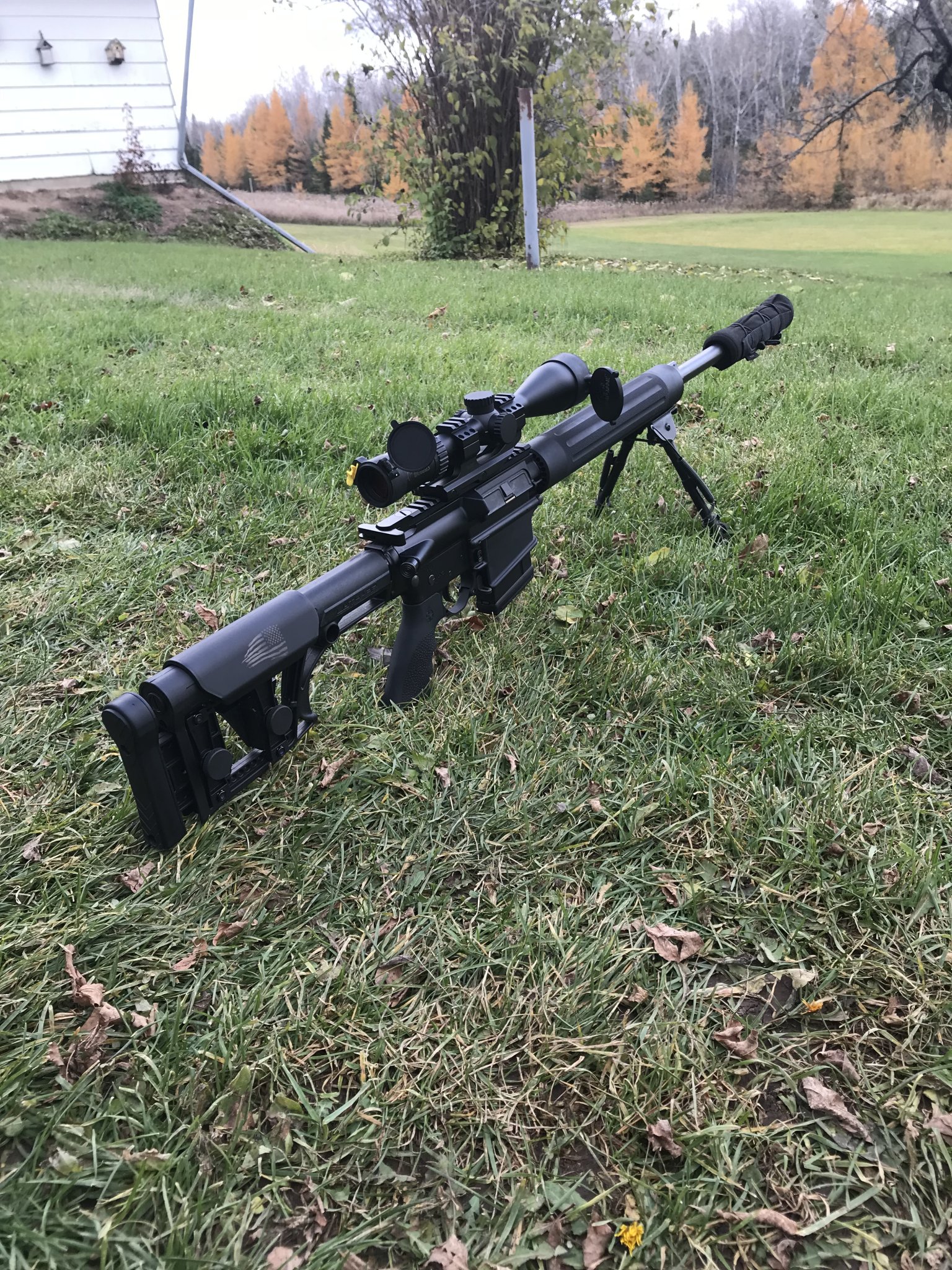

I run a Luth AR MBA 1 (Fixed stock) on my LAR 8. Swapped in about 2 minutes and works excellent
That looks good. I was just shooting mine yesterday and thinking about a stock change.
