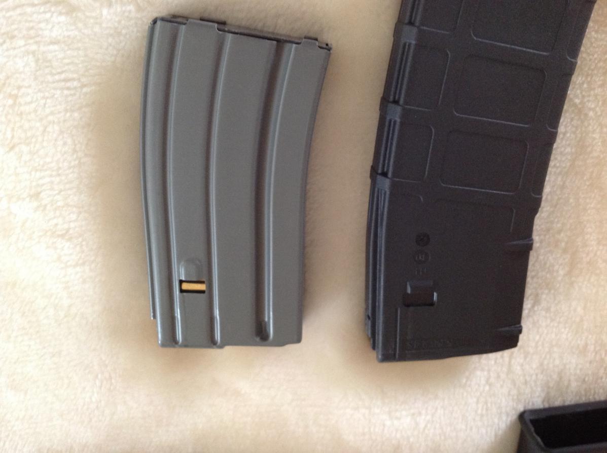

So I tried adjusting the catch. I went in both directions and I finally settled on a spot that works great on the Pmags, without having to slap them in there. It works on the Bushmaster mags but I still need to slap these to get them to seat. This is with the bolt closed.... If I lock the bolt back, no problems. Now, if I insert an empty Bushmaster mag with the bolt closed no problem, locks in easily. What I also observed is on the side of the Pmags and the Bushmasters, the little cut out for the rifle catch are different sizes. The Pmag is a little wider than the Bushmasters. Also on the Pmags you cannot see the ammo brass through the catch hole. On the Bushmasters you can.. I'm going to try to uploads pics. image.jpgimage.jpg

Without seeing how hard you have to slap the bushy mag it sounds like you might be functioning normally now. The magazine release button should have the little threaded part that sticks through the lower reciever, and through the release button, flush with the surface of the button your finger pushes. If its not flush but your weapon runs better like it is then I would leave it. Your resistance in seating the mag could come from the bolt catch not indexing on the bushy mag correctly but your adjustment of the mag release helped so it might be gtg.
