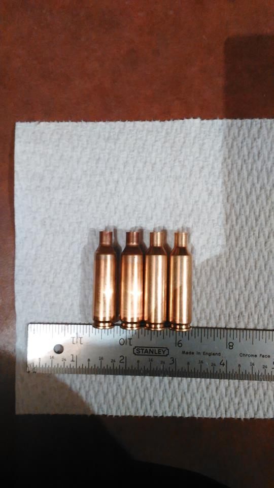

I just made a couple from older fired Hornady brass. I pulled the die innards, no bushing or stem. I did get some hydraulic dents on the shoulder from improper lube, then had to run back through with a bushing so my Giraud would trim them, I took off .035" to get to 1.900, guy could go 1.910" for the first firing.
Chambered in both my XC's.
Using new brass, rather than fired would be easier.
My pics suck, 2 on the left just formed, right 2 are processed Norma. Not sure if brass color, the shoulder on formed to the naked eye look slightly different, but the bump on the formed is .0005" more, probably because I ran through the sizer twice.
I think you are good to go, a tight bump, to match your chamber, being brass is constricted in all areas, it should result in load and go< no firing to match chamber dimensions, die did it for you.
