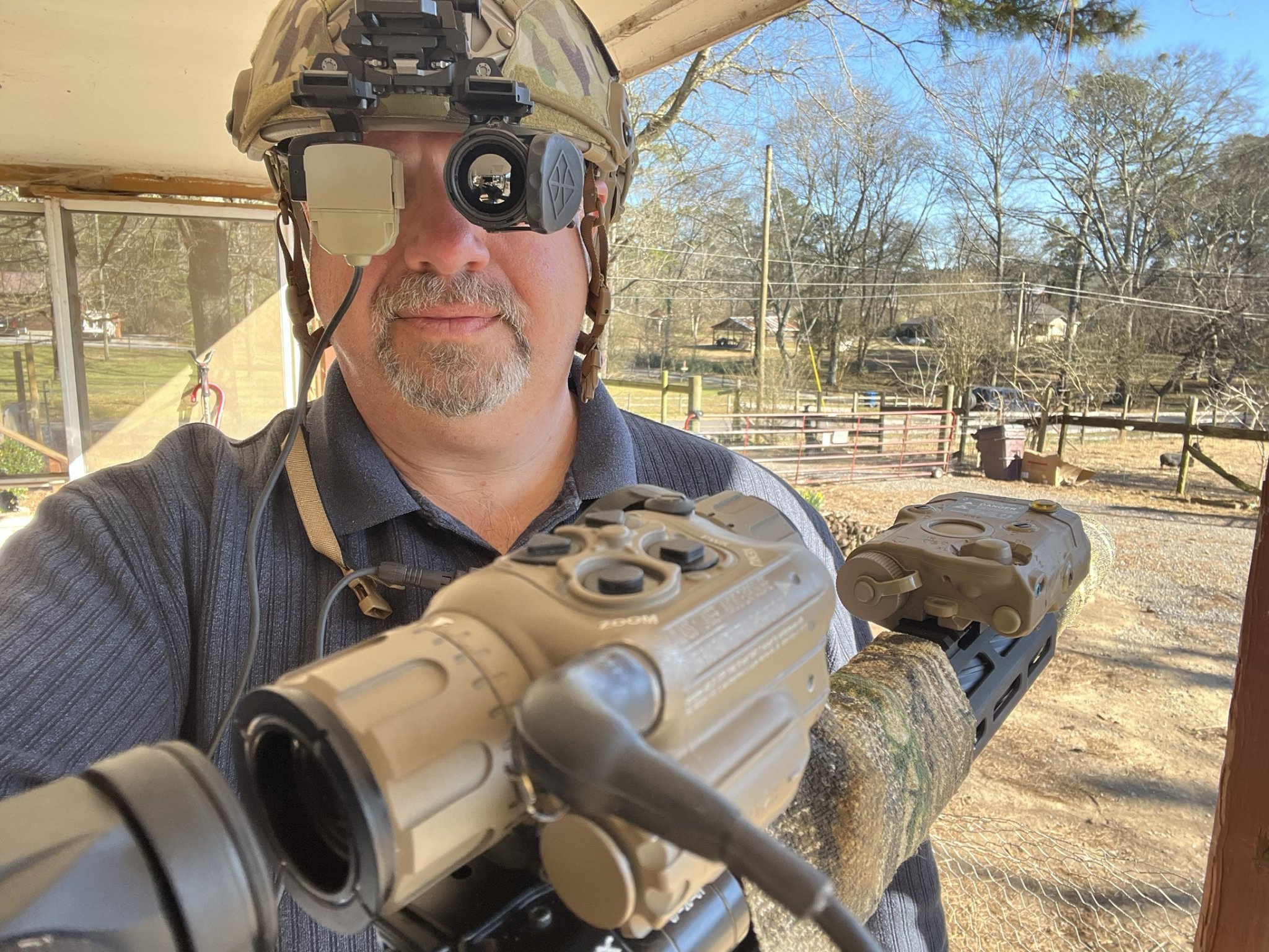

    I'm using an iRay MH25 HMT on my left eye. It's mounted via a Mod dovetail into an airsoft KVC brdige and on a Wilcox G24.
    The KVC bridge has sort of a force to overcome when flipping the pod out to the side, so that's the way I use it.
    My rifle is on a tripod, iRay Hybrid 50 WMT with the new adapter plate so I can use the ADM QD mount. It's a little lower than the stock mount but higher than say the Alpha with the ADM QD mount. I prefer my WMT to be on the higher side when wearing a helmet.
    Anyways, when calling my rifle is on a tripod, call remote in right hand. When I see one or transition to rifle, I just flip the MH25 out to the side. I leave the G24 down and there's still enough room for me to get comfortably behind the WMT and get proper eye relief and picture. I have a fixed stock with adjustable cheek riser but it's low as it will go and I might try taking it off sometime for a bit more room. Just haven't yet.,
    I've had coyotes pop up close and have managed to get them killed by doing the above, just quicker. But mostly where I call in the TX & OK panhandles it's wide open. The bigger issue for me has been hiding the vehicle and not being skylined as they come in. Just no trees or anythign for cover.
