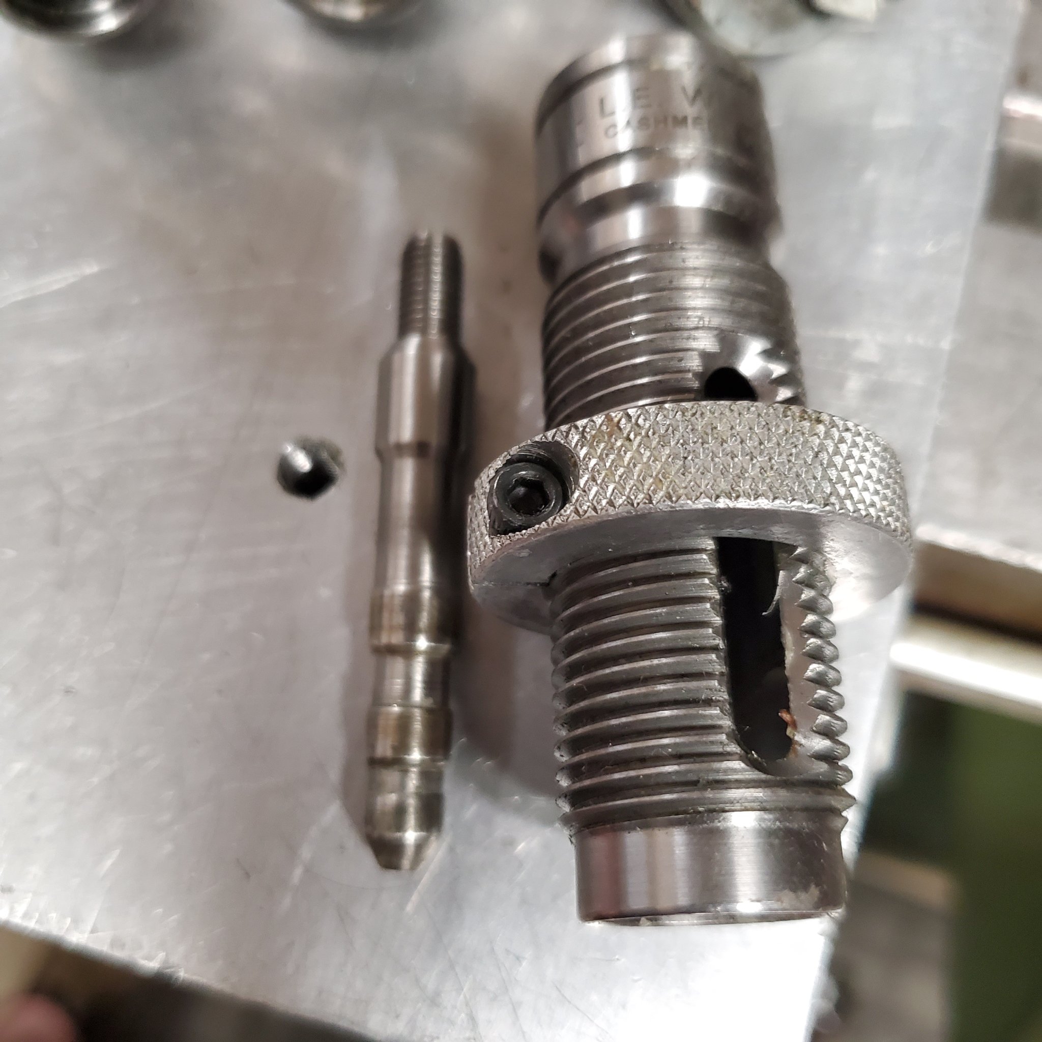

I use Wilson mandrel die body and make my own mandrels, any size I want.
Sometimes with multiple expansion bumps to move up to a much larger caliber in one pass. Also make bushings for their FL bushing dies, for different brass brands.
To get the right neck tension.
Spring back will be different if you anneal the case necks making them tighter, and more consistent also.

Looks really expensive, especially if ya have alot of calibers.
Not really - the pins are only $11-12 each and you don’t need many. I have 3-4 pins for each of the calibers I’m using it on. Some manufacturers mandrels are a whole lot more per size. I didn’t buy the Porters to save money but I liked having all the options and I’m happy with it.
