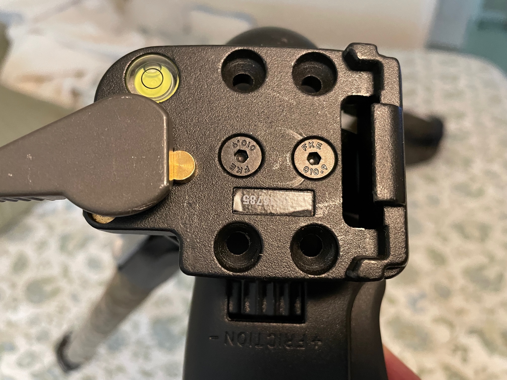

    I'd like to set up an observation center using a Mod Dos. I have a Manfrotto tripod with a 322RC2 pistol grip head (which uses their QR clamp, 200PL I think) and am trying to figure out an easy way to get the darn Dos (Arca) clamped to the RC2. I'd like a direct screw clamp so I'm not stacking clamps, but the RC2 has two closely spaced east to west holes versus most Arca clamps north to south holes (and spaced further). Neither my RRS SOAR or Area 419 Arca clamp will work. I've read a number of Hide threads but none seem to answer the Dos to RC2 question.

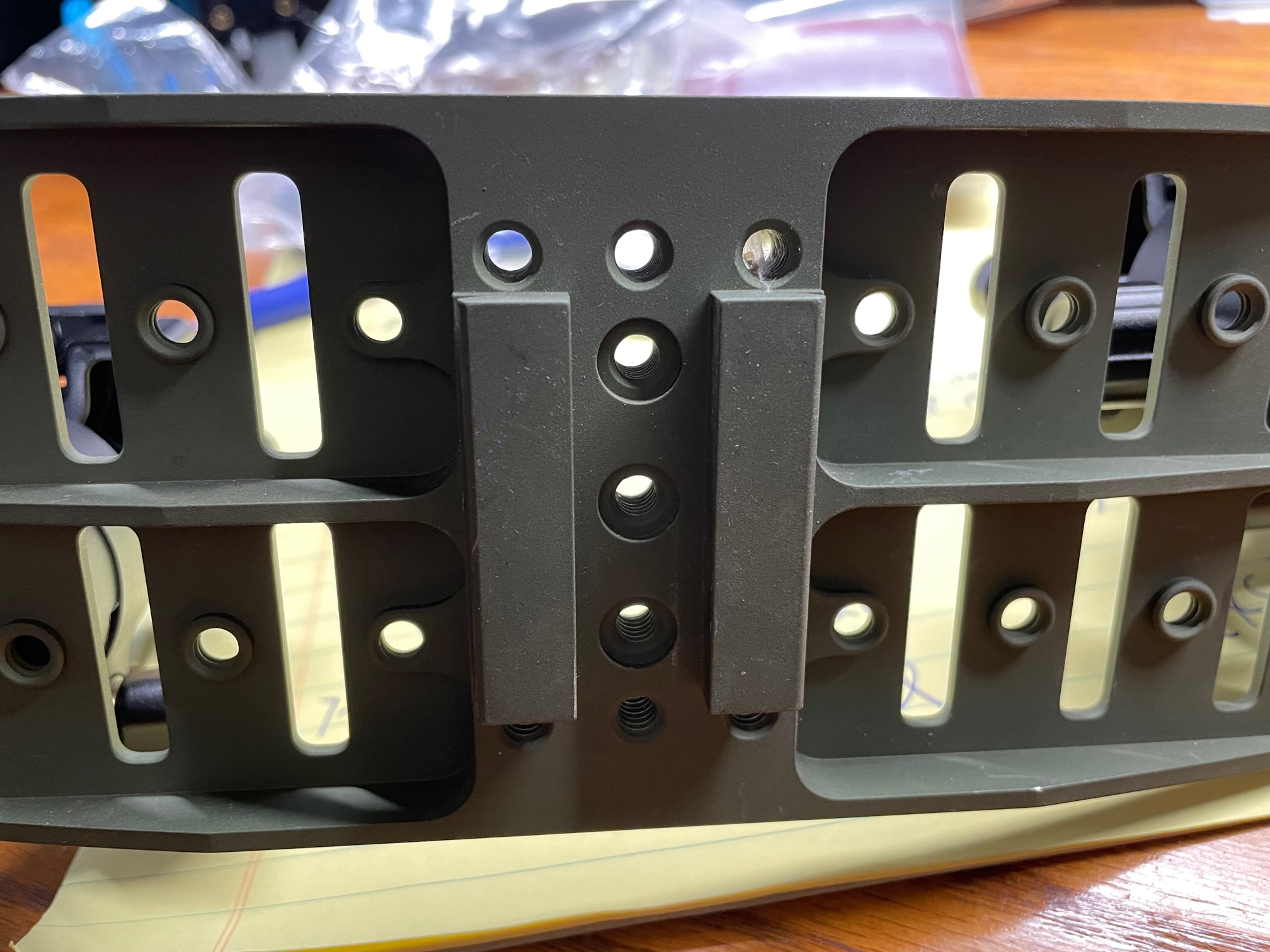

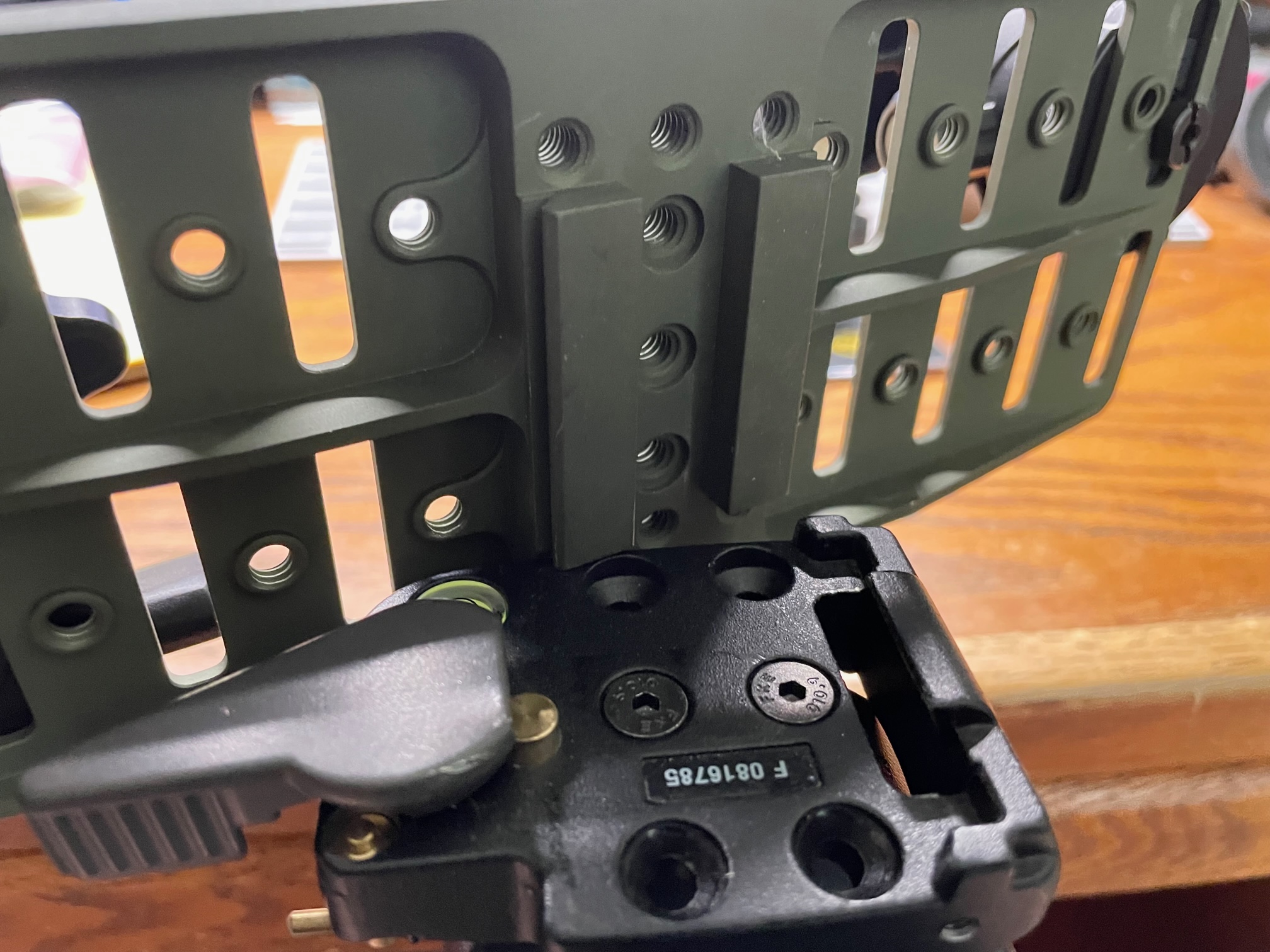

    Yes, the MOD DOS has a machined Arca, but some sort of clamp will be needed to adapt to the RC2 or replace the RC2 on the head. In the second pic you can see, even if it fit the RC2, the height of the RC2 lever will interfere with the bottom of MOD DOS' rail.

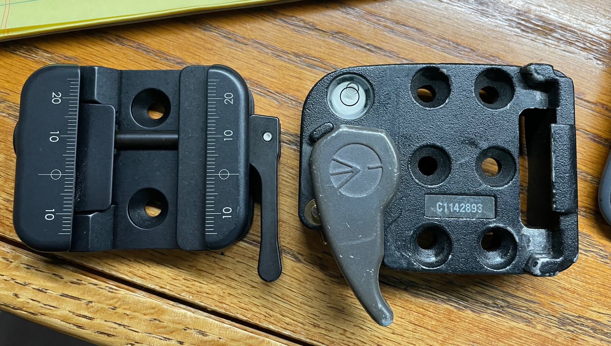

    I think I found what I need. This clamp will fit the 200pl slot of the RC2.

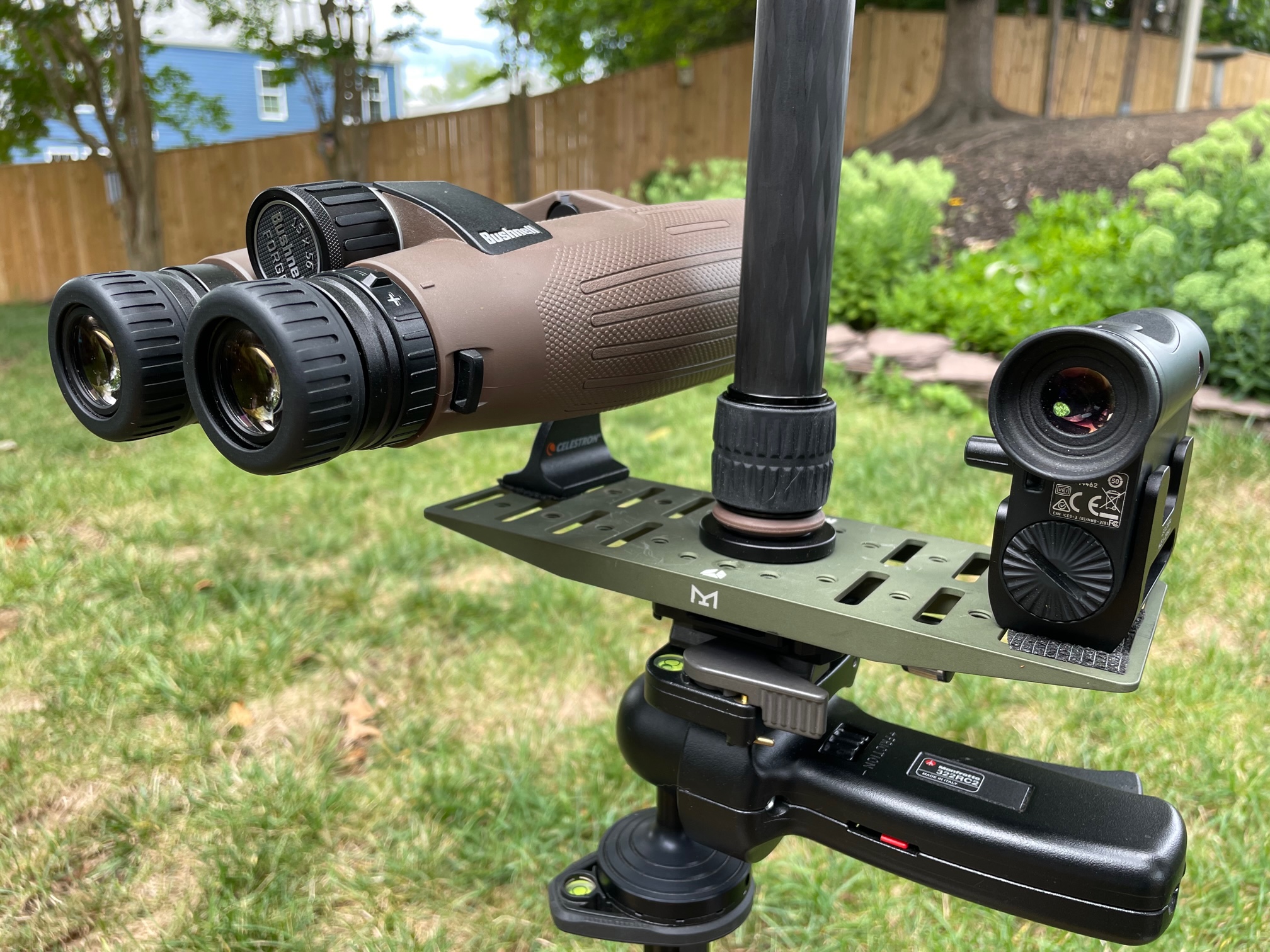

    The Pro Media Gear RC 60 worked. It fits the Manfrotto RC2 with the 200PL. When I get some anti-rotation pins, I'll just replace the 200PL with the ARCA clamp.
