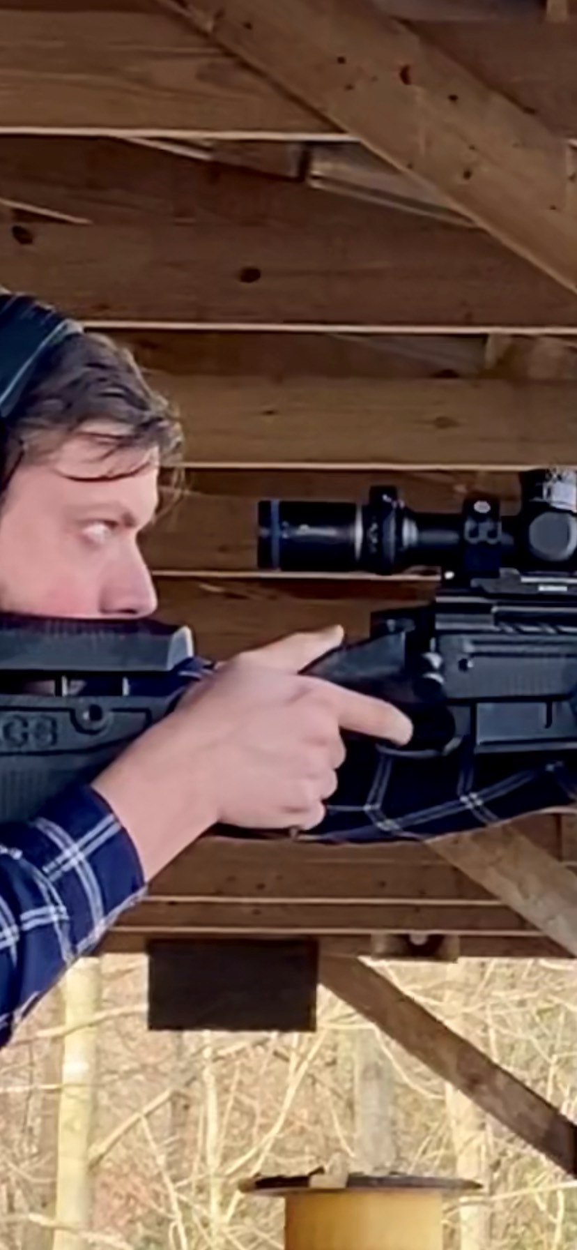

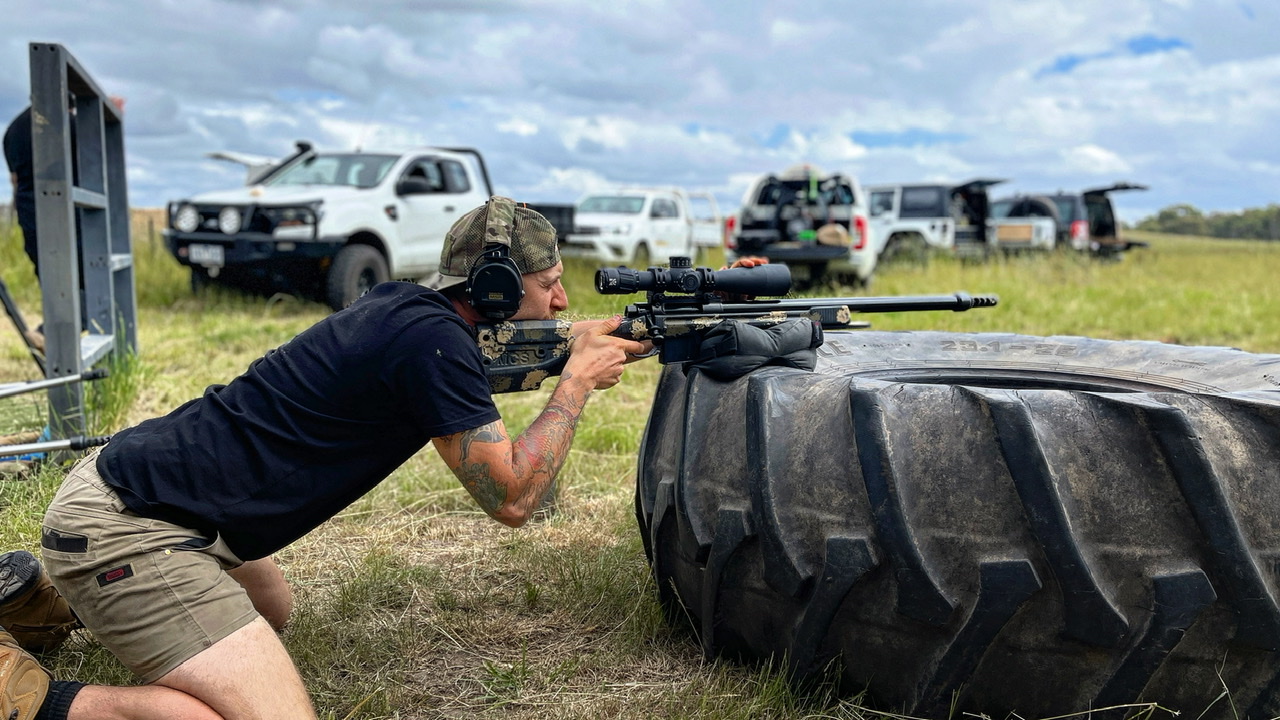

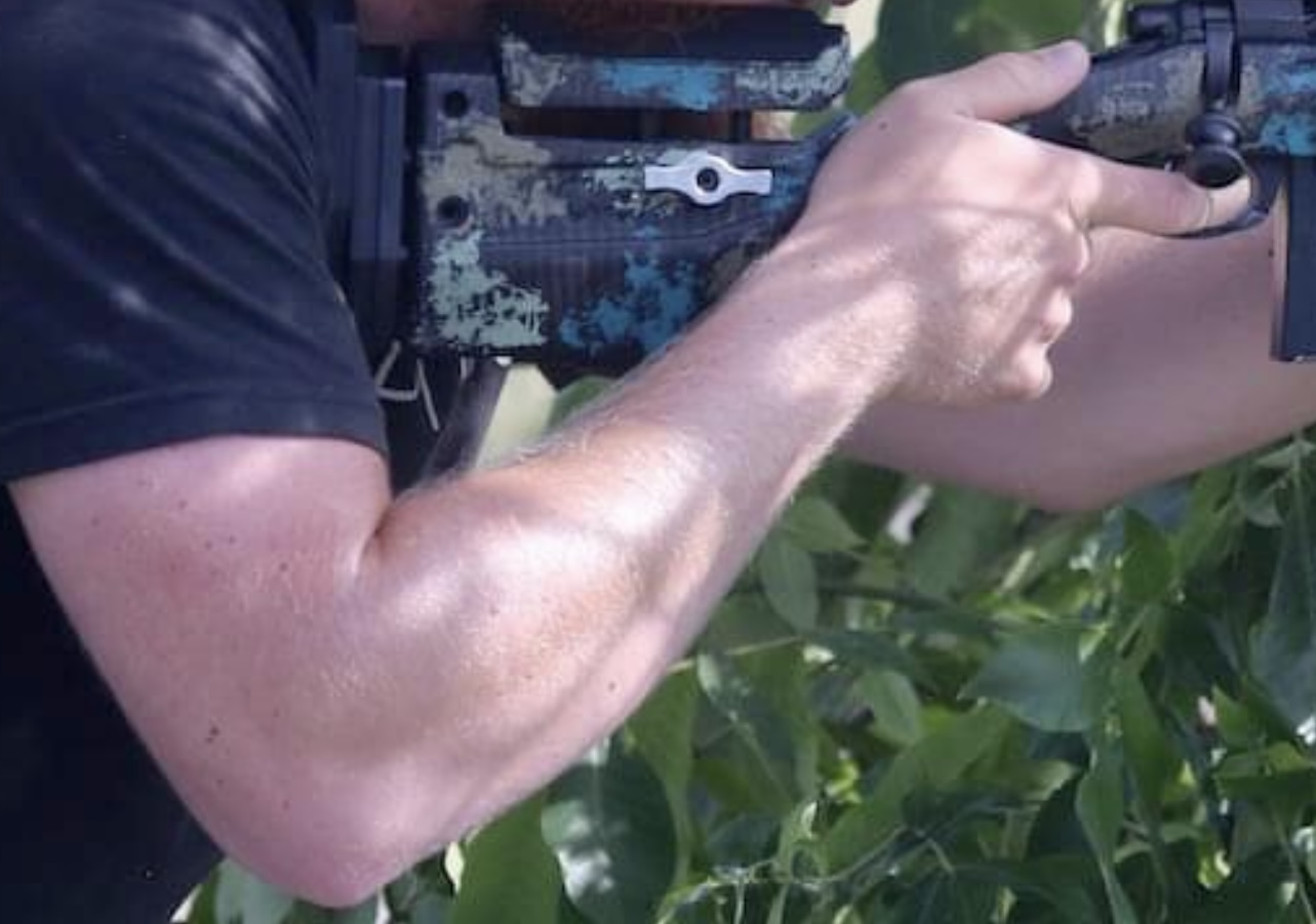

    But the grip is a bit too high and slants your hand downwards and it’s a bit far from the trigger, if they addressed those things it’d be pretty close to perfect. Unless you’ve got really small hands the grip won’t give you any issues you might just be surprised by the small nuances like any new grip.
    You can see in all the pictures. Downward slope and a bit far from the tigger. You can get them to move the trigger closer to the grip but that’s a custom order. I’ve been running manners stocks for a while though so to me it feels totally normal but I do still recognise they could make some improvements to it.
    Reactions: S3th
    But the grip is a bit too high and slants your hand downwards...You can see in all the pictures. Downward slope and a bit far from the tigger.
    I forgot who posted this pic a while back (not claiming credit), but I saved to my phone and now what you are saying makes a ton of sense when I look at it a second time. Thanks for calling that out.
    The forward angled grip is clearly apparent vs. my KRG Bravo. And, there does appear to be more of the wide area that is "graspable" on the Manners than the Bravo.

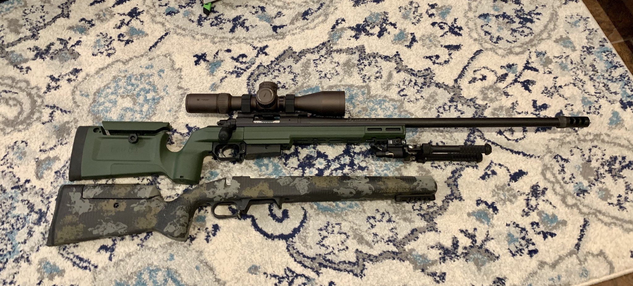

    FWIW, you posted one for sale a few months back with this sweet high plains gloss finish...and seeing that combo is what gave me the TCS itch.
    Go figure....🤣
    Go figure....🤣
    😆😆 It's an amazing stock. Just wasn't for me. And I'm a big Manners fan. They got everything but the grip right on that stock.
