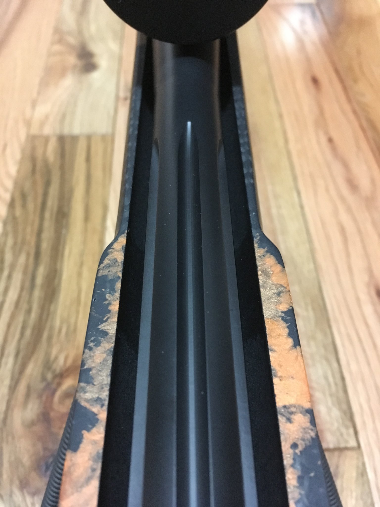

Here is a barrel channel for a free floated MTU barrel with a med palma barrel in it. Plenty of room and no issues.

I don't think it looks off. I set mine up for the same reason. Plus it aids in cooling during the hot summer months.
Thanks BCX, I appreciate pics. Marksman was what I was thinking of going with so that's a good view of what it would look like. Looks like a fair amount of gap but you make a good point on getting more air around it for cooling
I can measure the gap if need be? That was a close up. Always looks bigger in the pic lol. Plus thats a straight 1.350 so if i decide to run a Proof CF bull barrel.
No you dont need to measure it. I'll just measure my barrel at the end of my stock and have a pretty close number. Yeah I'm sure it looks bigger in the close up than in person when your actually looking for it.
