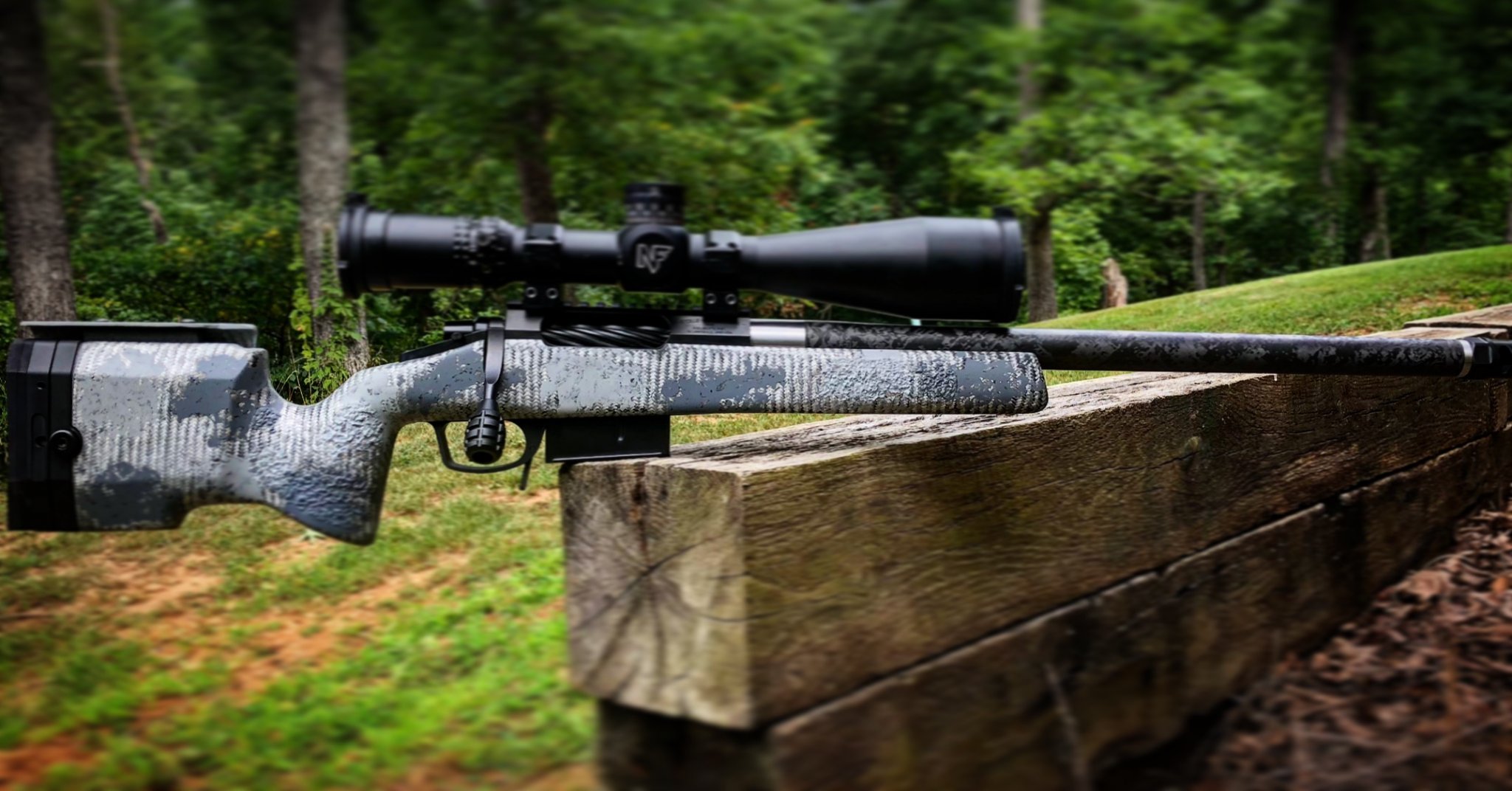

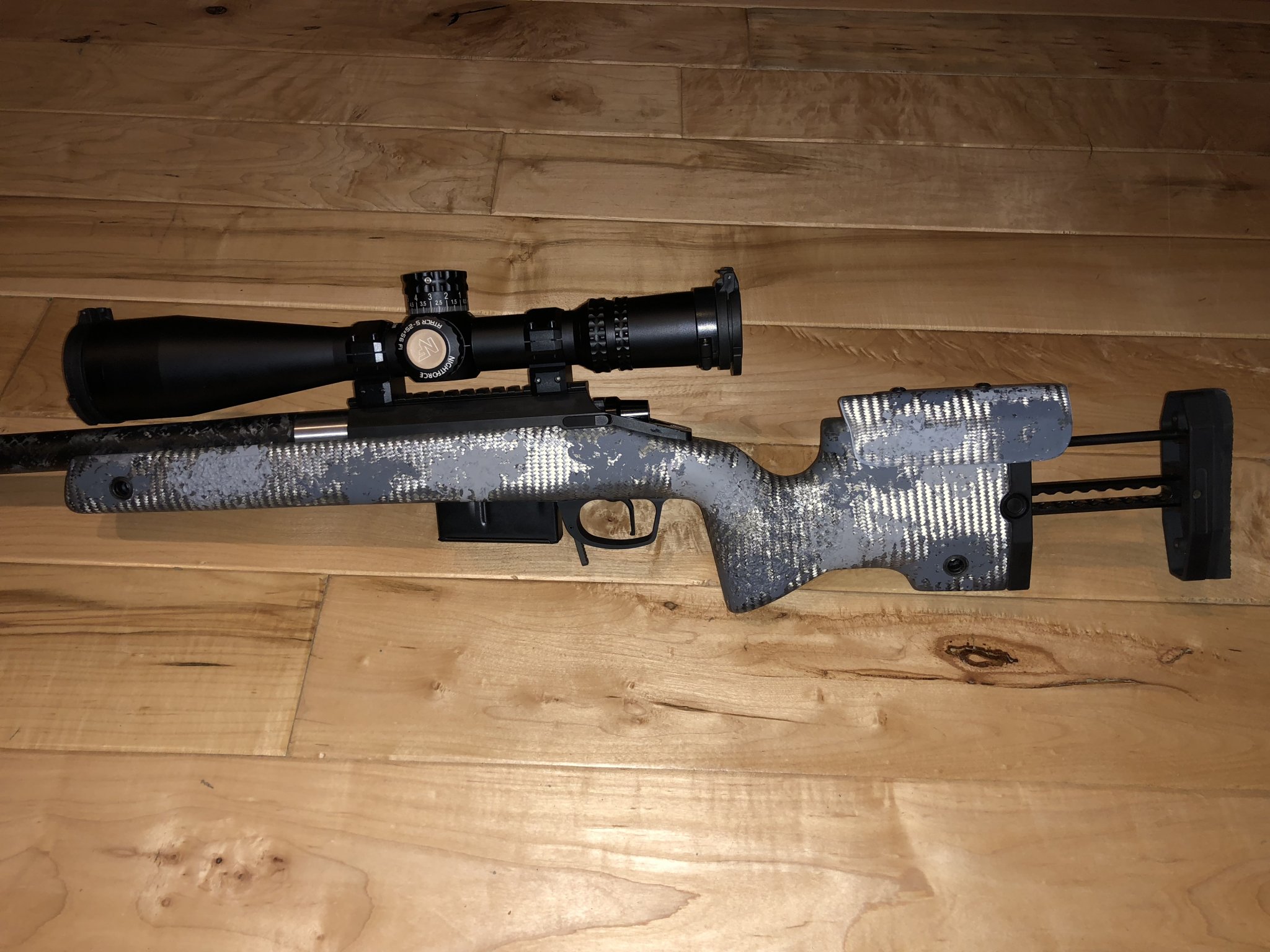

i Just got this one done in 6.5x47 Lapua. I love the compact stock in arctic Camo. It’s hard to swallow $1000 for a stock sometimes when you can’t even see or feel it. I couldn’t be happier with how it turned out. Just wanted to give a THANK YOU to @tmanners for the awesome stock and keeping me posted along the way with updates.
Is that stiller action?
It’s a Kelbly’s Black Bear Tactical, Triggertech diamond, 419 Hellfire brake, Proof barrel, Badger DBM, I made pillars on lathe and bedded in Marine tex. NF ATACR, Kelbly’s rings. Still waiting on new 419 Arca Rail to mount the Atlas 5H bipod

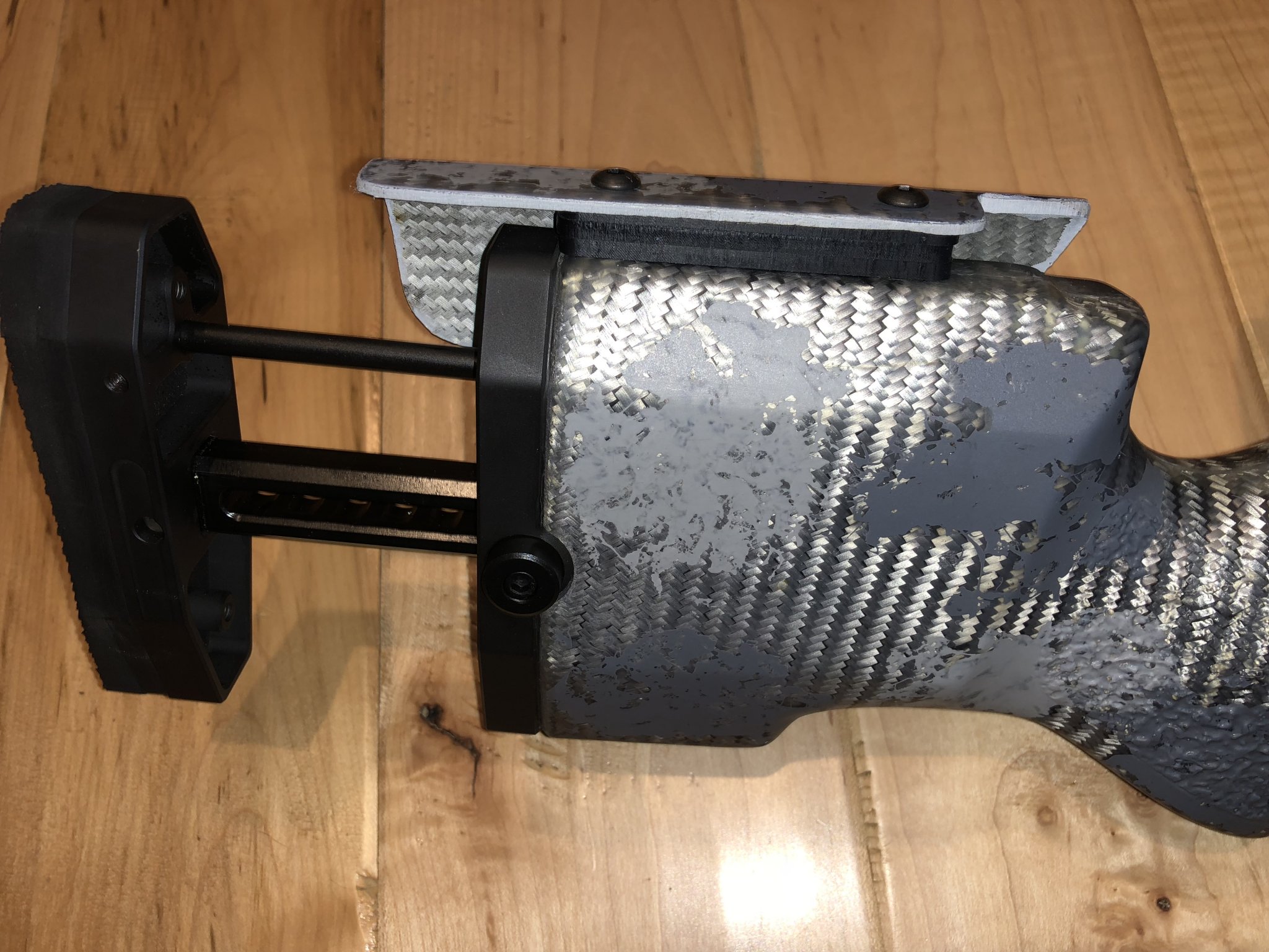

What LOP adjustment is that?
I believe it’s 10.25” to 13.5” with 9 settings. It is great to fit into short fabric tactical soft case I had already. My wife came out in shop shouldering it and could tell it was too long, simply moved it in 2 clicks, perfect!! In that aspect alone for my wife and 2 kids it’s one of the best designs on market for a stock. The mechanics of the stock are built solid, I have zero worries about this thing ever failing. Like I said before, my new favorite, can’t wait to stack some deer this fall with it.

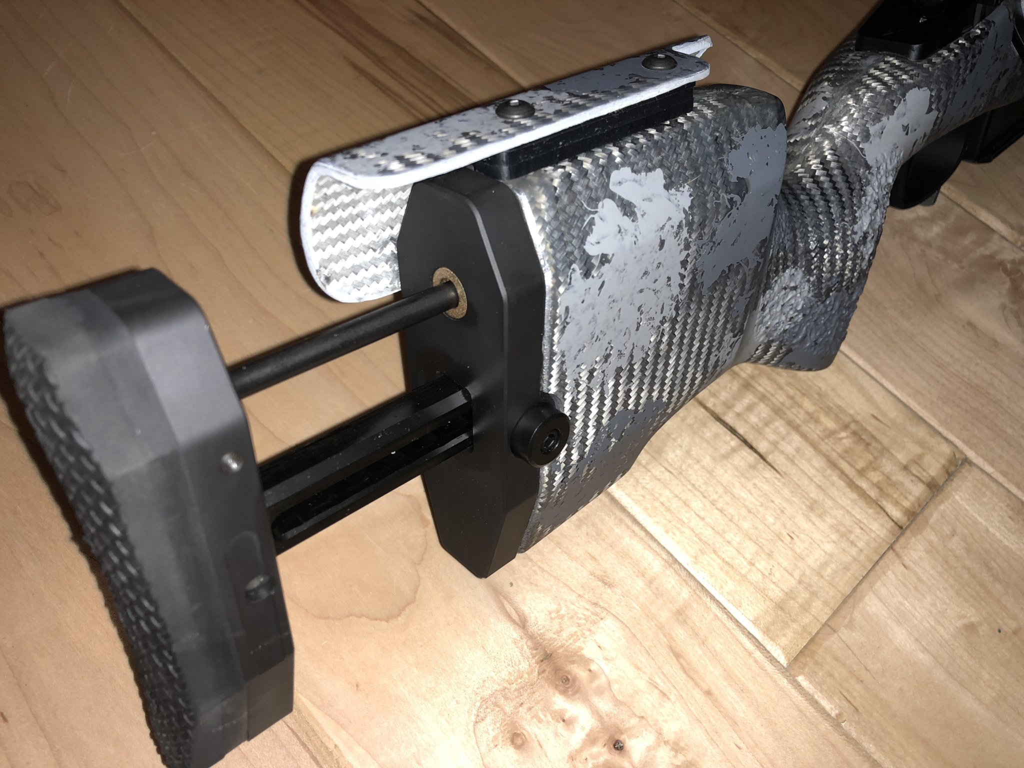

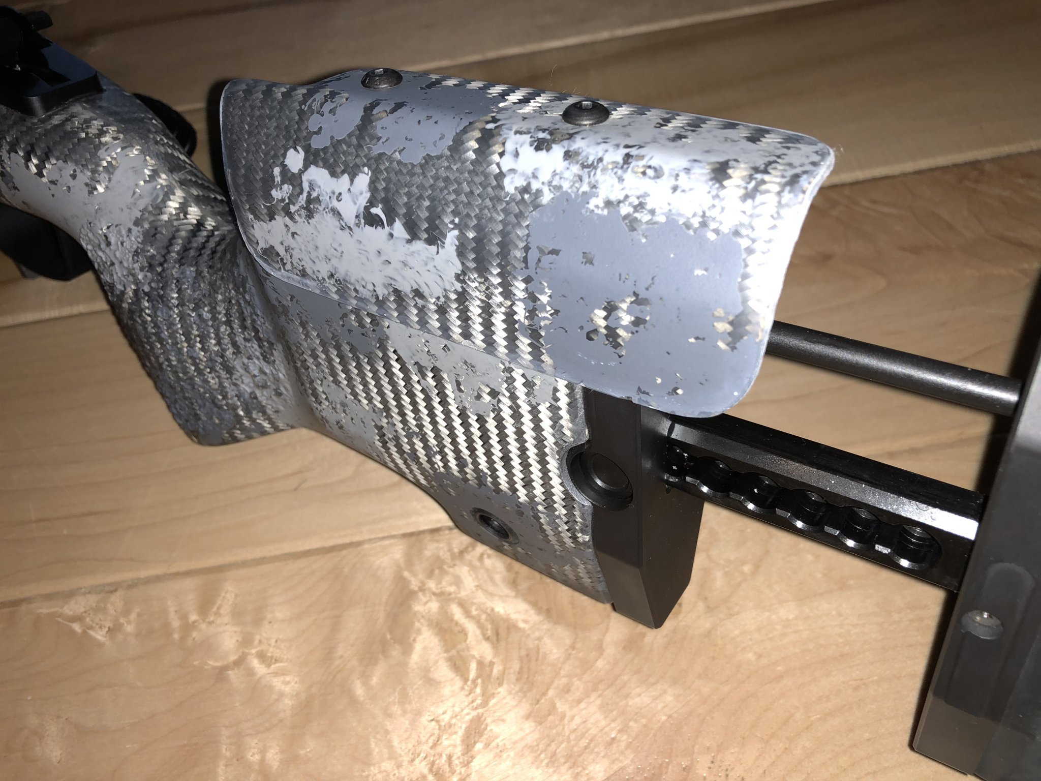

Looks great, can you post a picture from the other side to get a better look at the cheek riser?

How is it shooting off hand with the shorter forend?
As far as shooting offhand, I don’t feel there is anything hindering that. The balance of this rife with the proof barrel is right at front of mag well
Ask and you shall receive. Lol. I had flush cups put in this side also.
The look of this thing in the sunlight is pretty amazing, looks like fish scales under finish. Pictures don’t do it justice
Do they come with that cheek piece installed from manners? Cost of cheek piece? Is it adjustable?
Nice stick BTW...
I would suggest you let them do it, there are 2 bolts counter sunk in top of stock that hold cheek piece. It was worth every penny for me.
No it don’t come with it,
Yes it is adjustable
I think it was about $150 if I remember right.
Thanks
Thanks.. but it's an option directly from Manners correct?
If you could post a few more pics of the back end, I would appreciate it.
Yeah, it’s a option when you buy the stock, I’ll try and get a couple more pics today. I think Tom Manners posted something on Facebook about it. I can’t give you link, I’ve never been on Facebook.
