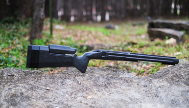

Hey guys I’ve tried burning down the search function and failed. Is there a preferred inlet for ordering a Manners mini chassis stock to fit the new American Rifle Company Coup De Grace long action? I want to get the order rolling as I know I’m in for a long wait. Thanks for any help!

Mausingfield is it's own inlet. Nucleus and Archimedes are different, but do believe the CDG to be similar to Arch with a longer ejection port. My Arch didn't fit well in a Mausingfield inlet Foundation, swapped to a chassis and accuracy instantly was better.
There are enough floating around at various vendors, no need to wait. I have the CDG short action. Drops right into the LRH. I emailed Manners and they explained that any 700 inlet works as long as the stock sits below the "waterline" so the bolt release does not require a special "cut out". LRH and TCS are 2 examples of this. Just bought a LRH from OTM. Arrived in the mail a few days later. Just need to get a M5 style BDM. I got mine from Pure Precision. Works great with AW mags without any modification. Only the LRH with mini chassis requires a BDM. AI other mini chassis do not. If you go for the TCS, you wont need a BDM.

Pro hunter with mini chassis requires bottom metal as well, not just LRH, I've had a few.

Sorry I didn’t report back with my findings once I received my action and stock. I ordered my Manners mini chassis with the Archimedes inlet and the CDG sits in perfectly. I don’t see any areas that I would want anything different. Thanks for your help along the way.
So you went with the mini chassis DBM and run AW mags?
This action was a long action so I haven’t worked with the AW mags yet. My next build is a short action CDG and I plan to run it in a mini chassis but not sure about magazine placement without modifying a magazine catch.
Did yall have any fitting to do with your bottom metal and trigger hanger on the CDG action? I've seen some posts saying the mini chassis accommodates the trigger hanger but I've never anything on the micro chassis. Manners have advised it "should" be fine and not require and fitting of the trigger hanger to bottom metal.
