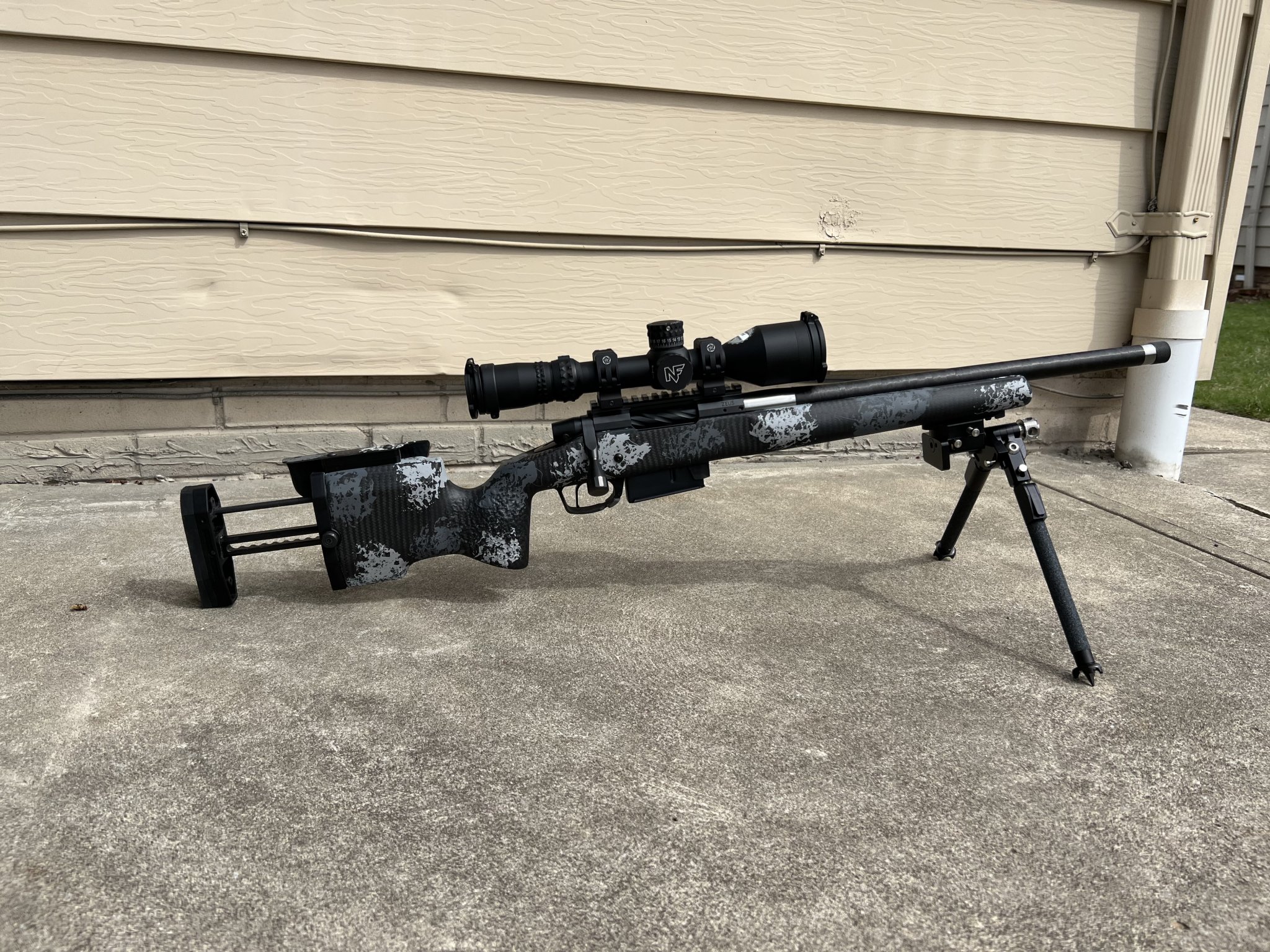

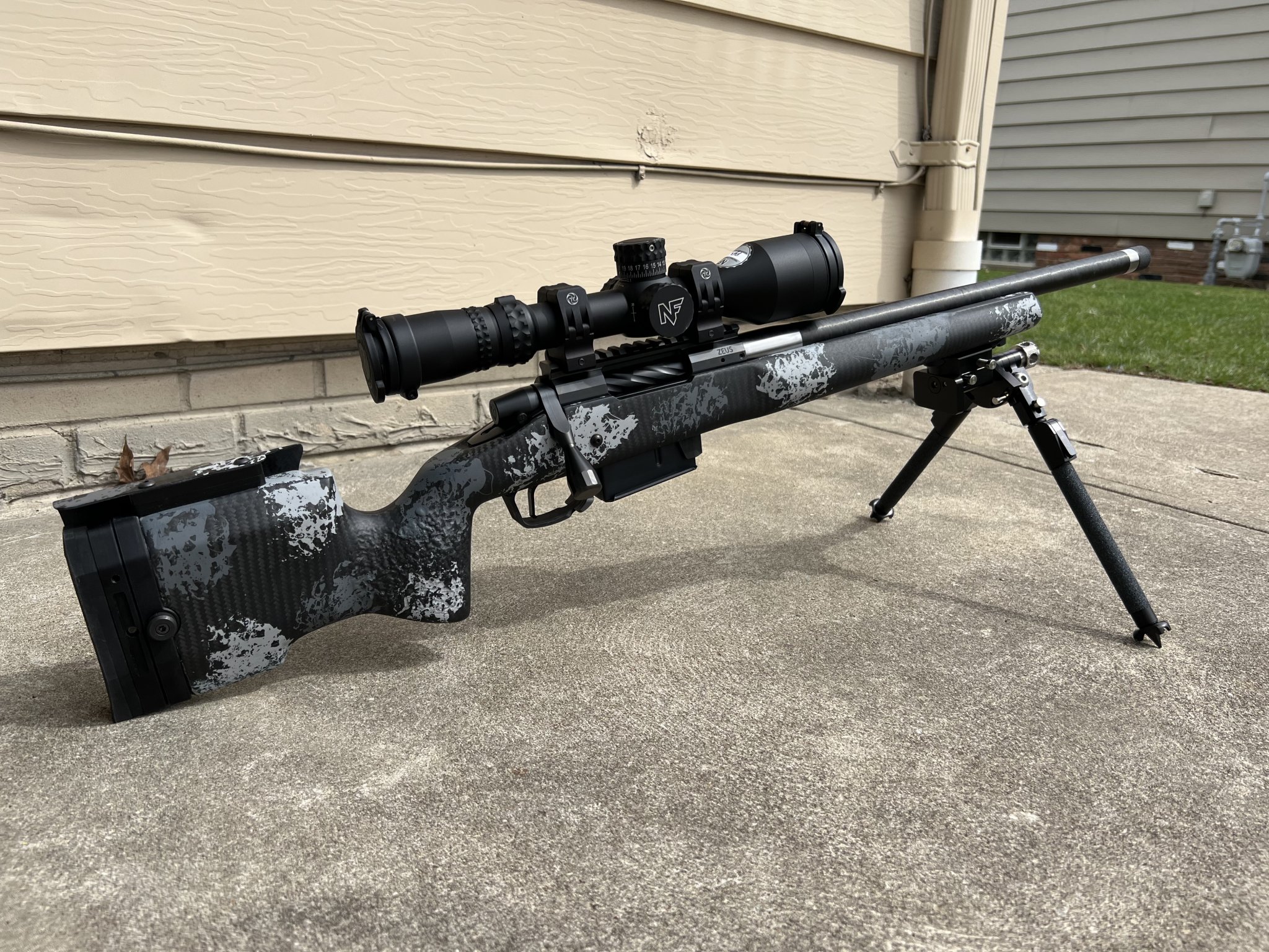

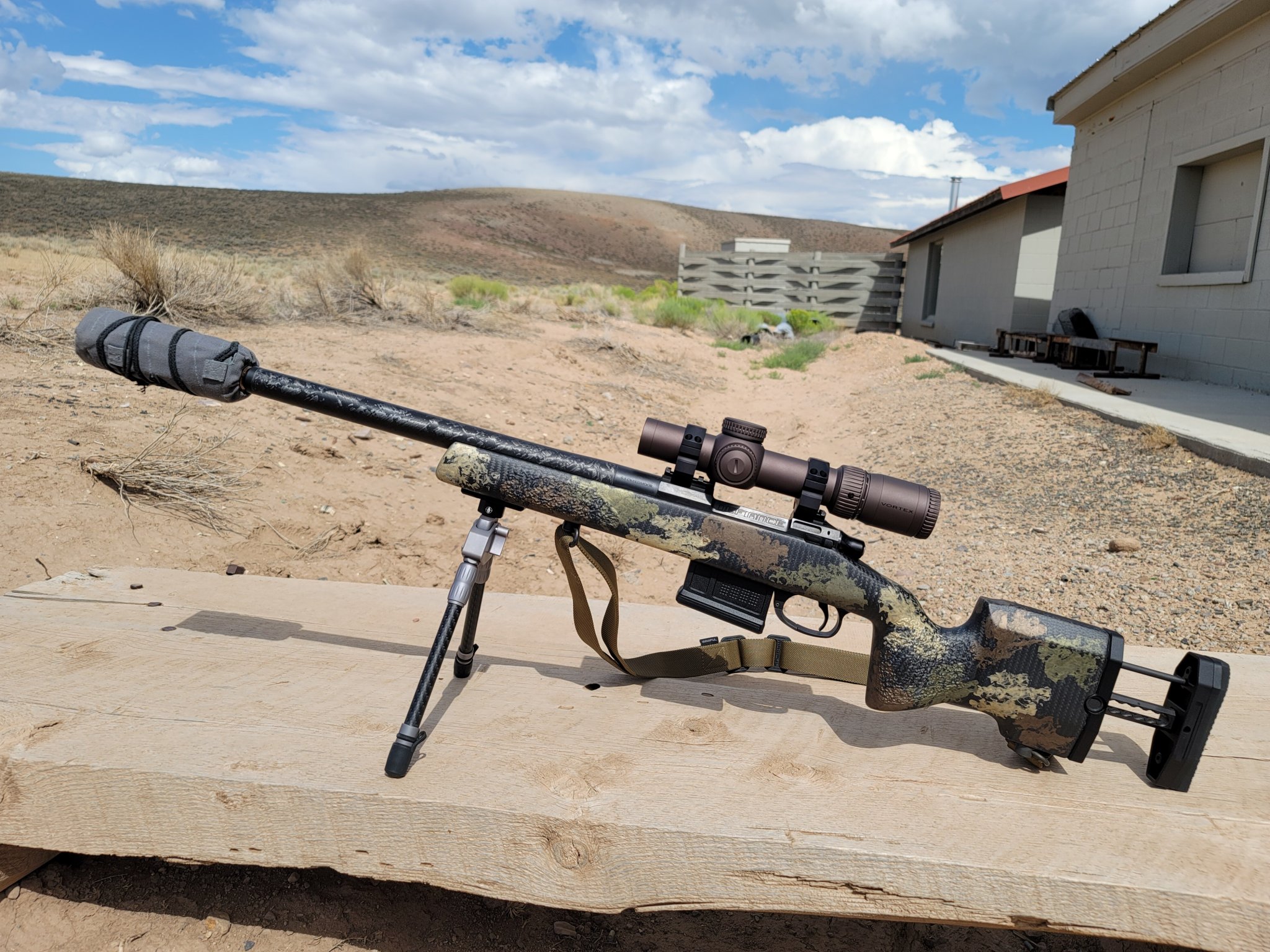

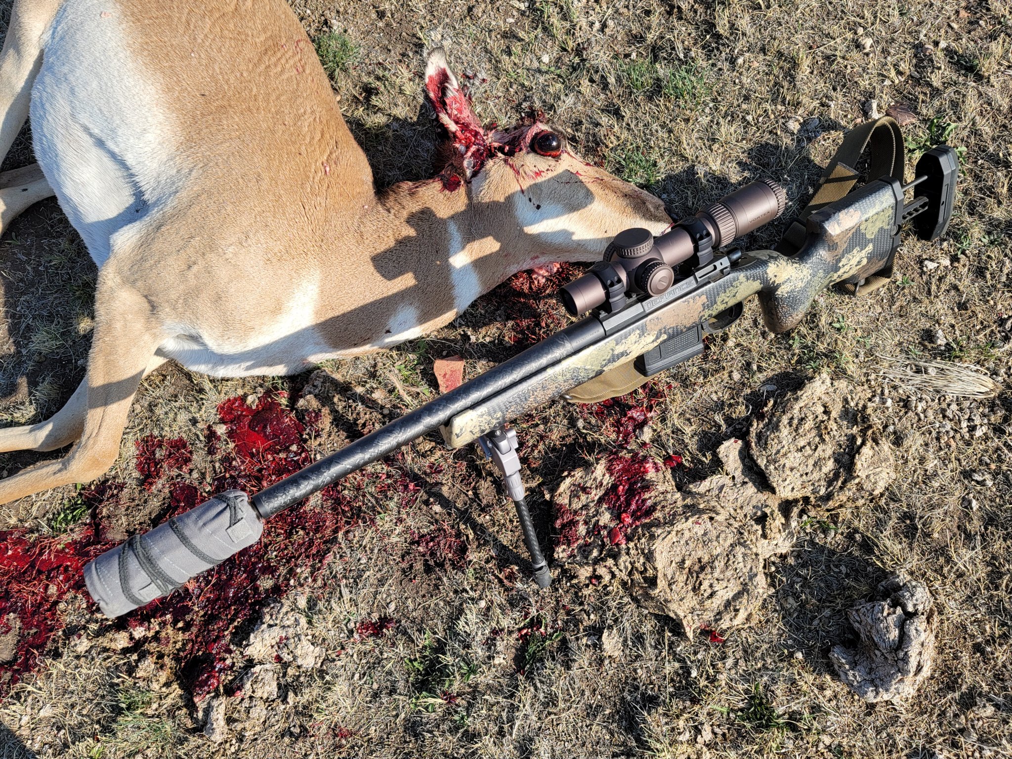

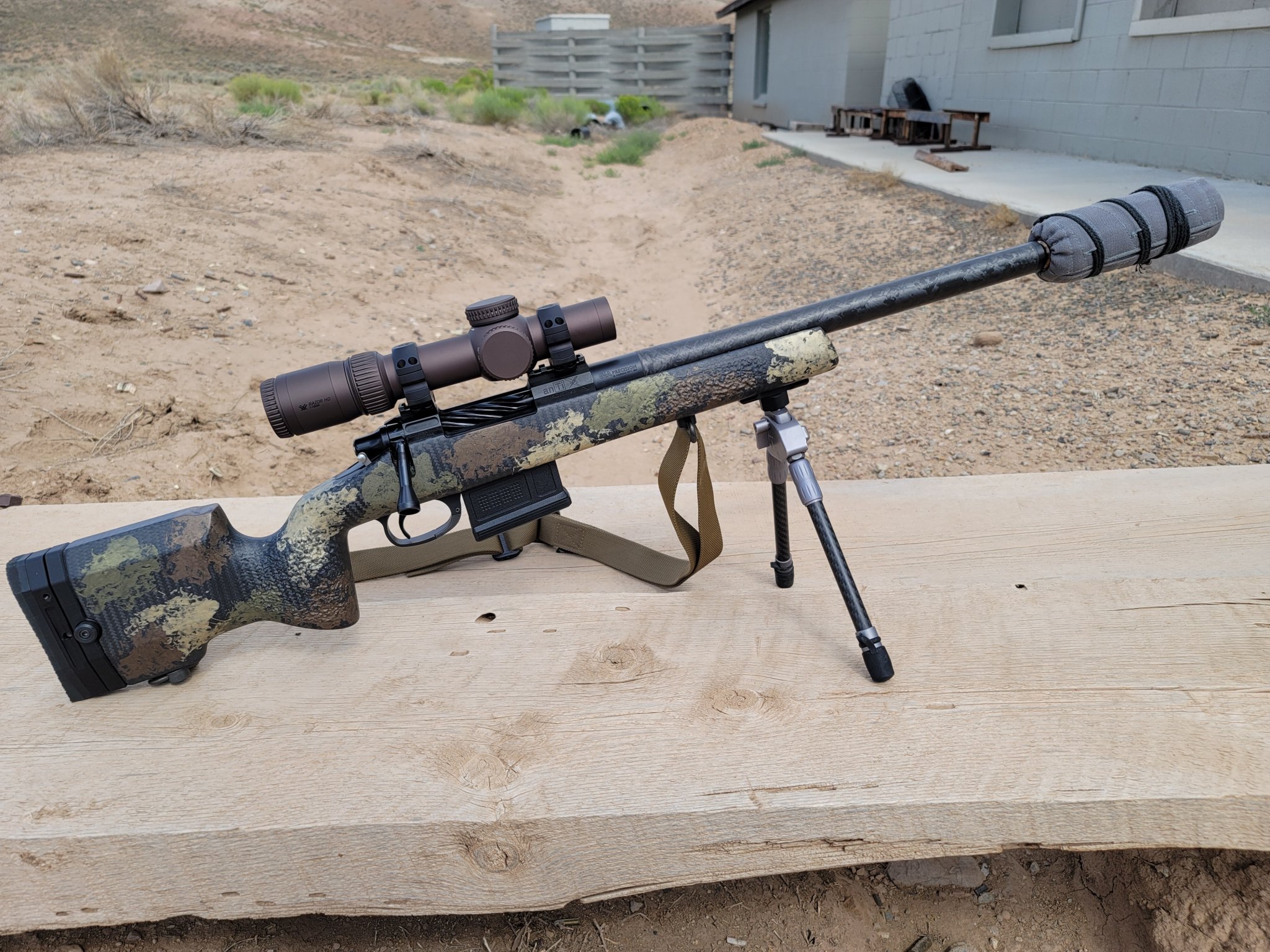

    I had an MCS-CS for a while that I have sold. I also love a short LOP being as I'm a short fella.
    My takeaways from the CS are as follows:
    1. The forend is way too short. I couldnt sling the rifle because the front sling point landed too far back.
    2. The adjustable LOP is cool, and it does make the rifle a little more compact, but it definitely weighs somethin, and it doesn't make it THAT much more compact.
    3. The grip was great, manners has nailed the grip on this.
    Bottom line, I shoulda ordered an EH1 or an LRH and just gotten a custom LOP. Thats the direction I'm goin next.

    What length barrel is that? I will be running a 16”
