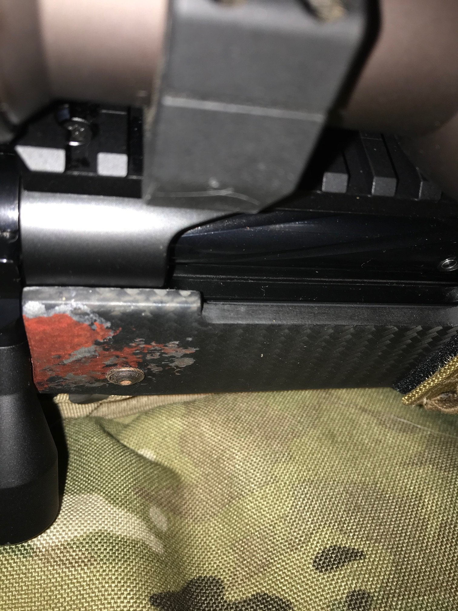

Here is an example. I got this Manners set up for a 700 but put a Bighorn TL3 in it. Works just fine but if you want the stock made for a specific action then tell them or if buying used just know this in advance.
Meaning the stock line runs the bottom of the ejection port, so no cutout is required
