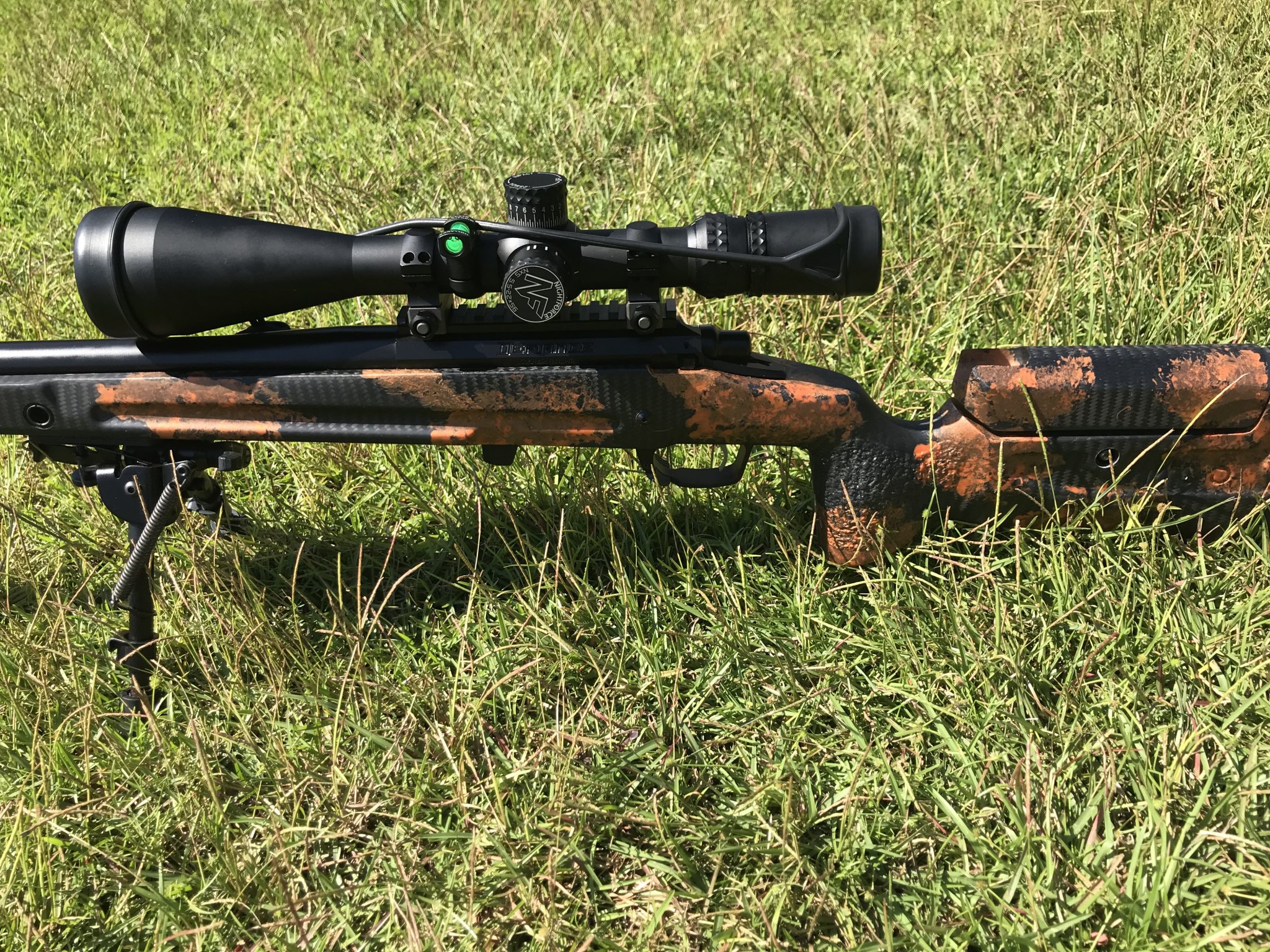

Hey guys. I have the ctr in 6.5 CM and installed the 20moa and bolt knob from tikka performance as they are local. I had a mcmillian a3a5 and it was ok. Sold it. Now I'm digging the nee manners MCS-PRS1TK in copperhead. With chassis and non ctr mags. I cant tell you enough of how much love this stock. Out of the box my tikka was around 1/2moa all day with 143eldx. Prime was a bit tighter. I through havdload In there and It was night and day! As for bedding. I contacted manners and they said some do but dont need to as it sits in the v. Very very sold system. For magz.. my ctr magz let me run my rounds out a bit longer compared to aics mags with with trimming the work great. Accuracy as In greatly and just budge. Had out 1k and still hold moa.i would never go back to any other stock

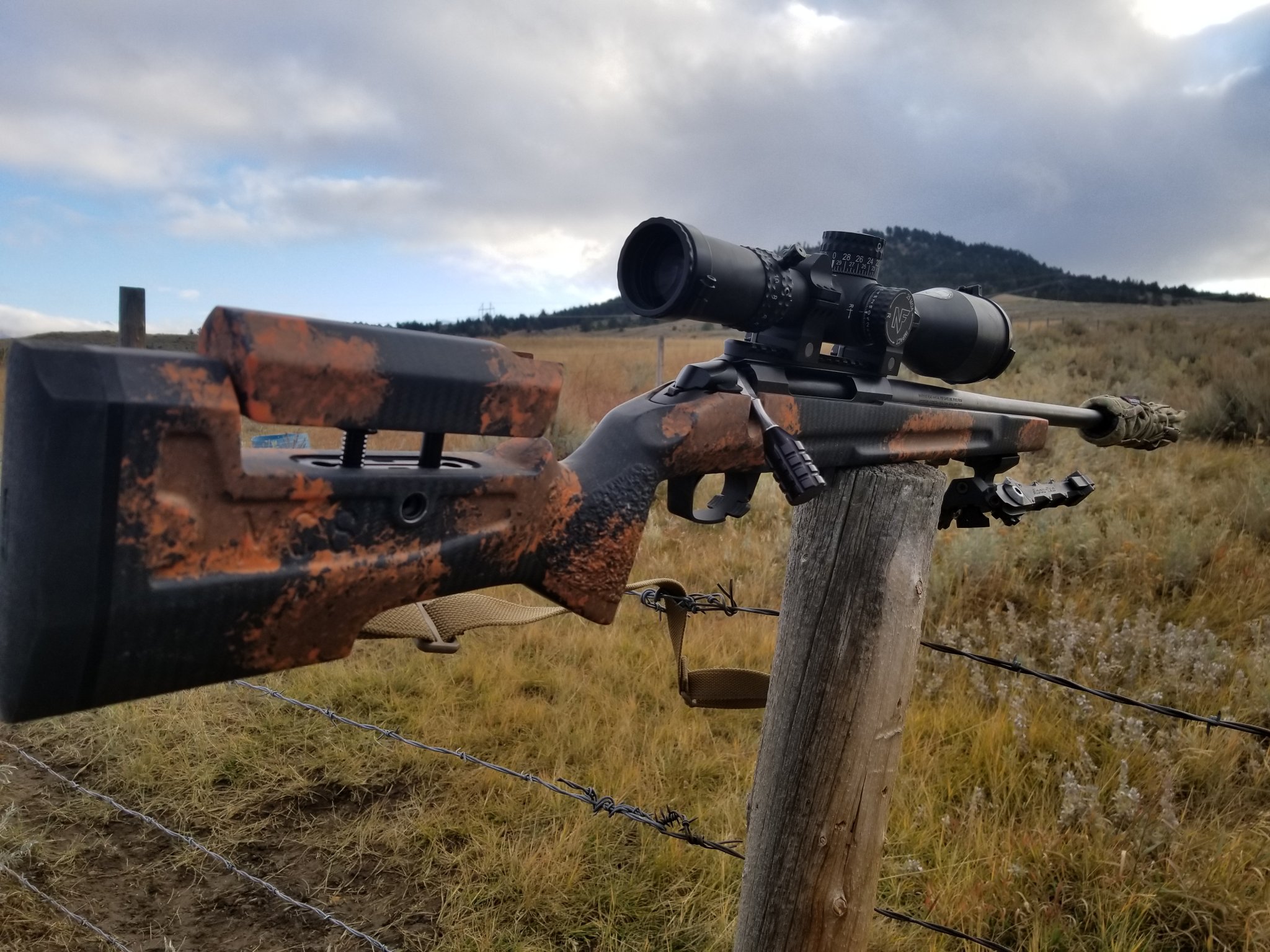

You do realize you’re the one that caused me to get another stock right? ?

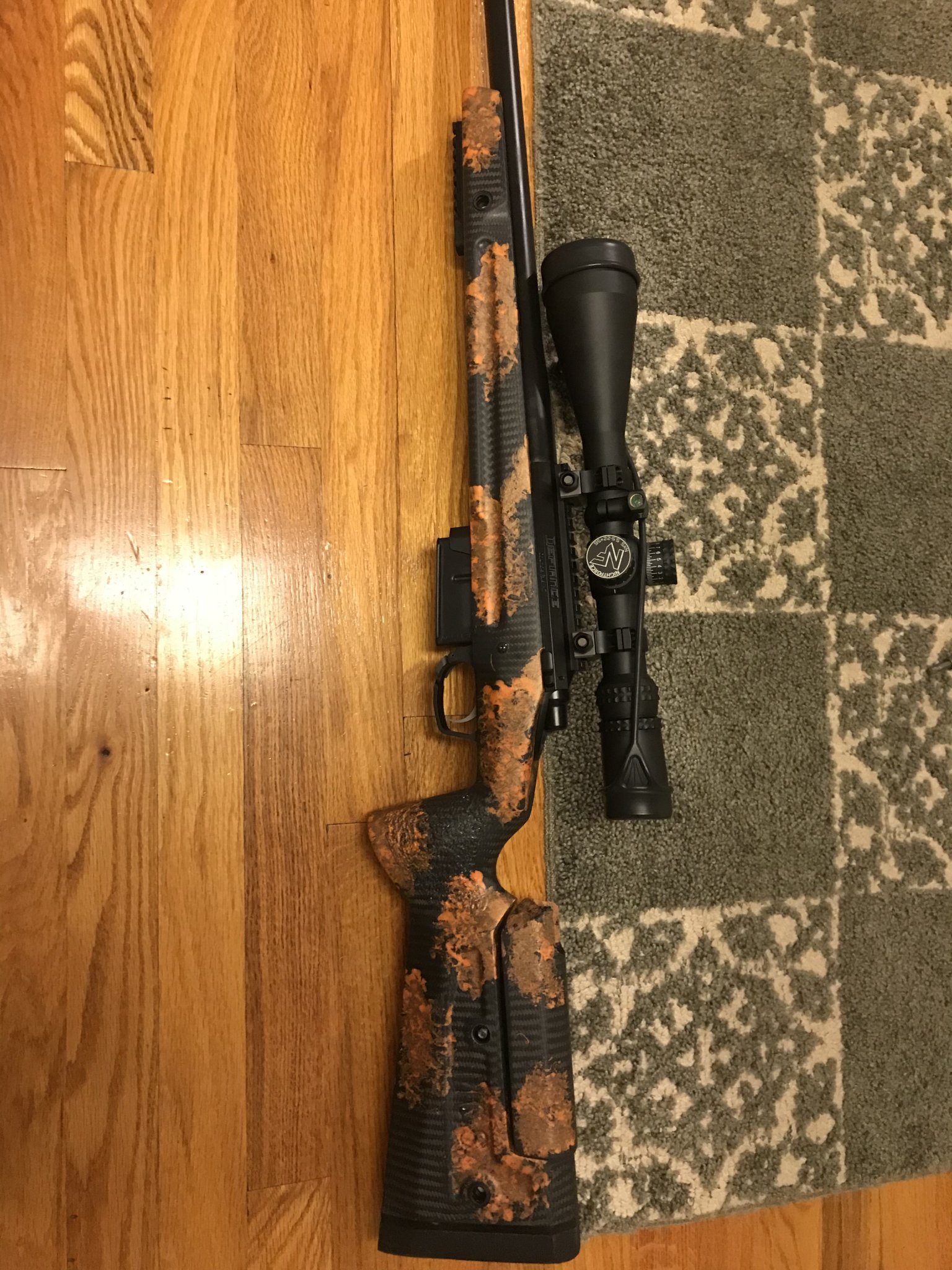

As a quick update as requested, last night I loaded up 5 mags and ran them through cycling and felt smooth as stock. Not a hiccup. I ran the rounds through unfired, so not a real life test, but no issues. That is with the stock Tikka T3 CTR action in the Manners MCS-PRS1TK with mini chassis, and the Badger Ordnance bottom metal with AICS 5 round mags. This is a sweet setup. A long wait (6 months), but nice to finally have it. Solid piece of work.
